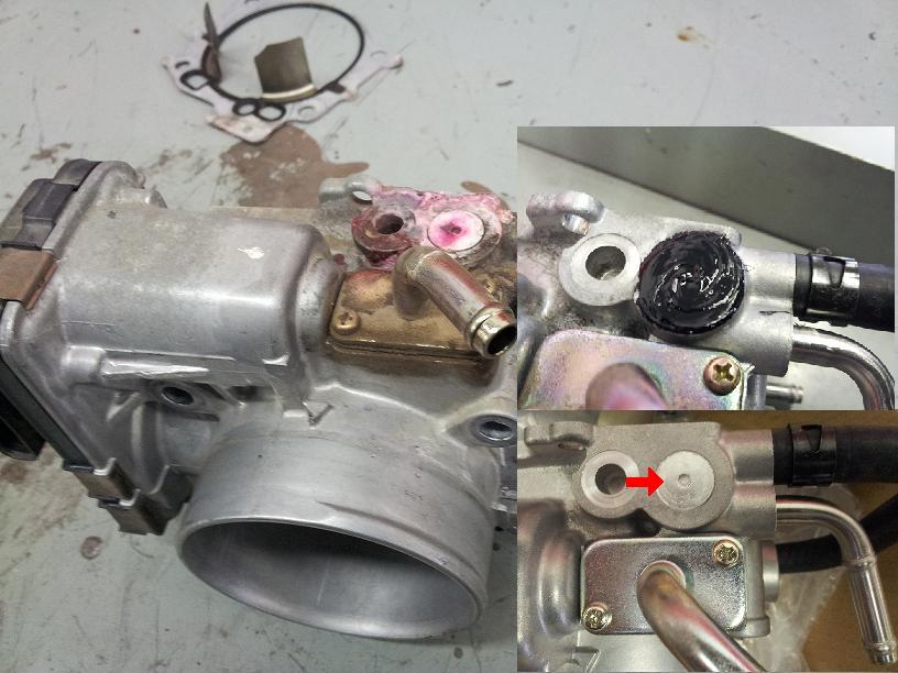

This is just a small "fix" to help save you roughy 1k on a new throttlebody.
When I did my Timing Belt I noticed my throttle body was leaking from one of the plugs on top, its about a grand for a new throttle body and it honestly does not affect performance, but does put your coolant at risk (OAT coolant does not like dissolved air and leaks can quickly degrade coolant's attributes.) I got mine covered unde rmy extended warranty, but a quick and simple fix is to just clean the area off very well, then apply either something like FIPG, or maybe even JB weld over the plug's edges as a "seal".
Here's a picture showing the leak, new Throttle Body's clean plug and my "fix" to the old plug.
I kept the old throttle body, because as I said its still a good part mechanically, just that small leak was the issue.
thanks for that bit of information.. good to know what to check when i do my timing belt, and a cheap fix with some fipg.
