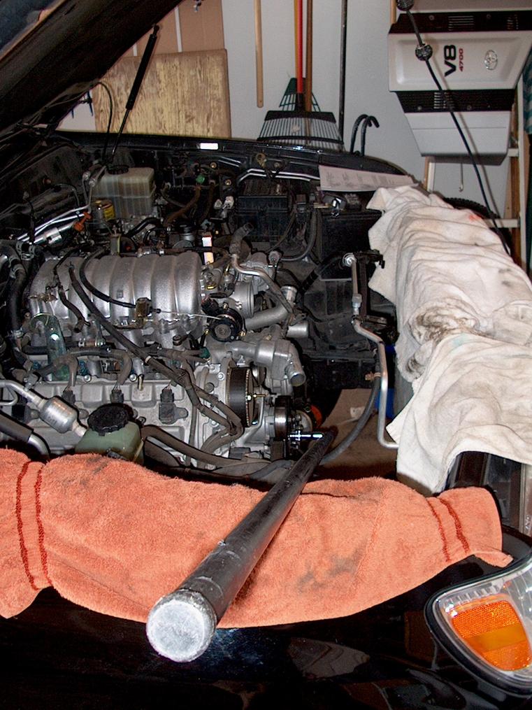

I will add to Nevada's post regarding the power steering pulley. If you remove the pully and not loosen the pump as indicated in the OP's instructions, you should replace the nut - indicated with a black diamond in the FSM. I speak from experience of being stranded many miles later and having to rebuild the power steering pump with a new shaft.
Attaching a photo with my "Breaker Bar" Yakima 48"'er it took to loosen the crank.
