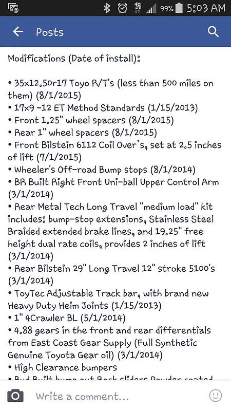

BMC, 3" Suspension, 1"BL, Alot of cutting, and/or swapping out your front bumper with a aftermarket bumper to run 12.5" wide...
You still have the body lift... What tires are you running (sig says 285s...) I remember you having major issues with the steering and the body lift and stating you were taking it off. Love the new paint job, BTW.
I got a buddy with a 1" Body lift, 3" suspension, and he did a bunch of cutting on his fenders and fender well ... His rig's actually for sale.

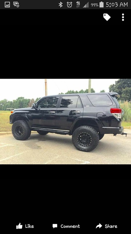

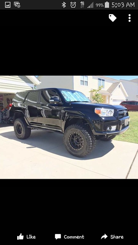

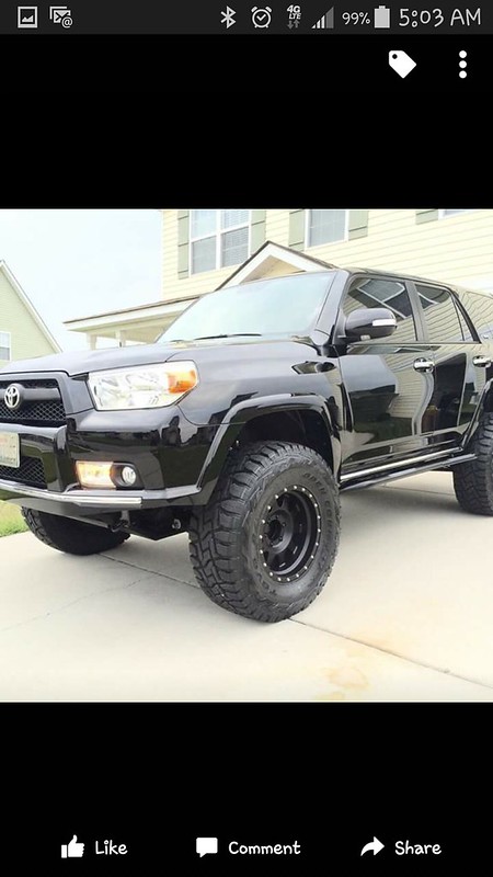

So he had 35s with the 1" body lift with off-road success? Curious to hear more about the body lift as an option....It's just not been done on 5th gens much.
A big issue you'll continuously run into with a body lift is going to be alignment of aftermarket bumpers in relation to the body and our frame mounted slider options.
To me, a body lift isn't even an available option with what stuff is available for our tucks but that's just me. If someone can get it all to work cleanly then more power to them.

Anybody really interested in 35s + a body lift should really be looking at another platform if off roading is the goal.
Yep, that was my first thought about the sliders and plate bumpers... but, those should be resolvable with some minor league fabrication skills.

Not trying to start something... But why is it not to use as some of us would like? Because it does not have big heavy plate bumpers and a swing out?
It actually looks well put together and done (at first glance). Just because it looks stock does not mean it does not have plenty of clearance....
Not being cookie cutter does not mean its a poorly done job.
Nobody said it was a poorly done job - not even sure where that came from. :shrug: And yes it has clearance but I would be concerned abut stuffing those wheels.
Again, we both are just seeing a few pretty pictures and have no real clue how it performs.
It came form you saying "but not to use as some of us would like. Anybody really interested in 35s + a body lift should really be looking at another platform if off roading is the goal."

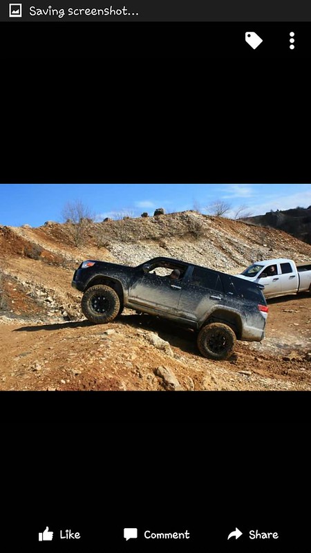

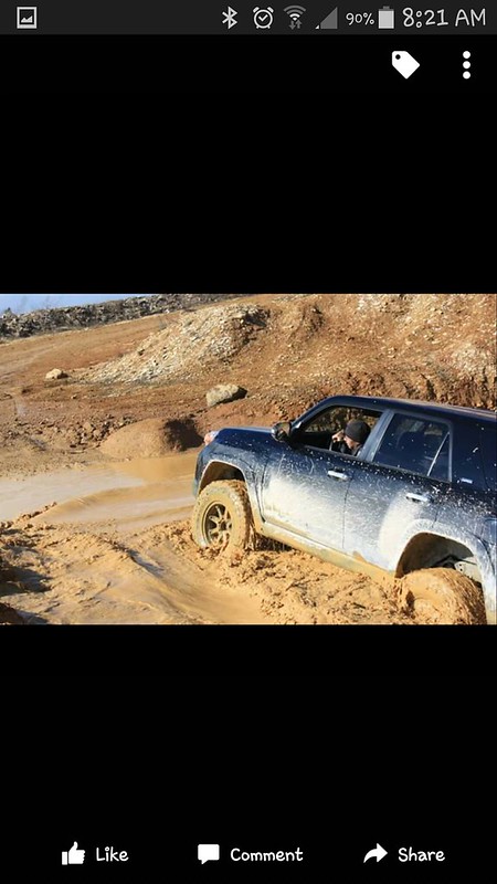

Yes, we only have pictures and a listing of installed parts. But the list looks like it was all resolved and actually built to use offroad.
Dude ignore these trolls that have nothing better to do than circle jerk eachother all day. Yes it can be done and its an absolutely valid question. As someone whos come from countless old landcruisers and built more early f engines and drivetrains than i could count, i didnt know dick squat about these 4runners. it will take a little work but can be done no issue.

I like that just because something looks clean and pretty doesnt mean it doesnt go wheelin'
Dont judge a book by its cover:
