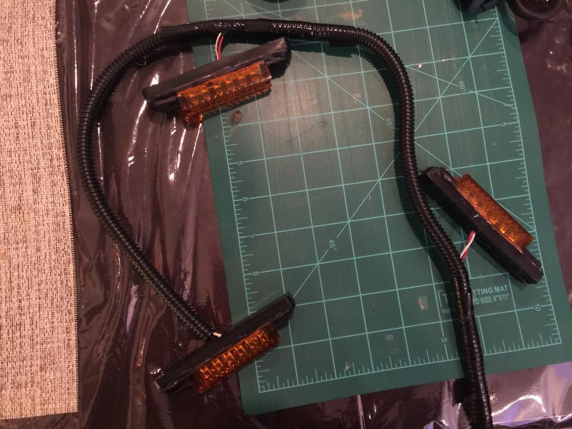

This is what I did for mine.

[MENTION=153114]tacoyota[/MENTION];Can you take some closer in pictures of the lights you used and a link to them?
I will when I get the chance. They are actually not as bright as the other brand though. More understated single led look than full diffused light. Still a toss up if I want to change them out or not.

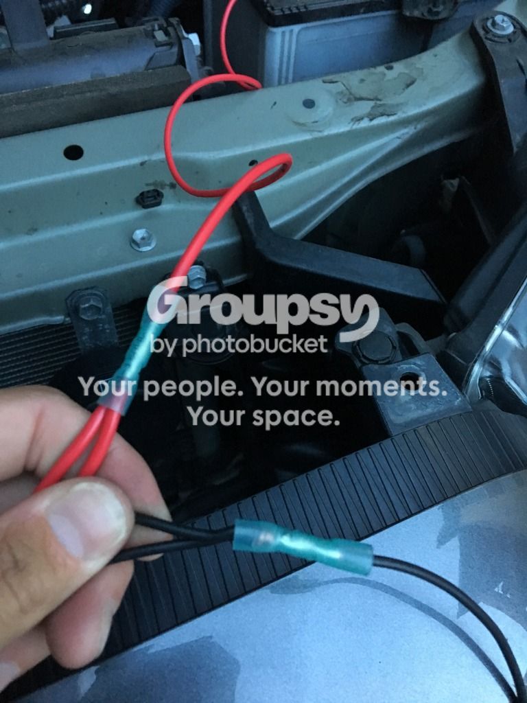

Need help with wiring!
Just found this thread and have read through the pages. Seems like everyone followed the RCO thread for the most part, with a few different options for lights and some different options for routing the cables in some.
I have followed the RCO instructions to a T and still can't figure out why I can't get power to go to the lights. Here are a few photos. What am I doing wrong here? Any help...?
Red is going to red wire through a butt splice crimp connector. White is going to black wire through a butt splice. Wires are 16 gauge.
Both red wires are then twisted together and joined to a single red wire through a butt splice crimp connector. This one is a little thicker obviously because of the 2 strands of wire. I feel like maybe this might be it? Maybe its not deep enough into the crimp connector? Or would that not matter as much?
I pulled on each of the connectors and they are all tight and secure too.
From here, then routed the red wire through to the cabin, hooked the add a fuse line to it and plugged it in to the open fuse suggested. Black wire I tried on both spots that RCO said, and nothing. Tried it with my headlights, DRL lights, everything and no power at all.
It's driving me nuts. Disassembled everything even and started from scratch again and still nothing.
Any help would be appreciated though!

You need to add a couple of 10 amp fuses (*edit* not 10 amp, do your research, my electrician skills are non existsnt*) to the add a fuse. I disassembled/reassembled my setup 4 times before I figured it out :ybrick:

You need to add a couple of 10 amp fuses to the add a fuse. I disassembled/reassembled my setup 4 times before I figured it out :ybrick:

Thanks for the quick reply camerasncoffee. Did other people have this problem too and had to buy those? Seems strange they didn't add it to the write up though to have these or did I totally miss that?
Do you mind showing a photo of the setup?
How many did you buy and add to the add a fuse?

If you look at this picture from their writeup you can see the fuses on there. I agree that it's odd that they left that part off of the writeup since the rest of it was so thorough.
You'll want to use 2, the pack that I linked to includes 5.

You are a lifesaver. I have been at it all day trying to figure out what the heck I was doing wrong or if I was just terrible at putting splice connectors on. haha. Definitely felt like it wasn't rocket science though and I was missing something in there.
Thanks a ton! Going to go snag them from Autozone tomorrow and give it a try.
I only had one fuse and it worked fine. Mind it didn't work when plugged into one of the port versus the other. I thought it was odd.

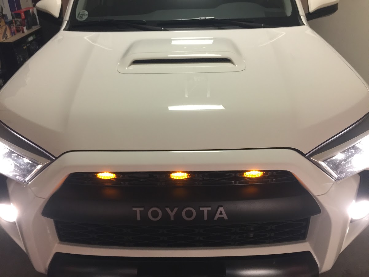

Super late to the party.
Went the RCO route this past weekend and bam!
