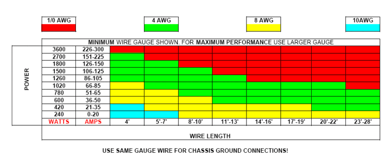

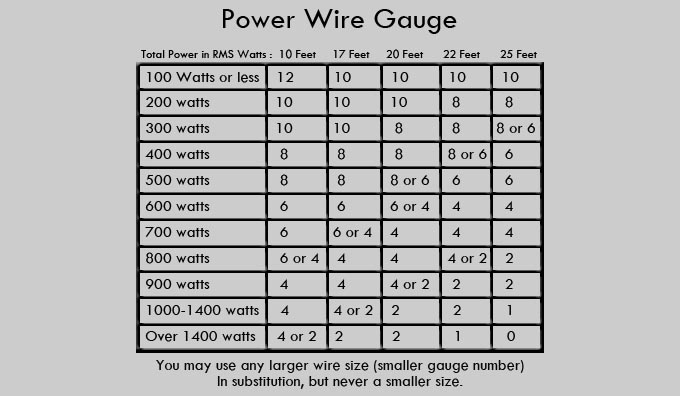

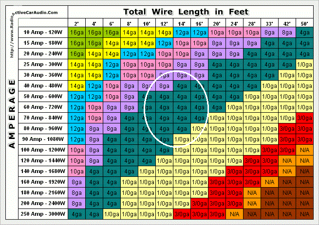

This chart ASSUMES you are running TRUE Copper 4 AWG.
Most of the 4Runner wire kits are 10-12 Feet.
If you are running Copper Clad Aluminum (aka most every kit below $100) then you will be about 1/2 as efficient as Copper.
So where the chart shows 4 Gauge you would be looking at 1/0 Gauge which is twice the thickness (I think, never used it myself) ...
They all show the same thing ... @ 10-12 Feet you NEED to have COPPER 4-AWG to handle 1000 W RMS.
All this talk aside, I'm not fully against CCA, just know that you need to modify how you read the charts. On my own vehicle I have a true Copper Kit I bought in 2003, back when it was cheaper running from the battery to below drivers side rear seat. From there I have a 2 ft cable that is CCA running to power each of two amps. My total cable length involving CCA is very small and this mainly because I didn't want to buy another expensive kit. But 10 feet of copper plus 2 feet of CCA is not the same as 12 feet of CCA only.

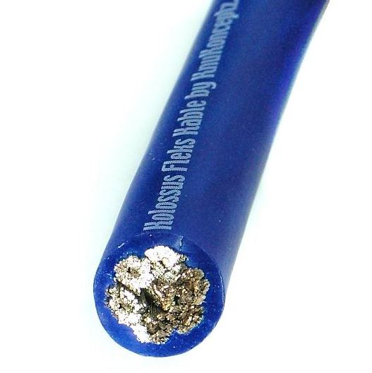

That is definitely copper, I'm running some in the 4runner right now, you are mistaking the silver color for Aluminum, when it is actually tinned to help prevent corrosion.
The KCA is their CCA line, and the Kollosus is nearly identical to Kicker Hyperflex, which is some of the most expensive wire you can get.
Dude, how can COPPER, an element have a silver color?
The only answer is that it is not copper. In the ad they never claim it is copper.
BTW the one on the right (that you say is the most expensive) does not look anything like 1/0 Wire. To me it looks like barely 4-gauge.
I know buying a true 4-AWG copper kit is a long shot these days but I wanted to point out that there is a huge difference in quality between the $40 kit and the $100 - $150 kits. You get what you pay for, in this case the value lies in the low resistance.

"The Kolossus Fleks Kable - High strand count, 99.99% purity tinned Oxygen Free Copper cables with an ultra-fleks PVC jacket. This stuff is flekskable. Suitable for all mobile and marine applications."
Simple, the wire is coated in tin to help combat corrosion as I stated earlier, the same process is used by kicker and Moster Cable. I'm not arguing here, just trying to help post factual information, and I mixed up sides on that, right is the cheapest (and is junk tbh, left is Tsunami 1/0.)
Paying 100$ for 20ft of 4 gauge you are getting ripped off, copper is around 2.60-2.75 a pound, and even 2/0 sized wire doesn't have a pound a foot, you're paying nearly 2/0 prices for 4 gauge, just because it comes in a kit.
Highly recommend reading this thread if you're wire shopping.
http://www.caraudio.com/forums/wiring-electrical-installation-help/515724-wire-comparison.html
It may be "99.99% purity tinned copper" as they say but that is very different from 99% copper with some tin added.
What you get could actually be 85% tin, 14.99% copper, and .01% dirt and still meet the definition above. The English language is awesome.
By the looks of it that's what it is , basically a tin wire with some copper somewhere, albiet invisible.
