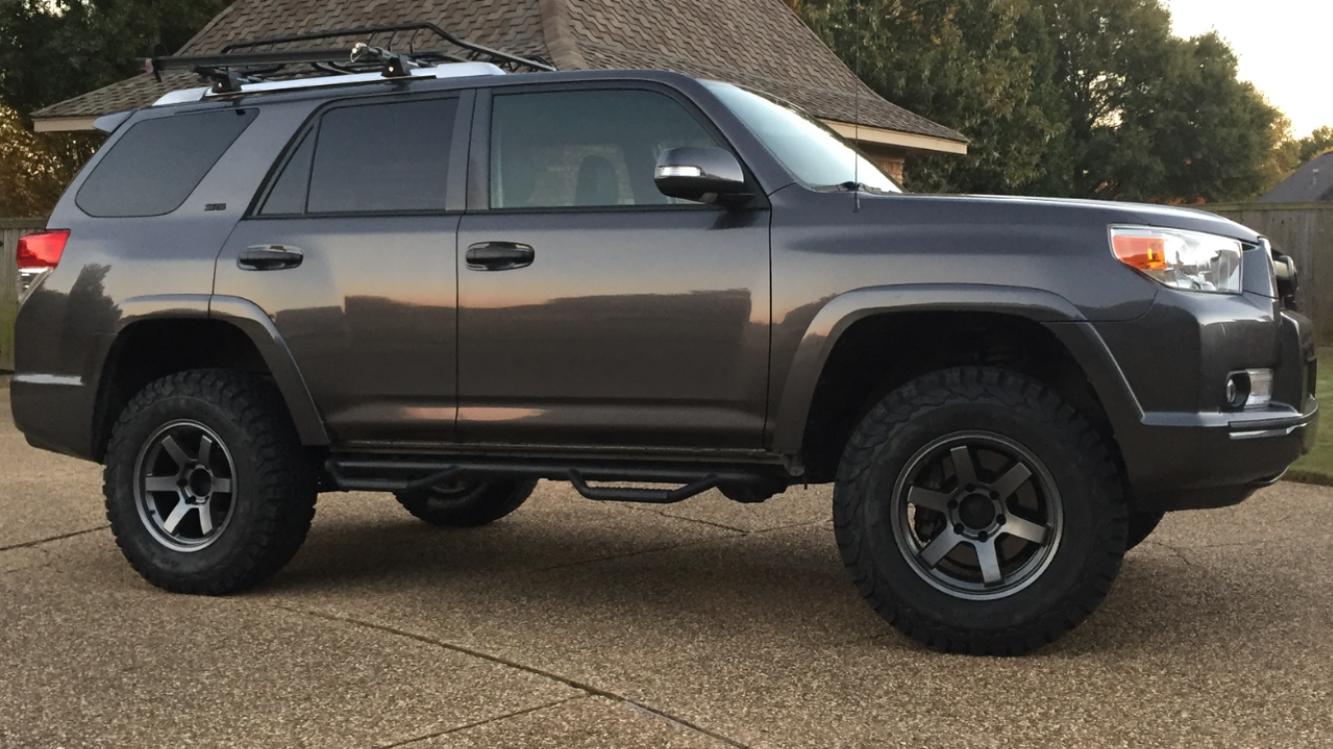

I have a 2011 SR5. Just had the 5100s installed at 2.5" and the 1.5" Daystar spacer in the rear along with wheels tires. The ride is incredible compared to how it felt before. No more nose dive or body roll. To me, this combination gives a great level look with a mild lift.
