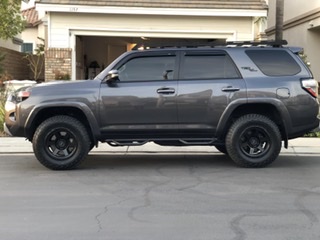

Finally got around to installing my Bilsteins 5100s all around.
Fronts set to 1.75”. Rear has 1” Cornfed spacers.
Love the stance and it suits my needs as this is my daily driver that will only see light trails (no rock crawling).
Hopefully this helps people on the fence about what setting to use or how it’ll look.
Great looking set-up!
Are these 275s?

I scrapped the spacers, didn't preload the 5100s, and instead went with a lift via Dobinsons. I'm also now running 285/70 Ridge Grapplers vs the 275/70 KO2 in the pic. I've got an IG with plenty of pictures - shoot me a PM.
