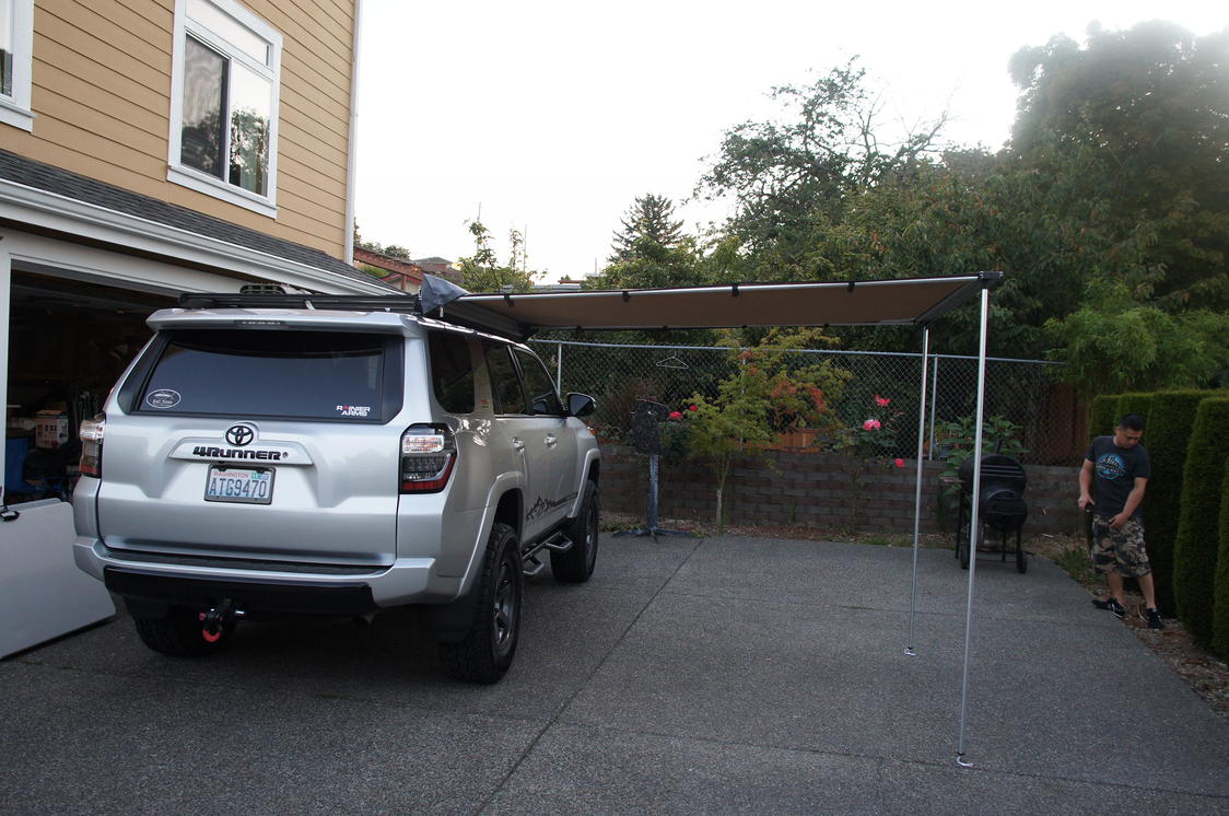

Mounted my ARB 2000 awning to my 3/4th rack after work. Took about 40 mins with the help of a friend. So much easier with a second pair of hands.

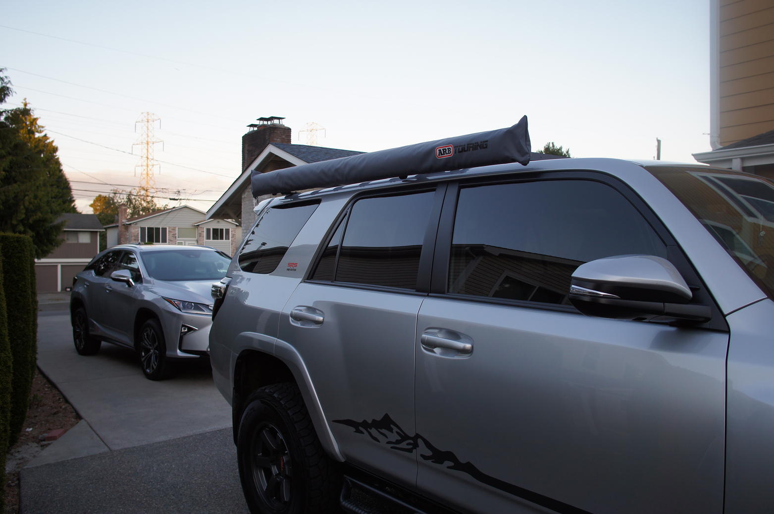

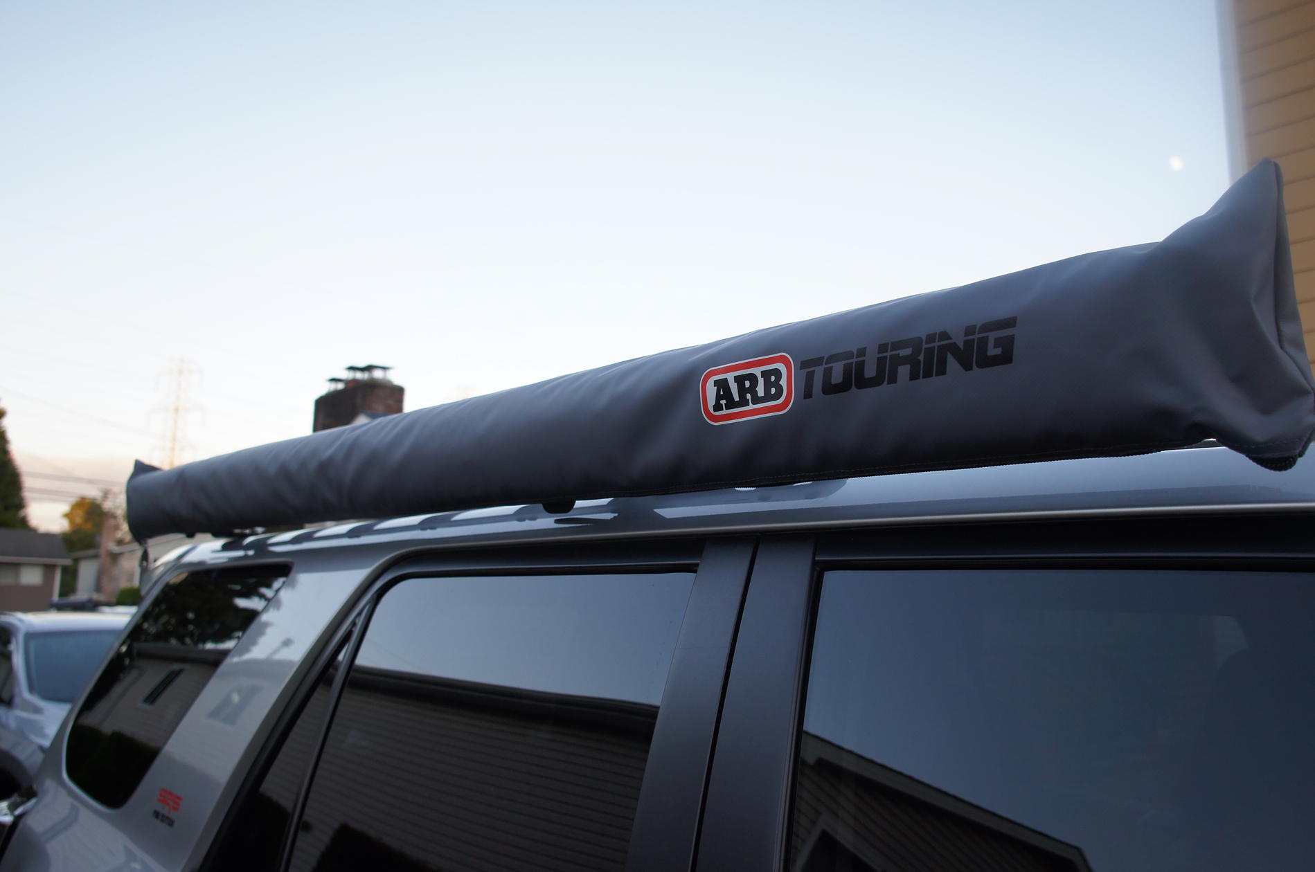

My buddy has the awning on his cabrac as well.

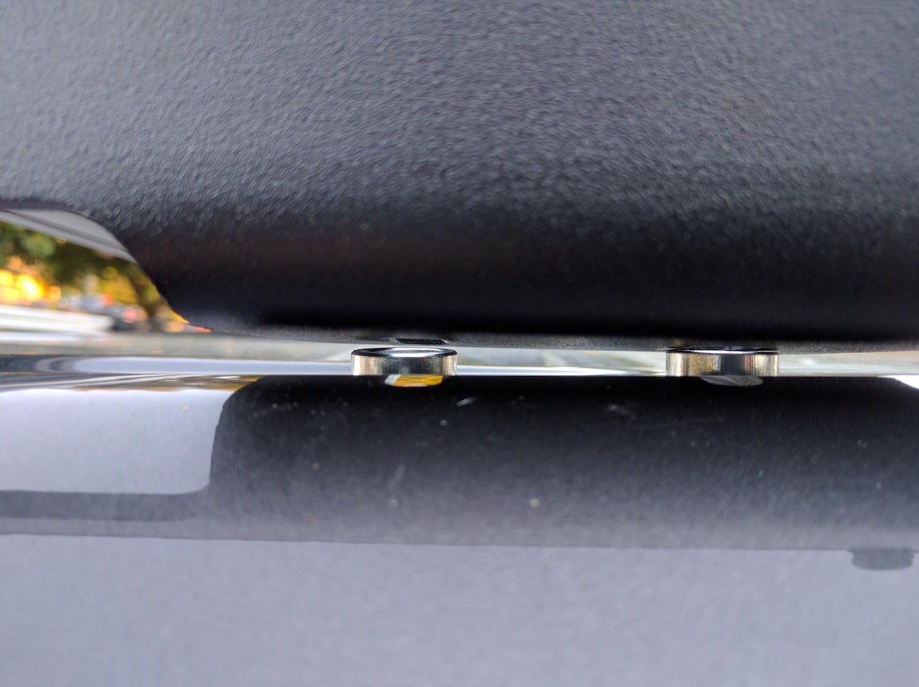

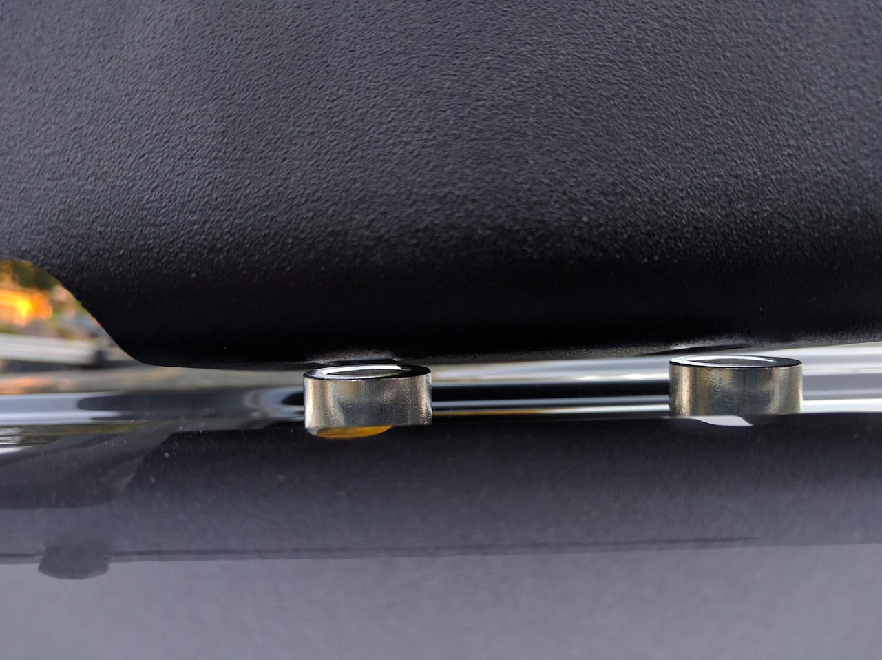

Got the rack all bolted together and undid the OEM unit (use a bike tire lever to remove the end caps - WAY easier than a pry bar). Lined up the full length unit and noticed two things:

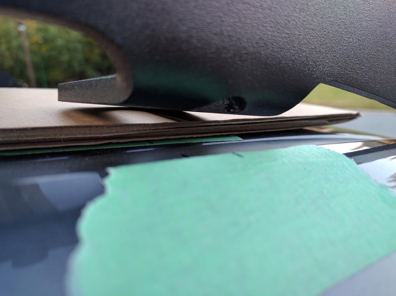

1) Maybe it's me but it looks like the rack does not have 90degree angled feet - or maybe they aren't supposed? When resting on the aluminum spacers they aren't siting flush and appear to be angled inwards... anyone else with a full length unit that can comment???
2) You can not flush mount the front feet. I was looking at trying to use some 3M VHB tape to attach the front feet to the roof line and weather strip - it just doesn't work. The angle of the feet and their length interfere with the ridges in the roof sheet metal. I could see the possibility of using a slim piece of metal in the channel attaching to a wider piece that the footings could then rest on...
Because of the weird angle issue I ran into, I ended up putting the OEM back on until I can determine if I need to piece the side rails in a vice and "adjust" the angles properly...

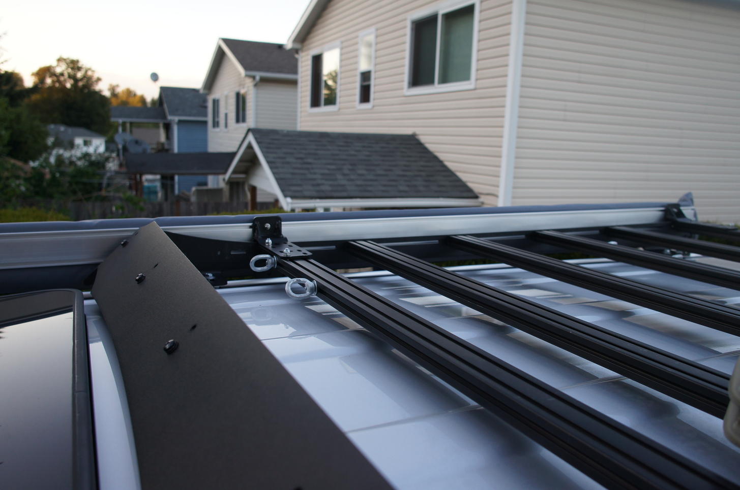

Ok here are some pics from the dry-fit...
So the rack doesn't fit properly?
Sorry should have followed up but I have been out of town... Once bolted down yes it fits perfectly. You could get a way without drilling the front by creating a foot that sits in the rain-gutter/weather strip channel and then punching a whole through the weather strip and attaching that way with some RTV silicone adhesive... depending on how off roading you are going.

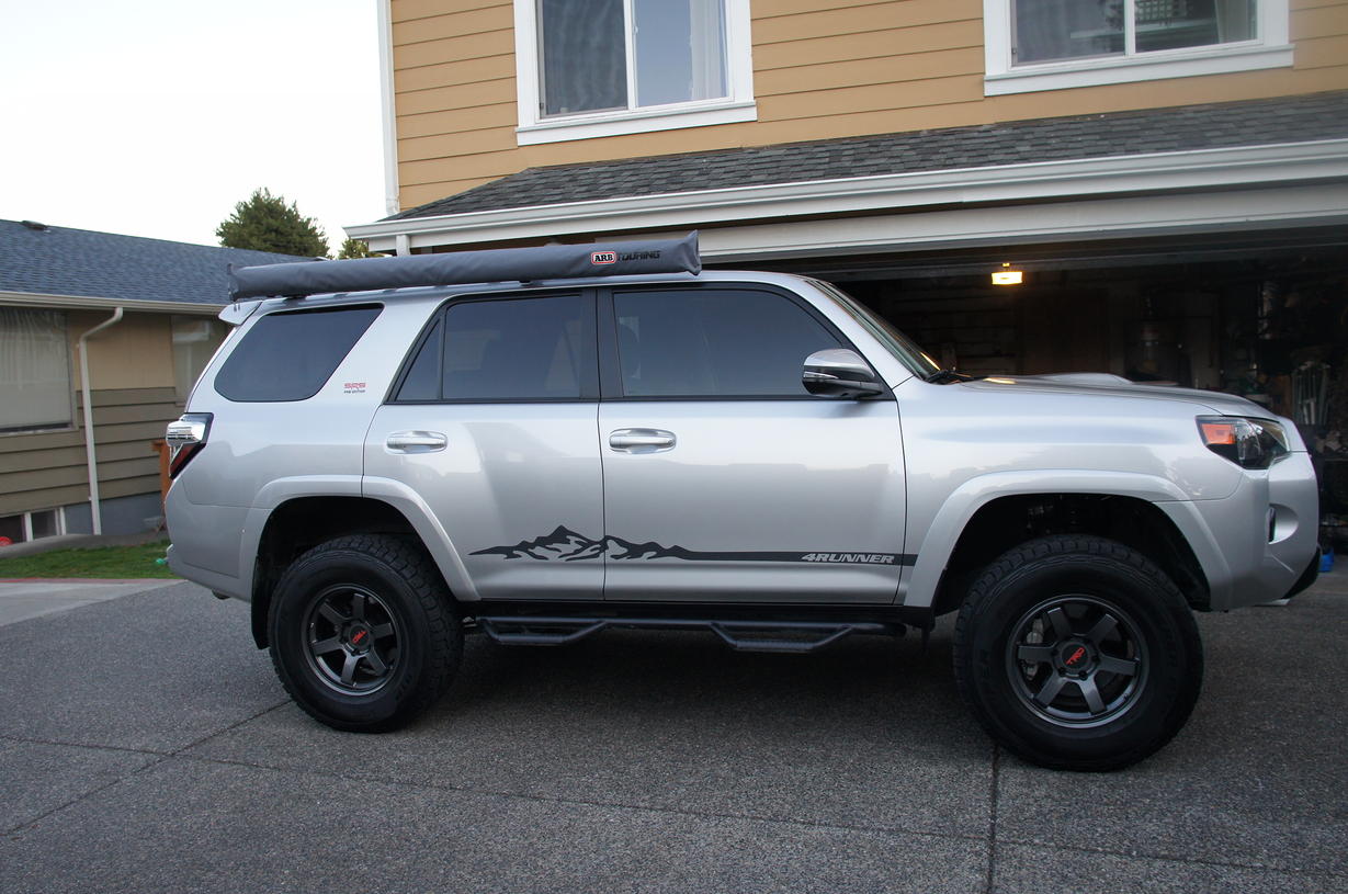

finished pic below :-)
I HIGHLY recommend the rack!
