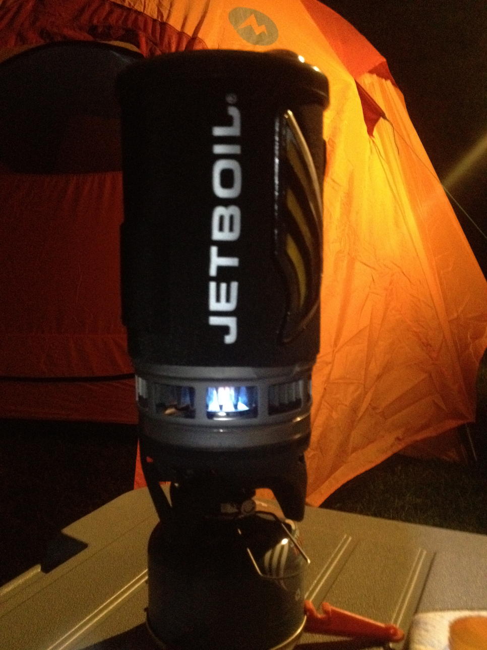

On a completely different note, how do you like that JetBoil? I'm looking around for a camping stove and have been eying that one for a bit. It gets mixed reviews most places i've looked though.

The JetBoil is AWESOME. I take it hiking, camping, fishing, and when it's not there it's in the 'Runner. The fuel lasts a long time and it heats really quickly. I also like that it cools down just as fast to pack up.
I wish I would have opted for the Flash with the piezo igniter though.

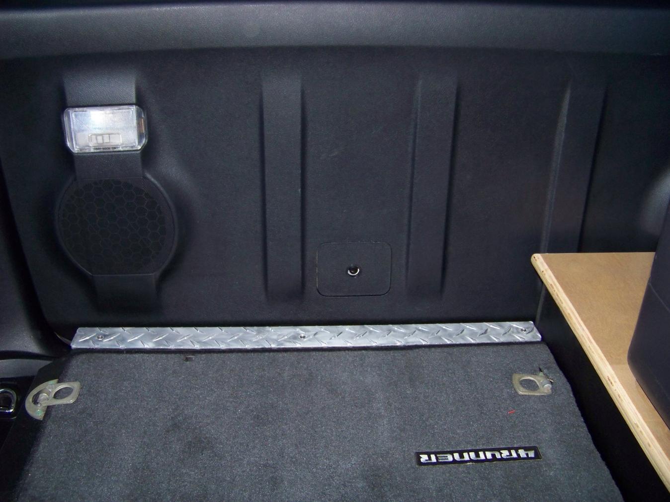

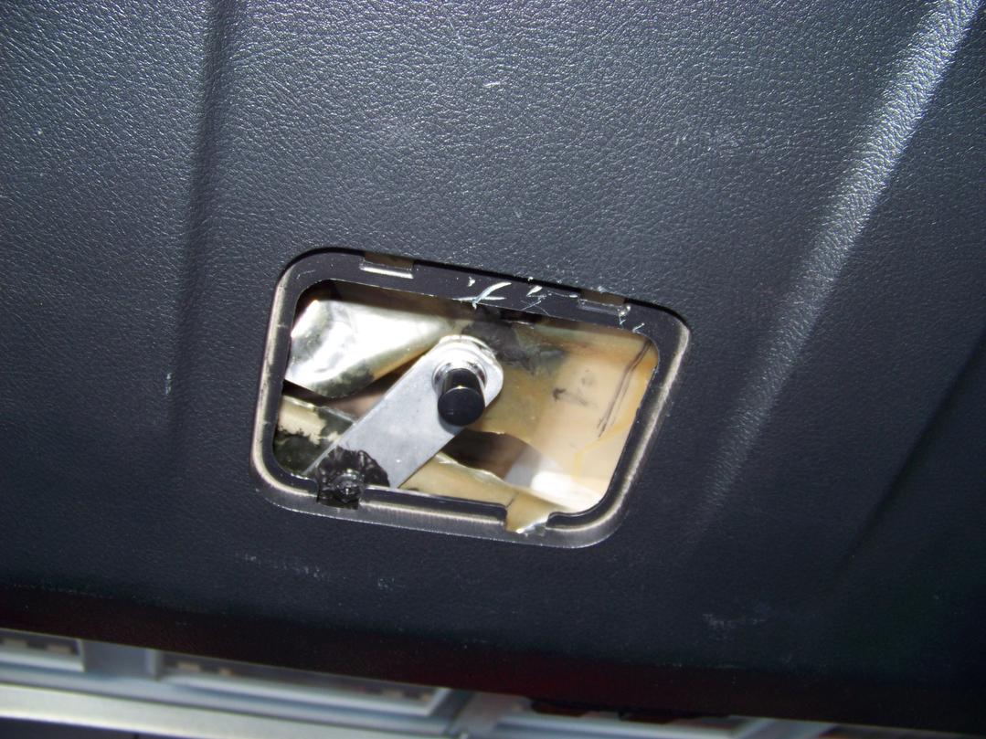

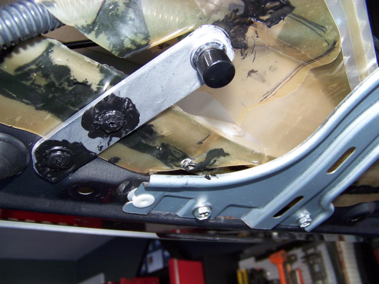

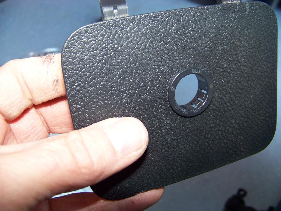

INSIDE REAR HATCH RELEASE BUTTON
For those of you that sometimes sleep in the back of your truck, this is a useful little mod. Sometimes I sleep back there. I always have the child-locks for the rear doors "on", so the only way for me to get out is to climb over and into the front seats- what a PITA. This little switch fixes all that!

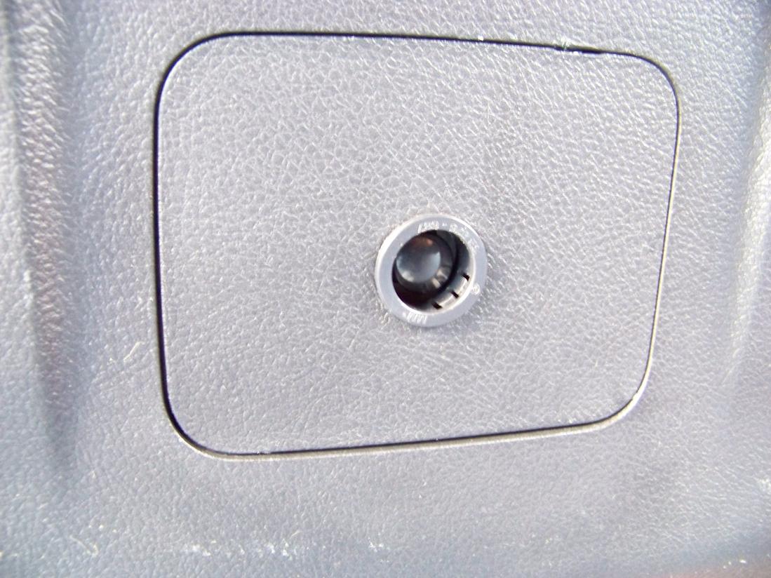

To prevent the switch from being accidentally triggered, I mounted it behind a 3/4" access hole. Just to make things easy to get to, I mounted the switch on the hatch (not somewhere in the cargo area which is another option) behind an easy access cover.
First you will need a push button, normally open switch; [open]/closed. This switch will send a +12V pulse to release the latch.

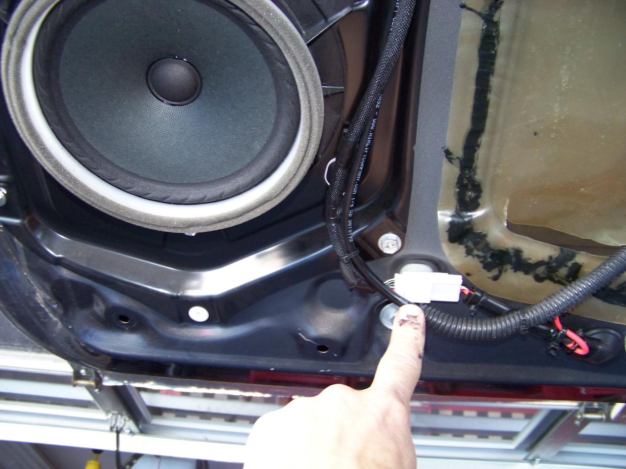

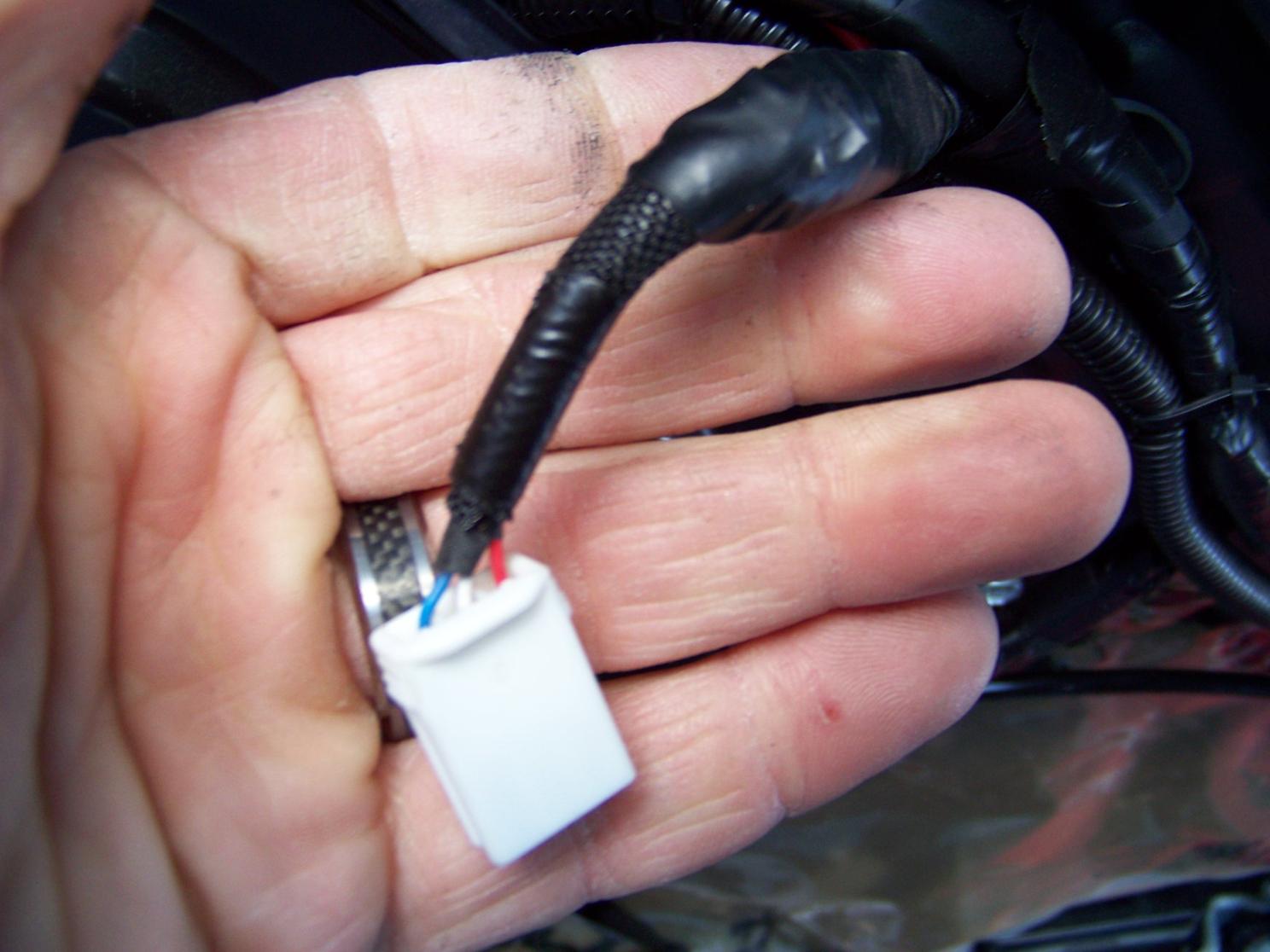

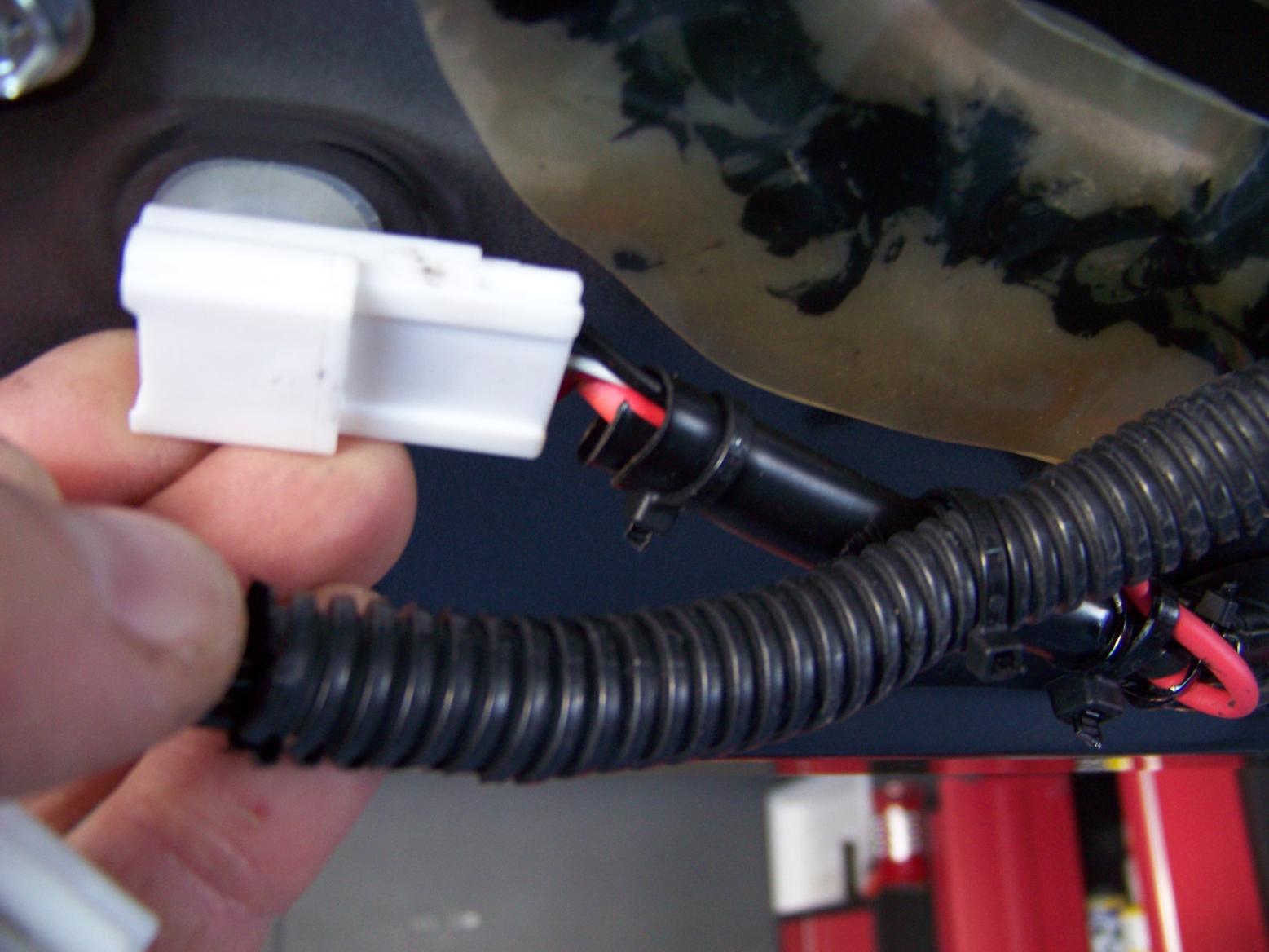

This is the plug that powers the hatch release. You need to access the red wire. I tapped into the side closest to the latch and used a diode to prevent the power from traveling back into the door release ECU. Not sure if I needed to use that, but better safe than sorry. The tap from this wire will connect to a terminal on the switch (either one).
The other terminal on the switch needs a constant +12v signal. I tapped into the red wire from the rear hatch light plug- here...
Here is the switch mounted to a thick piece of aluminum. I painted the mounting screws with liquid electrical tape to keep them tight.
This shows how far the button is recessed to prevent accidental opening. Just enough room to get your finger in there!
Works great!!
Merry Modding friends!

Seal the plastic lining back up...
Nice work! I will add that you'll want to seal that plastic lining back up; somehow. The reason being is dust. If you go anywhere near a gravel, sandy or dusty road you will wish you never had opened that plastic lining. Dust will go EVERYWHERE! Don't ask me how I know :)
