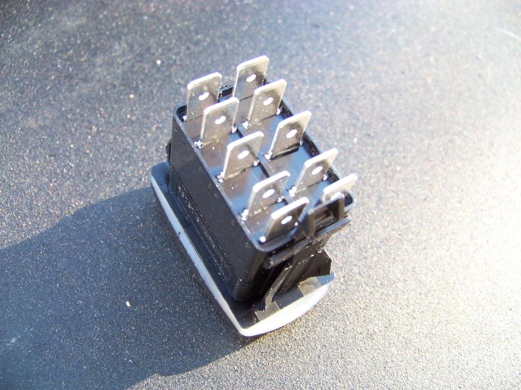

Look at all them terminals on a single switch :wow2:
So much for the K.I.S.S. method, lol
KISS is still in effect, LOL.
The 2 terminals on each end are power and ground for the LED's.
The other 6 are for the switch. Basically this switch is like 2 SPDT switches in one. Two independent sets of 3 terminals, activated by the same switch.
You can do all kinds of things with a switch like this!
LOL I thought exactly the same thing! I didn't even think that was possible.

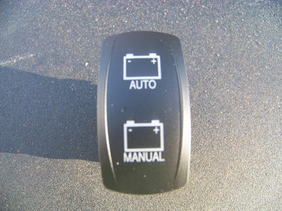

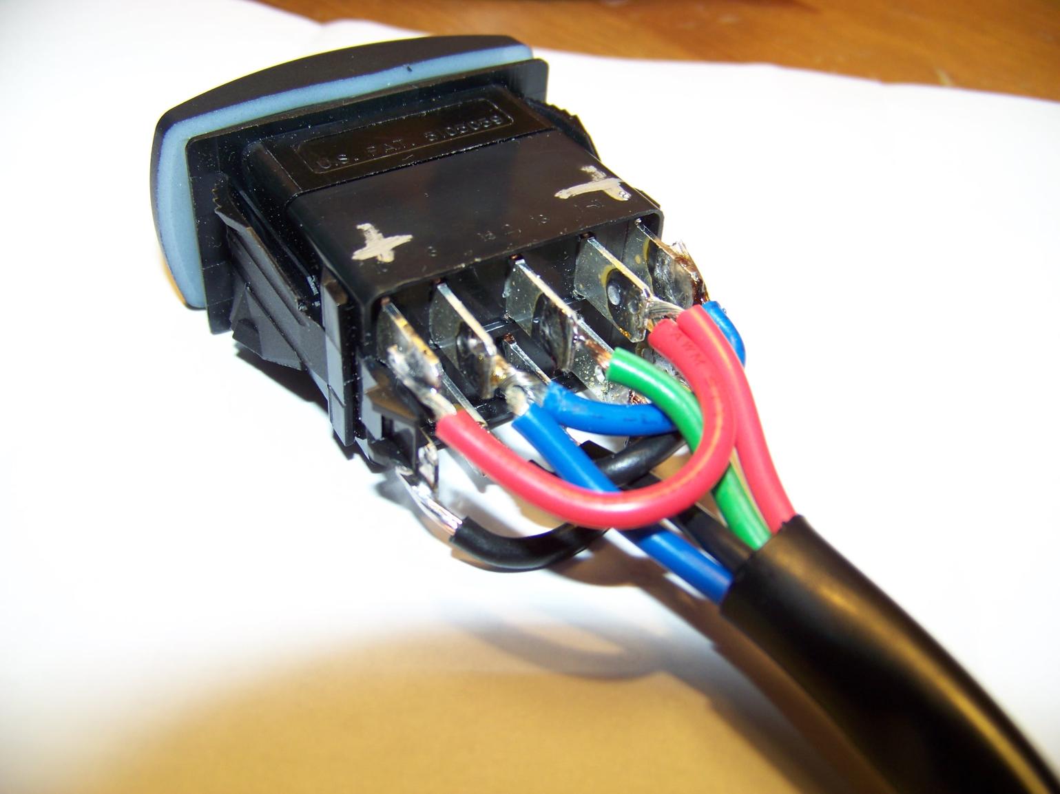

Very crafty as usual Jeff! Can I ask you...I noticed that in the first picture the the top battery is lit green and the bottom battery is just off (when switched in the up position); but then in the second picture the top battery appears to be reddish? and the bottom battery is lit amber (when switched in the down position)? Was that because in the second picture you had the parking lights on? (so basically if the switch was on the "off" position the batteries would be lit up kind of reddish when the parking lights are on?)
And because I'm nosy, what's that little black box at the end of the harness :)
The switch looks like that due to my poor camera skills...
The bottom LED is actually very bright red. The color bleeds through the switch a little and lights the top icon slightly. In person it's not that noticeable.
What's the box? Eddie, I'm disappointed in you! How do you think I was lighting up everything? Lol!
LOL! I was too busy paying attention to the switch lights I didn't even noticed the panel was not mounted in the dash when you took those pictures :frusty:
Aaaaactually, I think it's because your pictures sucked so much I can't even tell if the panel was mounted in the dash or sitting on your kitchen counter, yeah that's it :)

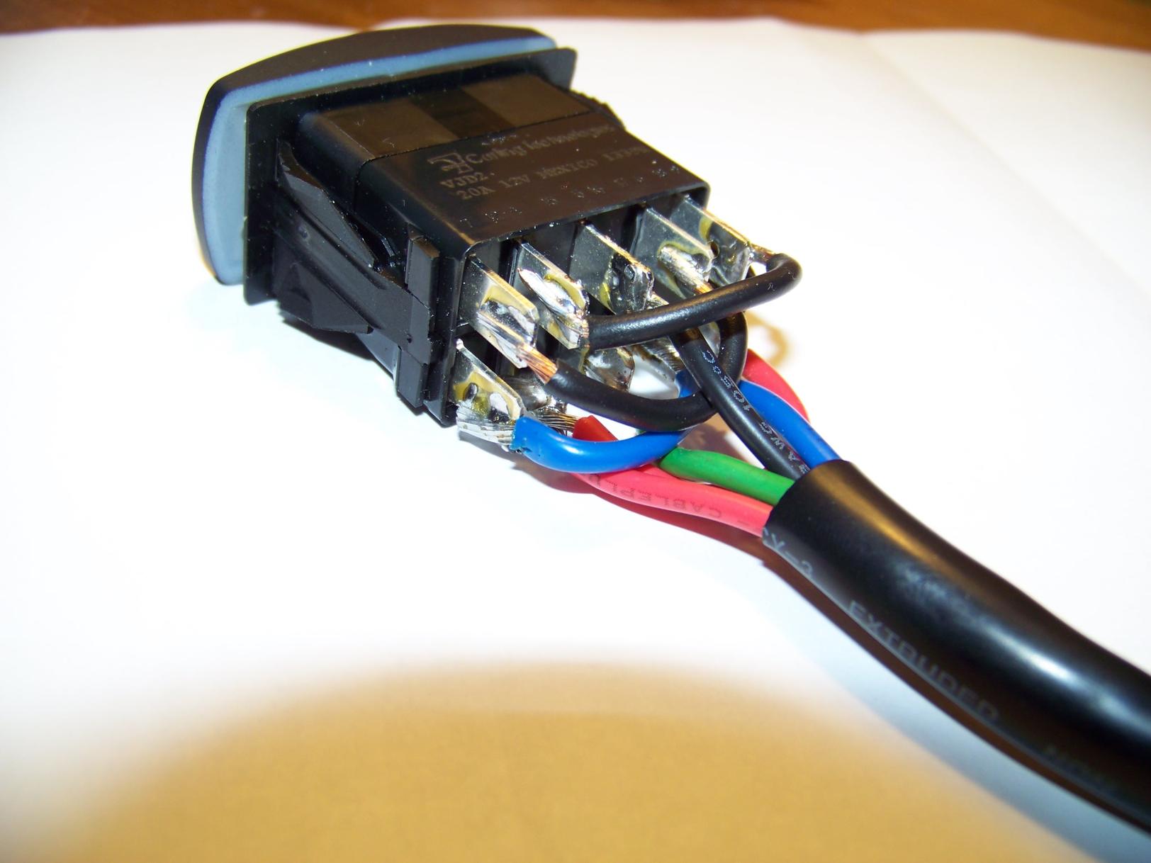

Awesome work as usual! Just out of curiosity, why solder directly to the switch instead of using some crimp push connectors?
Thanks!
1. Soldering is always a better, more permanent connection.
2. Spade connectors have a way of coming loose sometimes and then you have to figure out which one went where, lol.
3. Spades would have made the install depth even deeper.
4. I like to solder.
Nothing wrong with the crimp-on spades, they work. Whenever I use them I always squeeze the connector together with needle-nosed pliers first so they fit tighter.
