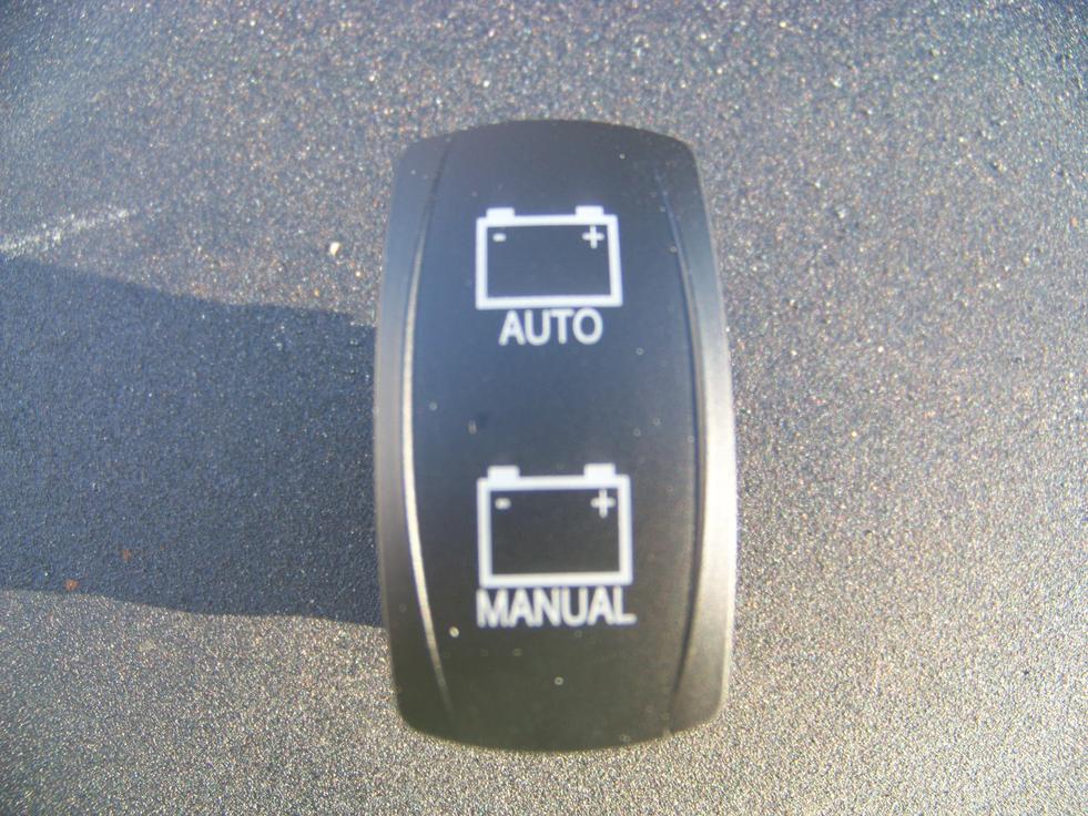

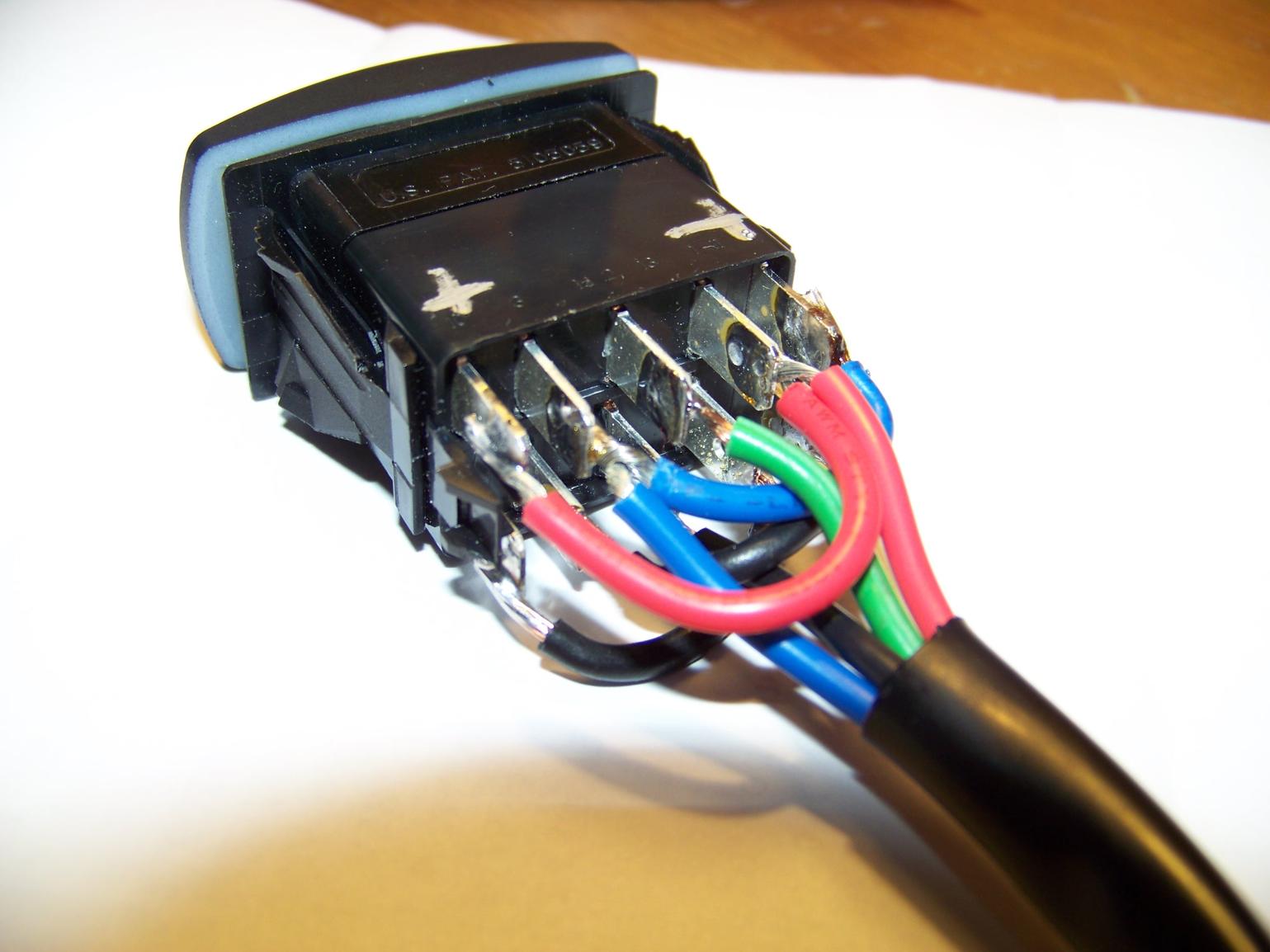

*ON/OFF/ON switch- or OTRATTW V-Series Contura Switch # VJD2UHTB : DPDT ON/OFF/ON, GREEN/DAYLIGHT BRIGHT RED BOTH INDEPENDENT LED'S.

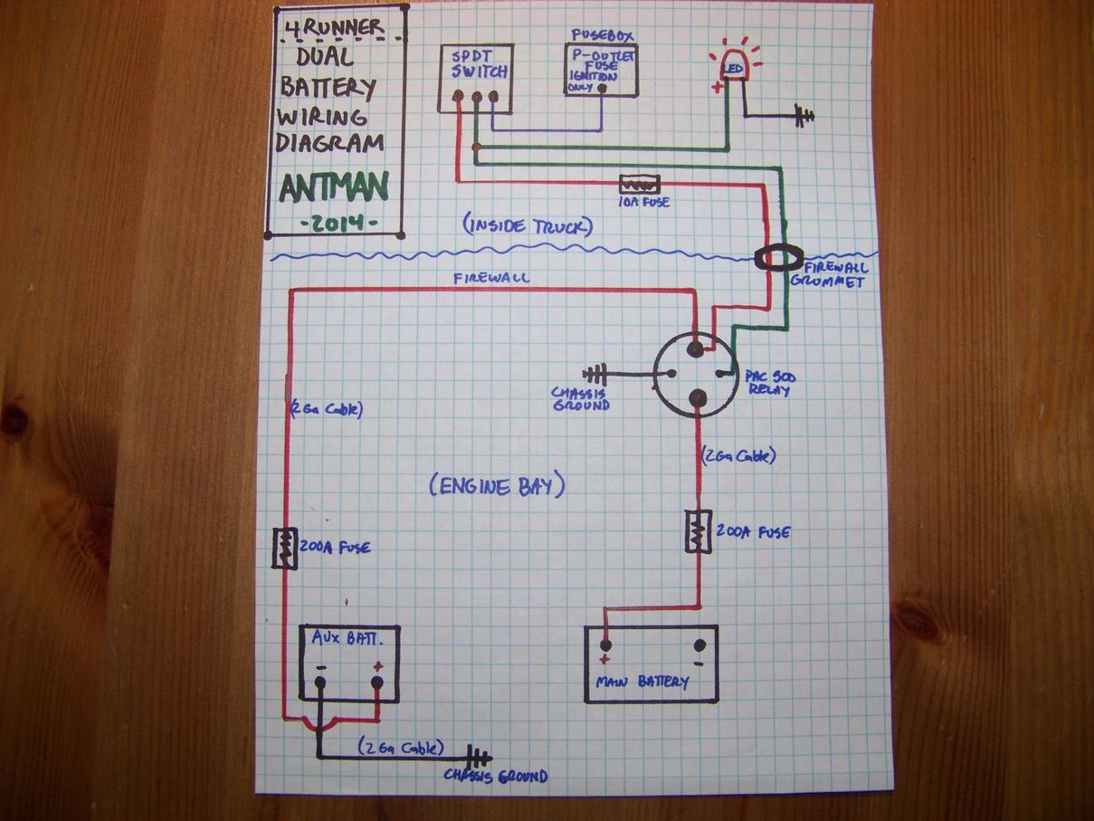

Main Battery positive terminal / 200a ANL fuse / PAC Relay / 200a ANL Fuse / Aux Battery positive terminal. Aux Battery Negative to ground. The PAC relay also needs a ground and a power source to connect .
**Here's a wiring diagram using a simple SPDT switch along with an LED to indicate when the batteries are connected.

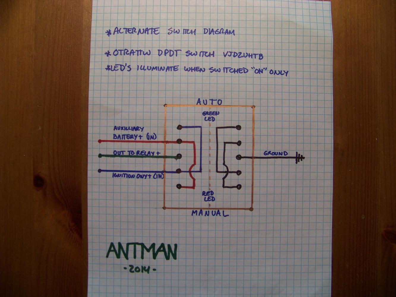

The diagram below incorporates the optional custom switch I used, a DPDT from OTRATTW.
