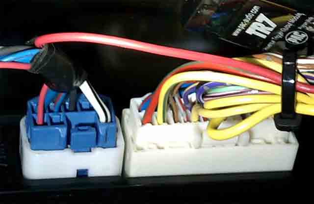

12 volt tap
FYI, someone asked where I tapped +12-volts; I tapped the B8 connector (blue in the picture). I forget which pin; just use a voltmeter and you can figure it out. It's a solid core wire pushed into the back of the connector; the end is covered in RTV right up to the connector so that no bare wire is exposed.

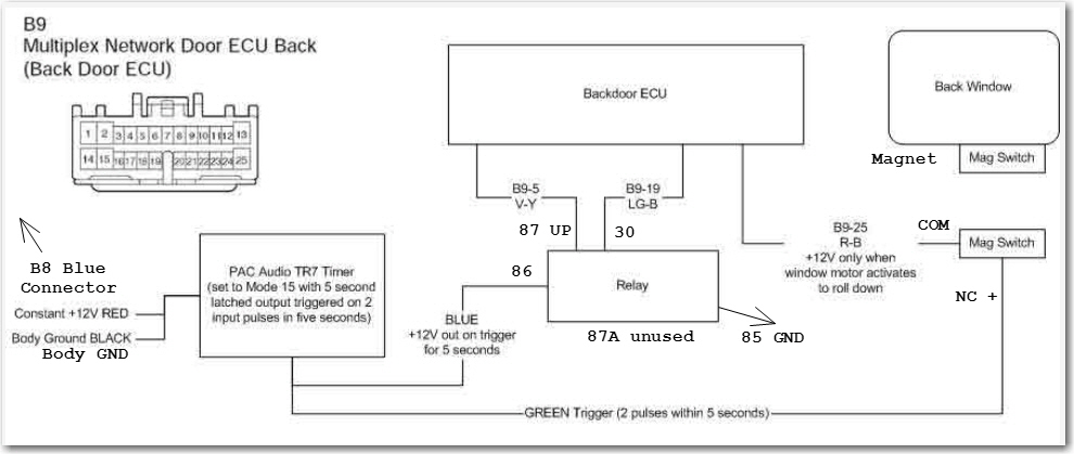

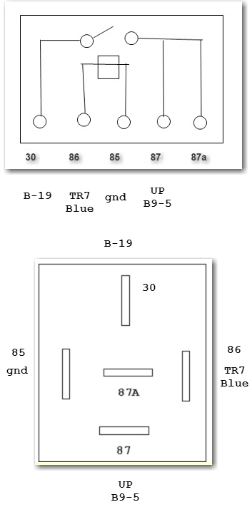

Updated Relay wiring
I had my relay connections between the ECU and the TR7 setup wrong. Here's a corrected relay layout.
Dpodo suggested powering the TR7 RED wire from #8 on blue connector, see my earlier ECU layout. thanks!
Still working on programming the TR7. Almost done !
Started on this mod and hit two snags-
1) I don't think I have an LED on my TR7 trigger. Really hard to program it without it. PAC said TR7's LED is internal next to the TR7 emblem, but I didn't see it. Need to check again. Anyone have a picture of the LED?
2) The waterproof barrier - How did you all remove it? Is it possible to carefully remove it and reapply it after finishing the mod or just cut it and tape it back up afterwards?
Thanks.
Got the trigger programmed, had to use alligator clips to make the connections.
However, when looking over things, I unplugged the B9 connector to find the wires. After reconnecting it, none of the mod in place yet, none of the back door functions worked.
Now, after disconnecting and reconnecting the battery, the keylock will lock/unlock the doors and the hatch button works, but neither the keylock nor the fob will roll the window down or up. The car beeps from the fob, but no window movement. The dash button does work though.
Anyone have any insight or help on this issue? Thanks.

Mojav stated in Post #40 that he added a momentary switch between Pins #22 and #10 on B9. You can also see that in the wiring schematic I posted above. I've seen pictures from a few people on this forum that also added a button.
Mojav, where did you mount the button?

As for the mag switch, see the diagram below and other ones from my earlier posts. good luck. drop me a line about your progress. This diagram was from my last work on this in late June...
Mojav
