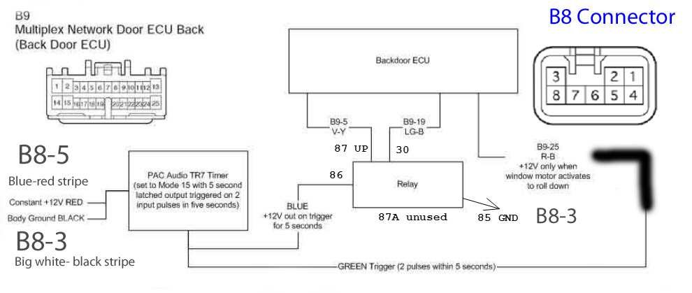

As you look at the ECU it is the connector in the lower right. Mine happens to be blue. You are looking for the blue wire with a red strip which is +12vdc. The white wire with the black stripe is the negative. Look at the last picture in this post.
YES! Thank you very much. I don't know how I missed that. That connector is blue for me too. Looking at the other pictures, then, +12v is at B8-5. Thanks again, I can't wait to try it now.

I have finally completed this mod! Thank you to everyone who helped. Ask questions if you want, I'll try to answer them. I did not use a magnetic switch, because mine didn't work, so all I can tell you is NC stands for normally closed and NO stands for normally open, which is the one you want.
I edited this diagram to show what I did and added some details.

Hey has anyone that got this mod to work run into the problem with the TR7 not giving out a 12v output on the blue wire when activated? At this point this is my only problem I'm pretty sure I programmed it correctly with the 5 second timer but I am not getting a 12V output from the blue with to turn the relay on to drive the window up. I have gotten it to work by activating the TR7 with the timer and applying my own 12V source to the relay. Any help will be greatly appreciated.
Thanks,
Leo

If the TR7 is programmed correctly, you should be able to hit the green wire with + 12 two times in 5 seconds and then the blue wire will go hot (+12) which activates the relay.
Just disconnect one of the wires from the relay to the ECU for testing so you are not messing with the actual window (but leave power to the relay). You should be able to hear the relay being activated by the TR7. If not, the TR7 isn't programmed correctly or is bad. Most likely the former. It is kind of a pain.
Thanks for the reply Asmara I tried putting +12 volts to the green wire by touching it two times to a +12 volt source then the red led in the Tr7 lite up for 5 seconds but still no 12 volt output on the blue wire to make the relay click. I have followed this direction to program my TR7:

Also another thing the only wires used in the TR7 are red for constant 12V, black for ground, Green for the two pulse signal, and blue for 12V output to the relay correct? And the rest are left alone except for the brown which is used for programming.
