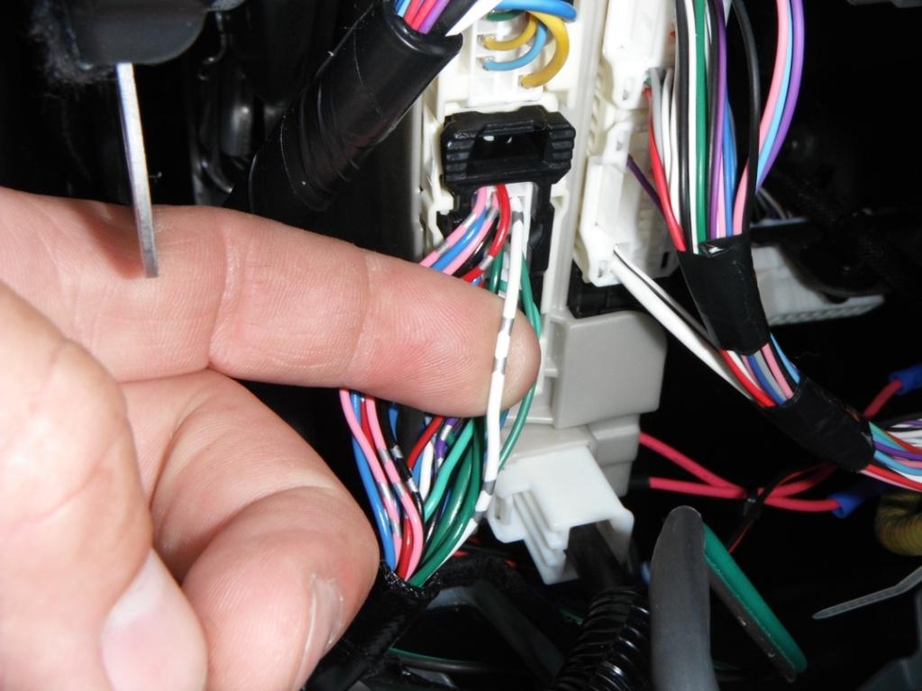

Yeah, there's a large (iirc, 8 gauge?) cable near the fuse block, left of the steering wheel.
See Antman's thread and search for Foglight rewire mod for more photos and how to get to the wiring. Here's a photo of that wire I'm talking about:
(stolen from Antman's thread noted above!)
If you look just below Jeff's finger in that photo, you can see the large black cable that has a white molex plug on it. Tying into that wire will be your only challenge, as you don't want to cut into any wiring.
Other than that, running directly to the battery is really the only other place that I'd suggest, unless your radio pulls less than 5 or 6 amps. Adding that onto any of the other constant circuits will put a load nearing the fuse for that circuit's limit. Fuses are usually about 25% higher than the circuit requires, so a 15A fuse is probably using about 10-11A, and a 5A+ cb will probably pop that circuit.
