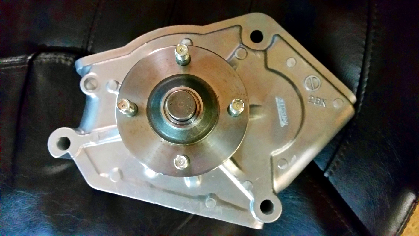

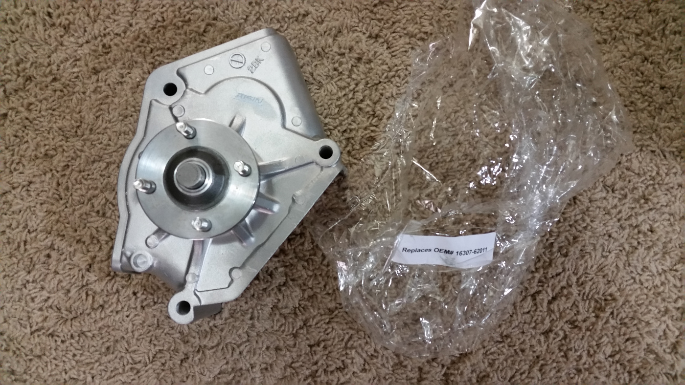

I watch my parts VERY close and out of the last 40-50 or so I have received authentic items. But tonight I got bit in the ass. Thank goodness I know parts...
Purchased a FBT-004 Fan idler for my 02 3rd gen from the ebay. Taking this one to the moon and back as this is killing my engine work for a week in which I took a day off extra to complete.
Seller claims authentic aisin and they have a direct aisin rep - but will not give me his name!
- Received idler in a generic plastic baggy marked "replaces OEM 16307-62011"
- Aisin logo not even attempted to be faked properly! Looks like whiteout with a stamp
- Metal feels like it was made from recycled tinfoil and beer cans
- Lots of gouges, scratches and such on the part
About the only decent part of the unit was the bearing is stamped koyo but that is probably a fake too HAA!
Ah well, took a gamble at almost $55 less than the price of a real aisin. At least ebay should enforce its policy on the return as I filed as a counterfeit item / requested a return and also emailed Aisin with photos.
I am with ya man - DOWN WITH THE COUNTERFEIT CAR PART SELLERS!
I received a call from Aisin which confirmed the above is in fact counterfeit / at least they have NEVER used a sloppy white paint logo on anything they have ever made according to a gentleman named Brad.
Aisin was totally awesome about it - sent me a brand new replacement and requested the counterfeit item be shipped to them. Ebay seller wanted it back but they are not getting it / likely they will be contacted by some legal department at Aisin.
It is possible they have no idea they are selling a counterfeit item and are totally innocent... which sucks for them... but the fact is they never denied it was counterfeit when I told them it was, just apologized for the quality issue and requested the part be returned. :lie: :clap2:
