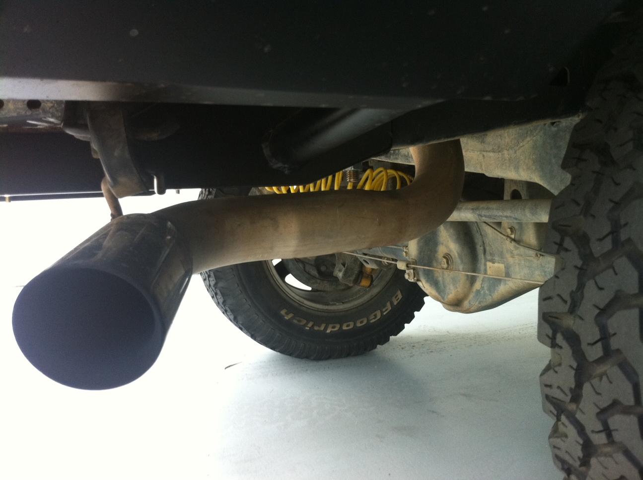

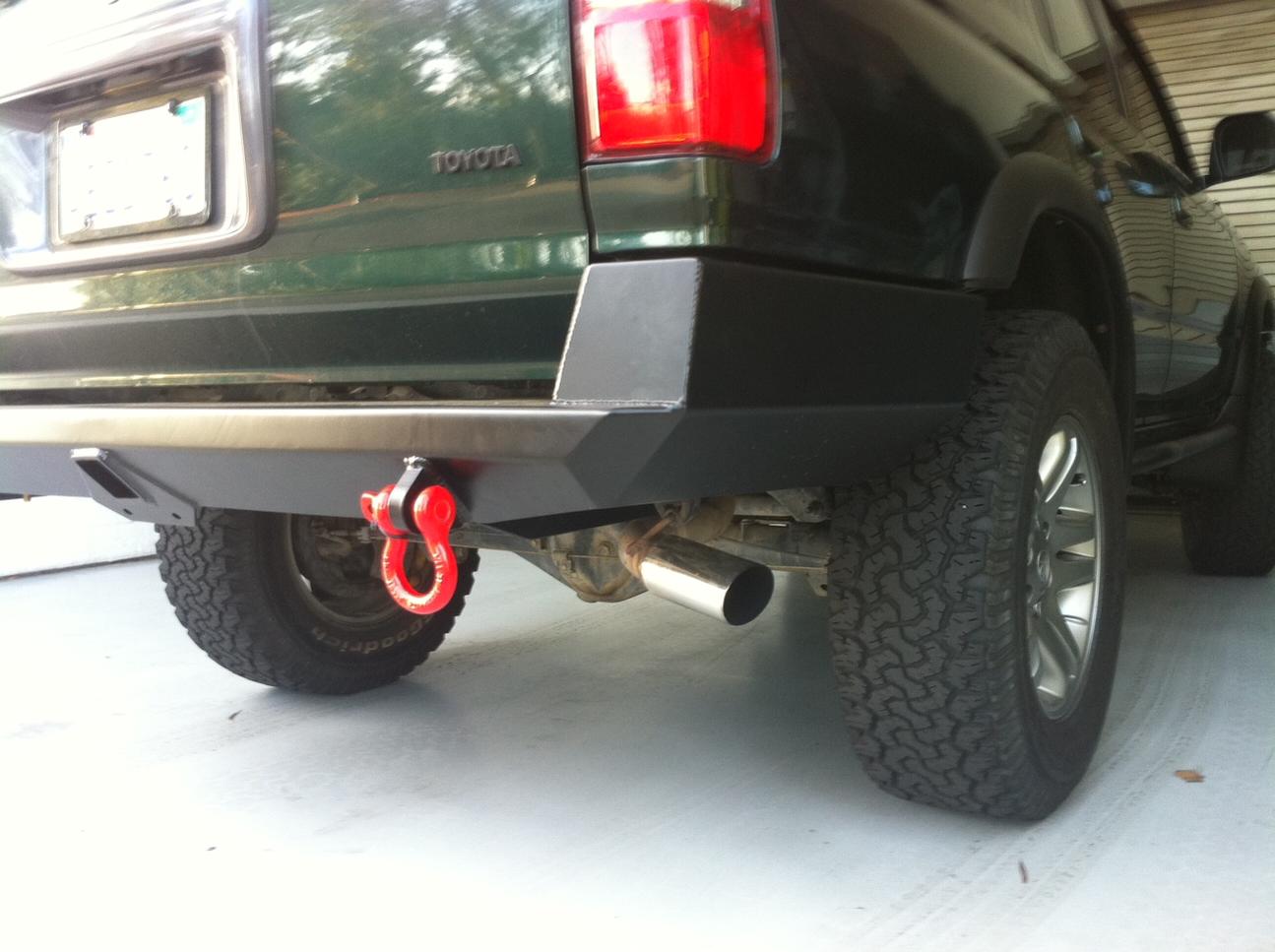

I love the bumper, I just don't like how much lower the exhuast looks.
I am getting annoyed with it too. The angle is off... so when the back window is down, I can really get a lot of exhaust smell. I gotta see what I can do.
I hacked mine off..
I don't smell it and you can't really see it unless you're under the truck..
I did think of that... but I don't know, I like the exhaust pipe showing... I would hate to waste the money I paid for the tip by just cutting it off. I am all for re-angling it, though.
I just went outside and took a few pics, it appears that the exhaust is about as high as it can get without completely eliminating it.
The exhaust cutout option was cool on the CBI, but brian mentioned it would require cutting the body.
Looks like the exhaust is staying put.

Don't hack it! I hate mine cause mine is to dang loud sometimes!
It didn't make mine any louder, it's still post muffler.
may i suggest hack it to move up to the mid area right b4 the tire
You'd have to do a turn down exhaust (tailpipe angle at the ground) so it doesn't blow straight on your axle and heat it up. This could be bad for fumes and it could blow dirt and dust up if your sitting there idling. I hacked mine where I did because it still has just enough of a curve to blow it out the side and the back. I've never smelled it inside the truck unless I have the rear window all the way open and I'm parked for a while.
i was thinking having the exhaust pipe sticking out under the pass door and in front of the tire kinda like gohidetheasian's old runner
Hah that's cool and all, but I've got sliders there. The routing process would be redundant and most likely costly.
I guess if I end up going this route, I will have to do this. It's cool to do on a dedicated trail rig like yours. If anything, I was thinking of getting a longer tip and angle the pipe just a bit more up so the exhaust sits high up and far enough to the side.
Now that my engine's rebuilt and the Honda is sold, the 4runner is back out retirement and my DD again. Another option is to do what Proudrunner did and have someone make your tailpipe go over the frame and angle downwards (right behind the bumper). Kinda hard to explain, but see if you can have Proud take a pic of his exhaust for you.
