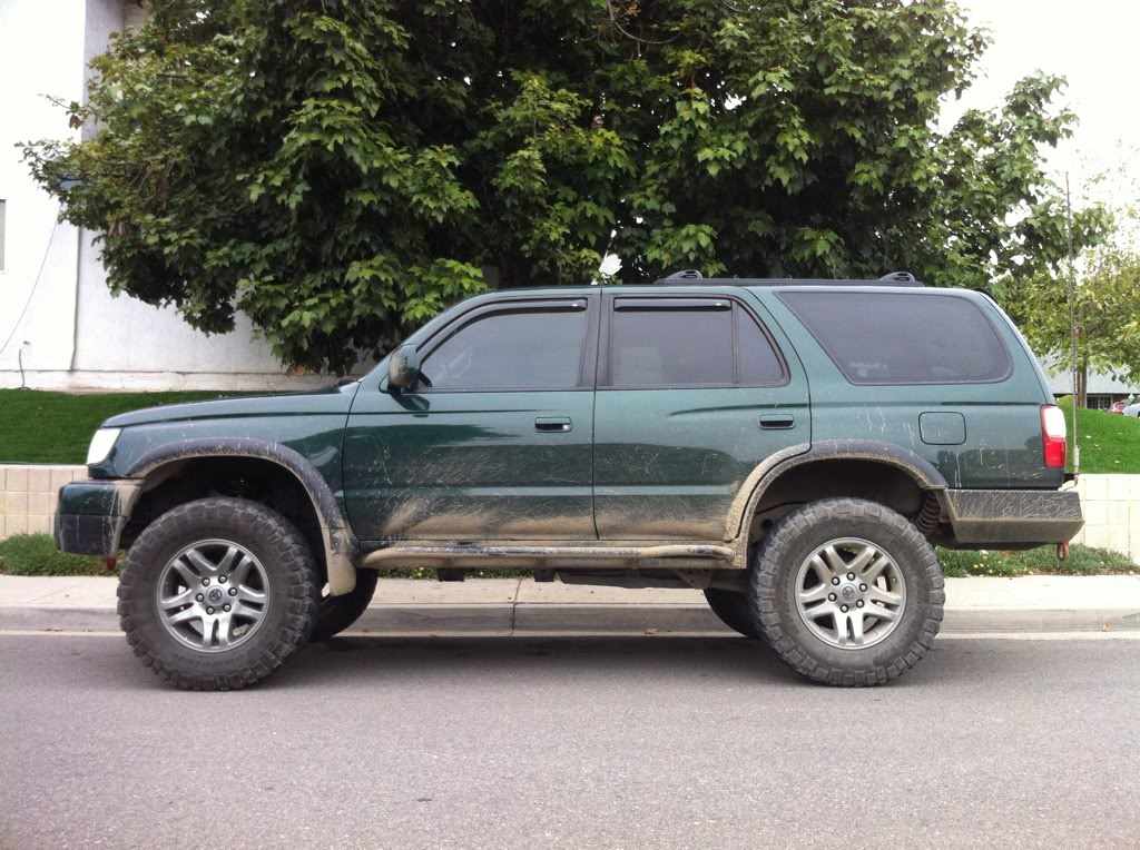

That trim paint makes a big difference. I'm thinking I'll use that on my flares and valence of the front bumper. When you did the window trim did you just mask it all off? or remove it somehow?
I removed them all and painted them over a sheet of cardboard. They're a pain in the ass to take off, especially the back one.
i have been wanting to paint my trim pieces soo bad and im glad you found the right paint! Dou think that stuff would work on my stock roof rack? would i have to sand it down and prime it? I dont know much about painting parts.
I would use it on my rack if I had enough, but I wouldn't expect it to hold up against anything crazy. You can sand and prime if you desire.

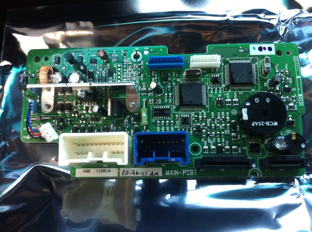

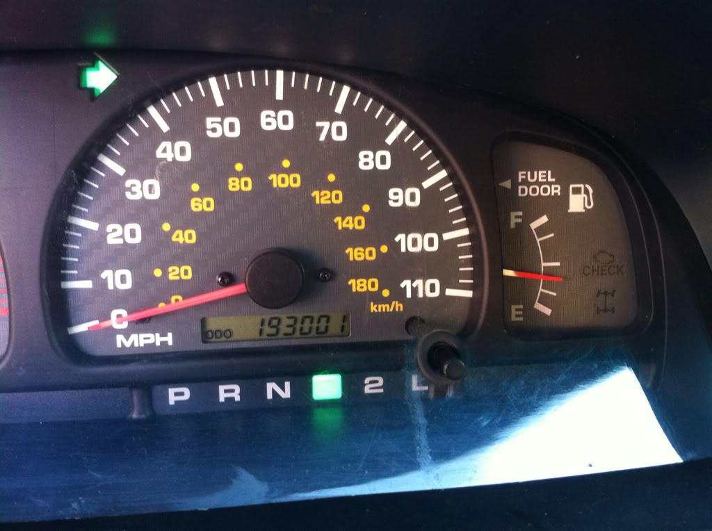

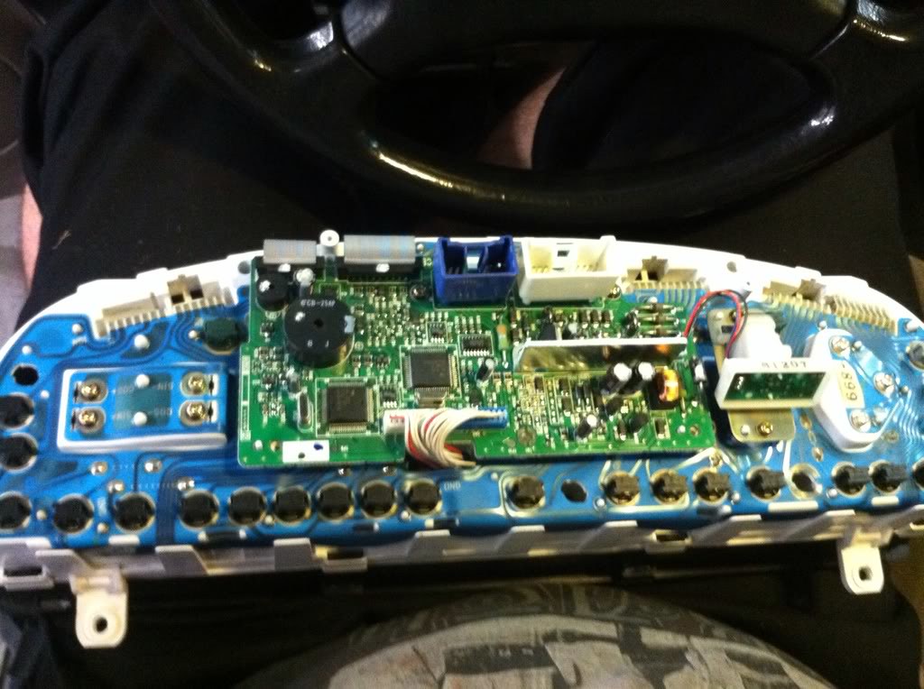

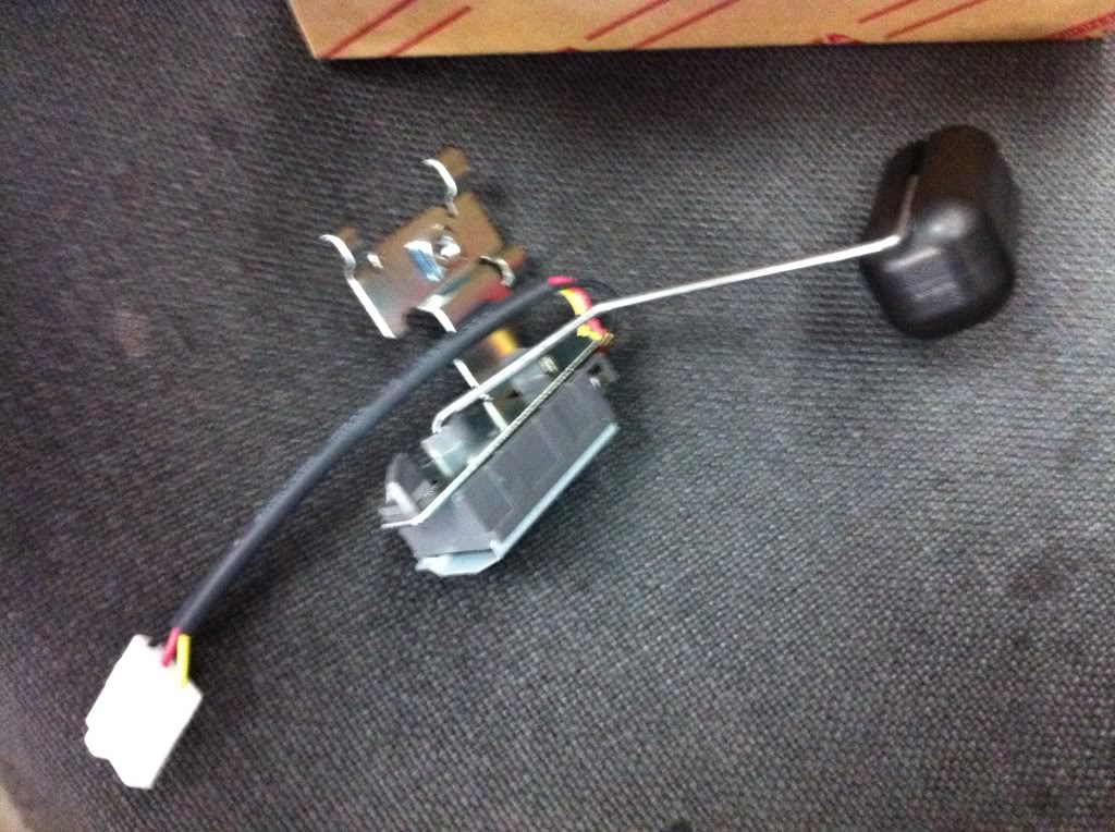

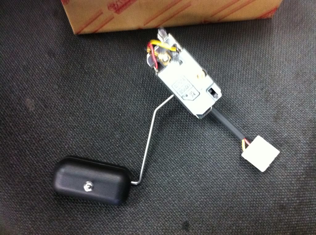

My gas gauge died. 1999 and 2000 years have a TSB for bad fuel sender units and a revised motherboard for the back of the gauge cluster.
New sender:

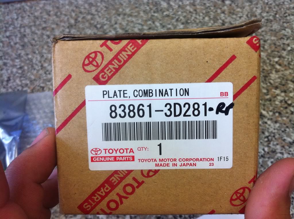

Gauge Motherboard (special order from Toyota, $50 with 0 miles on the ODO or $130 for your mileage)
Old motherboard on back of cluster:
Instructions for reprogramming:
New mileage (I asked for 193,001)

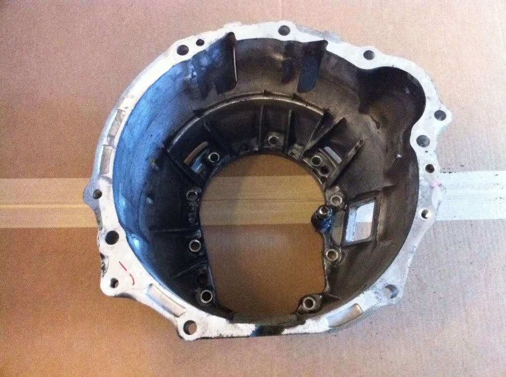

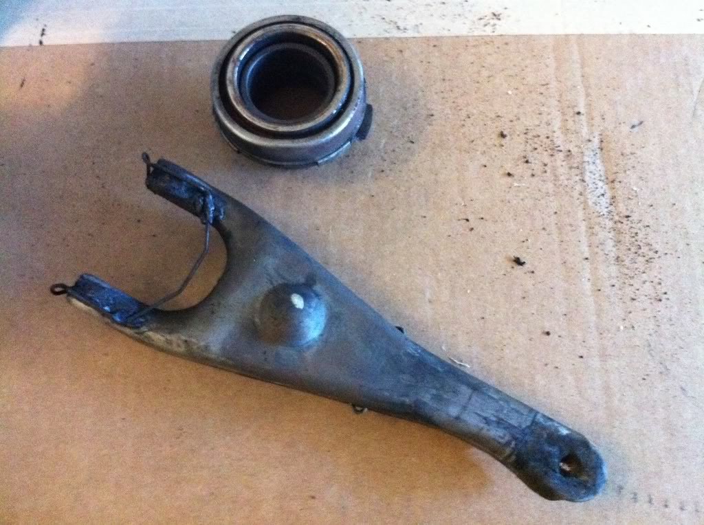

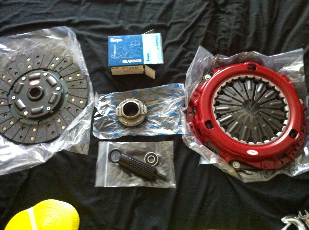

These few items are the next direction this truck is heading. Awfully silly to buy a clutch for an automatic 4Runner...
.... a bell housing....
...clutch fork...

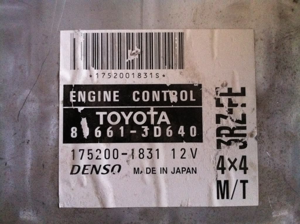

and 3RZ 4WD M/T ECU....

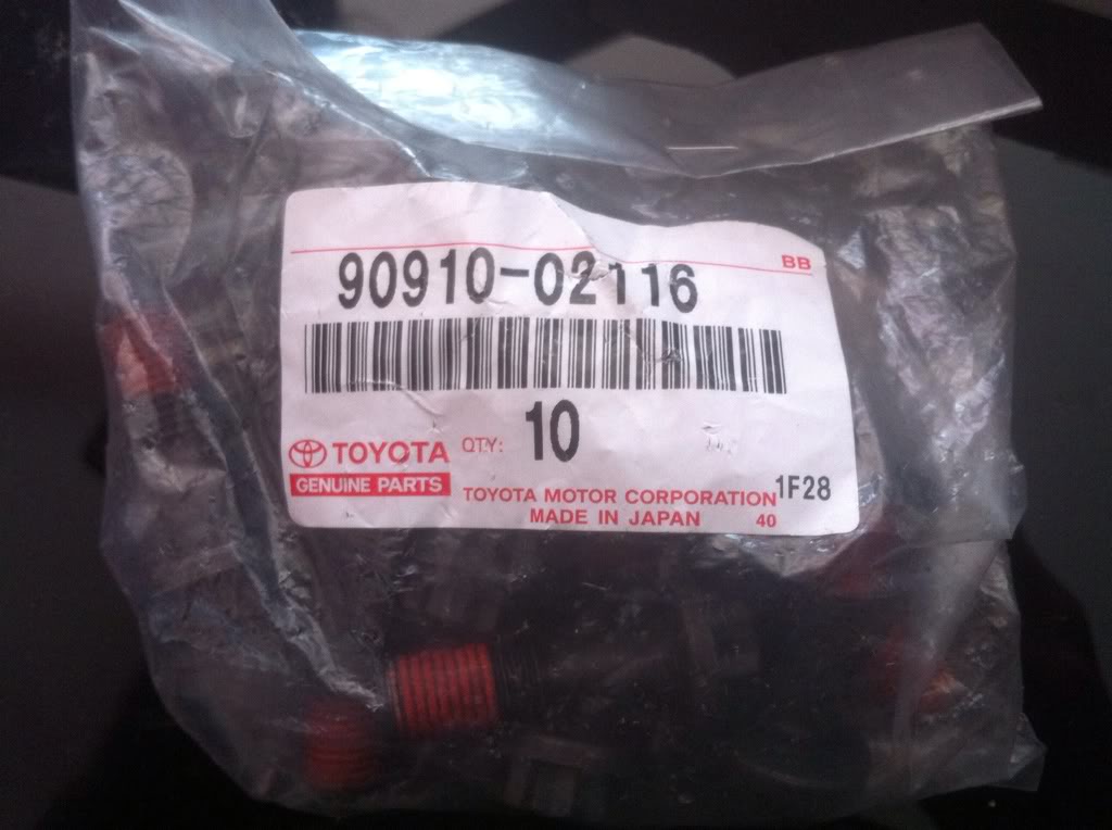

... bolts for a flywheel...

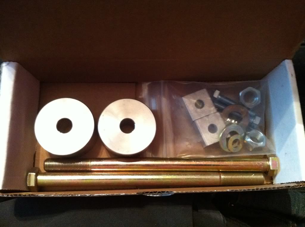

... a front diff drop for a 2WD? What's next, a 4WD emblem?
... yes, of course.

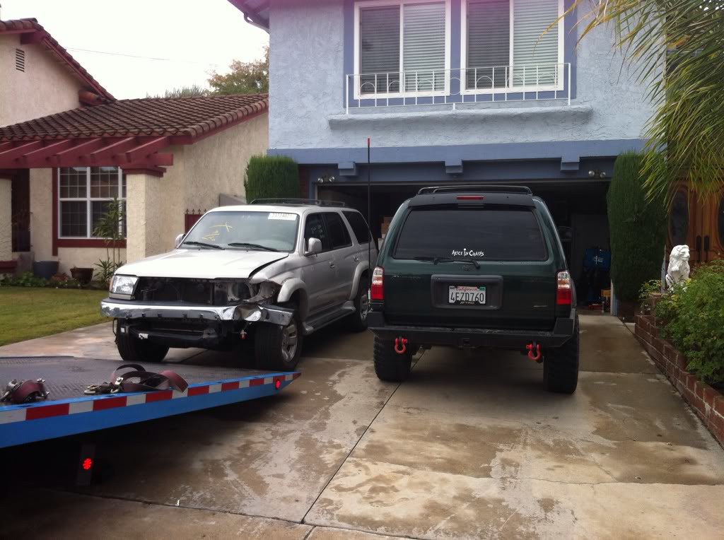

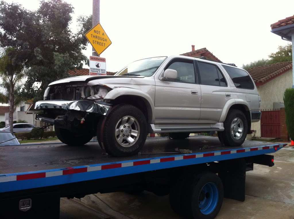

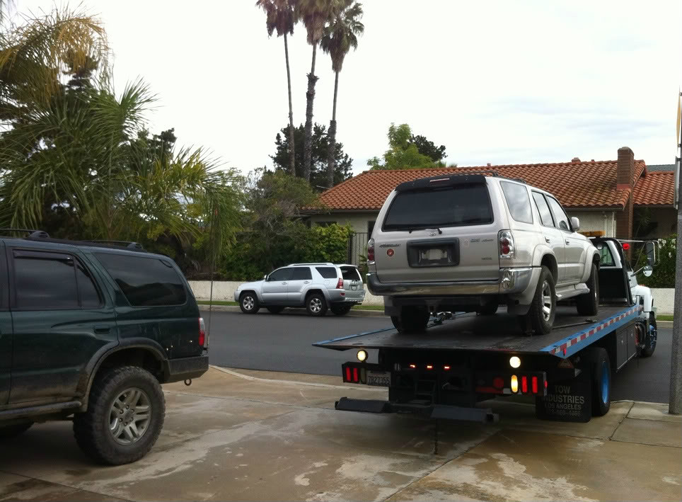

3 4Runners in the family now, newest being this 2000 SR5 4x4 5 speed DONOR TRUCK with horrific tail lights!

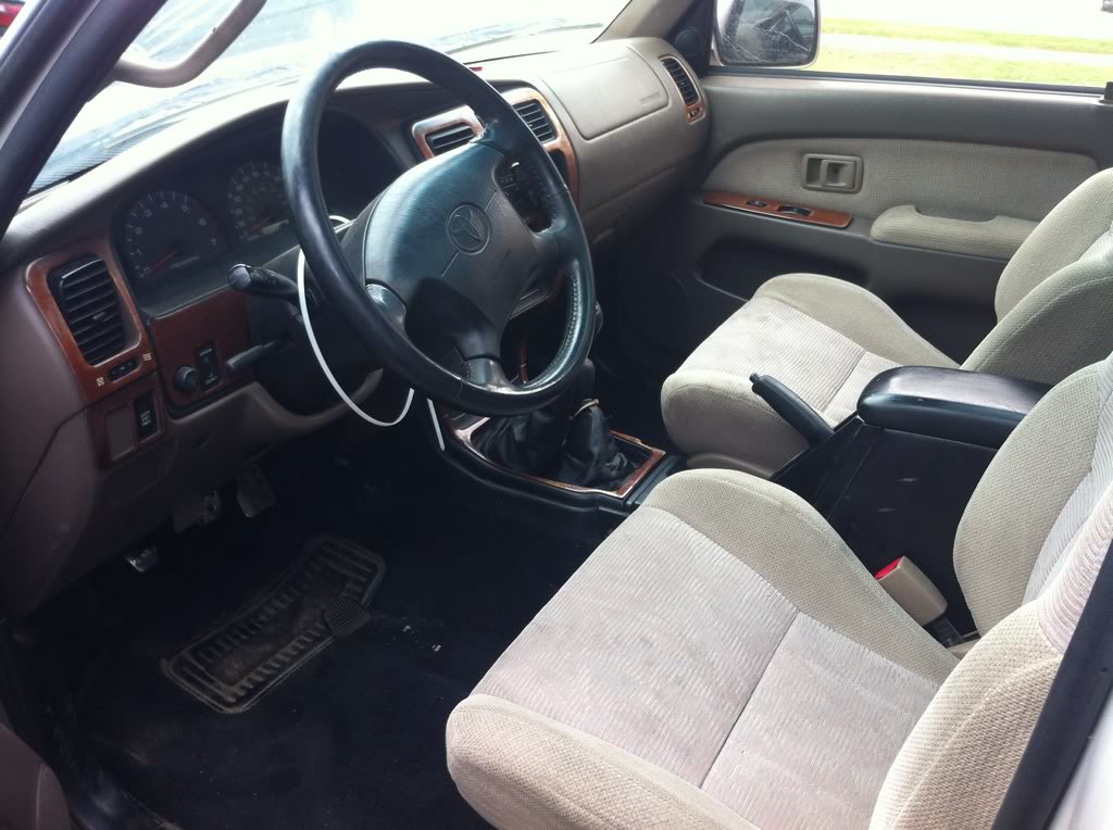

Previous owner tried to make the interior black...
Hehe... looks like I've got all of my 4x4 swap parts...

^ Like I said, Vultures are always out and lookin' :lol: Congrats on the purchase my man!!!! :happy bda

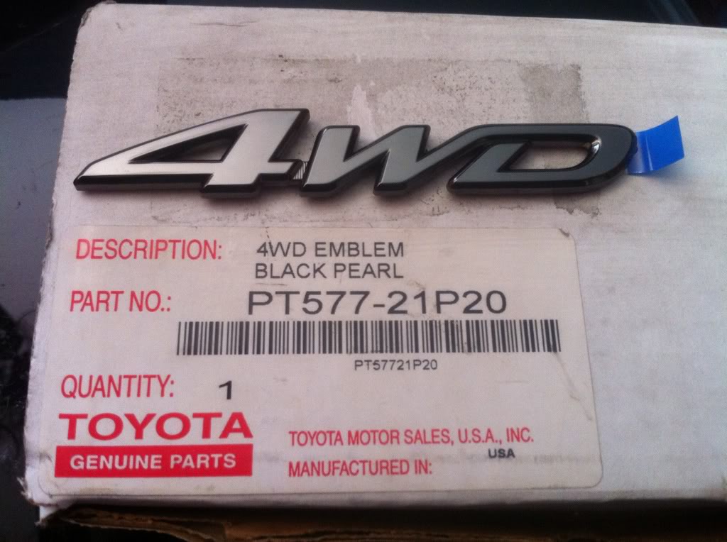

dude how the hell do you keep finding these black pearl emblems? congrats though man! these is going to be EPIC!
The 4WD one was actually available from Toyota. There's still a couple left in their warehouse.

Tonight, I'll probably take out the horns and swap the seats. I wanna get a good look at the black carpet, it might be nice enough to swap into mine.
Definitely gonna swap the rear heat into my 4Runner.
AHHHH solid find bro! congrats! and here come the vultures, haha i am definently interested in the flares, if and when youre ready, can i call 2nd in line behind The97Runner?? schweet!!
are you gonna do all the fab work ur self?
The only fab required is a transmission mount. Gonna have to find someone to weld that.
The driveshafts will be correctly lengthened or shortened by a driveline place by my house.
Thats all really...
Thanks dude, yeah, the vultures are good though, I need to cover costs. You'll be second in line. Please be aware that the front left bumper mounted piece is missing. The front left also has a little scuffing from whatever collision it was involved in.
