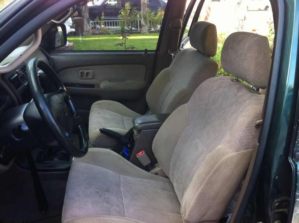

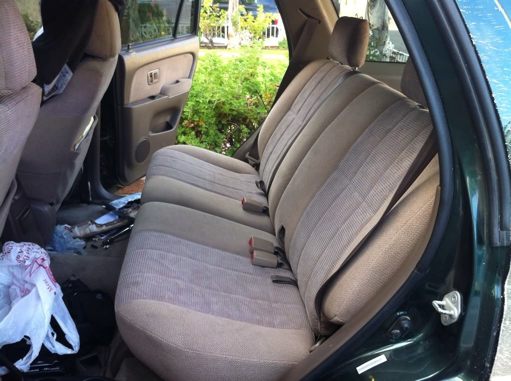

Swapped seats out. My 4Runner now has a matching set of SR5 seats. My old setup was 1997 SR5 front seats and 1999 base model rear seats.

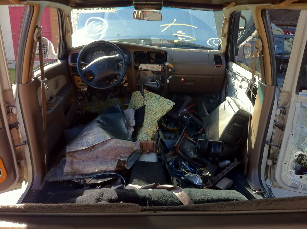

As far as the donor goes, I removed the front bumper and straightened out the bent up brackets that were rubbing on the tire. The interior came apart next, including the seats (as shown earlier, installed in my 99), the carpet, panels, center console, and audio system. The guy who used to own this thing lined the floor with ROOFING SHINGLES as sound deadening. There was a lot of sweet audio stuff, a set of front Blaupunkt components, small infinity rears, RCA's, 5 tons of thick gauge wire, and some cool thick ground wires. I only wish he left the amps... I'm going to leave the rest of the disassembly until after the conversion is completed.

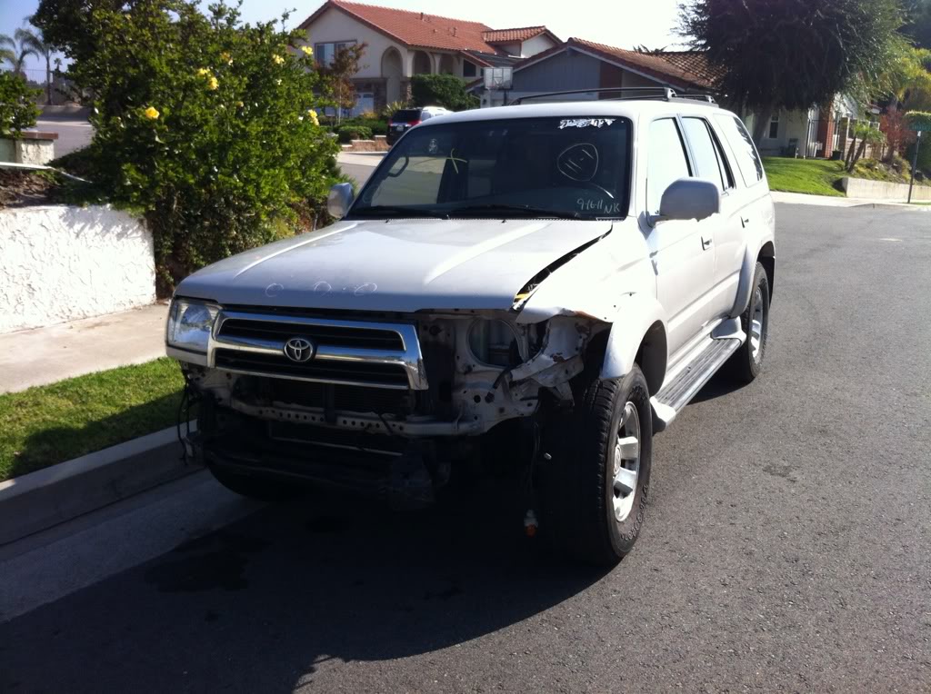

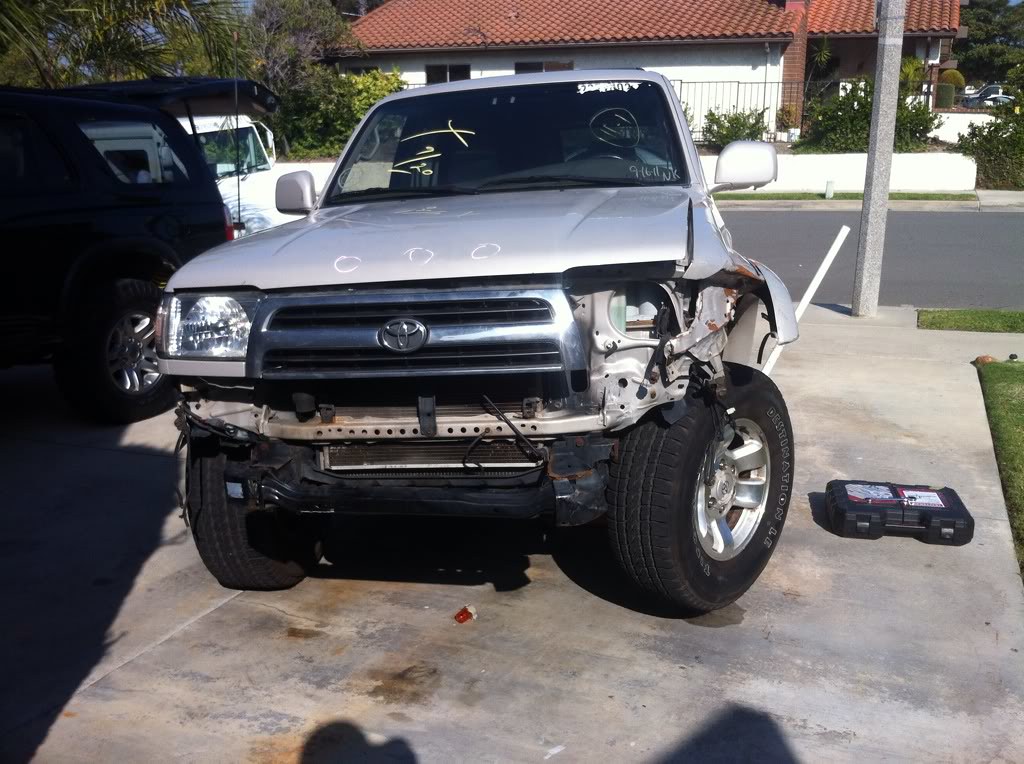

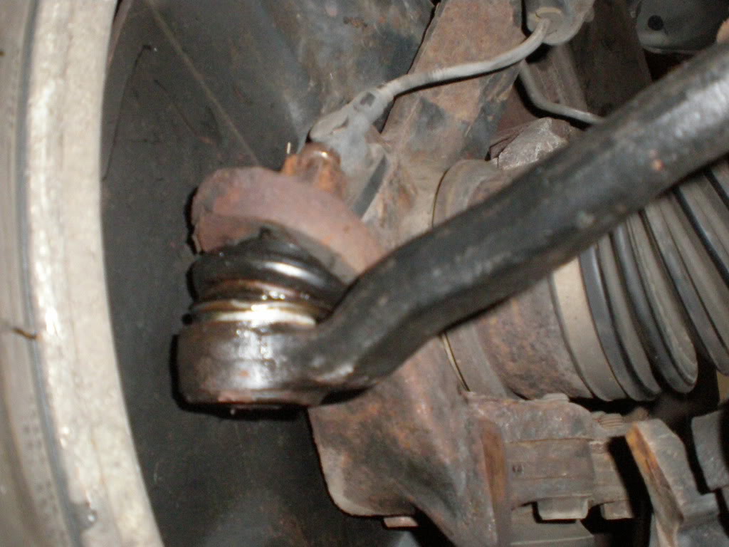

I got the donor truck from an auto auction called Copart. This 4Runner was shown as not running and driving. In the photographs, I could tell the front wheels were not pointed the same direction, leading me to believe there was a tie rod failure, and that the truck would run and drive other than that one issue. The truck showed up on the tow truck to my house, sure enough, the tie rod had just popped clean apart. I removed it and John, the shop owner, used his 30 ton hydraulic press to bend it back. He then pressed the ball back into its socket. After reinstalling the tie rod, I drove the manual transmission donor 4Runner down to his shop from my house. The clutch was slipping with light acceleration, original at 170k. A video is posted below.
Tie rod removal:
Back in place and ready to go:
On the road with tie rod installed.

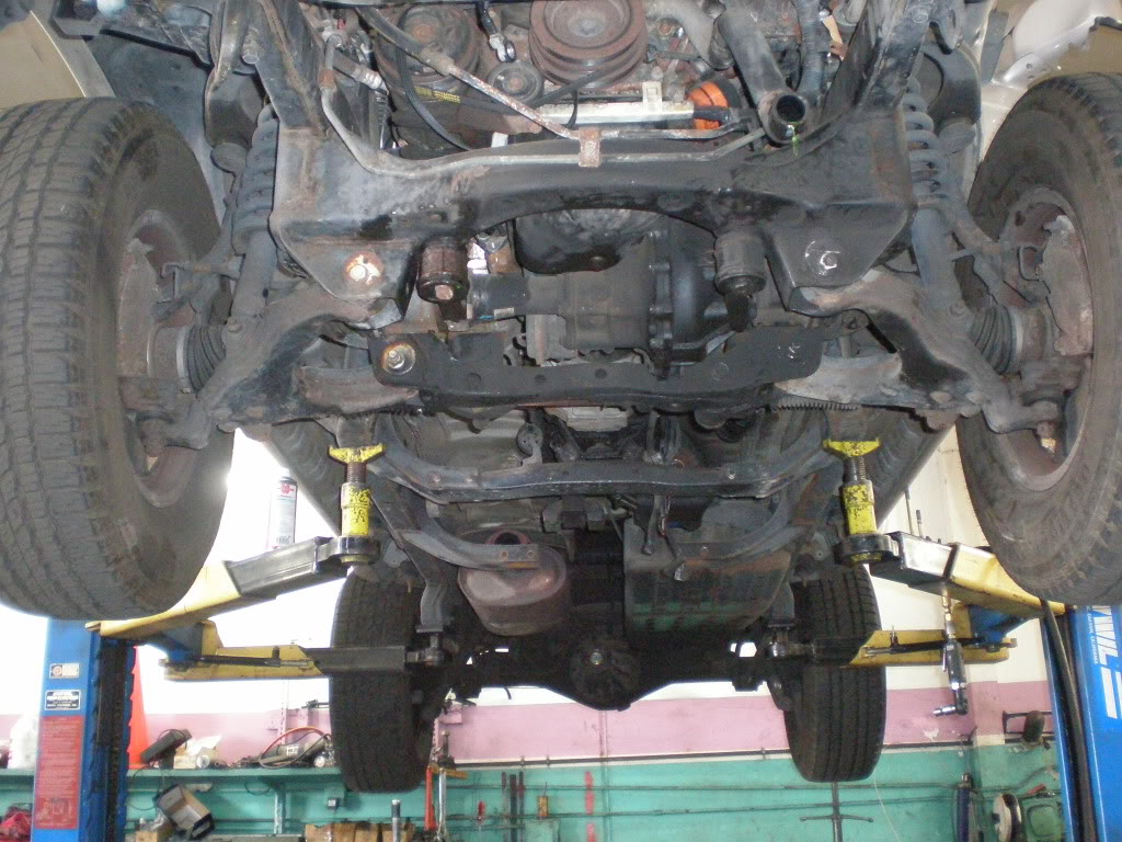

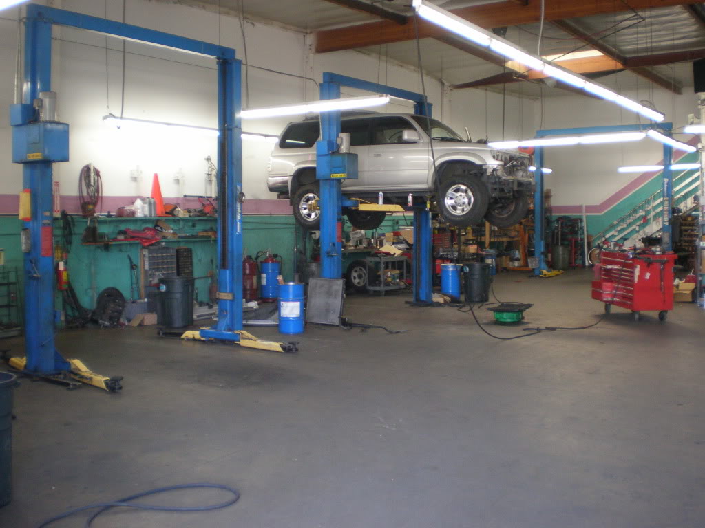

The donor went up in the air. First call to duty is removing the engine and transmission.

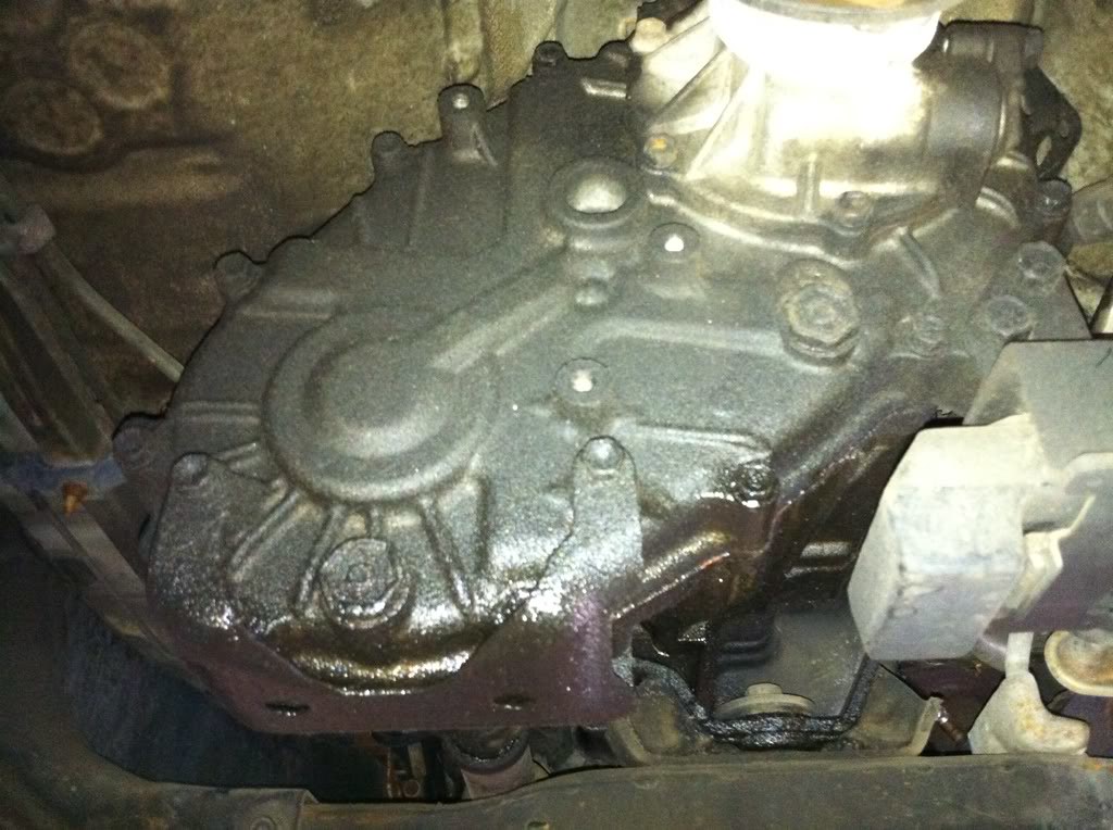

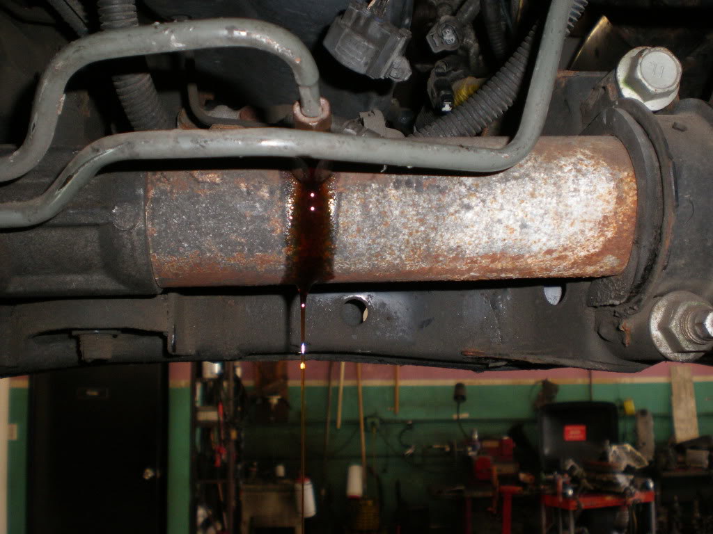

The undercarriage is not badly rusted. There's some slight leaking from the shifter seals on both the transmission and transfer case. The rear axle seals are blown, one of the shocks broke from the top mount, and there's a bit of rust on the exhaust. The parts I need will be fine to use. The leaks will be simple to fix when the transmission is out.

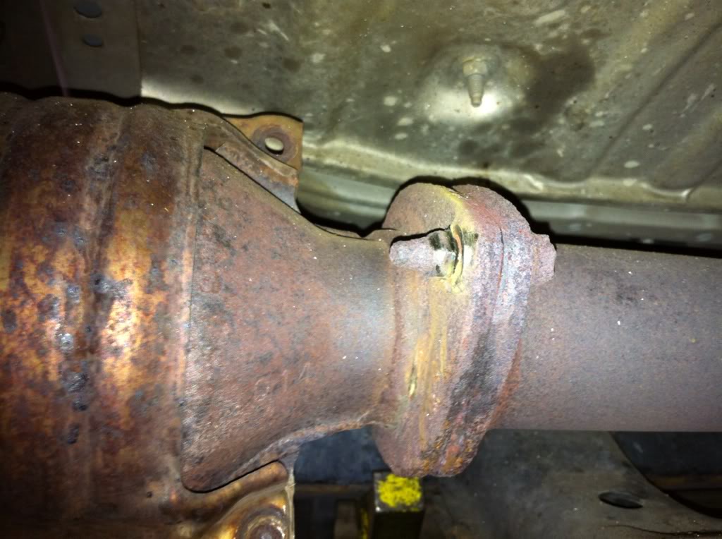

The exhaust rust is bad enough that the bolts had become one with the cat. Angle grinder time.

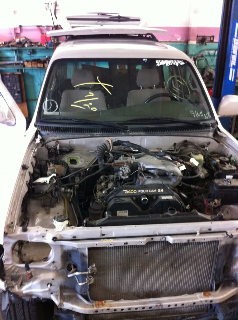

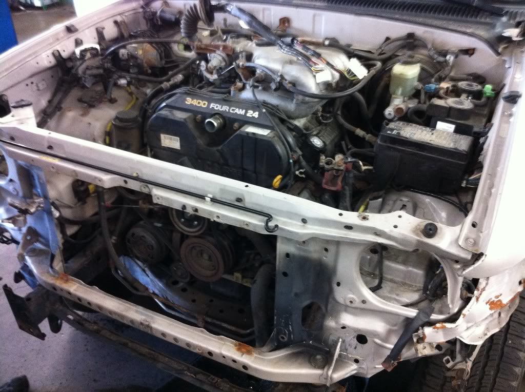

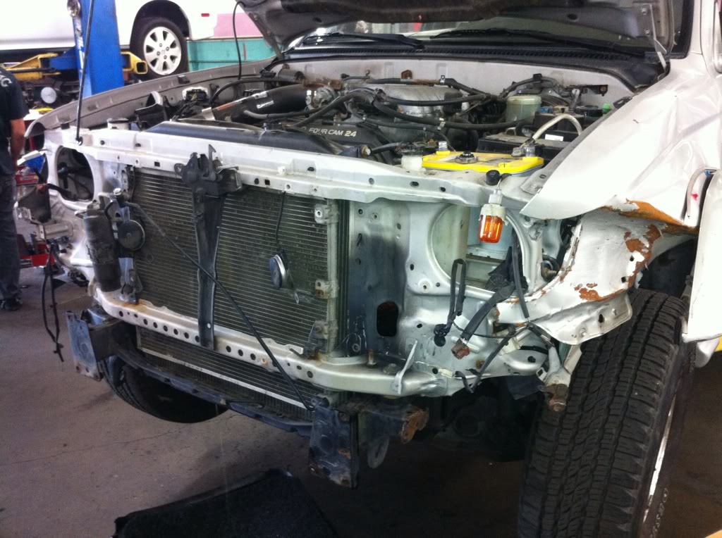

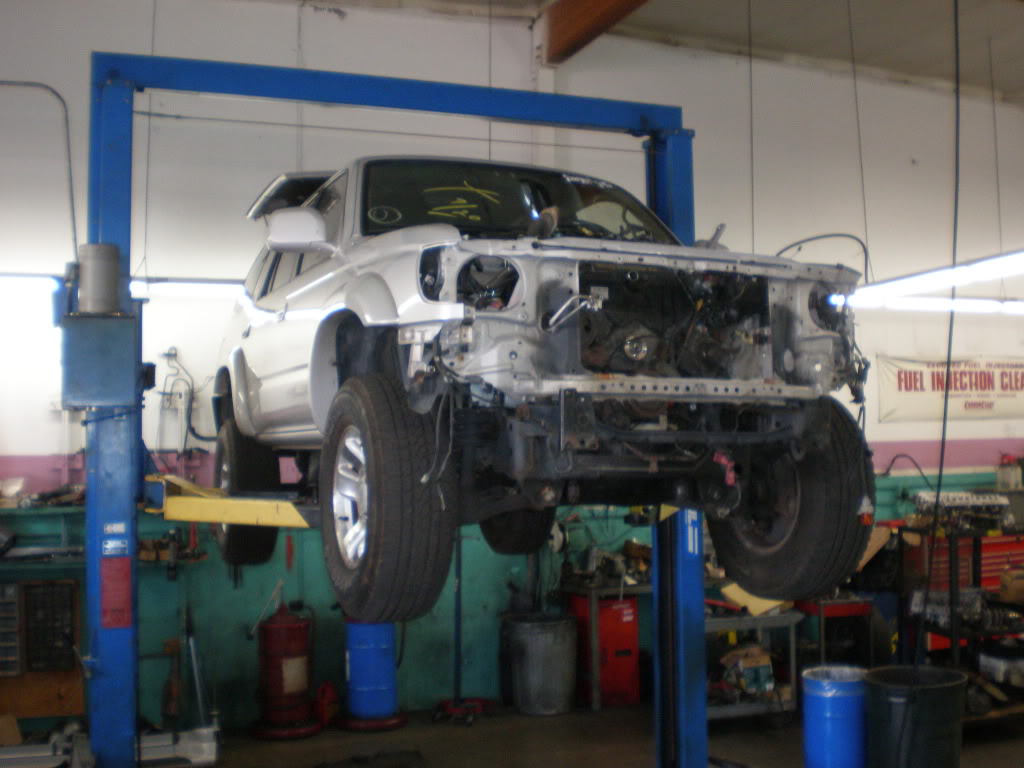

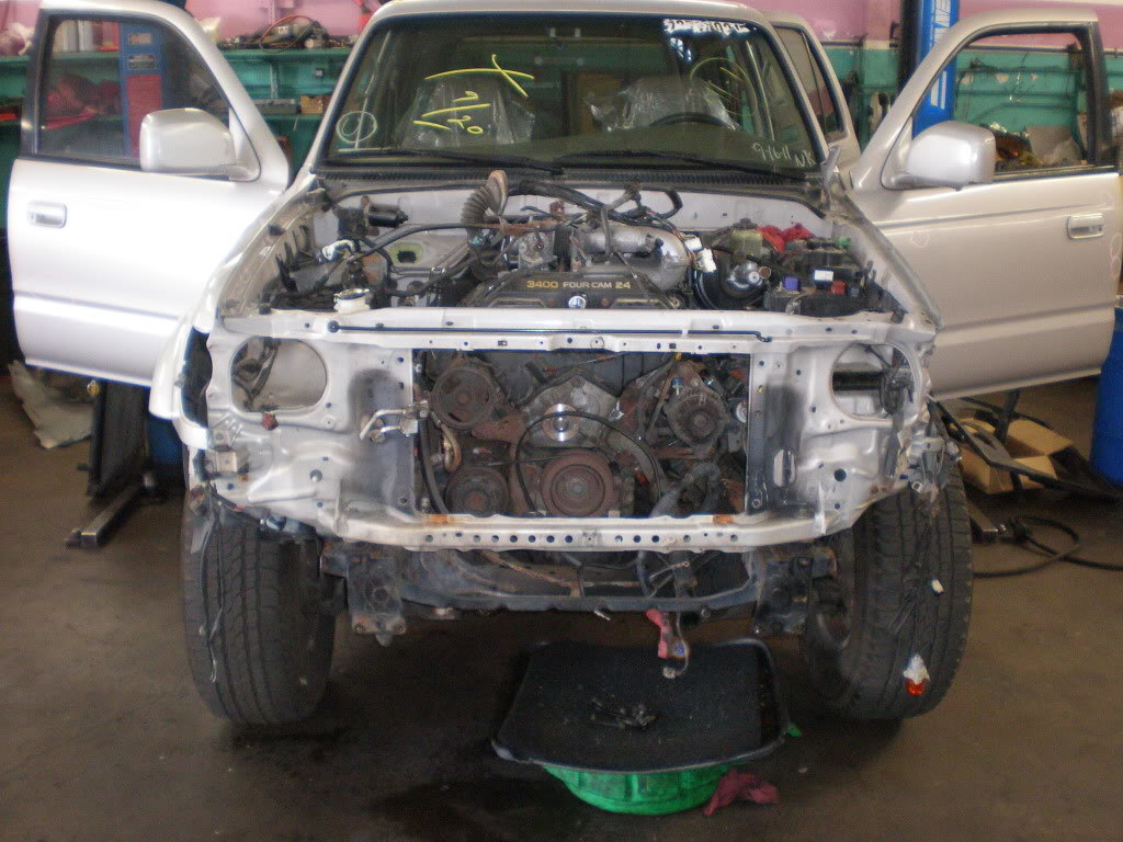

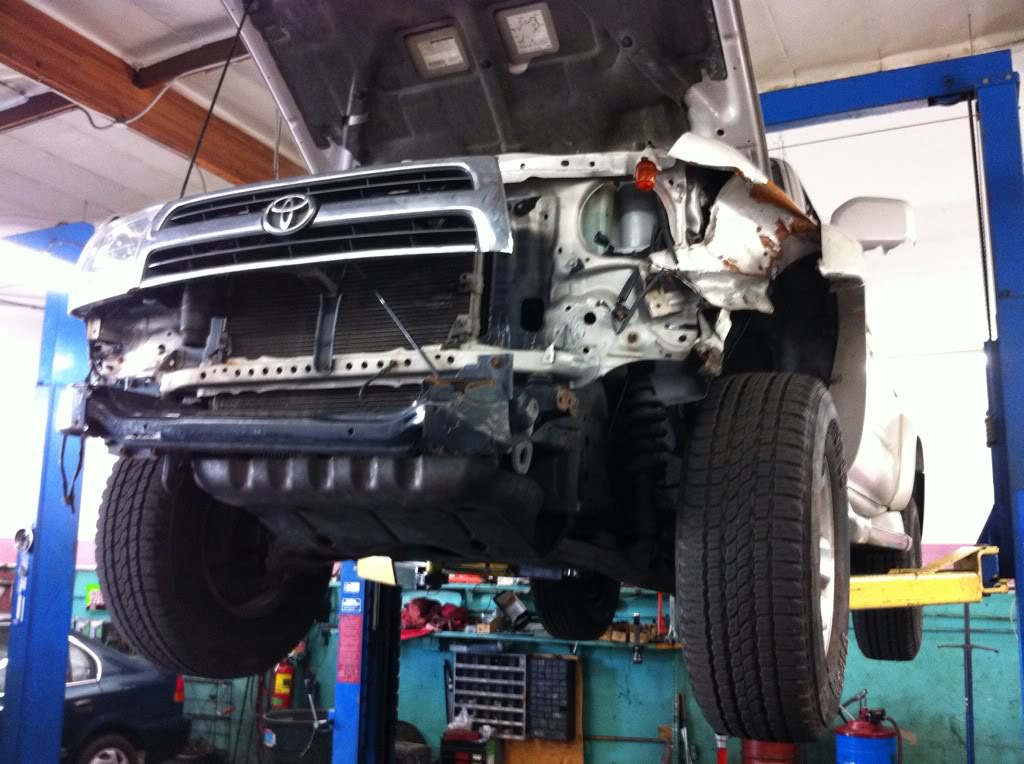

Starting out with stripping the core support area - this truck is never hitting the road ever again.

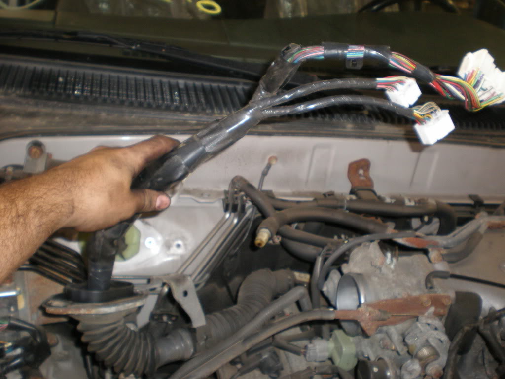

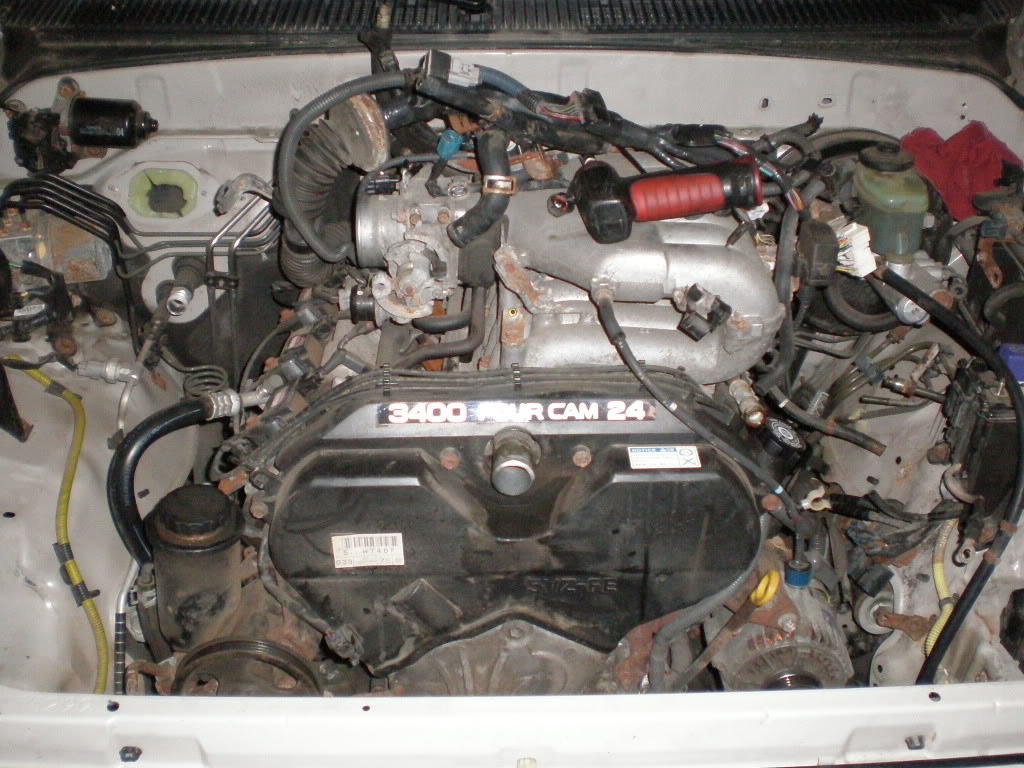

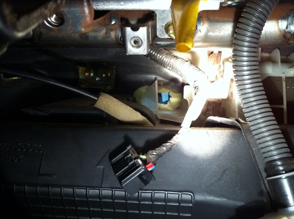

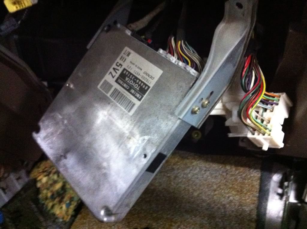

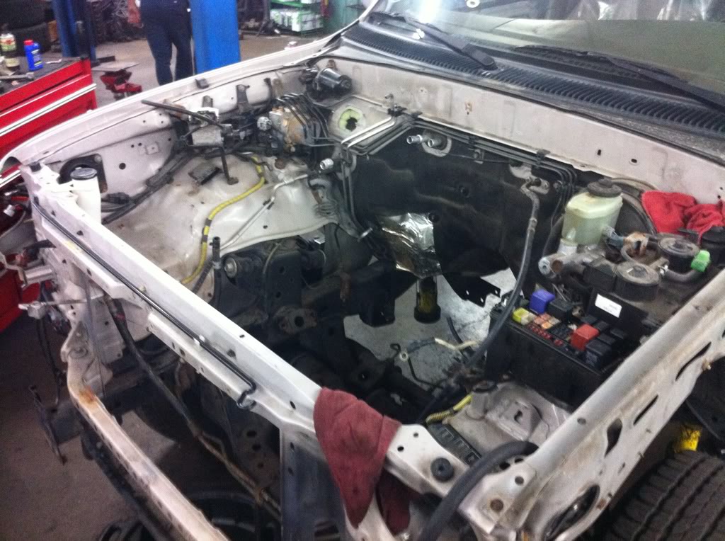

Removed the ECU to get the engine wire harness out. This will allow for the motor to come out with the harness still attached, which is good because the intake manifold and accessories can stay in place.

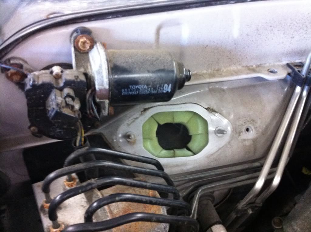

The wires go straight out into the engine bay, much easier to take them through the firewall than to remove the wiring from the motor.
A lot of the bolts and studs broke because of rust. It's led to a lot of wasted time on things that should have been quick. I'm thankful we have no salt on our roads here. This is after pulling the radiator and getting the engine ready to pull, with the exception of the bell housing bolts.

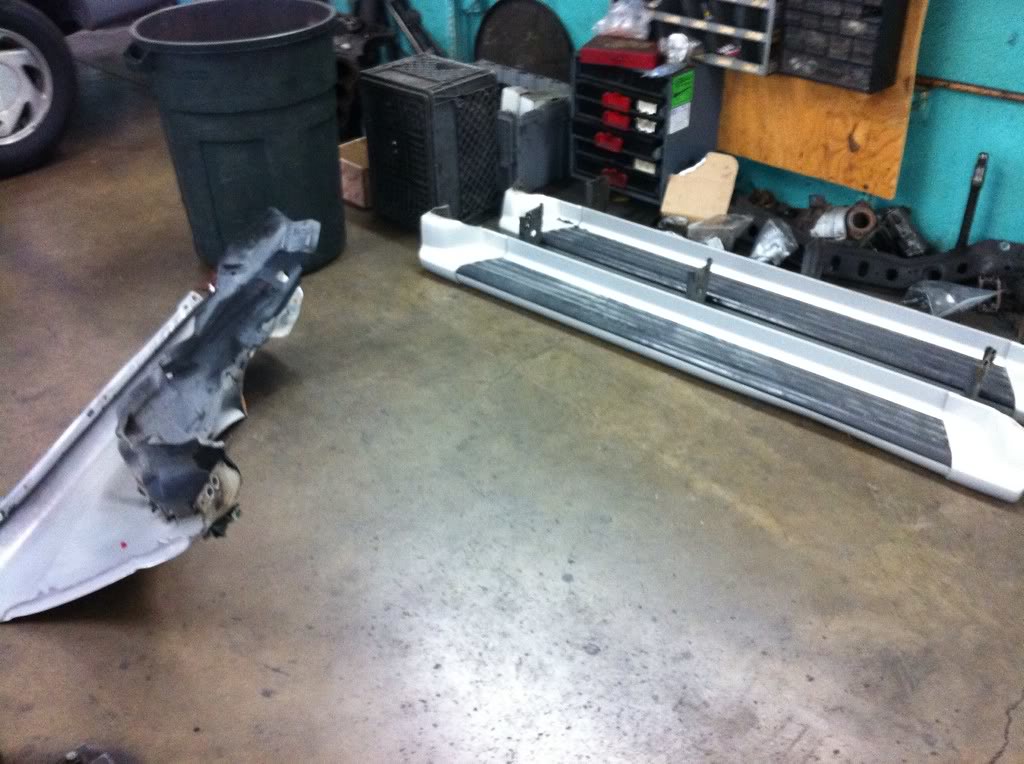

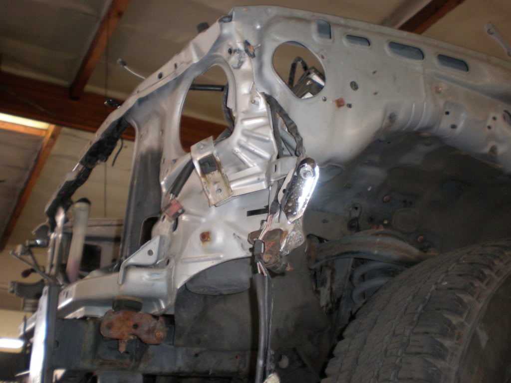

I needed to remove the damaged fender, which meant removing the running board to get access to the lower bolts. Ended up just pulling both off. Air tools are nice.

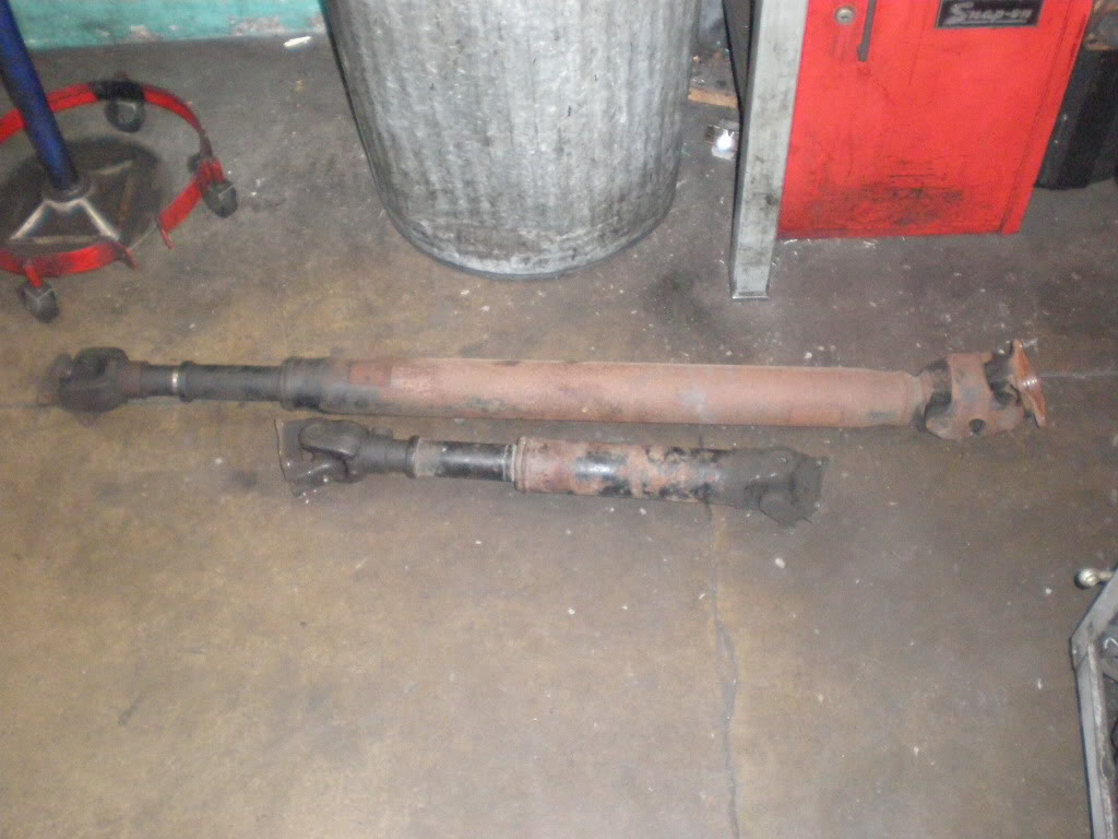

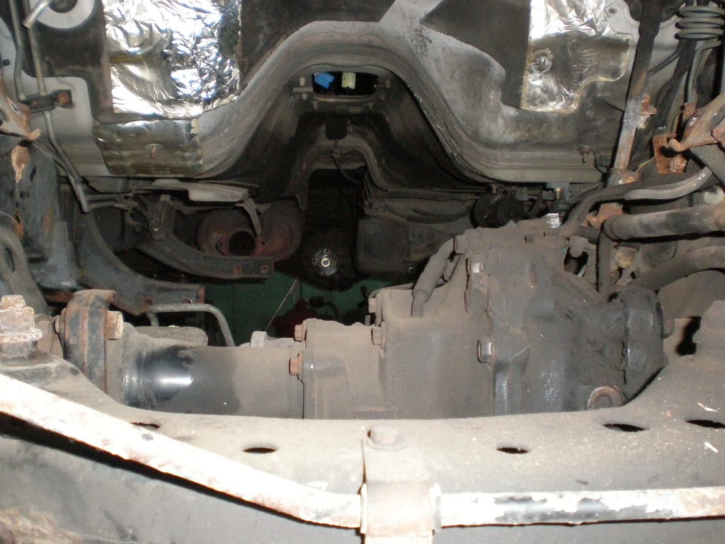

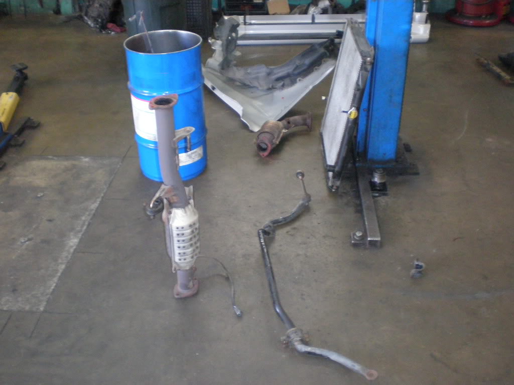

Removed the rust-fused exhaust and CA catalytic converters. Next to come out were the driveshafts, transmission crossmember, and front sway bar:

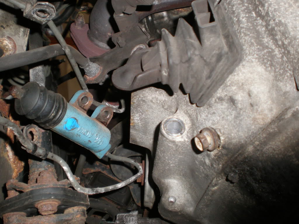

Slave cylinder unbolted:

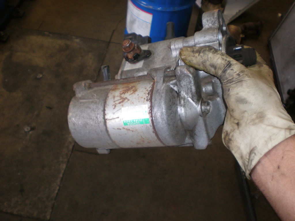

Here's the starter out as the bell housing bolts were removed:

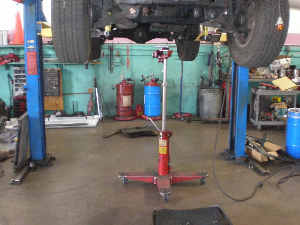

continued:

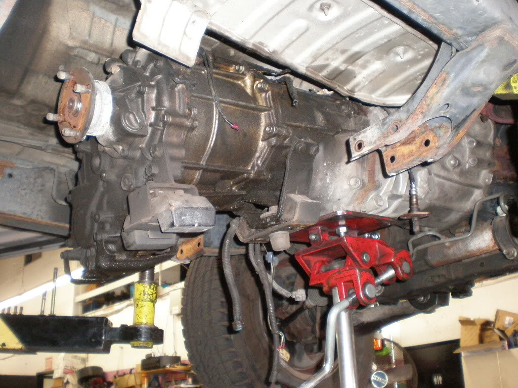

Jack in place

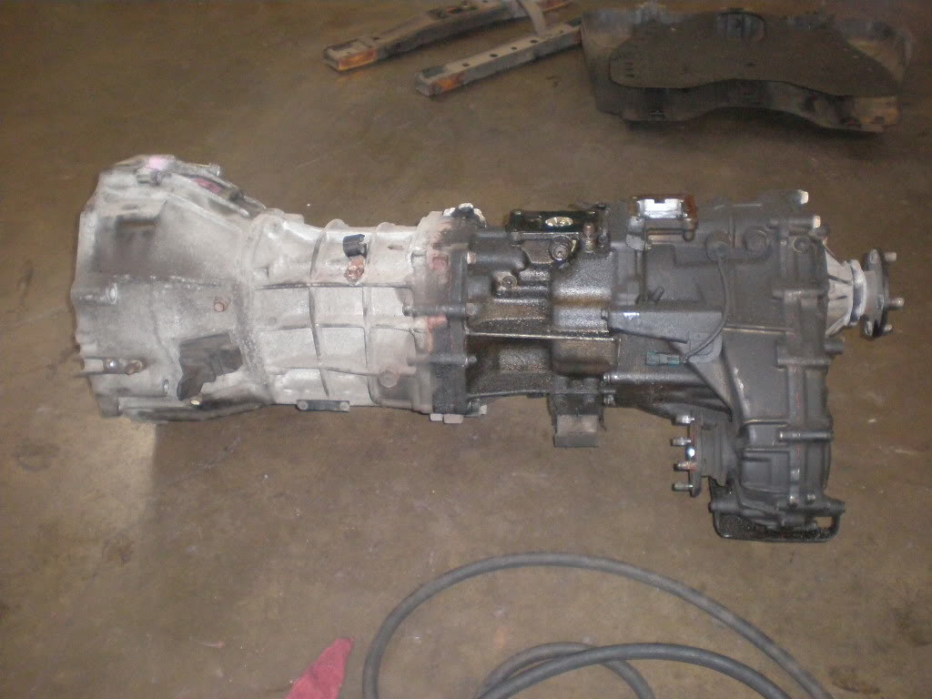

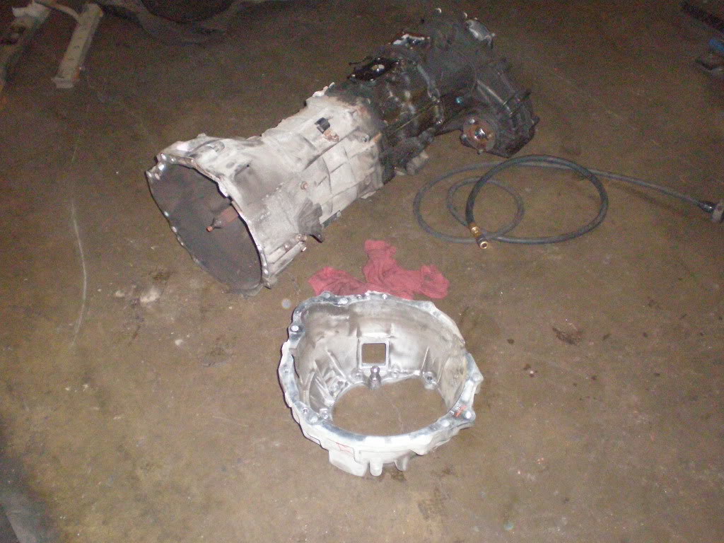

R150F coming out. A little wiggling and it slides out.

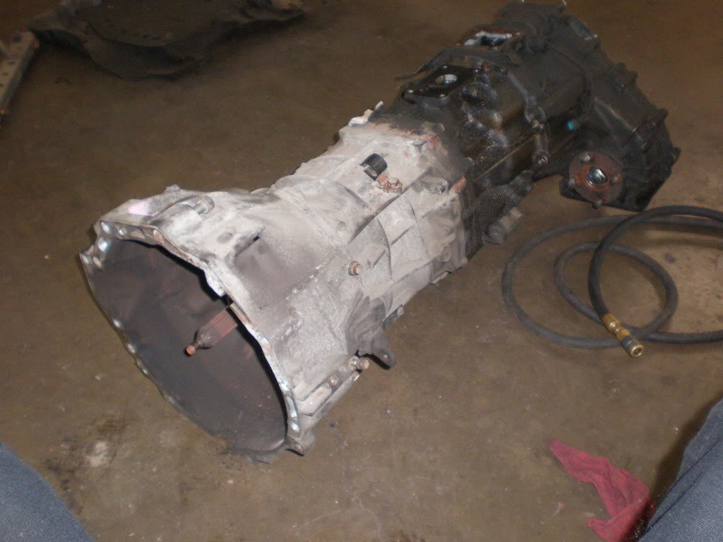

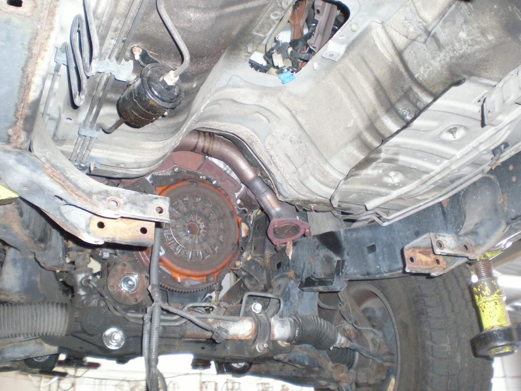

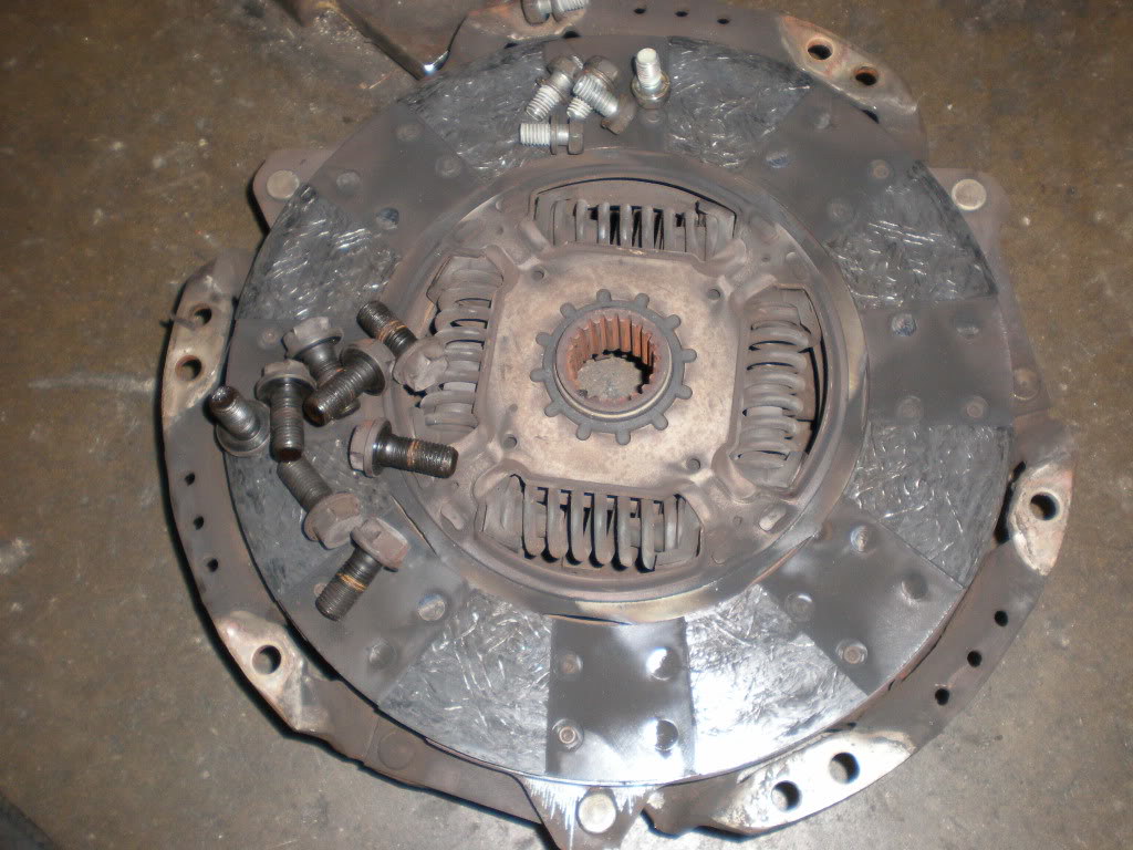

Transmission removed. Original clutch and pressure plate showing. She's an ugly one.

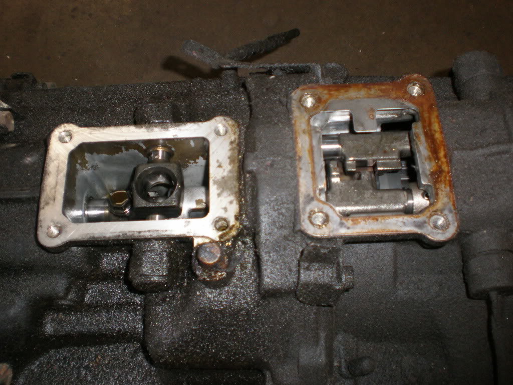

R150F
The shifter seal leaks will be easy to solve before installing into the green truck.
Here's the completely fried clutch disk. The rivets in the disk were worn down.

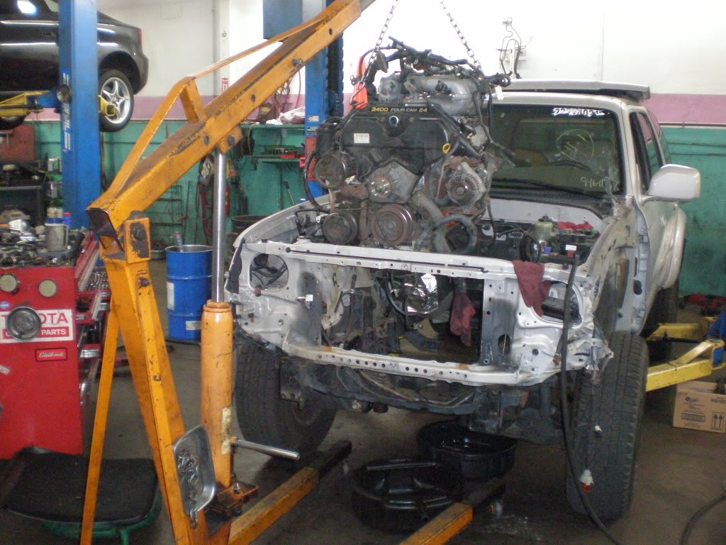

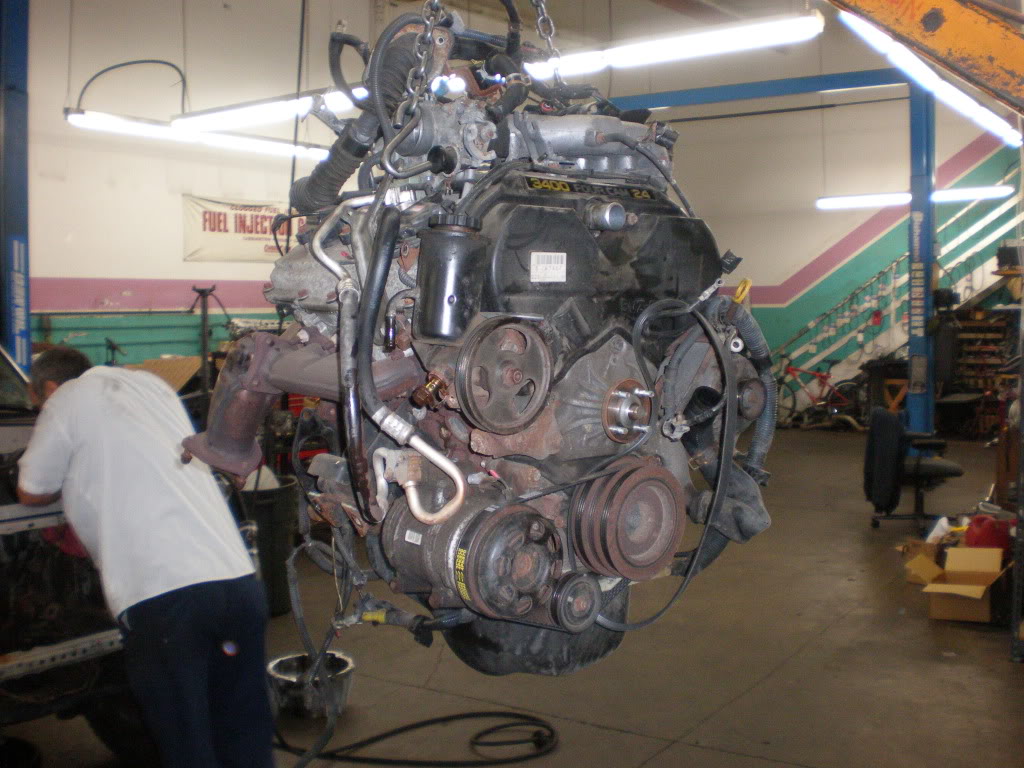

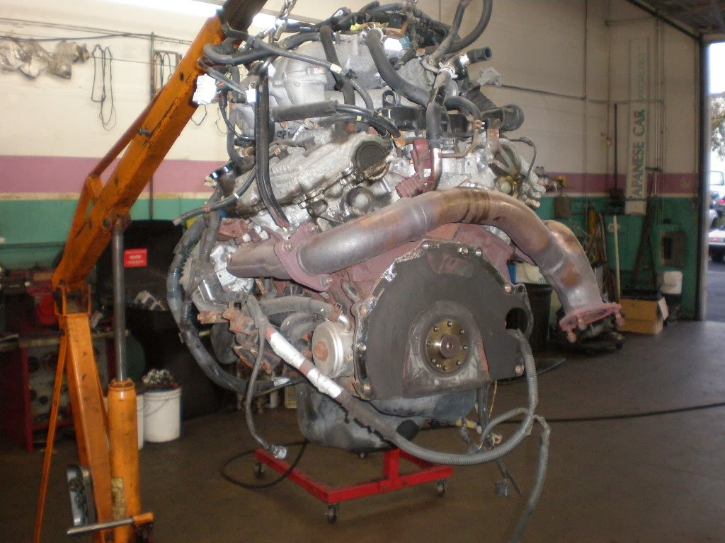

Now it's time to pull the engine. The power steering fluid was drained from the race so the power steering pump wouldn't need to be removed from the motor:
The engine soon followed:

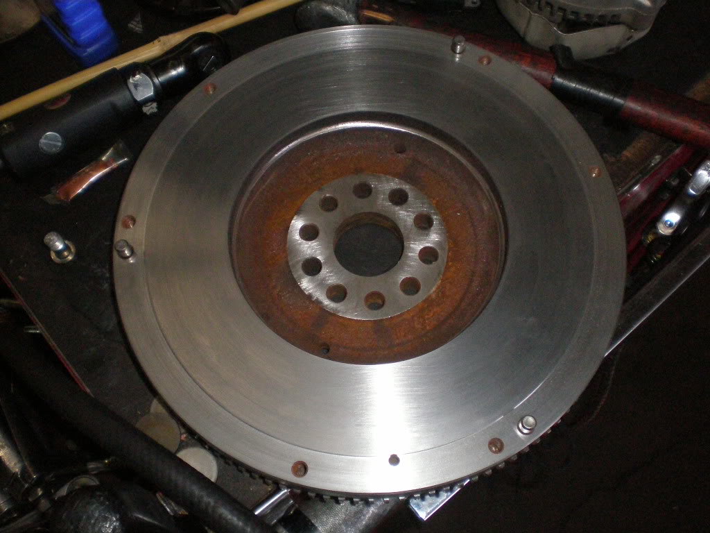

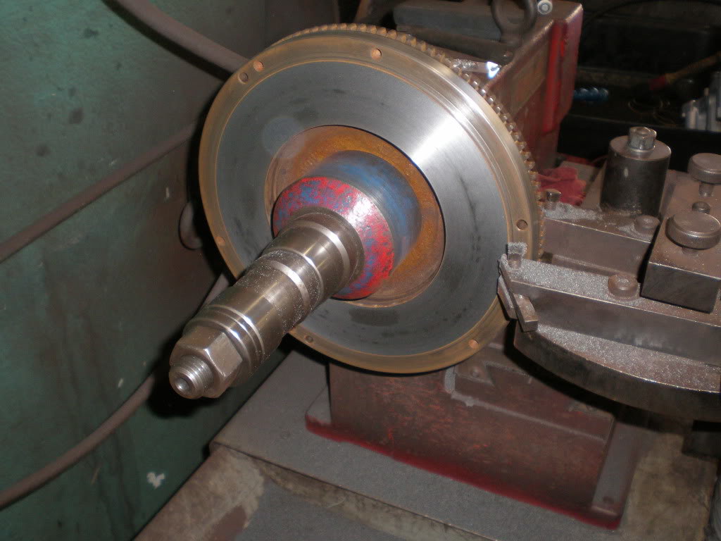

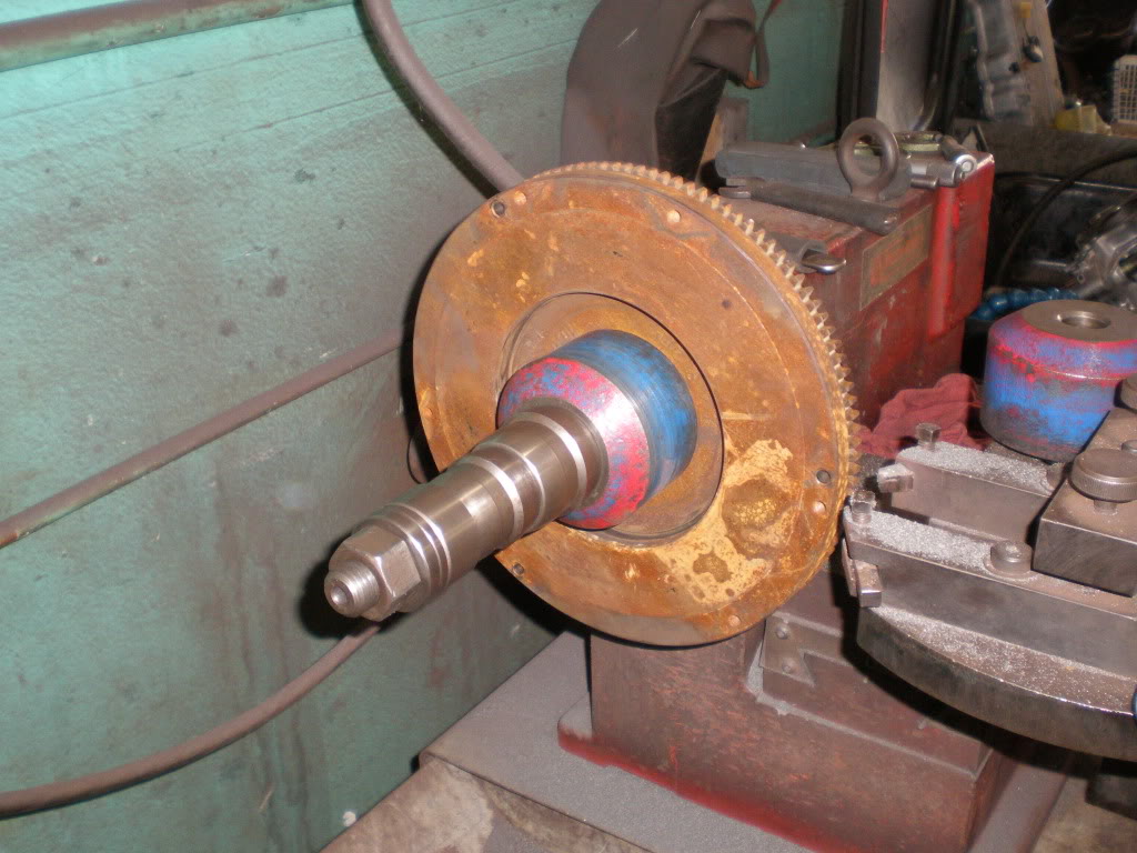

This rusty 3RZ flywheel was $25 used online. It took machining it twice to get it looking clean. There are some heat spots, nothing crazy.
After the first pass
After the second pass.
R150F Trans soon to be mated with 2TR-FE bell housing.

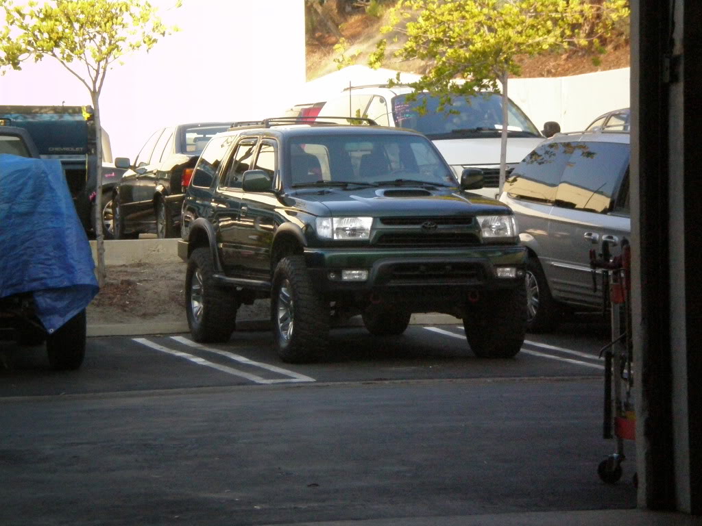

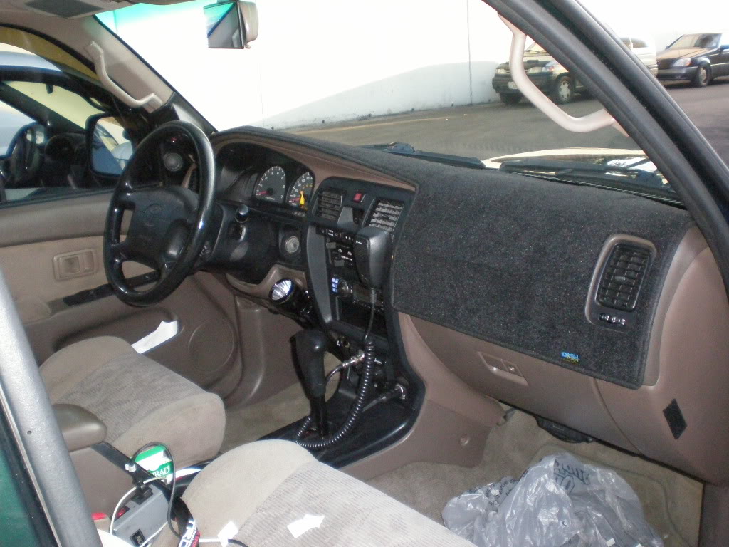

As far as my 2WD goes, I received a Dash Designs cover today. I want to hide my dash, even though it's not cracking. The top part is slightly discolored and there's some obvious sagging. Looks 100% better covered.
It sat on it's ass outside all day
