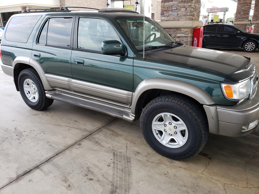

Got a doppleganger now, my friend Lee

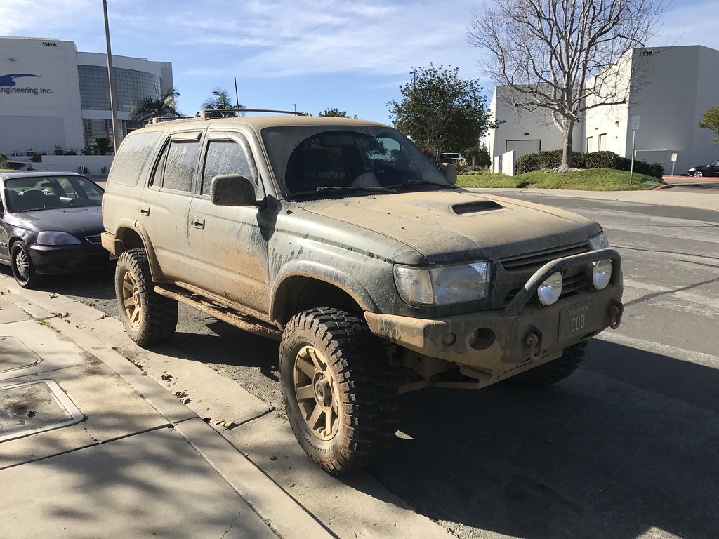

Next day at work... cue the curious coworkers
"do you go off road?"
"where did you go?"
