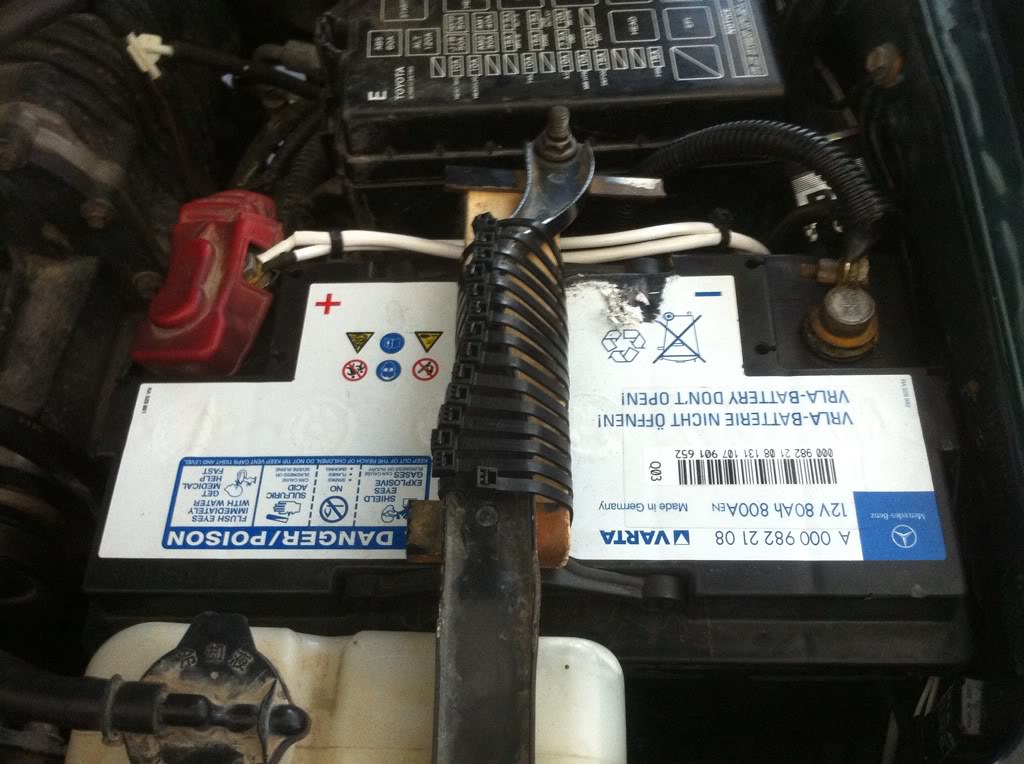

Sorry CoB, I had to! You have a lot of sweep parts put on the runner but you have zip ties holding a block of wood to take up the gap from the smaller battery.
Whatchu talkin bout? Haha it's a COB tradition! Zip ties are JDM's best friend :) My 99 has some gnarly zip ties going on.
1ed070c8 by cobblewagen, on Flickr
It's a custom battery holder bro, anything custom adds 20hp. it's in the rule book of BRAAAPPPP!!!!

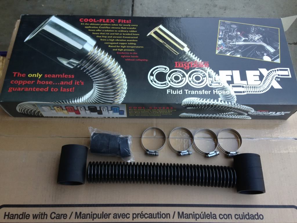

Replaced a few water lines with 3/8 hose that I'd been waiting for. Also got a lead on some 95 4Runner V6 S13WB calipers and a 1 1/16 brake master. Gonna redo the whole brake system before registration time.

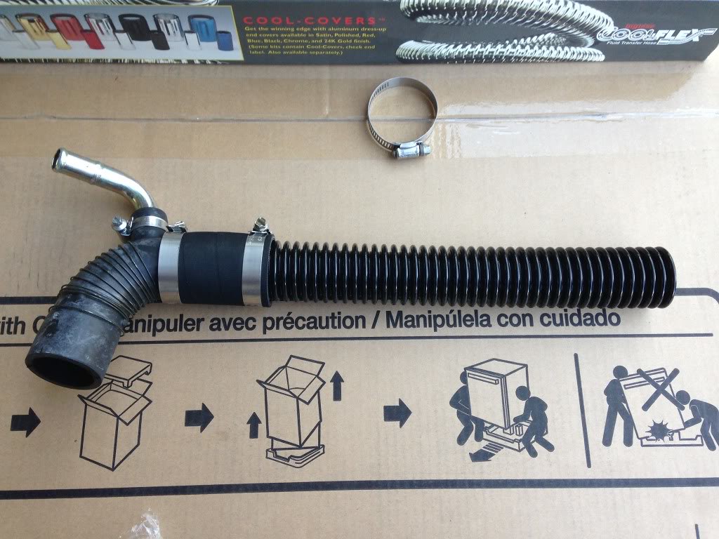

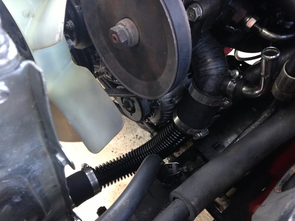

Got my lower radiator hose installed.
null_zpsd0c45622 by cobblewagen, on Flickr
It won't hold where it connects to the half hose on the left, so I have to cut a small piece of the old hardpipe to slip between them for a better solid connection.
null_zps3f457eeb by cobblewagen, on Flickr
null_zpsdb7919a3 by cobblewagen, on Flickr
Test fit to get the angles correct

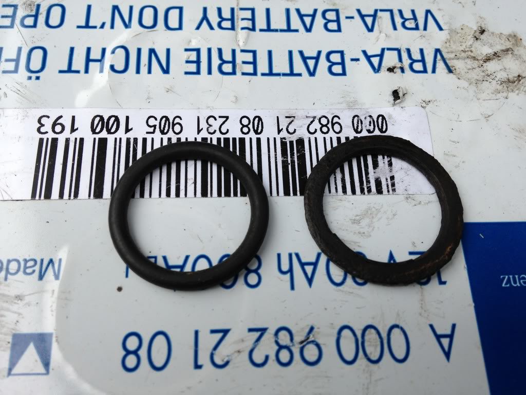

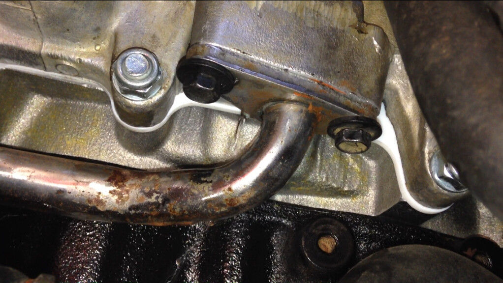

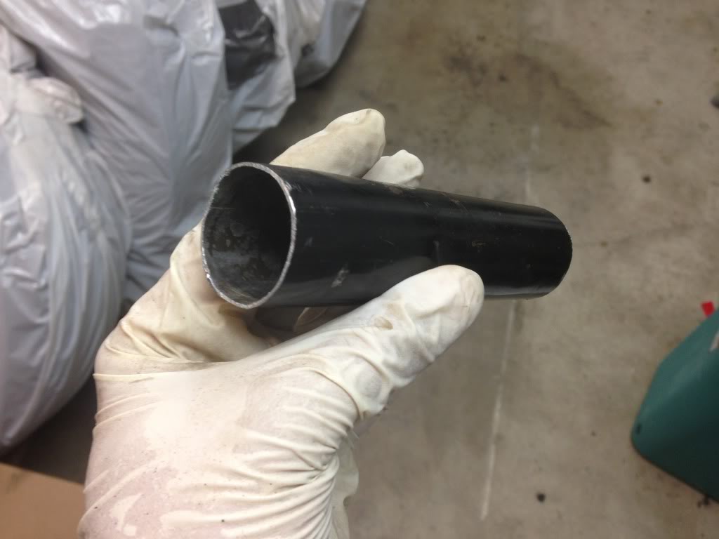

Put coolant in the truck and this little ****er started leaking. This is the coolant pipe that runs under the manifold from the thermostat towards the rear heater (back of the block)
null_zps5c1f2536 by cobblewagen, on Flickr

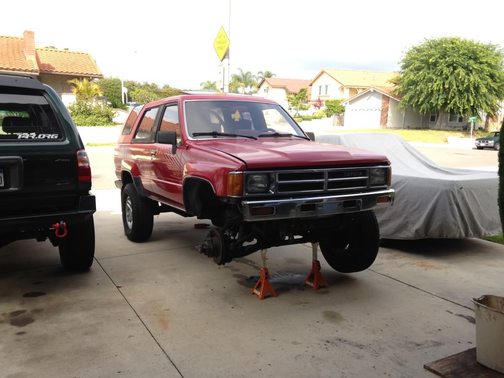

There was no o ring, instead, silicone. I had to remove the front right wheel, reach up in there and scrape the old stuff off with a flathead screwdriver and a razor blade. It was not fun. I went down to my buddy John's shop, pulled another coolant hardpipe from a 22RE manifold, and took the O-ring.
null_zpsa22b757b by cobblewagen, on Flickr
I was able to use that o-ring to find a suitable replacement.
null_zps58248995 by cobblewagen, on Flickr

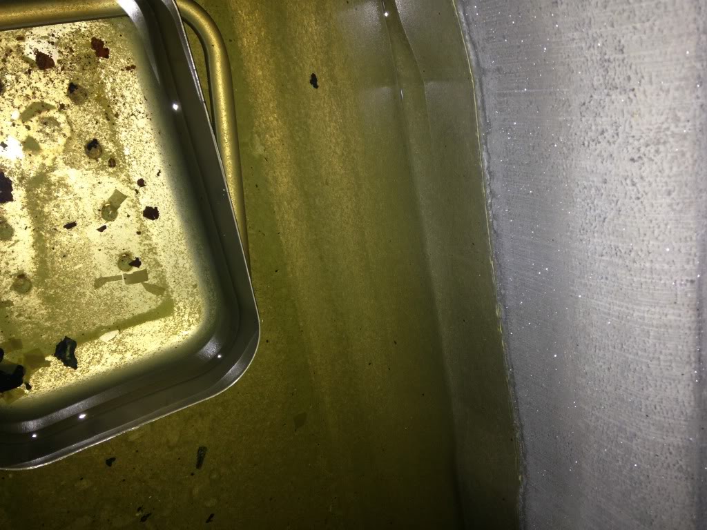

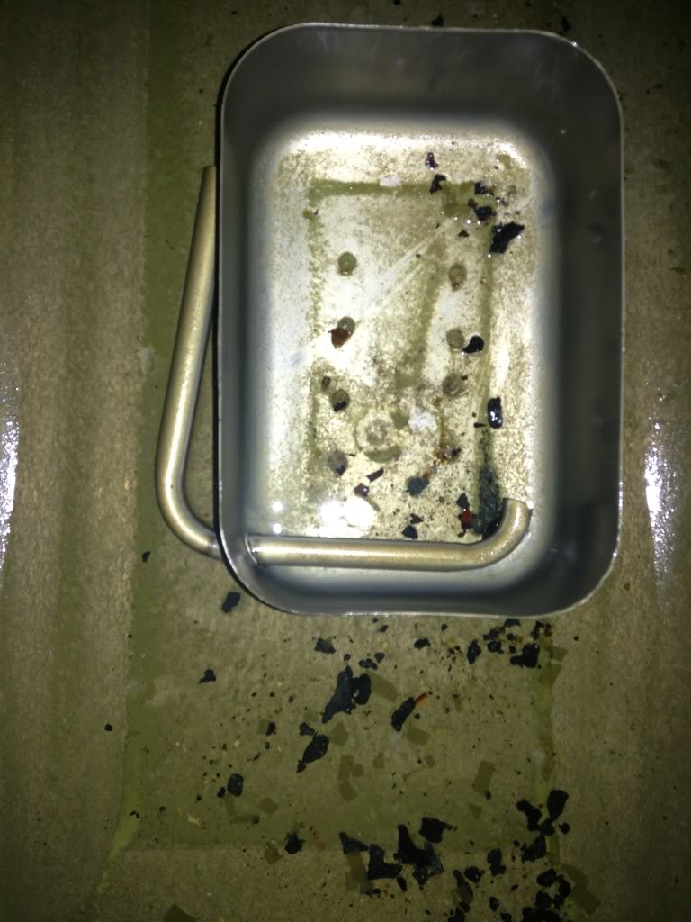

The truck isn't staying running. It isn't because the O2 isn't there, and I know everything is hooked up properly.

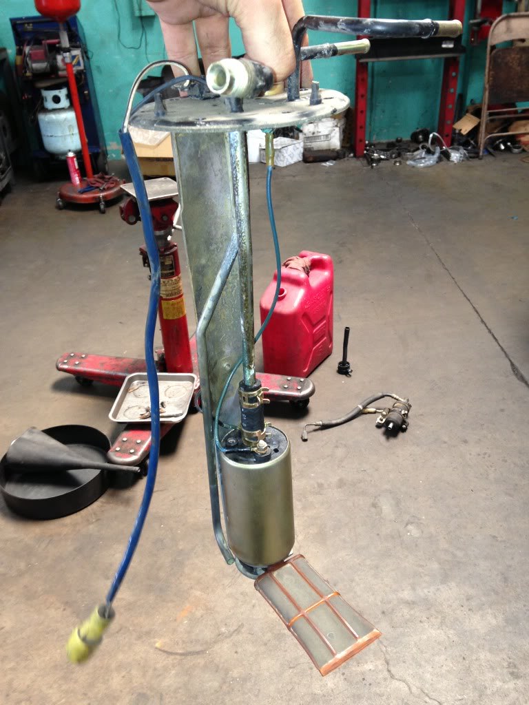

Testing the fuel pump using the diagnostic port on the side of fusebox showed that fuel delivery was the issue.

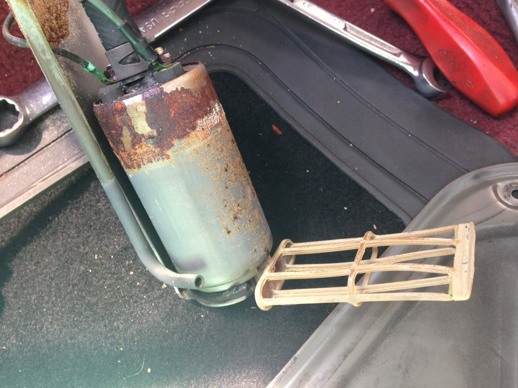

Pulled the fuel pump to see what the fuss is about in there.
null_zps261ab2ca by cobblewagen, on Flickr
Hoooooly shit
null_zps707fa127 by cobblewagen, on Flickr
null_zps5f71fa85 by cobblewagen, on Flickr

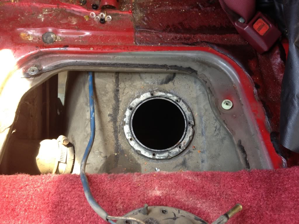

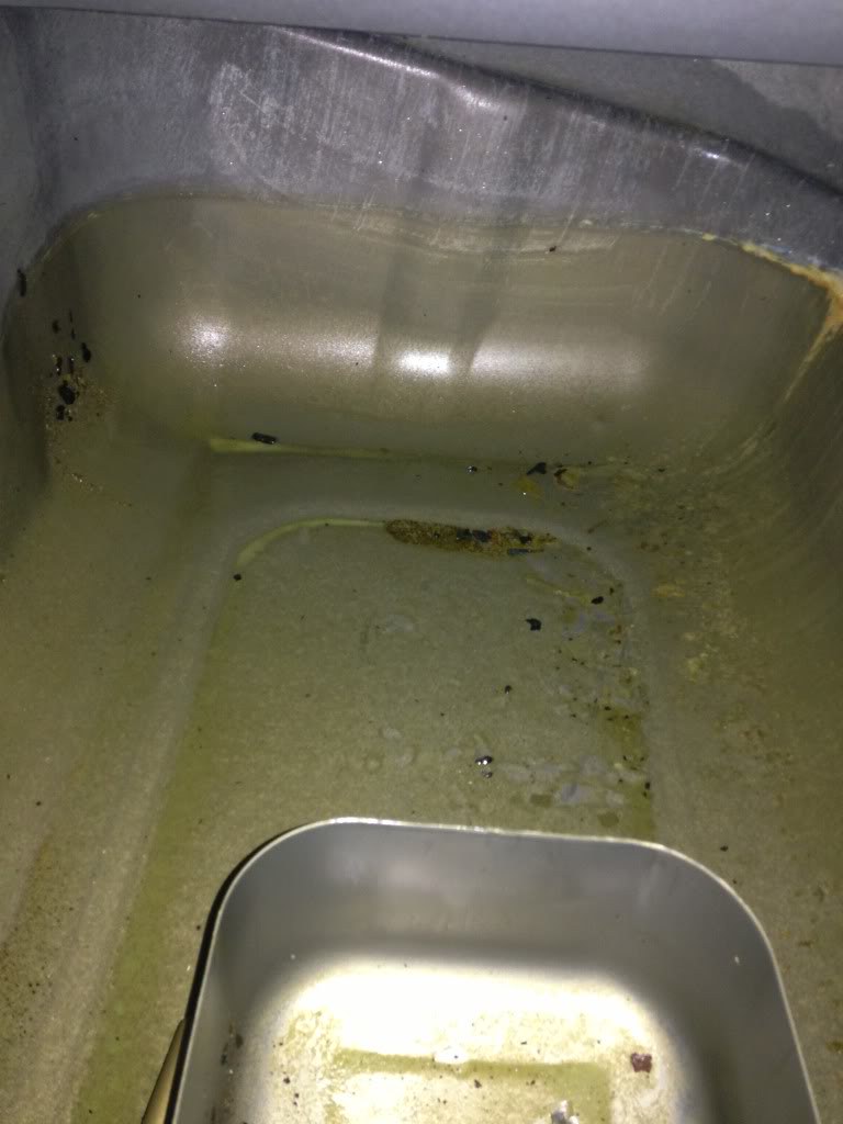

Tank pulled, fuel drained using an old fuel pump:
null_zps788153f0 by cobblewagen, on Flickr
null_zpscc89f266 by cobblewagen, on Flickr
Spent at least two hours cleaning the tank out. Replacement fuel pump:

That was one nasty mess in the tank! No wonder it wouldn't stay running, with all those chunks being pulled up against the inlet and shutting off the flow. Glad to see you got her running good!
Especially with that screen missing. Can't believe how bad it was. You should have seen the rust corrosion (I forgot, CA rust isn't like real rust). Took several washes out with water and air drying to clear that out.

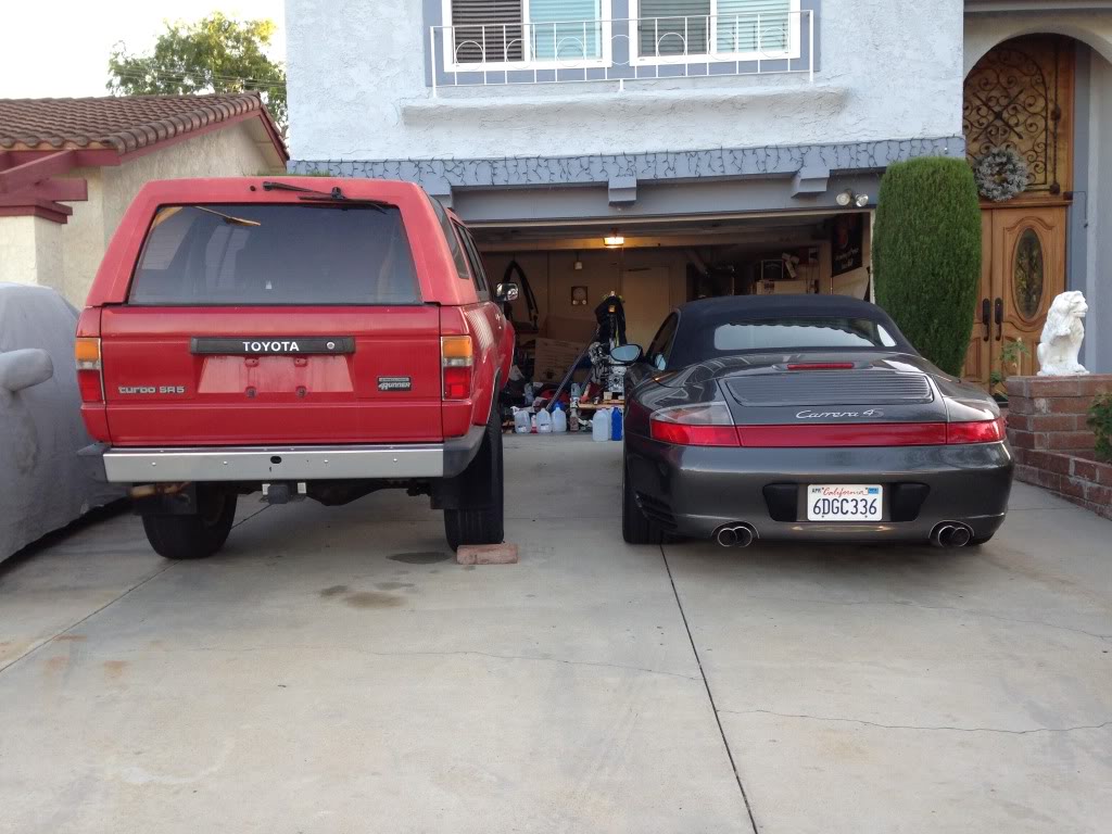

Also had to change the 5/8" line from the oil cooler. Started leaking like crazy right after the video of the first start. A couple pics with my brother's (cool brother, not the same dipshit who can't fix his truck) Porsche Carrera 4S. Only has 25k on the ODO.
