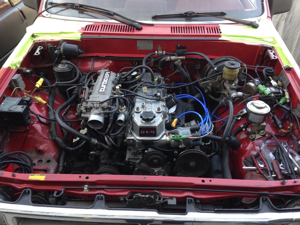

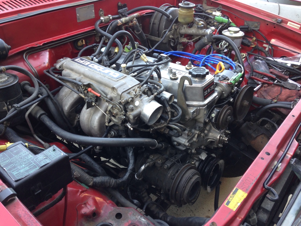

Intake manifold, wiring, starter, torque converter bolts, etc, etc, etc
D91F9284-C3AD-4A09-BC94-0C2C55D22B26-5568-00000314BECD1C05_z by cobblewagen, on Flickr
2D616CAF-EE55-4952-96B8-26505552E094-5568-00000314C26B7F76_z by cobblewagen, on Flickr
Got rid of the coolant hard pipe that runs behind the turbo. Going to reroute a new coolant hose around the alternator and straight into the radiator.
DAC7D2AC-9FC4-47FB-9643-DEFF8227235D-5568-00000314C5171E4B_z by cobblewagen, on Flickr

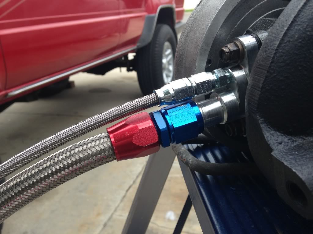

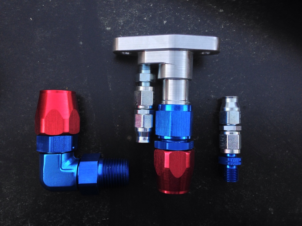

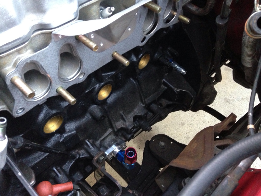

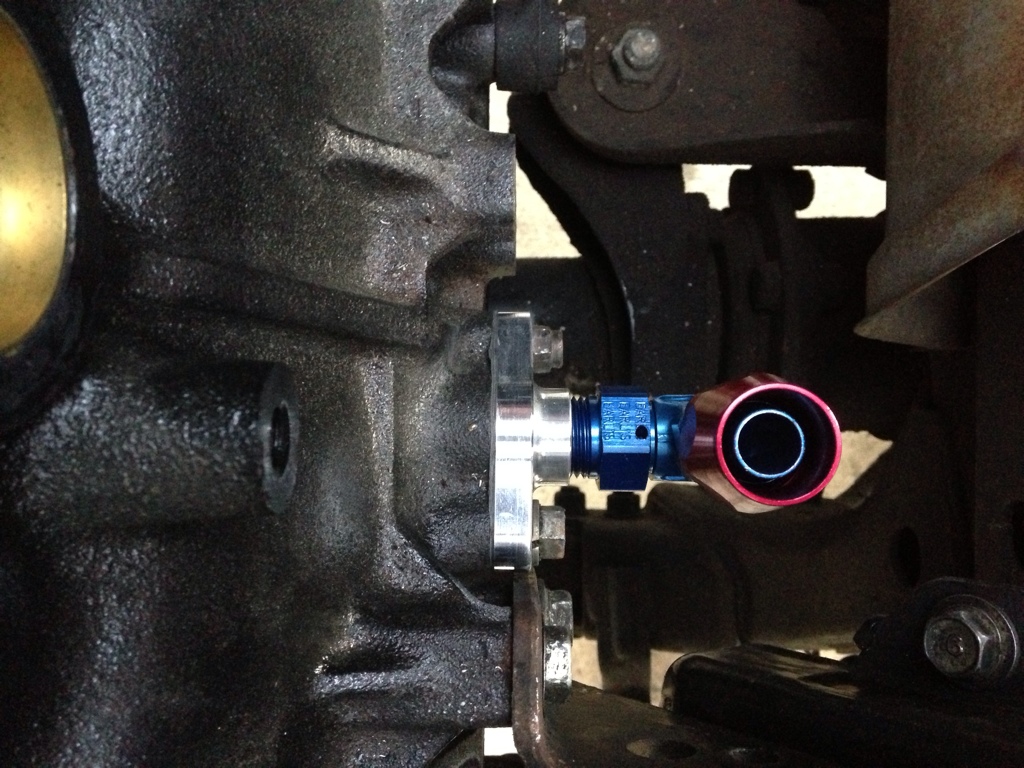

Also got my stainless steel lines figured out for the CT26. I didn't want to use the OEM lines, nor did I want to buy a 7M-GTE stainless line kit and risk fitment troubles.
1x CT26 Oil Drain/Feed Flange, -4 AN feed and -10AN drain
1x 22R-TE Oil Return Flange 1/2" NPT Boss
1x Earl's Performance -4 AN to 12mm x 1.25 Male adapter for feed line (EAR-9919BFFERL)
1x Earl's Performance Swivel-Seal hose end, -10 AN to 1/2" NPT, Oil drain hose to block flange (EAR-829010ERL)
1x Earl's Performance Swivel-Seal hose end, -10 AN to -10 AN Female, Oil drain to oil drain hose
2x Earl's Performance Speed-Seal hose end, -4 AN to Female, feed line ends
-4 AN Earl's Performance Stainless Steel braided hose
-10 AN Summit Racing Stainless Steel braided hose
Got my block flange for the oil drain. Just waiting on the feed line now.

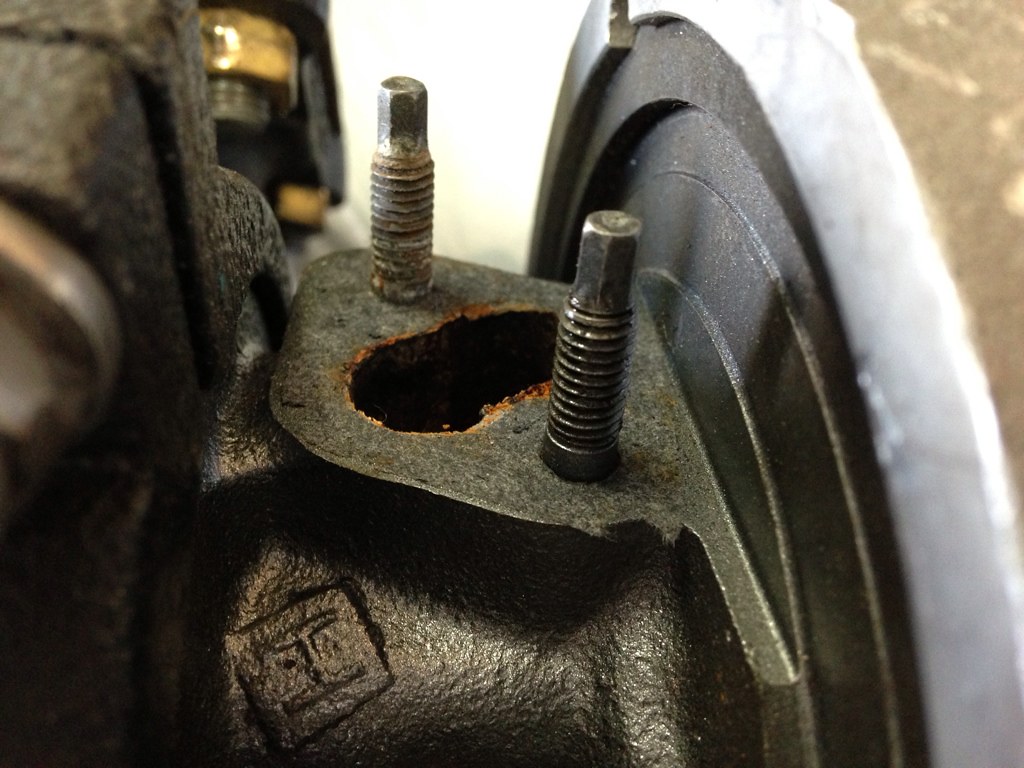

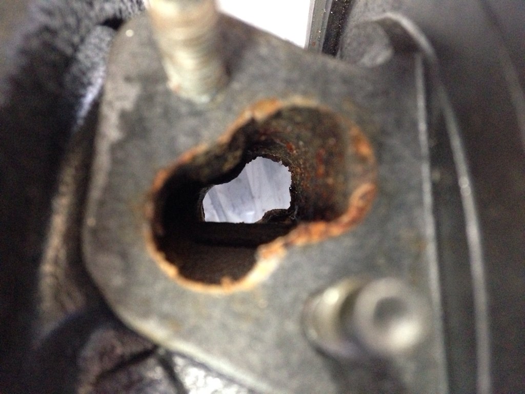

Took the turbo back out to set up the coolant lines.
Removed a block off plate from the water pump line side of the turbo and going to use the CT20 lines.
90FEC056-6577-4EED-BB9D-4B6E792E2825-8903-000005567DA1BB6B_z by cobblewagen, on Flickr
0893BD3F-4BB2-4EE8-A02D-409A7166A941-8903-000005567F916773_z by cobblewagen, on Flickr

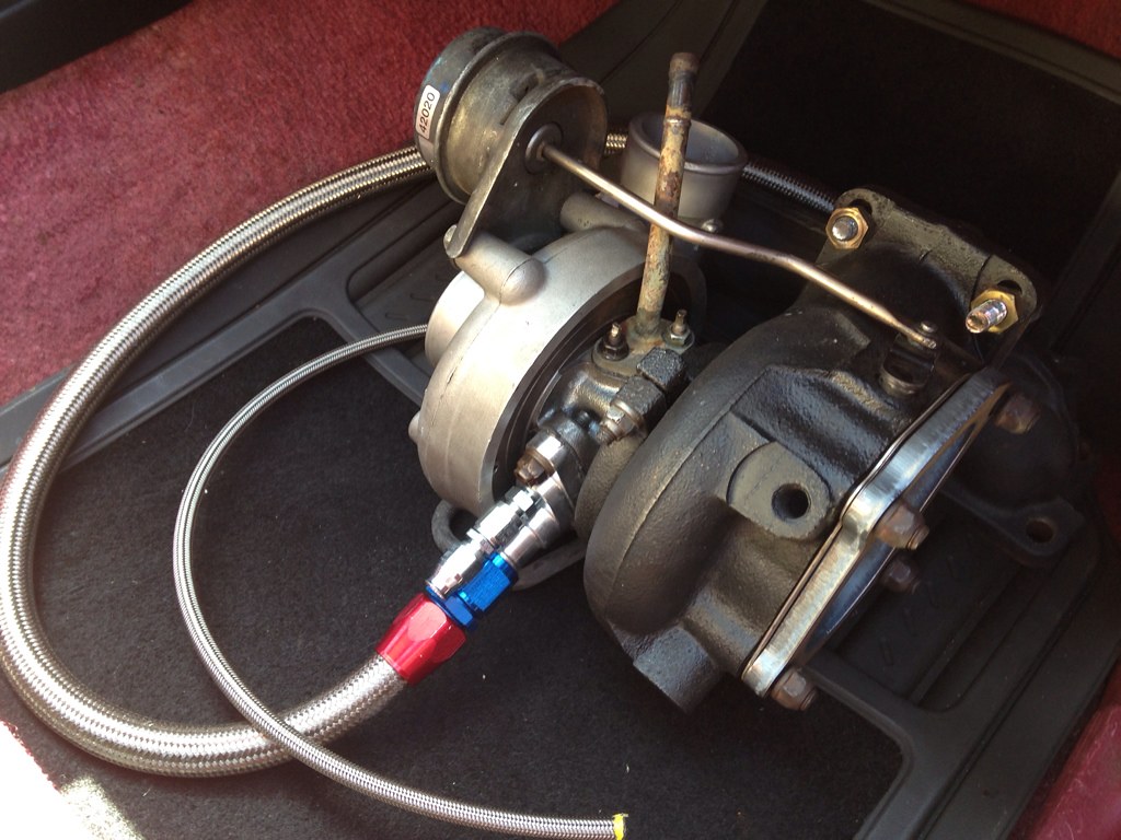

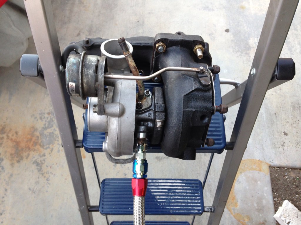

I have my oil lines ready to go.
3515331E-5129-4241-A316-C7C95DBC3A1E-8903-0000055681742729_z by cobblewagen, on Flickr
CF08F3A5-E74D-40C8-BEED-14C36D1191FB-8903-0000055686A356A3_z by cobblewagen, on Flickr

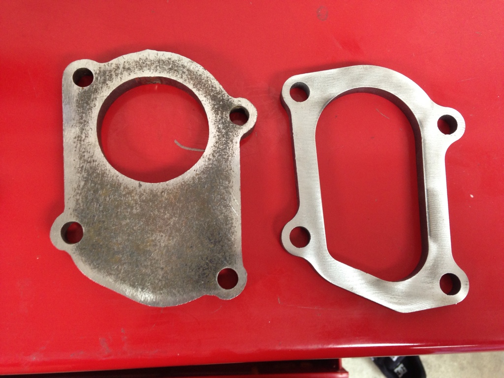

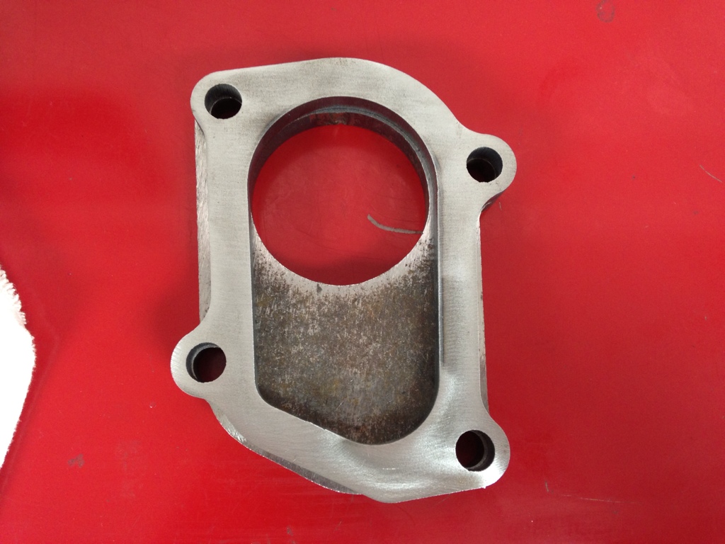

Also got this outlet flange from Suprasport. I don't like how the wastegate is blocked with the other flange.
B7D1C48B-1FE1-475B-9706-8A04E29AA72C-8903-0000055696450BD3_z by cobblewagen, on Flickr
D1C05573-49E6-4CCD-9A04-32D31BFB80C5-8903-000005569848635E_z by cobblewagen, on Flickr
747B73C8-D2ED-4006-B1E7-FB918E394B97-8903-000005569CCCE565_z by cobblewagen, on Flickr

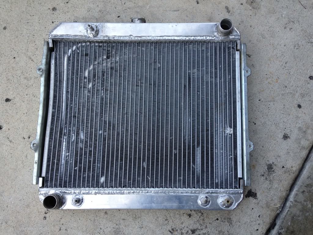

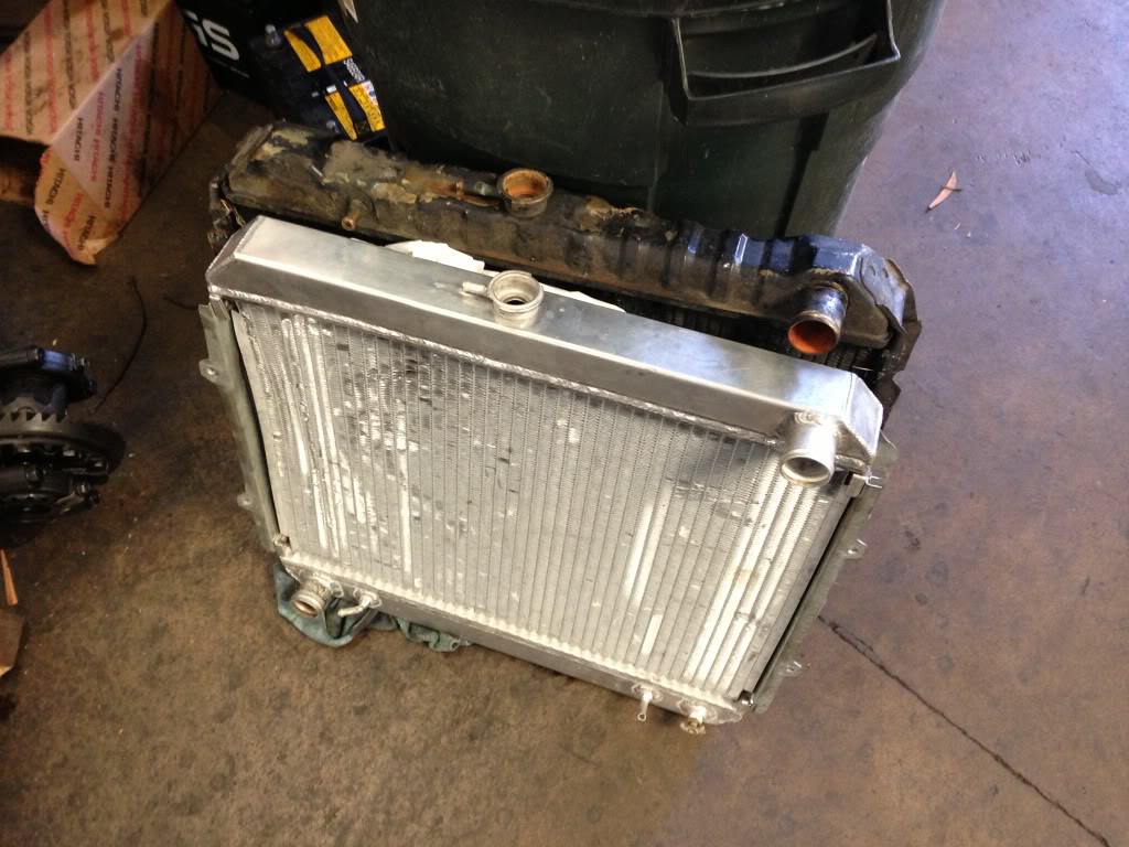

Going to try to install a coolant return on the aluminum rad.
Today I had some time to work on the truck. Started by figuring out the cooling situation. First, the heater core was bypassed for replacement at a later date. 5/8" hose from back of block to the middle coolant hose. The middle coolant hose was also cut in half to soon accommodate a flexible lower radiator hose (coolflex).
Stock radiator versus free aluminum radiator. Only difference is the coolant line for the turbo.

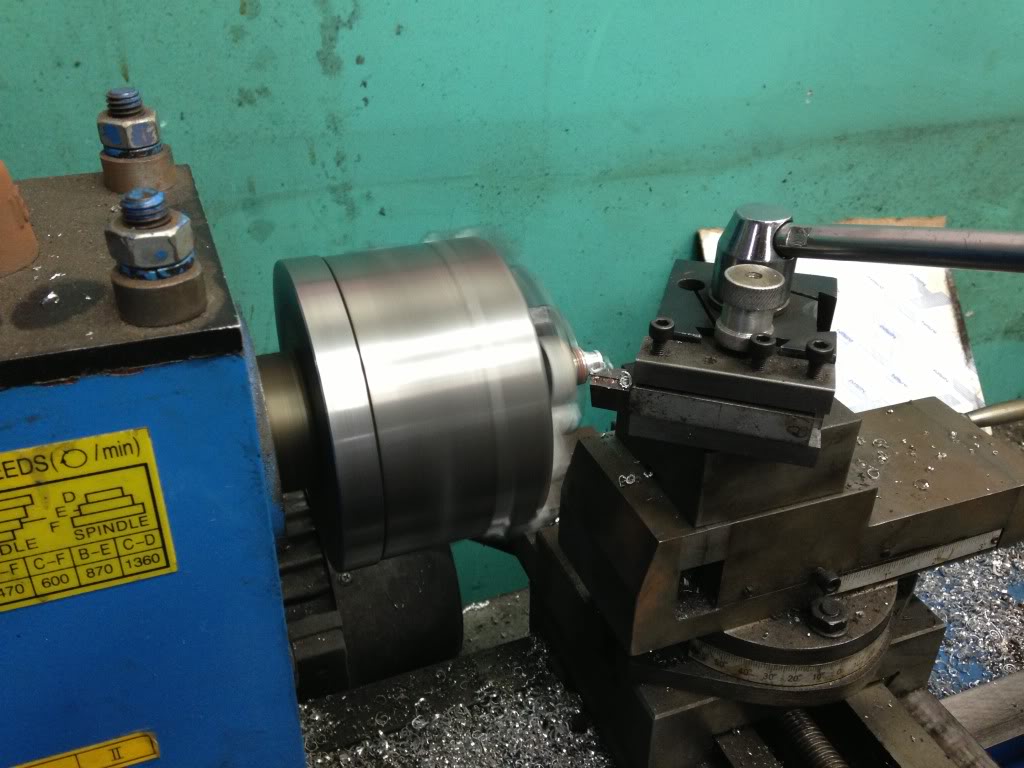

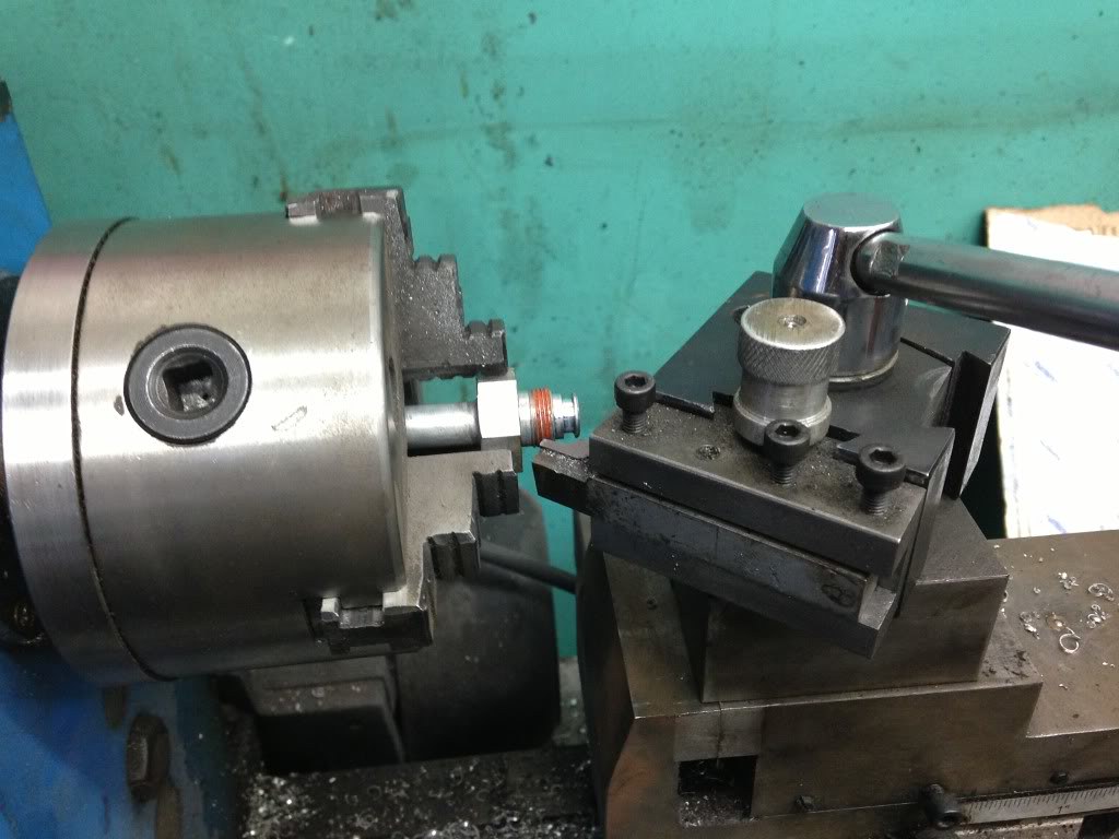

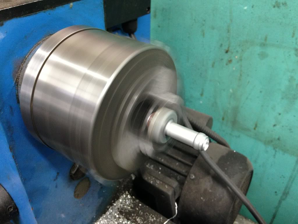

My friend John gave me an aluminum radiator fitting. He has a lathe that was able to trim the threads off the back and drill out the center to a larger size.
null_zps59c331f0 by cobblewagen, on Flickr
null_zps637412dc by cobblewagen, on Flickr
null_zpsefbe9aca by cobblewagen, on Flickr

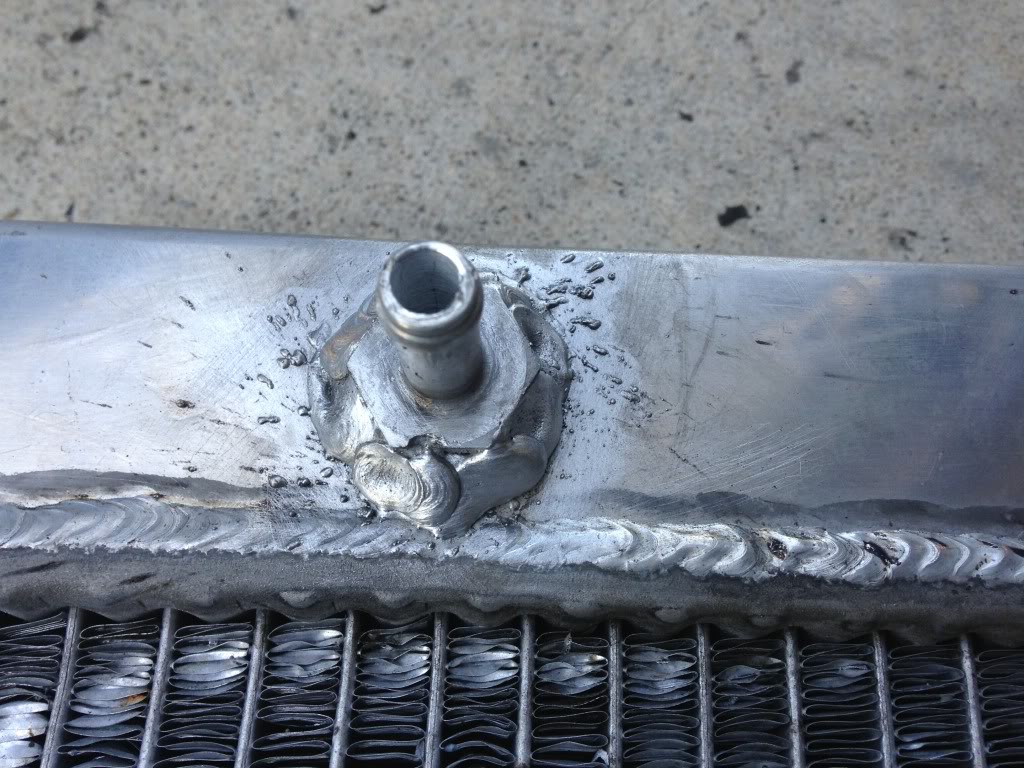

I found a welder named Jaime through a radiator shop. I have a feeling I'll be visiting him again soon.
null_zps41d66281 by cobblewagen, on Flickr
null_zps8d4772f1 by cobblewagen, on Flickr

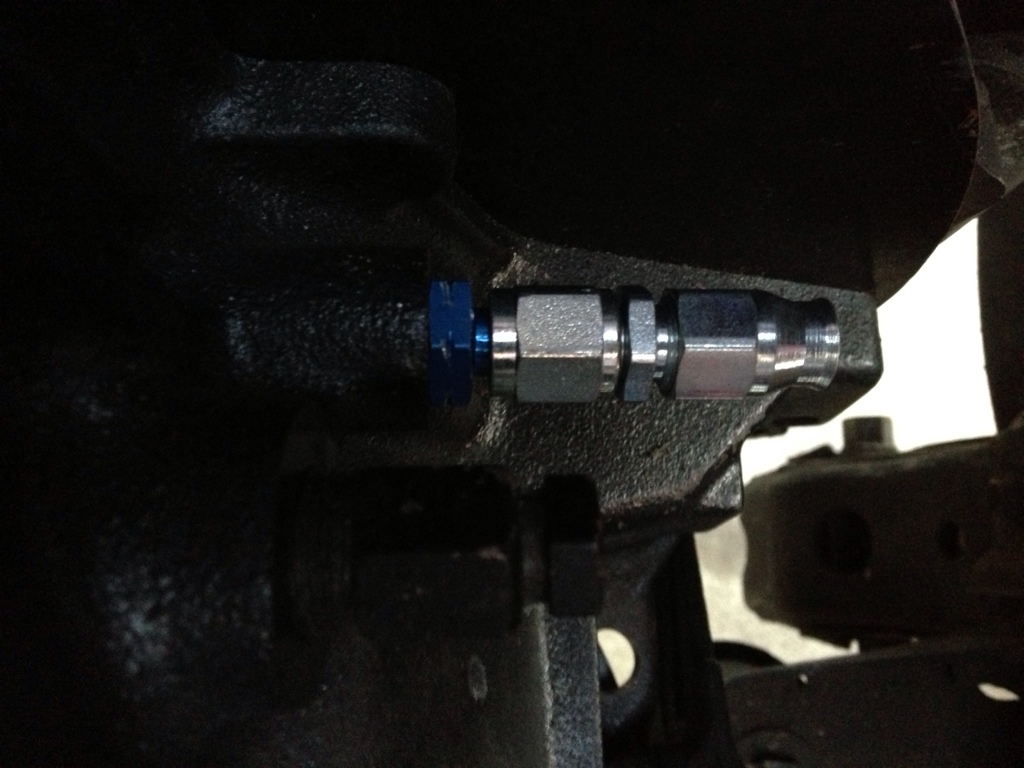

Stainless lines are done. Turbo coolant lines are done also.
null_zps8fa0a540 by cobblewagen, on Flickr

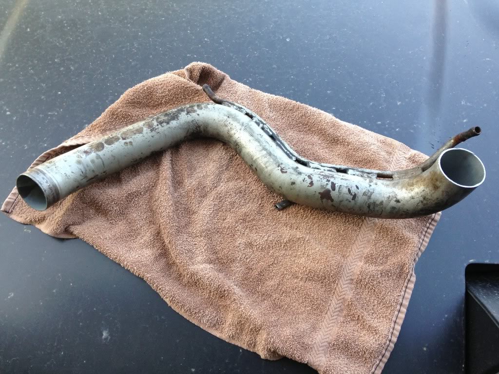

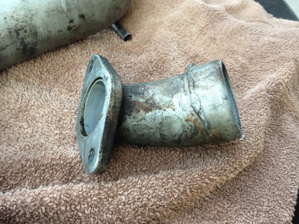

Intake pipe had to be modified to work with the CT26. The CT20 turbo had a 2 bolt flange to bolt to the intake pipe, instead of a clamped coupler. I cut off the end flange from the intake pipe and will refinish after fitment is perfected. Installed on CT26 using a silicone elbow coupler (2", 45 degrees) EDIT: I had to change to a 60 degree coupler, 45 was not enough

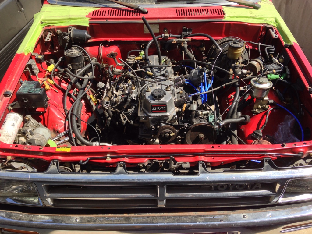

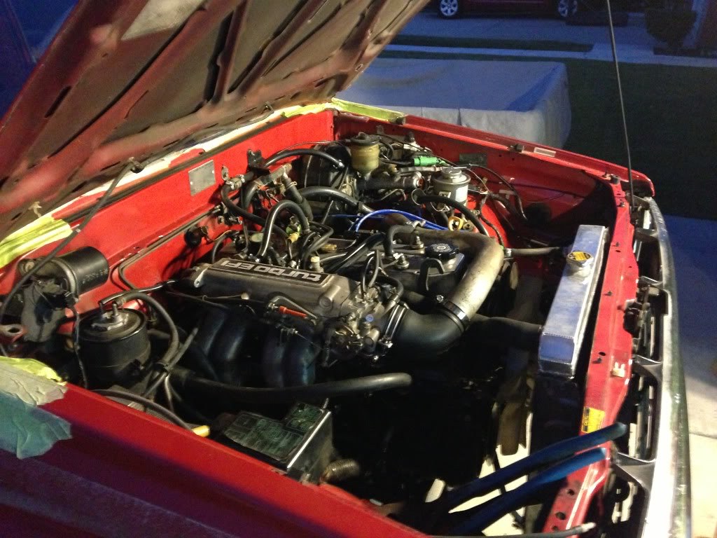

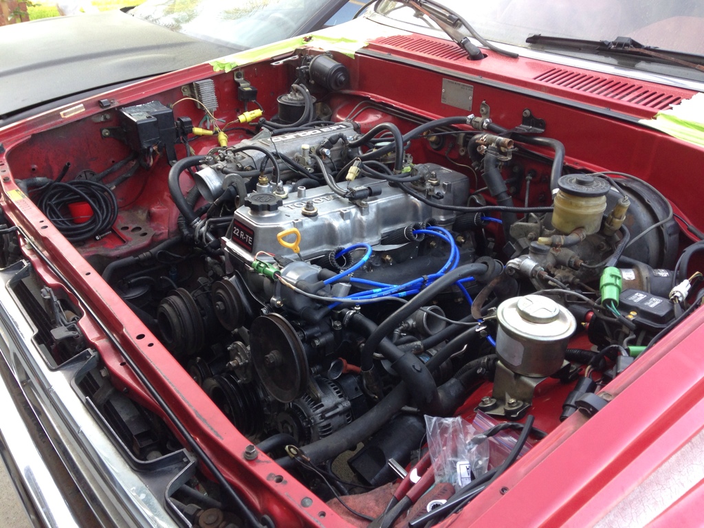

The battery is back in, the truck has power. Engine filled with oil. There isn't much left before starting.
To do list:
Figure out where some plugs go, 3 danglers
2 upper bell housing bolts
drop and clean fuel tank
lower radiator hose
trim turbo inlet boot to fit CT26
install airbox
Mazda transmission cooler (radiator bypass)
And then, after it's running:
TruckPillars gauge pillar pod
install innovate mtx-l
custom downpipe using CT26 outlet flange, LC weld on O2 sensor flange, and Bosch wideband O2 bung.
And then hopefully SMOG (and brakes... and install the tires)
