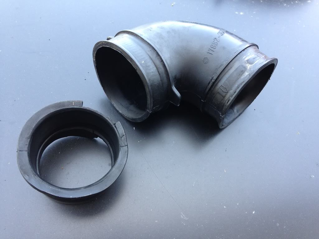

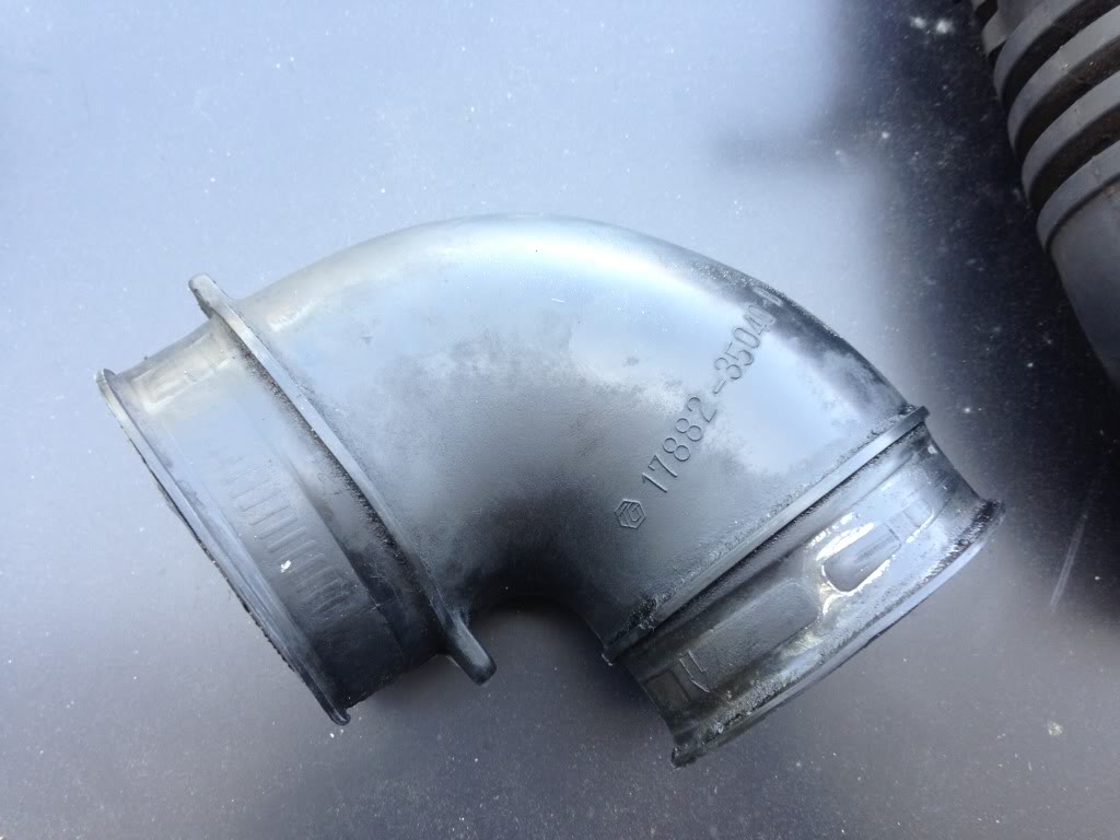

Trimmed the inside of this intake boot. It was originally two pieces of hose stuck together, but I removed the inner hose and trimmed it back. The diameter of the outer hose fits the CT-26 like a glove. I glued the trimmed piece in using Permatex Ultra Black RTV.
null_zpsdb70bb5f by cobblewagen, on Flickr
null_zps5f01c1e6 by cobblewagen, on Flickr

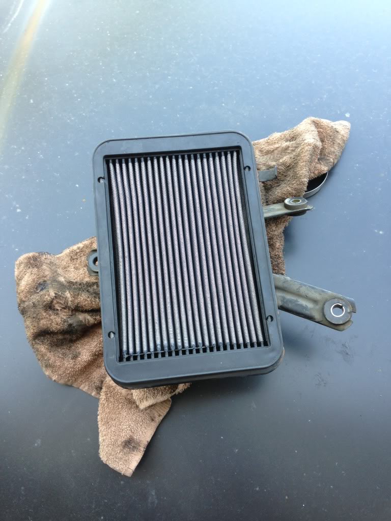

Got a K&N drop filter off of Yotatech.

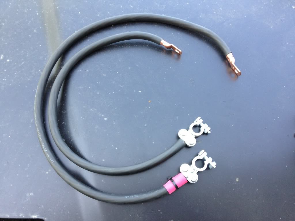

Made some 1/0 gauge battery cables with new terminals.

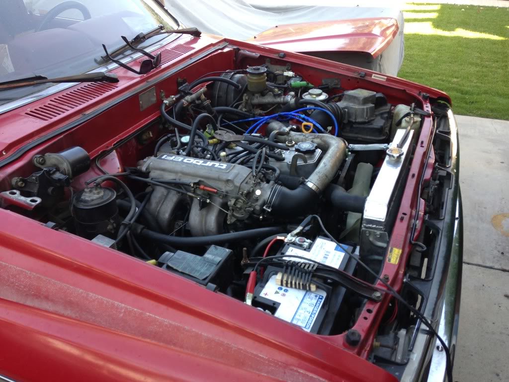

Good ol ziptie-wood battery mount, 3rd gen style. The intake is all done with the exception of refinishing the hardpipe from the turbo to throttle body.

You have to paint the valve cover red, it's good for another 10 horsepower.
If he adds red zip ties to his battery tie down he can get another 10 hp. :boom:
Sorry CoB, I had to! You have a lot of sweep parts put on the runner but you have zip ties holding a block of wood to take up the gap from the smaller battery.
