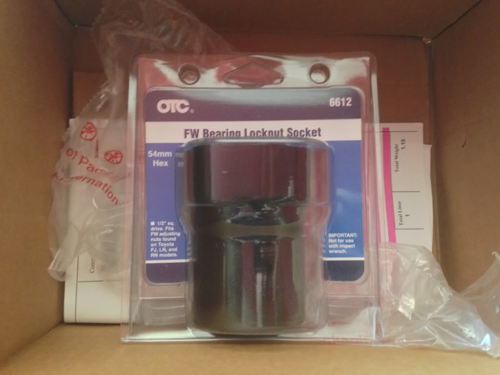

Finally received my 54mm socket. Huge is the only way to describe this thing. Only things left to order are front wheel bearings, inner and outer races, and a wheel bearing packer.

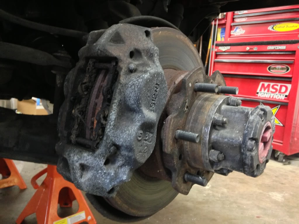

Take note of the nasty brake caliper.

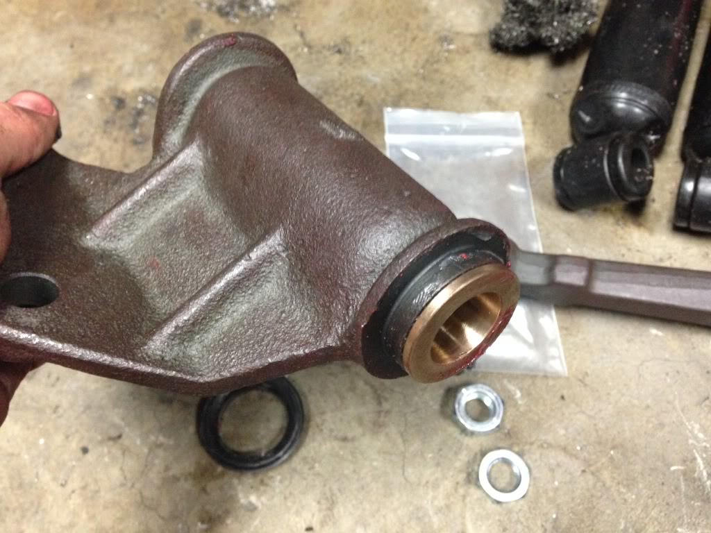

Duralast FA5040 Idler arm
null_zps10297898 by cobblewagen, on Flickr
4Crawler bronze idler arm bushings
null_zps128d85ed by cobblewagen, on Flickr

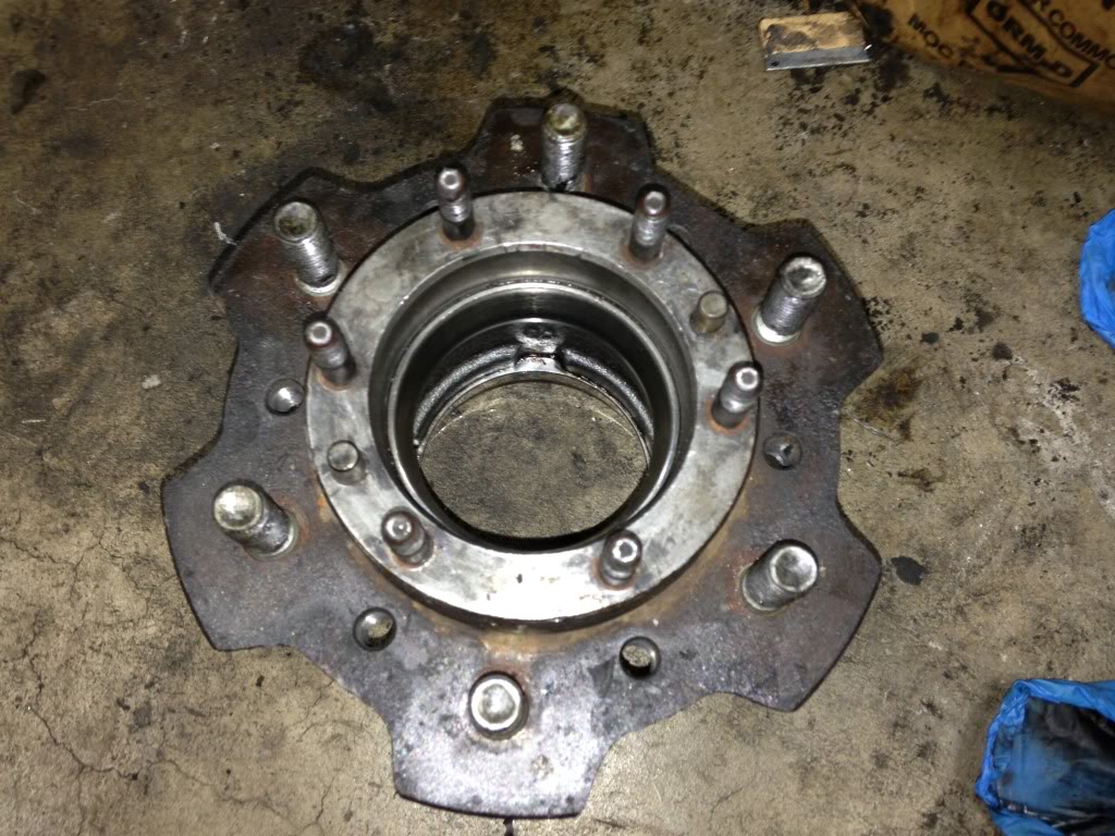

Hub clean and disassembled, races removed.
null_zps19c0392f by cobblewagen, on Flickr
