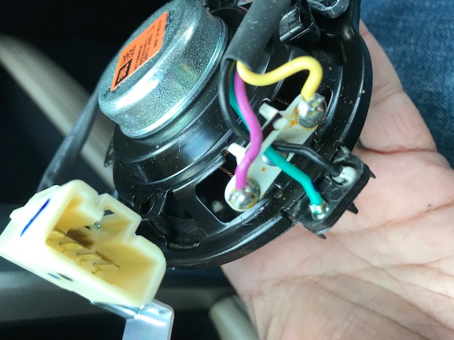

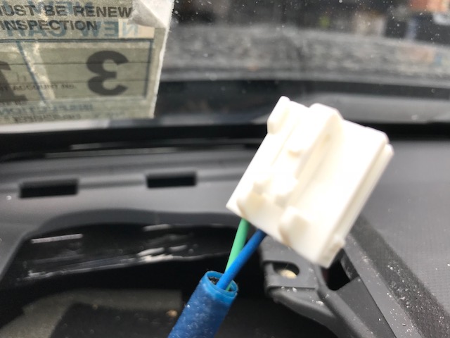

Guys
I am looking to replace my dash speakers to improve the sound quality. I removed the factory dash speakers and I see only two wires on the plug.
Most of the folks here mention there are four wires.
Can you please suggest how should I be wiring up my 3.5" speakers for the dash?

Guys
Hi,
Did you ever figure this out? I have the same situation and can not find info on how to wire a aftermarket speaker to the dash.
Thank!
You only need 2 wires, positive and negative, the 4 wires is from the TacoTunes wire adapter. You should be able to wire in a speaker with just the 2 wires no problem.
