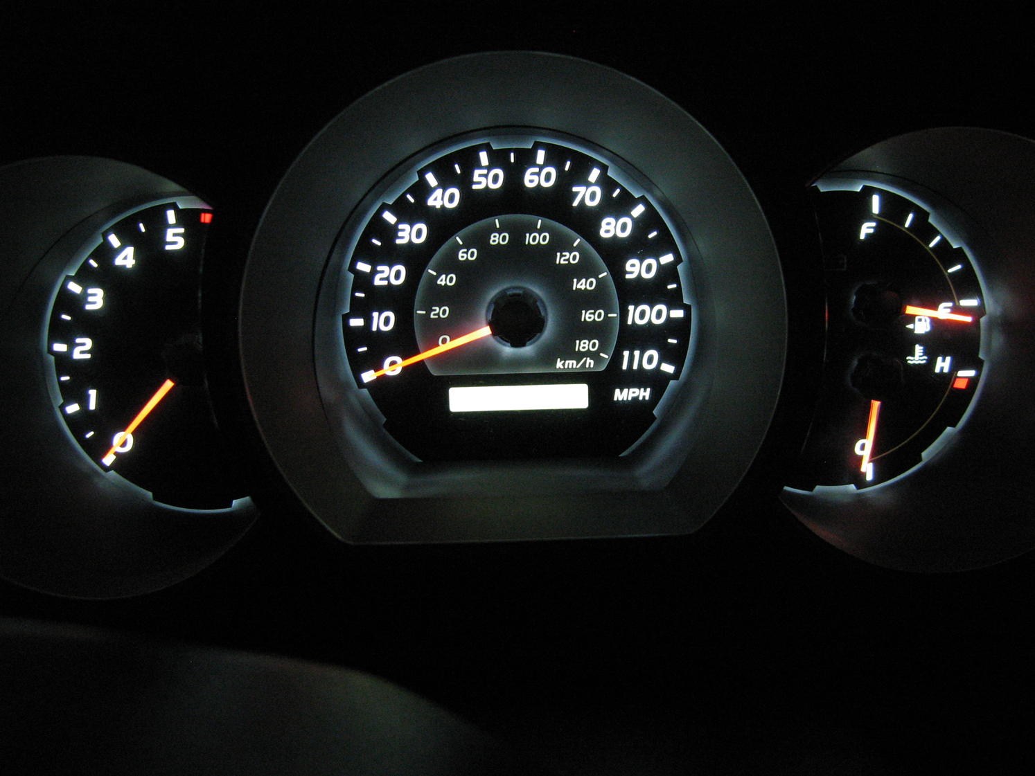

not the best pic, but half of my gauge wont light up (more apparent at night - cant read the clock at all).
i tore it apart and it seems that all the removable bulbs' filament arent blown. can anyone confirm this for me please? i suspect it may be a bulb that's soldered onto the board.

You'll only have to replace the removeable bulbs. No soldering needed.
no i was refering to yours actually. what kind of bulbs do you use? same kind for the whole dash? where can i find them at.?

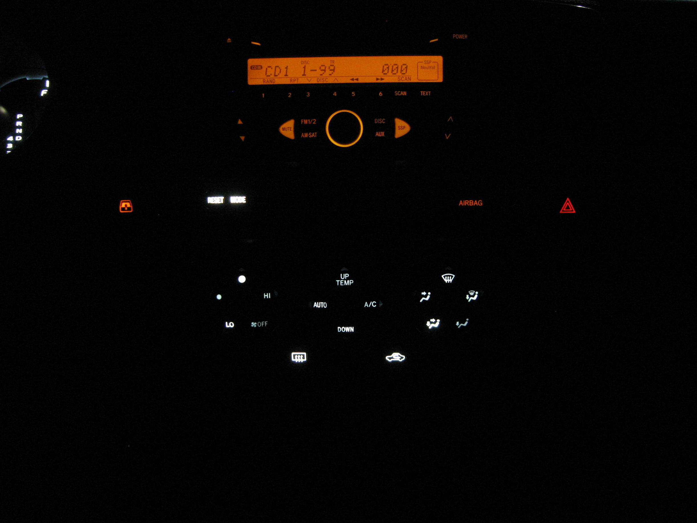

Ahh...mine are all white leds. I used PLCC-2 surface mounted LED's from Oznium.com for the cluster and steering wheel controls. for the rest i used some 3mm flat top LED's i got from ebay. for the switches and HVAC, you'll need 1/8W 1.2K ohm resistors for each light.

Thanks!! Just take your time and make sure the connections are clean. Also, remember to test the LEDs are all lighting up before you put the needles back on. It'll save alot of time. Good luck!!
propman07 - I know its probably mentioned somewhere in these 18 pages (haven't gone through all of them), but how did you get the LCD display to come out white? Just putting in white LEDs doesn't make it white.

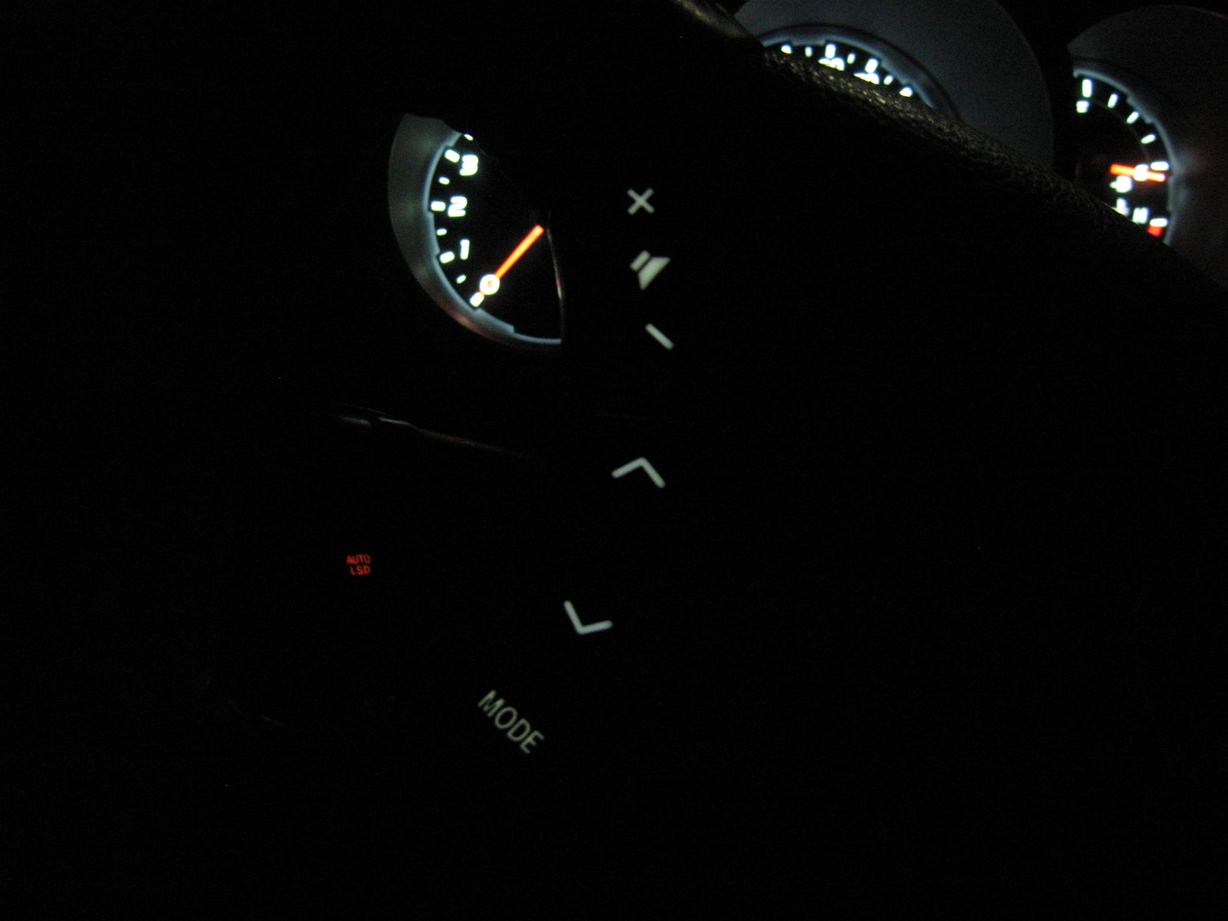

The 4x4 switch, diff lock, DAC and rear window switches all use the twist style NEO bases. I believe that the rear window is the only NEO4 while the rest are NEO3.
You'll have to pop them out to confirm since I chose the longer route of making my own LEDs using the stock bulb bases and aiming them towards the front of the switch.

Why would you use Flat-top LEDs and not round ones if the factory ones are round? This is for the center counsel and switches.
The size needed for both switches and HVAC (3MM) , the flat top LEDs typically provide a wider angle of light in the range of 135-180 degrees vs the round top LEDs which is 15-45 degrees. Last time I checked, they offer 360 degree LEDs but only in 5MM and above that wouldn't fit inside the switches.
