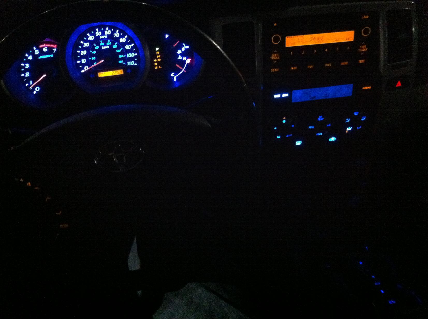

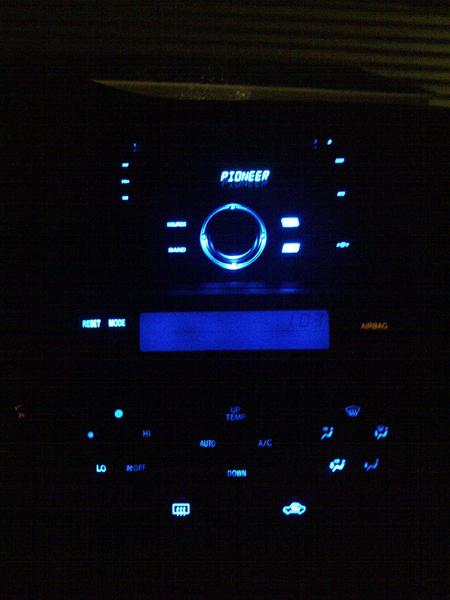

Decided to switch to blue interior lighting because my HU has blue, and I can't (and wouldn't want to) change the lighting inside of the Pioneer HU. I have to say, I really love the blue LEDs compared to the Snooki-Orange crap that Toyota forced on us poor bas****s. I only got around to doing the HVAC tonight, I need to order LEDs for the rear window switch and the 4WD selector soon.
Here's what I've got so far! Also, thanks to Darkie and everyone else for the tips and tricks for this mod.

Looks good!!!

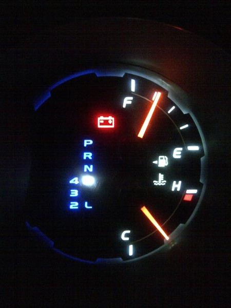

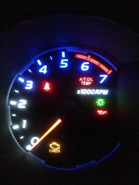

Finished up the dash Saturday night into Sunday morning (finished at 4:30 AM,
including te extra hour from setting the clocks back). I messed up with the
tach, accidentally putting in a white LED, but I like the mistake! It fades from
white to blue as the RPMs increase. From now on, I'm gonna say I meant to do
that haha.

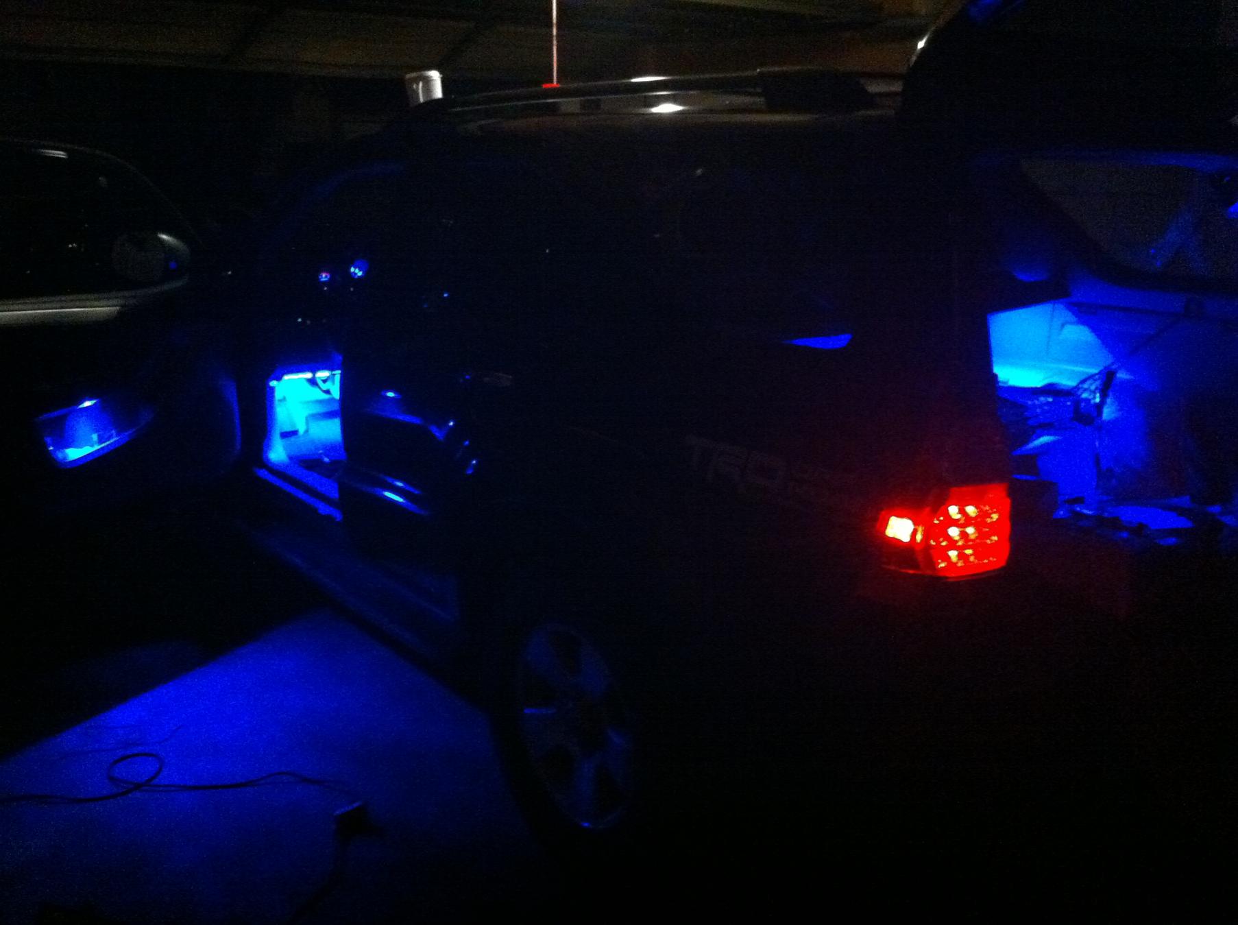

Did quite a few blue led's myself
I have almost completely changed all light to blue LED's and added a few extra as well but have not been able to change over the factory radio yet.

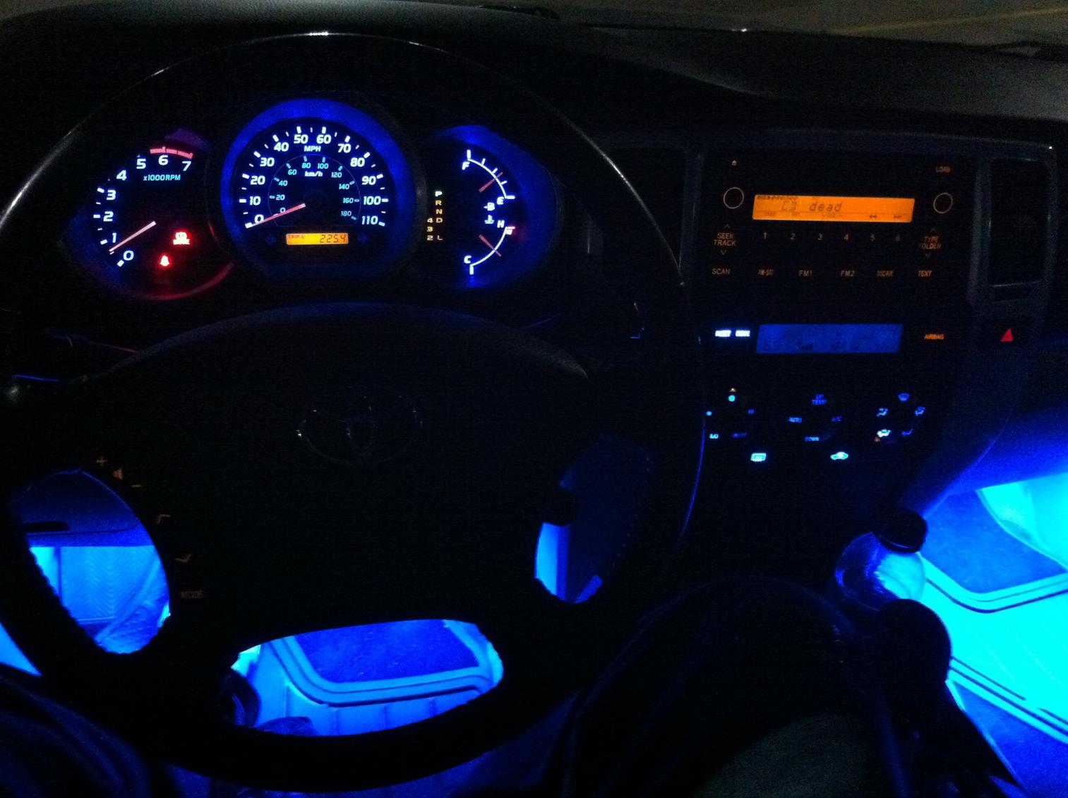

Some info on what I did
Here's one also showing the center shift control display. I added 2 LED's in the cup holder, One in the center glove box, and one in the small cig/power cubby thing. Changed the dash glove box light to blue LED's added a blue LED light bar on each side of the front floor under the dash (those ones blink, flash, scan etc...) 2 LED light bars in the cargo area that are on a blue lighted switch from dash. I can also dim and control all light with the factory dimmer switch.
Many of the areas that I have changed over to blue LED's I added several so it would be much brighter and or got the Hight power LED's and or the 4.5 and 6 led wedge bulbs. My advice is look aty what you have pull out your bulbs and do some looking around online super bright and oznium have lots of bulbs you can just plug in and not have to do all that soldering work. But the dash gauges is a different story I did not solder mine I did a little trick with the flat 505 LED's so I can easily pull out the blue and put it back top factory in just a few min's.
Now what I have not completed is adding LED's to light the door speakers changed out the radio for aftermarket and or just change it to blue, The light for the power window and the steering wheel controls. And a few other thing's I'm sure I am missing :wow:
that haha.

Looks awesome!! Very unique to have the dual colors.
