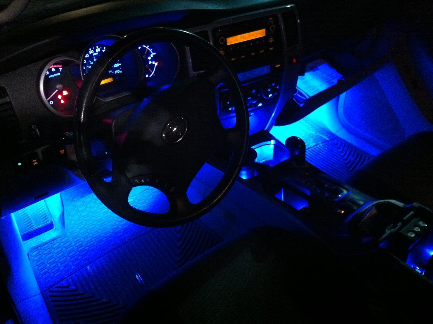

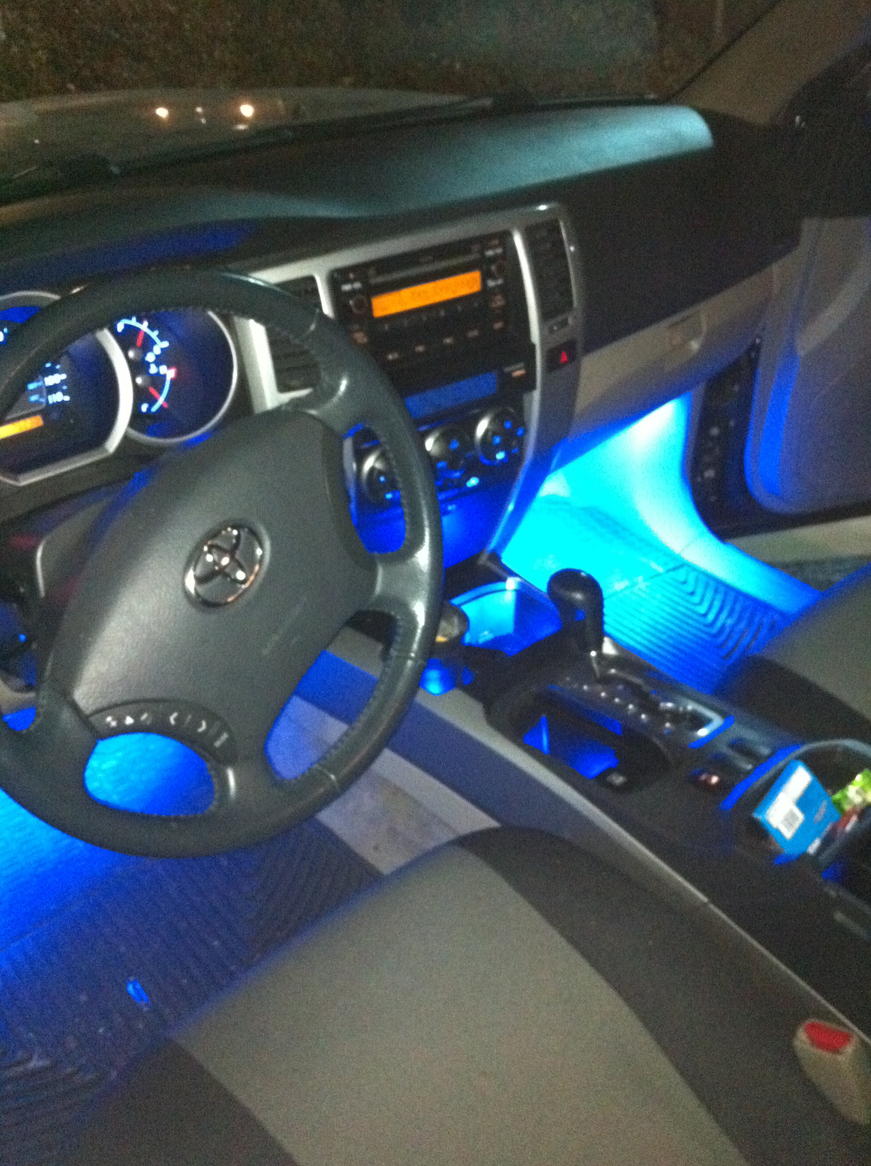

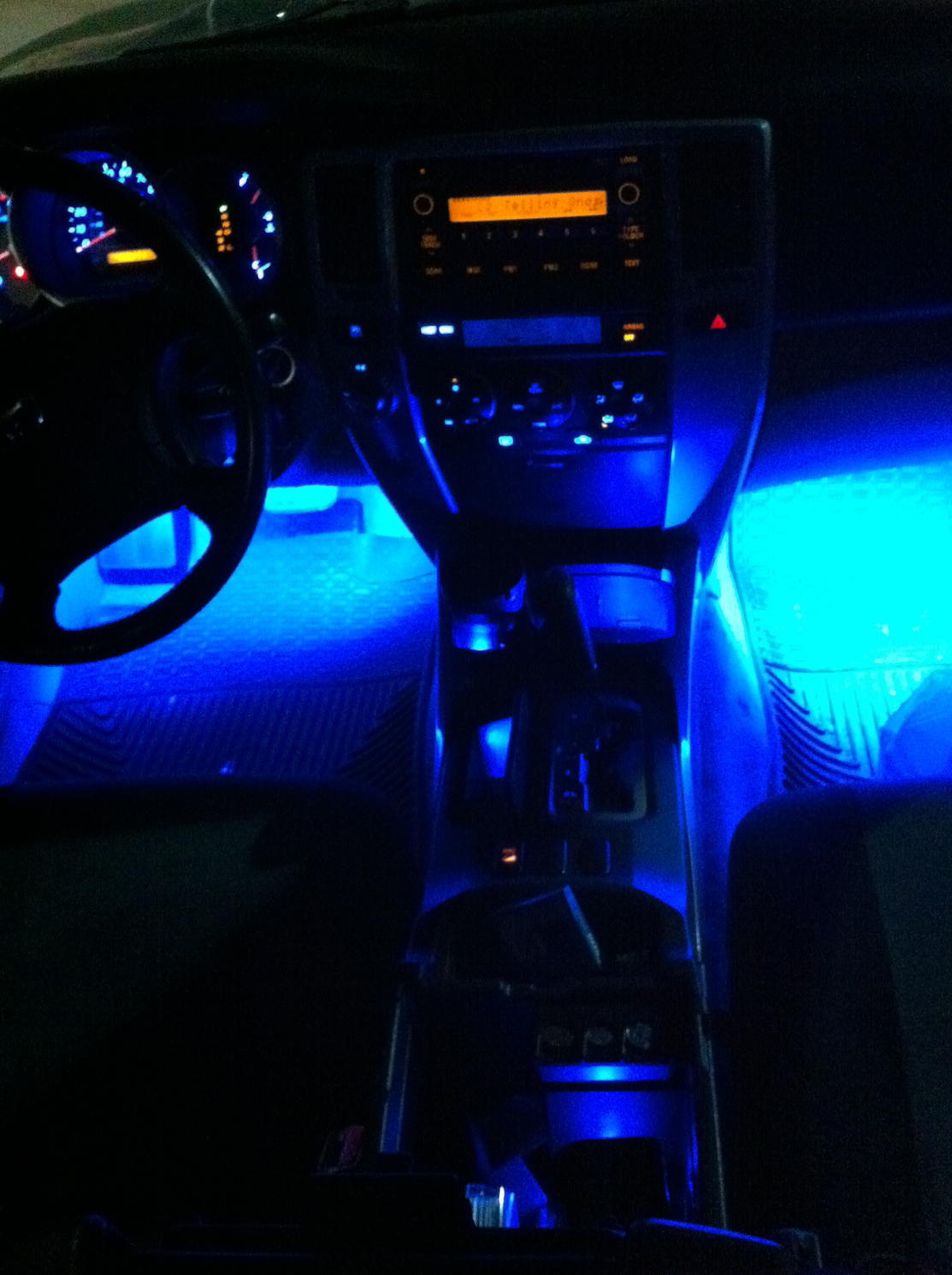

Updated PIC's
Here are some more recent pic's of the LED's. I just got new lights for the center display screen to make it brighter. (need to instal)
Notice on the interior pic the glove box is open and with a blue LED. put 2 lights in the cup holder. added 2 lights in the shifter display (center) have a single led in the ash tray compartment and a 4 chip led in the center console glove box.
The small blue/green light on the dash far left is the switch for the back LED's
I can also control the footwell LED's by a remote control. Also most of the light's are wired through the dimmer (rheostat) switch.

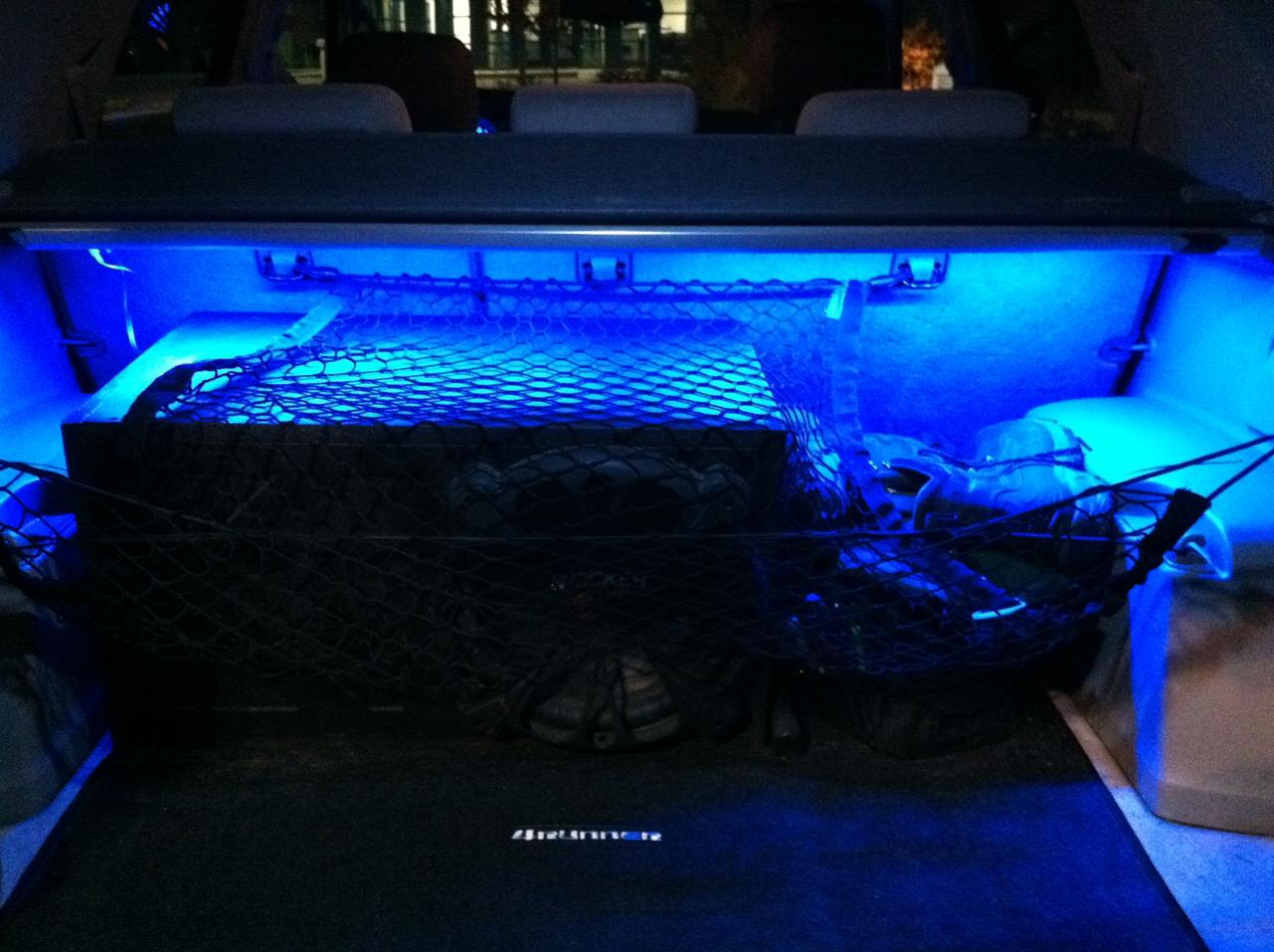

A few more Pic's
Have had a few people ask for pic's.
I would recommend to anybody if you don't feel comfortable about what your doing or you have doubt THEN DON'T DO IT. Anybody can make a mistake so be prepared to pay a price for messing around with your Electronics/Lights/Wiring. A dash mod is not for everybody the center console is pretty straight forward with replacing bulbs you can buy and just plug in but your gauges are a different story. So PLEASE just take care :)

What kind of LEDs did you use for the cup holders and other center console areas (that are relatively easy to do)?
Thanks
Thanks
They were pretty easy to do. Depends on how you want them to turn on? you can wire them to turn on when you interior lights are on, or you can run more wires and add a switch. I have added a toggle switch on the dash I was going to place it on the center console but figure it would get bumped, and when I started the work found it just worked better by the dimmer but also so I could dim them. Here is a switch I used had to cut the back plastic just a little. Scion OEM Style Rocker Switch
Here is a link to the LED's. Tiny Prewired Super Bright Surface Mount LEDs - 12V DIY Plug and Play SMT LED
They come with a 3M sticky back and inline resistor they are pretty small no heat and the wire to them is so thin you can tuck it through the gaps in plastic. They come in lots of colors. I placed them on the back side so you don't see them just the glow.
The light in the center console glove box is this.
12V LED - Pre-wired Waterproof SuperFlux LEDs
I added a rubber grommet to hold it. And there is a small plastic pop out in that box the factory uses for power supply on some models I believe? Mine does not have anything but the stereo hook up in there so this way I did not put a hole in the box it's self.
One thing I did is find a place to run every wire to and put a small amp fuse I used the center area for allot of the light to wire back to and also have some wired back to a fuse at the switch just under the dimmer there is a little room there as well.
There are lots of lights and makers out there so look at some of the pic's give it some thought.
I'm going to use the small flat LED's to light the speaker grills when I get the time.
And TIME was everything on this mod. Take your time make a good connection because it would be a pain to go back and fix a short or something.
I have found the lights are pretty cheap work great and work even if the voltage is not an exact 12v I was worried at first because auto's run as low as 12.Xv to 14.4v (varies on a few things) Hope this helps some.

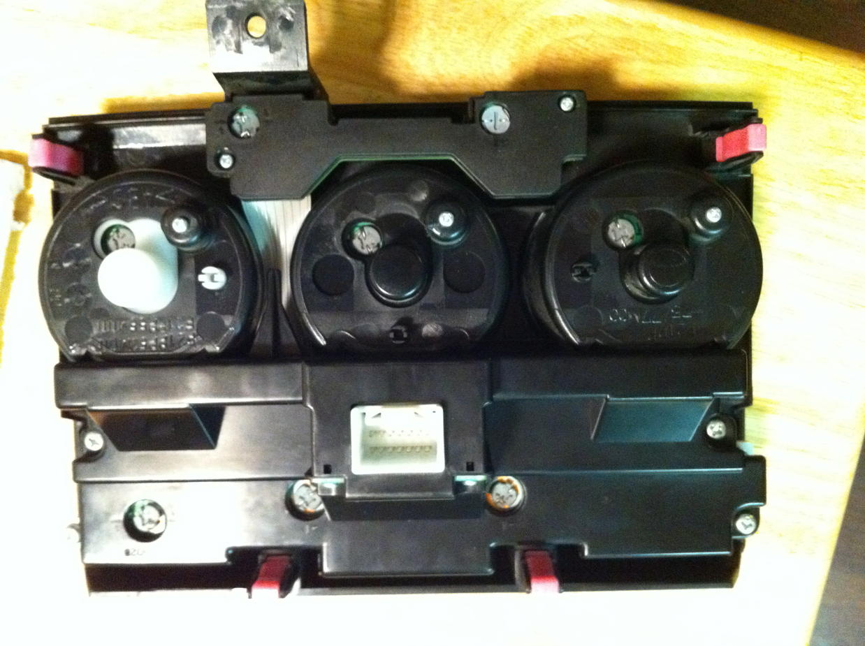

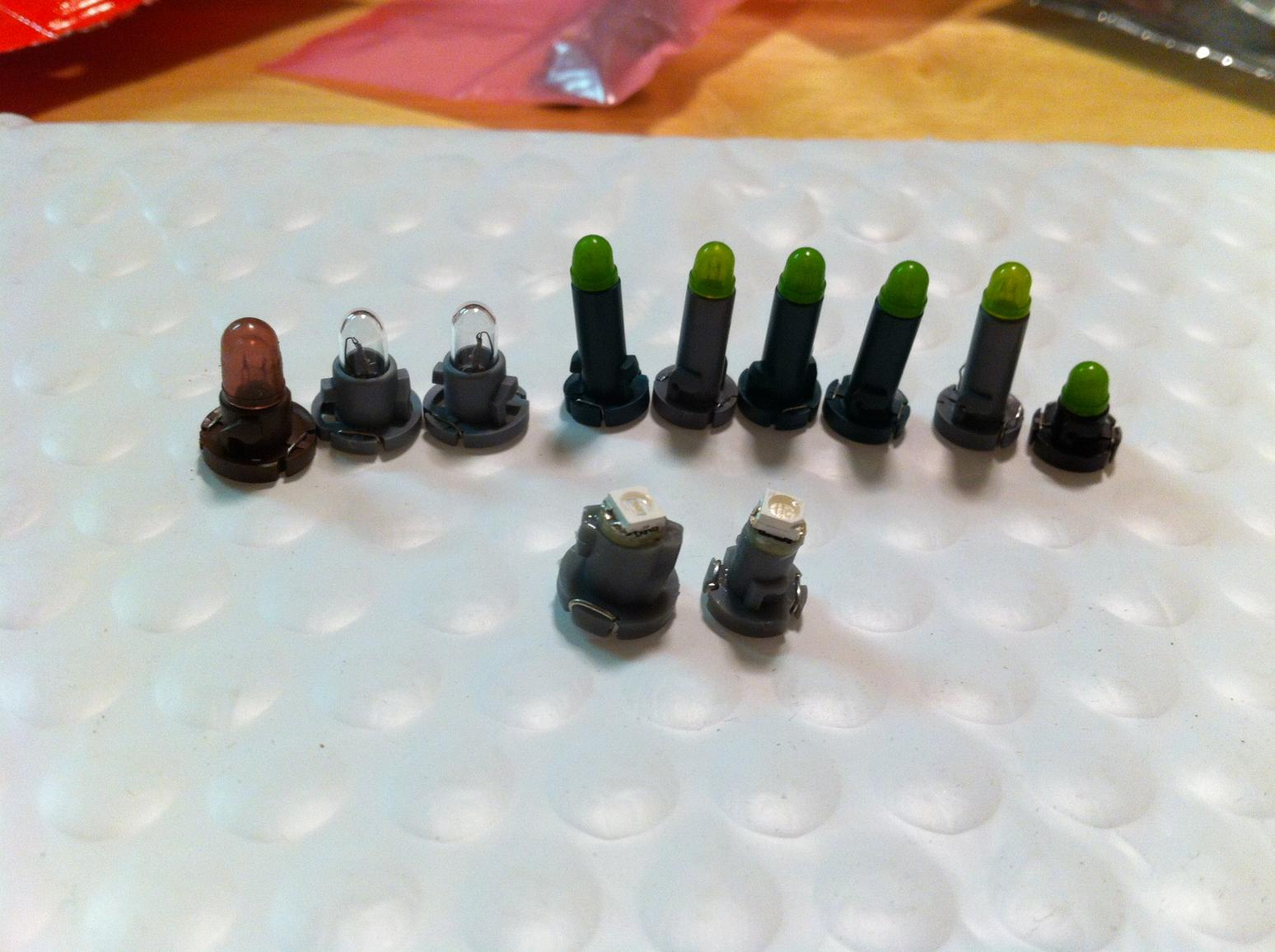

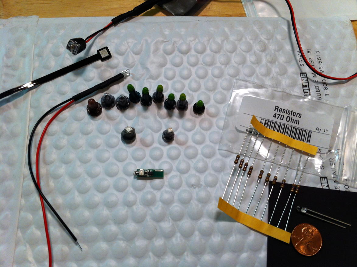

Dash/HVAC... LED's
Here are a few pic's of the factory bulbs and the LED's that replace them.
Here is a link to super bright.
Instrument Cluster and Gauge Backlights - Super Bright LEDs
Also a pic of the back of the HVAC and display unit. The display takes the 4mm
You will want to purchase 3mm and 4mm LED's no need for the 5mm.
And if your wondering if you should get the NEOx-x: NEOx LED Instrument bulb
or the NEOx-xHP: NEOx High Power LED Instrument bulb. I would strongly suggest the High Power ones. If you go for Cool White it may not be as important. But I purchased both and found the high powers to be much better.
In the last picture you will see the light that goes in the glove box and also used for the shifter light. (center of pic) On the right are the resistors and led
top left are 3 different type of prewired with resistor LED's. I really like the flat thin 5050's you can place them just about anywhere and they put out a fairly good amount of light.
