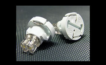

Hi guys i was recenlty looking parts for 4runner but on japanese sites (using google translator to get some english lol) and I found ready to put in LEDs.
Google Translate
it is translated version. If someone who did the swap could just go to this web site and tell if they would fit and work. There are many kinds and sizes on this web site. Thanks. Also if someone speaks japanese please pm me:-)

where are u planning on putting them? and Superbrightleds.com has all the lights that i did the interior swap with. and it cost me only like 20 bucks
Leds
Yeah there are same heheh 4runner 8 could you tell me all names/types of LEDs you have used and did you do the complete interior swap? thnx
i did dome lights, map lights, door lights, and did the mpg and climate control screen hold on let me get the packages i kept

I know this may be a little late, but these type of bulbs will fit and work well with the HVAC unit since the light spread seems to be out the top but they might seem a bit dim for the switches. I initially tried the premade ones and it just didn't match the brightness of everything else.
