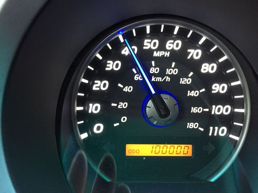

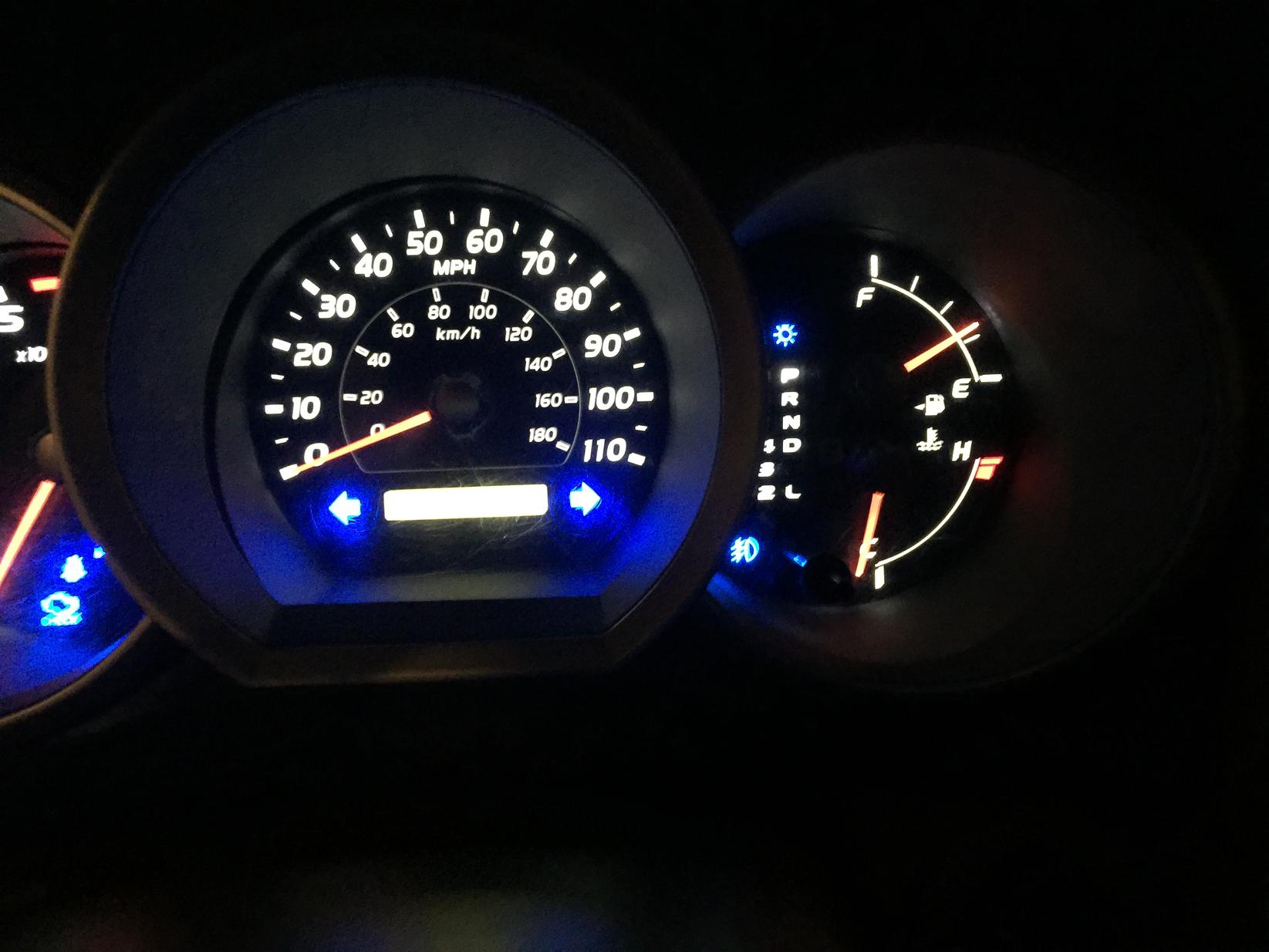

The blue needles on a white background is NOT hard to see during the daytime. I did mine and love it.

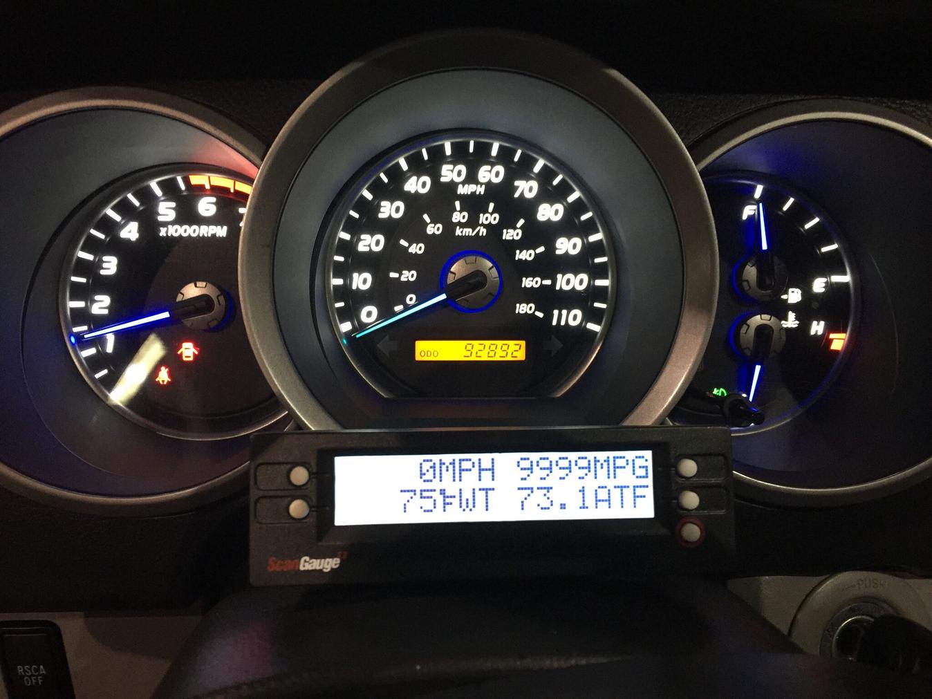

I used this method to get the Neo 4 HP white bulbs in my info display and it worked great. I ended up using the green wire with silver striping for my 12V source. The wire is on the top row, second wire from the passenger side with the white connector oriented the way it is when it is connected to the HVAC. I have a 04 sport and the inner contacts were also the positive side of the board. I just soldered wires to the positive lead on the LEDs, and then taped up the exposed area. I then used a posi-tap to tap into the 12V wire. I feel this is better than using a regular inline tap or soldering since they just screw together and can be unscrewed and screwed back together as many times as you like. I'll post another picture when I get a chance of the 12V wire I used.

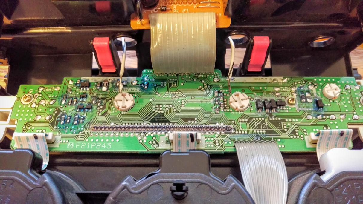

Been lurking a while but this is my first post. This forum is an awesome resource for everything T4R! I got inspired to do the LED color swap on my 2005 4Runner Sport V8. Using a lot of info from this forum and some extra tinkering, I've gotten the high brightness neo4's working at full brightness 12V with dimming control. They actually look pretty close to the factory brightness when compared to the factory radio backlight.
attachment.php
As many people found, the neo4 high brightness LED's don't work in the HVAC backlight as it only gets about 6.5-7 volts not 12v. For some reason all the Neo3’s that backlight the knobs and buttons get full 12v but not the backlight for the LCD display itself. I did some tinkering trying to get the Neo4 High brightness LED's working. Many car dimmers that I've seen in the past use a PWM (pulse width modulated) negative side Transistor or Mosfet to control Brightness. I took my Oscilloscope out to the truck and confirmed that it seams to operate that way on my t4r. So the Ground side where the Neo4's plug in is the actual source of the dimming and we just need a straight 12v source for the positive side of the neo4... Make sure to disconnect the positive side of the neo4 from the circuit board contact before you give it 12V otherwise all sorts of bad stuff could happen. I just completely un-wrapped the positive wire out of the neo4 plastic housing and left it sticking straight out the back. Here’s what it looks like:
attachment.php
You can see that on my 05 sport HVAC control, the inner side of the neo4 plugin (ie closer to center of the board) are the positive sides. This may be different for the Limited edition as it is fairly different from the HVAC console on the Sport edition. You need to figure out which side of the Neo4 is positive as they are polarity sensitive. You can figure out which is the positive side of the neo4 using a 9 volt battery or some such. I then soldered a wire from a 12v source to the leads that are now sticking out and are isolated from the circuit board. The 12v source I tracked down and decided to use was pin 14 on the thick ribbon cable that goes from the small board where the main wiring harness plugs in to the board that runs the display.

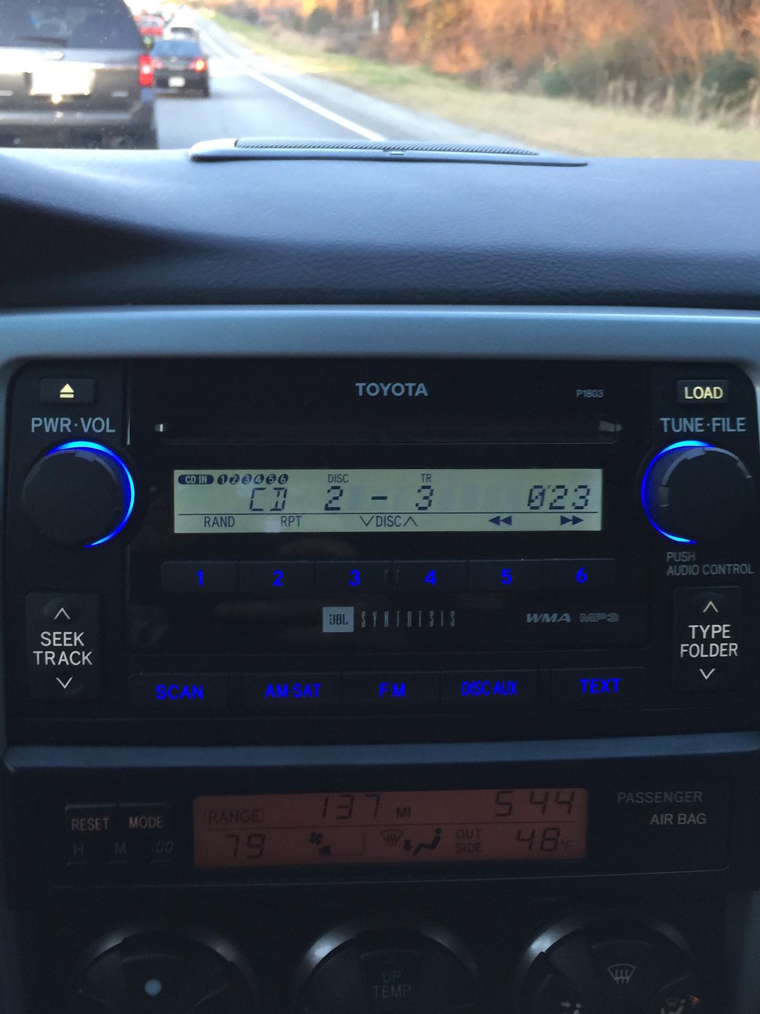

Finally got a little time to mess with the radio. The black push down clamps for the white connector were the issue. I didn't see that when you push down one side at a time it pushes the other side out. I'm in the middle of soldering the leds behind the lcd right now. Anyone done this before? I got the LEDs to light up soldering them sideways. Not sure how it will turn out since the other LEDs had the plastic on the side. Wife wanted to go to the movies so I'll post an update when I'm finished.
The leds for the lcd screen are soldered on sideways. Here is mine after replacing the leds.
Thanks. Phone died so I didn't get a picture but everything turned out great. The lcd screen looks brand new. Haven't seen it like that in years. Took a blow dryer to the lcd ribbon (the black cushion sandwiched between 2 white cushion looking things). After heating them up pushed them into the glass to get the ribbon to stick all the way across. Also made sure to clamp it down extremely tight to the circuit board when putting everything back together. Thanks!
Finally got a picture of the final product. Really happy with the lcd screen but not too sure about the color combination. I'll wait until the hvac is done to decide if I want to switch any of the colors.
