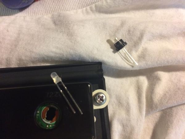

Can someone help me figure out why I am getting a flashing LED for the driver's window switch?
I have soldered a standard 3mm LED on in place of the existing amber one.
I got the LEDs from this site: http://www.led-switch.com/3mm LED.htm
3mm White With White Diffused Lens
I have also tried some with the resistors built in (12V 3mm) and they also flash.
It is a slow flash - 2 slow flashes with a longer pause in between.
Is there a specific LED that I need for this switch backlight?
were you shipped the flashing ones?

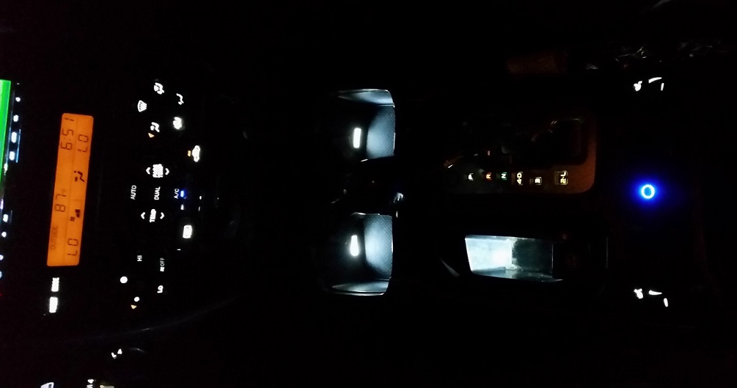

I changed the HVAC indicators to blue, and the backlighting white, I love it..
My only complaint is on the HVAC the back lighting is brighter in certain spots than others.. I assume that is because of the location of the LED in all three knobs, I used NEO3s.. Is there a solution to that or is that just what it is????
thanks..
You are talking about "hot spots". They are inevitable b/c LED throw directional light. A regular incandescent bulb is omnidirectional. So, a light disperser would be needed, only there is a very limited amount of space in the HVAC assembly.
My 12V mod: I re-engineered my HVAC screen. I had reverse-polarized film installed on the screen, so the factory light (or any LED bulb) practically did nothing to illuminate the screen. Like I said, I gutted the assembly to accommodate LED strips. Problem with that, is that I got MASSIVE hot spots.
Gutted inside the HVAC panel:
Desired effect, only TONS dimmer: (looks good here b/c the pic was taken with very little light. At night, the display looked awesome. In the daytime, it was bearly visible)
I WILL make adjustments to my HVAC lighting, I just have to find the time to do it. i purchased more dense LED strips AND got light disperser. That should do the trick.
If not, well, as James May would say, "C*CK!:
