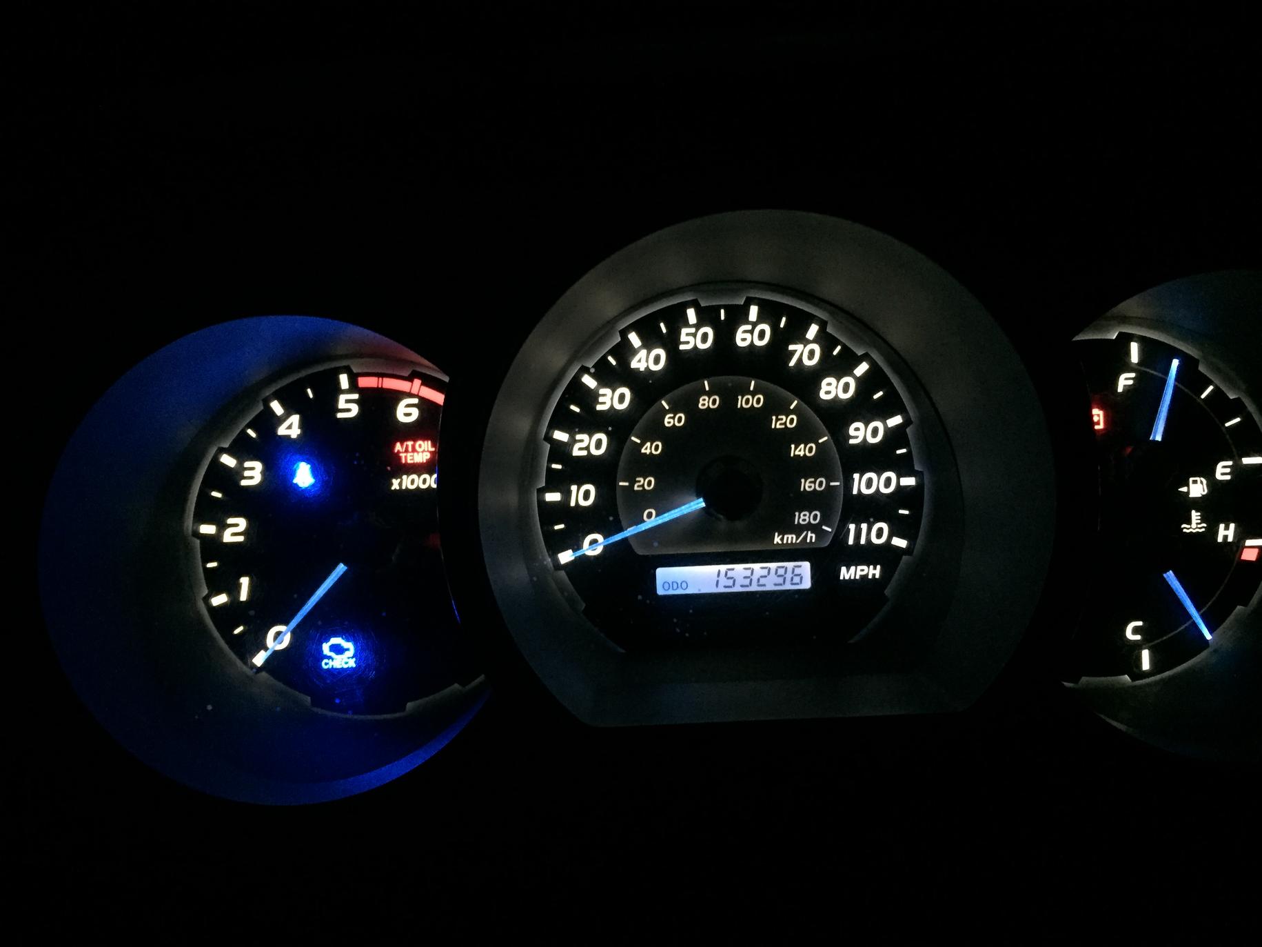

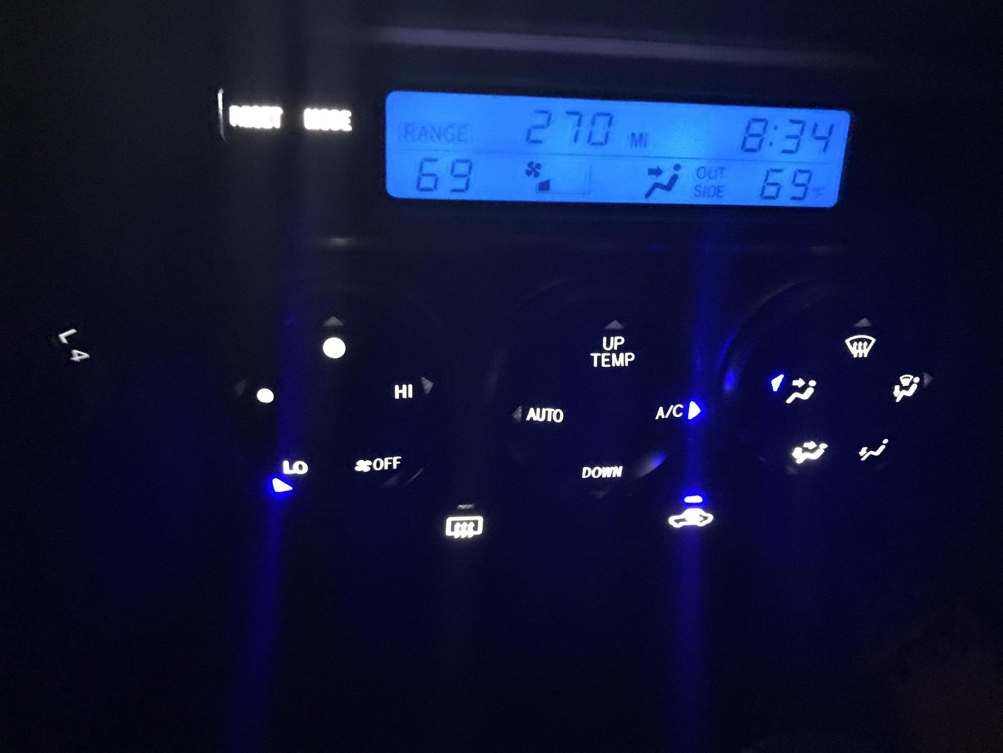

Can you post a pic of the blue? And they're just plug and play no 12v mod needed?
here you go.
I like that one sparky. But I would have to do the digital mileage reader on the cluster that color too.
Not being a limited the white bleeds into it some, however still looks good, and like all pics it's better in person!

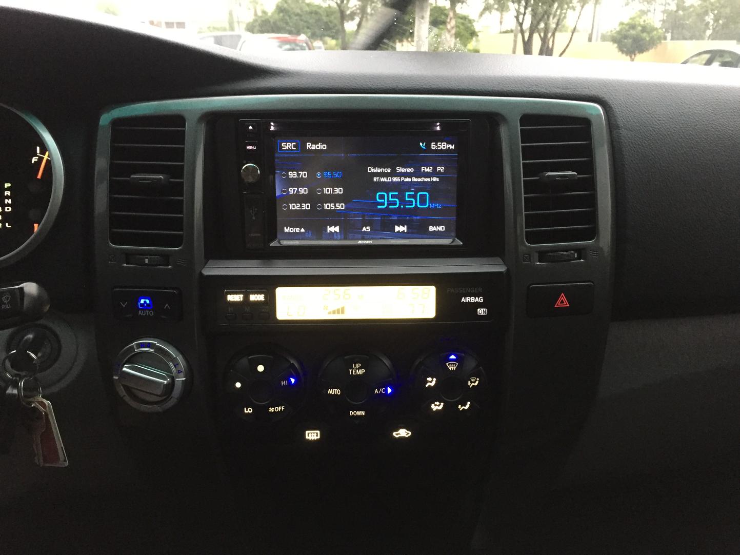

I did the 12v mod for neo4 hp bulbs.
Pretty simple. Separate the positives on the LEDs. Solder wire to them. Run to a 12 volt source. I chose my accessory wire on my head units wiring harness. I used a male/female connector so I could remove it easier.
I originally tapped into the hvac wiring harness but wasn't sure which wire. (Always thought red or yellow was 12v) but I wasn't getting anything. So I moved to the wiring harness where I knew the 12v was coming from. I ended up getting the pos/neg backwards on the led like a dope. So when I had it wired it wasn't doing anything. Swapped the sides of the LEDs and viola.
In hindsight, a Multi meter would of probably helped.
How did you find the polarity of the LEDs? I tried using a multimeter and I also dont see any markings.
