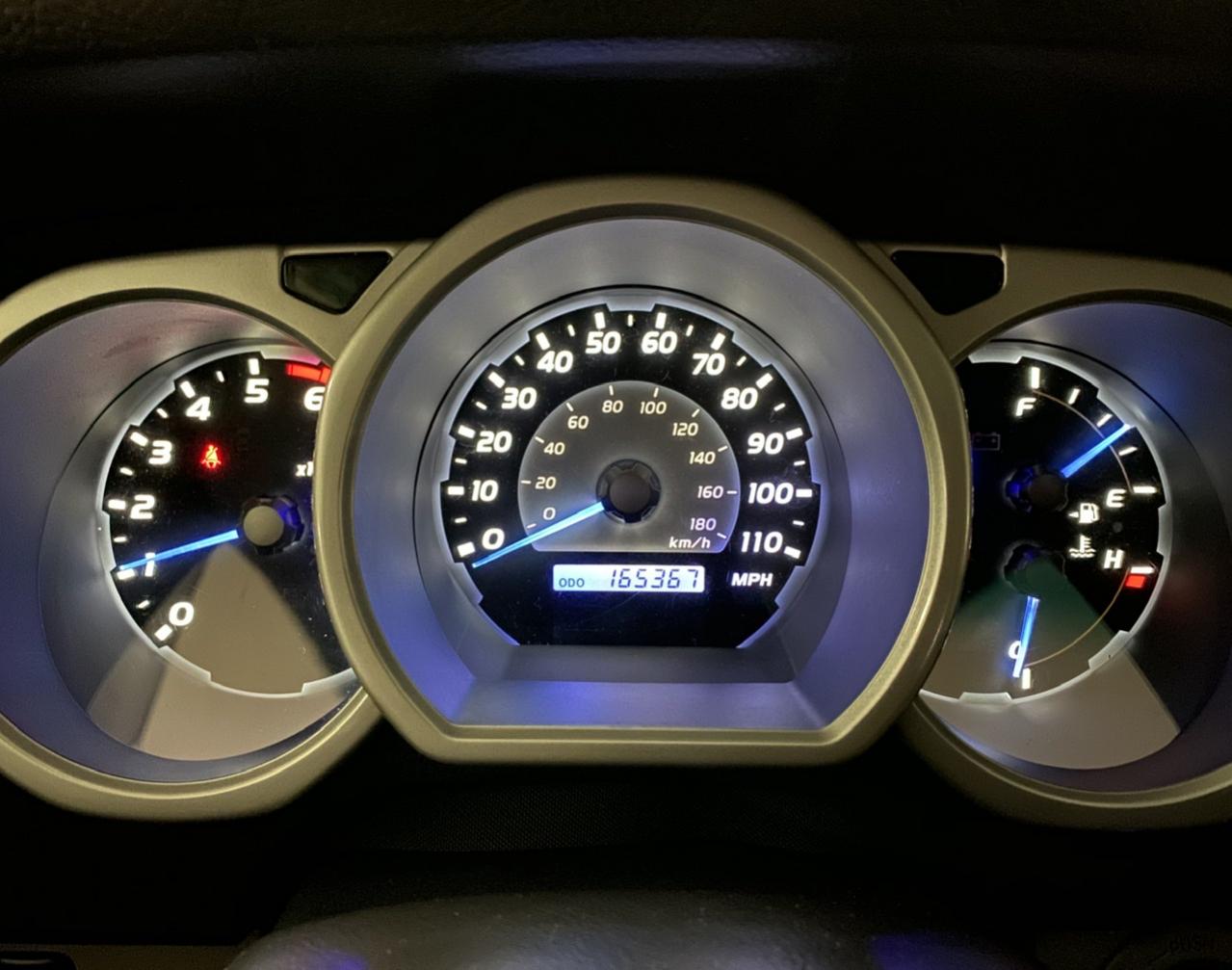

I tried to attach a pic so hopefully it shows up. I’m trying to see what model comes with this cluster. Instead of the background being all black this one also have some grey rings.
Not sure why you are interested in which model comes with that cluster. I'm sure you know that is not how they come from the factory. That looks to be an SR5 or Sport. Limited clusters are a little different. IN any case, whatever color you want it to light up is completely up to you regardless of whether it is an SR5, Sport or Limited. The way they come from the factory is kinda dated (orange/yellow light) looking, and changing it refreshes it bigtime.
