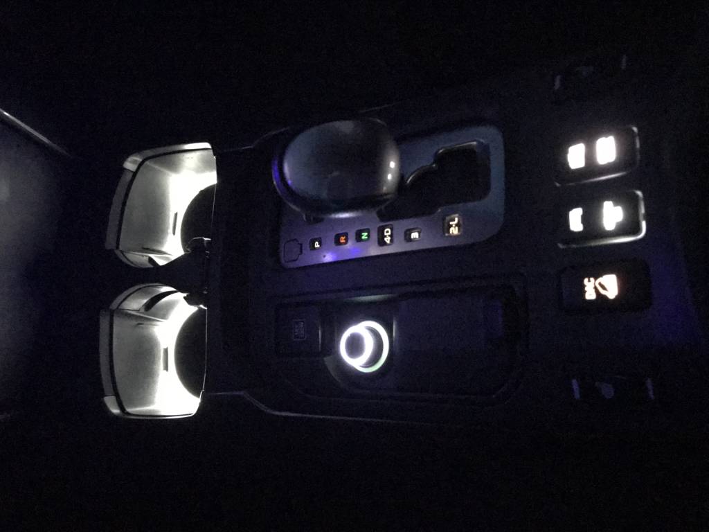

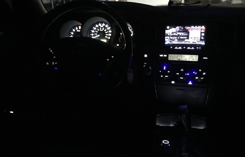

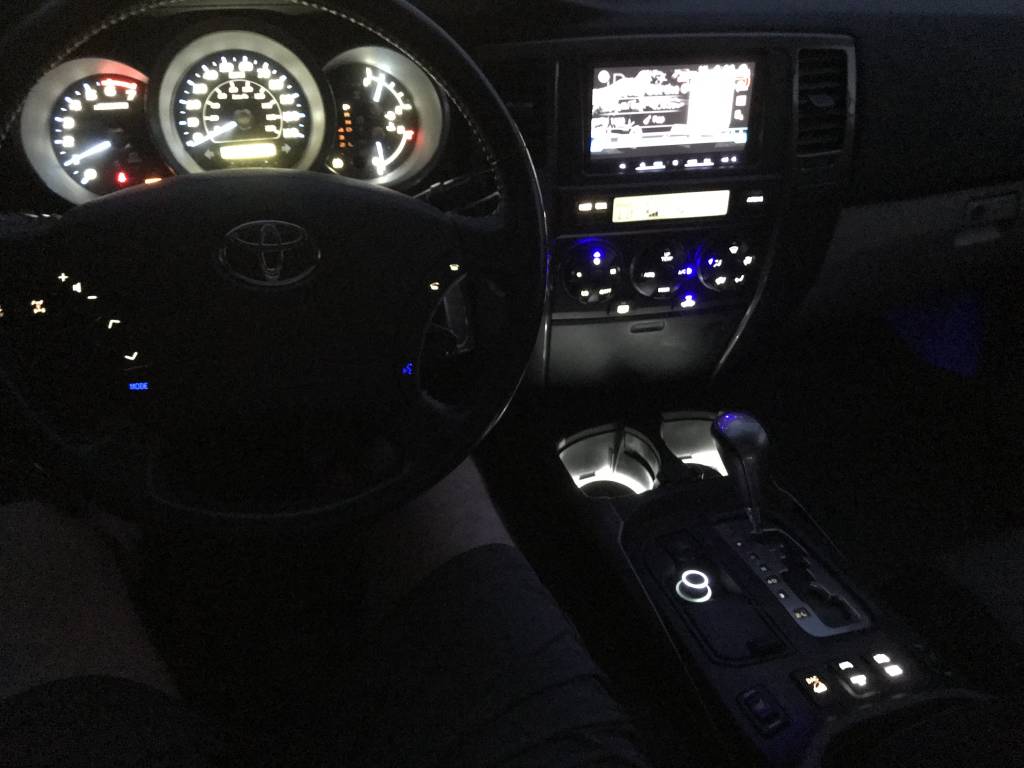

I love all of the mods posted on here, it's really motivated to do my own. Check it out. 1st pic shows the new switches I installed, a switch for the LED light bar and a switch for the rear camera instant on (comes in real handy when try to hook up the trailer). Also installed cup holder led discs as well as 4runner smokers kit with USB chargers with led rings instead of cigarette lighter. I really like how it turned out. Other pics show led swap outs on dash. Pictures don't do it justice.
