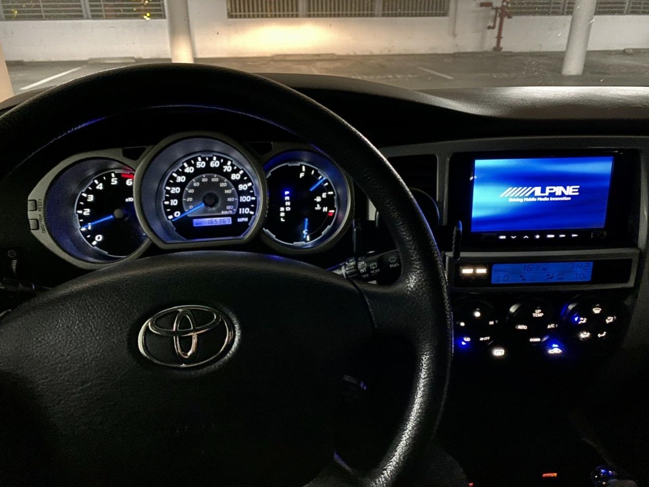

I love all of the mods posted on here, it's really motivated to do my own. Check it out. 1st pic shows the new switches I installed, a switch for the LED light bar and a switch for the rear camera instant on (comes in real handy when try to hook up the trailer). Also installed cup holder led discs as well as 4runner smokers kit with USB chargers with led rings instead of cigarette lighter. I really like how it turned out. Other pics show led swap outs on dash. Pictures don't do it justice.
Wow this is pretty nice ! More detail please on cup holder rings etc

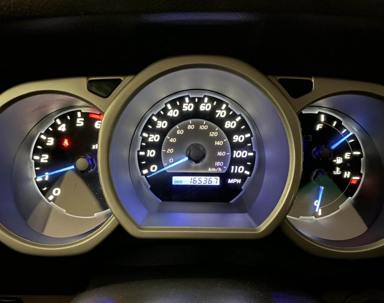

Thanks to all the tips gained reading this entire thread (no small feat) I did my HVAC cluster plus some others on a rainy Saturday.
Couple minor things I learned to add here:
All my LED's were from Superbright. I emailed them before buying and despite them saying their blue Neo4 should work at 6V for the display, they did not. They did however look great w/ zero hotspots after I did the 12v mod.
