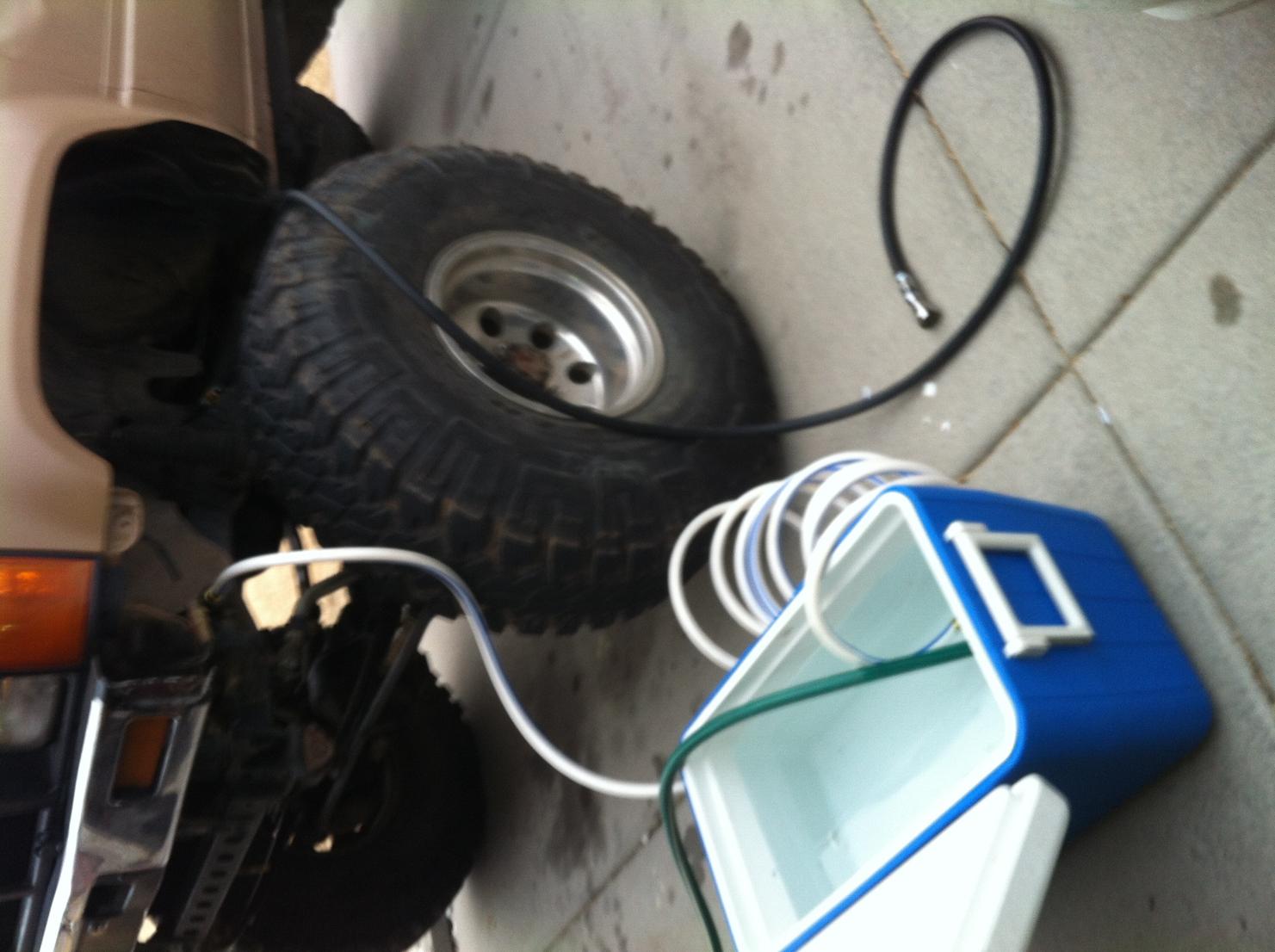

Got a chance to snap a couple more pics today..

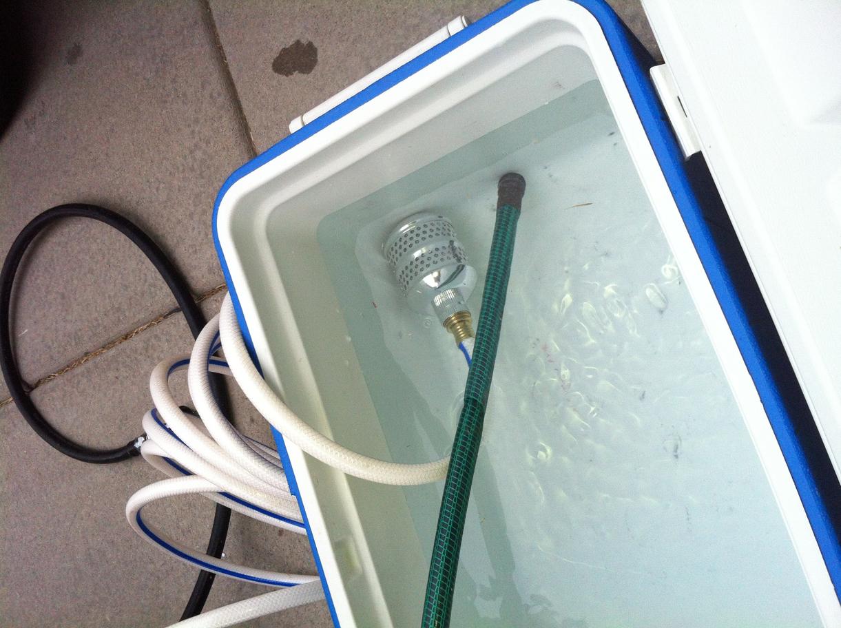

I have 3 filters before the pump. The first is the big chrome one, its actually a "gental soaker" made for dense watering of trees and shrubs.. But seems the right thing for the first stage of filtering... The other two filters are screen filters that I put in the intake hose on both ends.. With the finest mesh one on the side that connects to the truck. I'm also considering using a small bucket with holes drilled in it near the top (so it can still be used as a bucket for whatever else) to place in the water with a rock to keep it in place, then putting the inlet in that.. So it keeps even the biggest stuff off the intake and keeps the intake from sucking anything off the bottom of the stream/lake.. Plus serve as a simple place to keep any shower things; hoses mainly but whatever else as well.

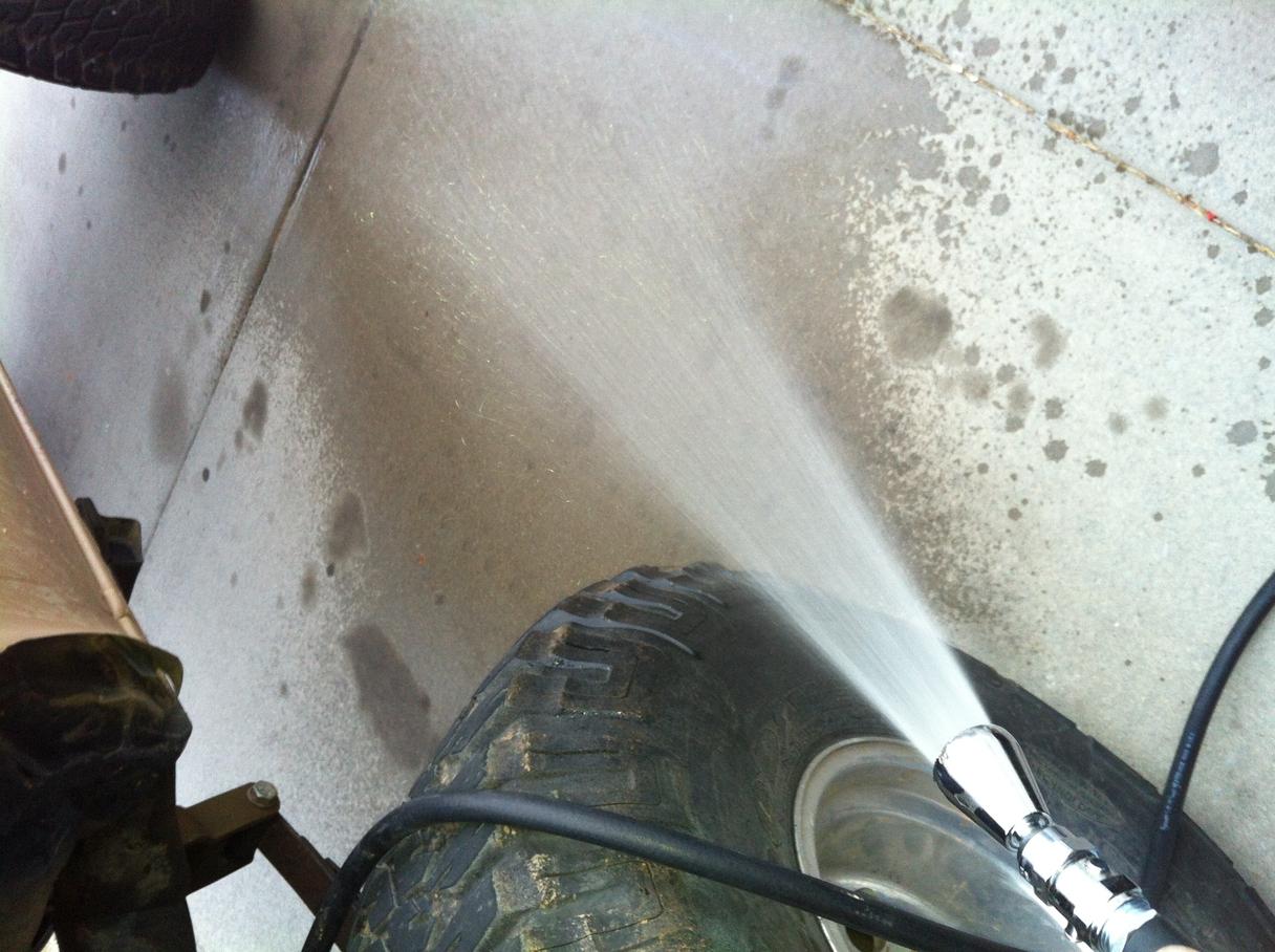

And one of it in action, it was about 50deg out when I took the pic. You can kinda see the steam comming off, but it was windy too.

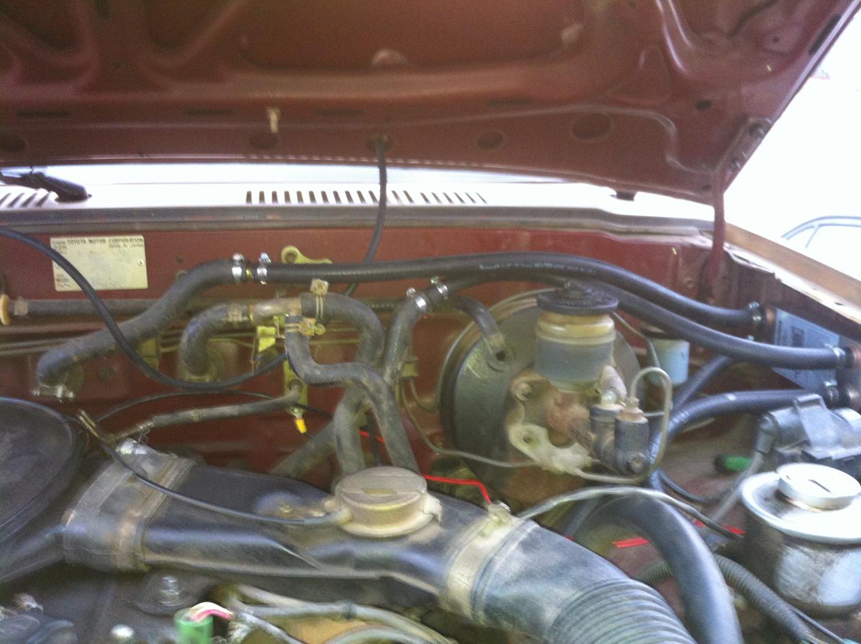

A closer pic of how its connected from the heatercore to the HEX. I know its not that great a pic, but its kind of hard to show.
The writeup of the whole system plus a simple drawn schematic is soon to be posted. Let me know of any details you'd like to be covered closely! I'll do my best to answer them! Of course I'm sure allot of you guys could blow me away with details and exact stats of what I put together, but what I know is; it works great! Its not very hard to do and its gonna make me a happy camper! Lol

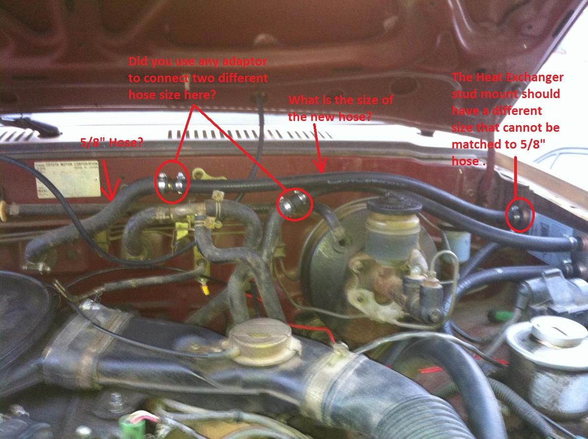

What is the original size of the heater core hose? Should it be 5/8" ?
Did you use any adapter to connect the original heater core hose to the Heat Exchanger?
Thanks
