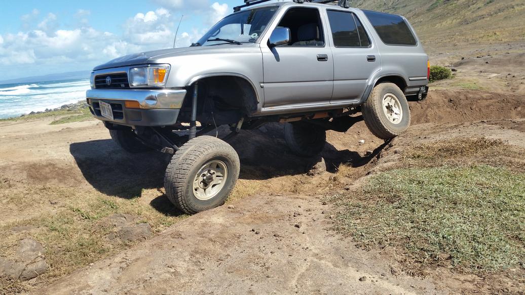

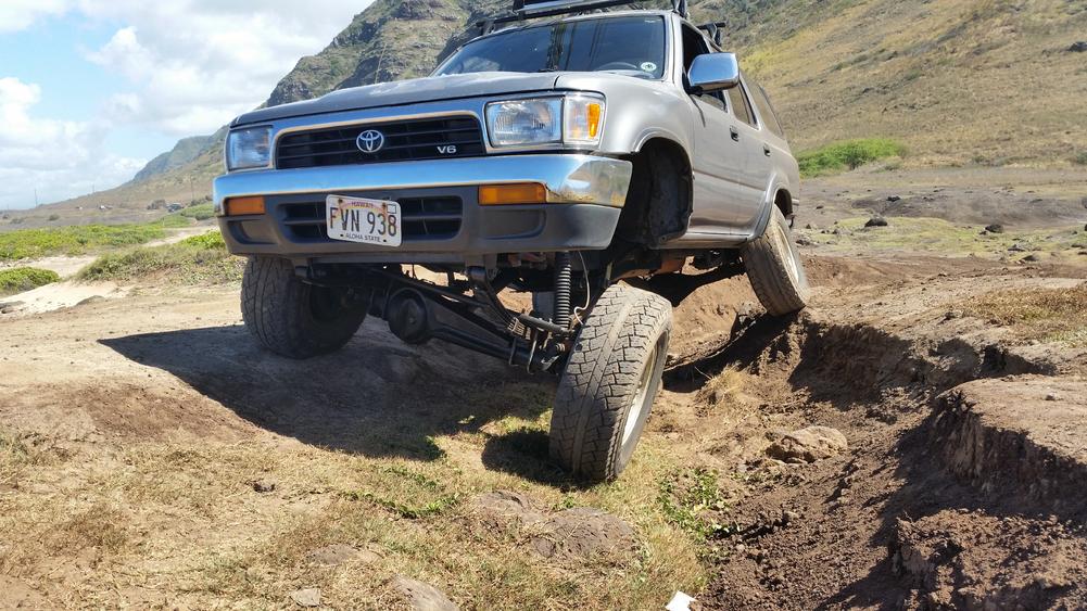

Nice!! Just went through the same process. finished my swap a month ago. 3" tg HD springs up front with 4" on rear. Stoked to see the rest of your build good luck bro. Check out my set up. Running stock tires for now to break in but got my 36 iroks coming
