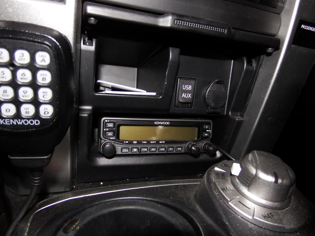

The V71 fits pretty well within the cubby below the radio. But it is sometimes difficult to read. I have the body of the radio underneath the passenger seat, and the separation cable is run up underneath the console trim.

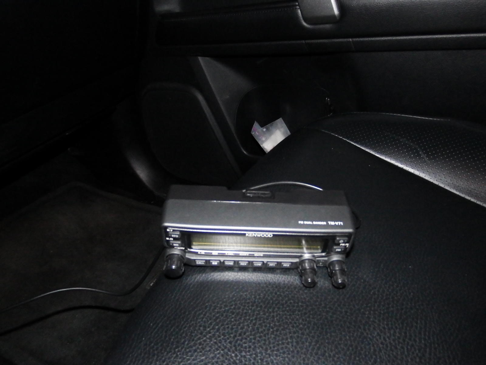

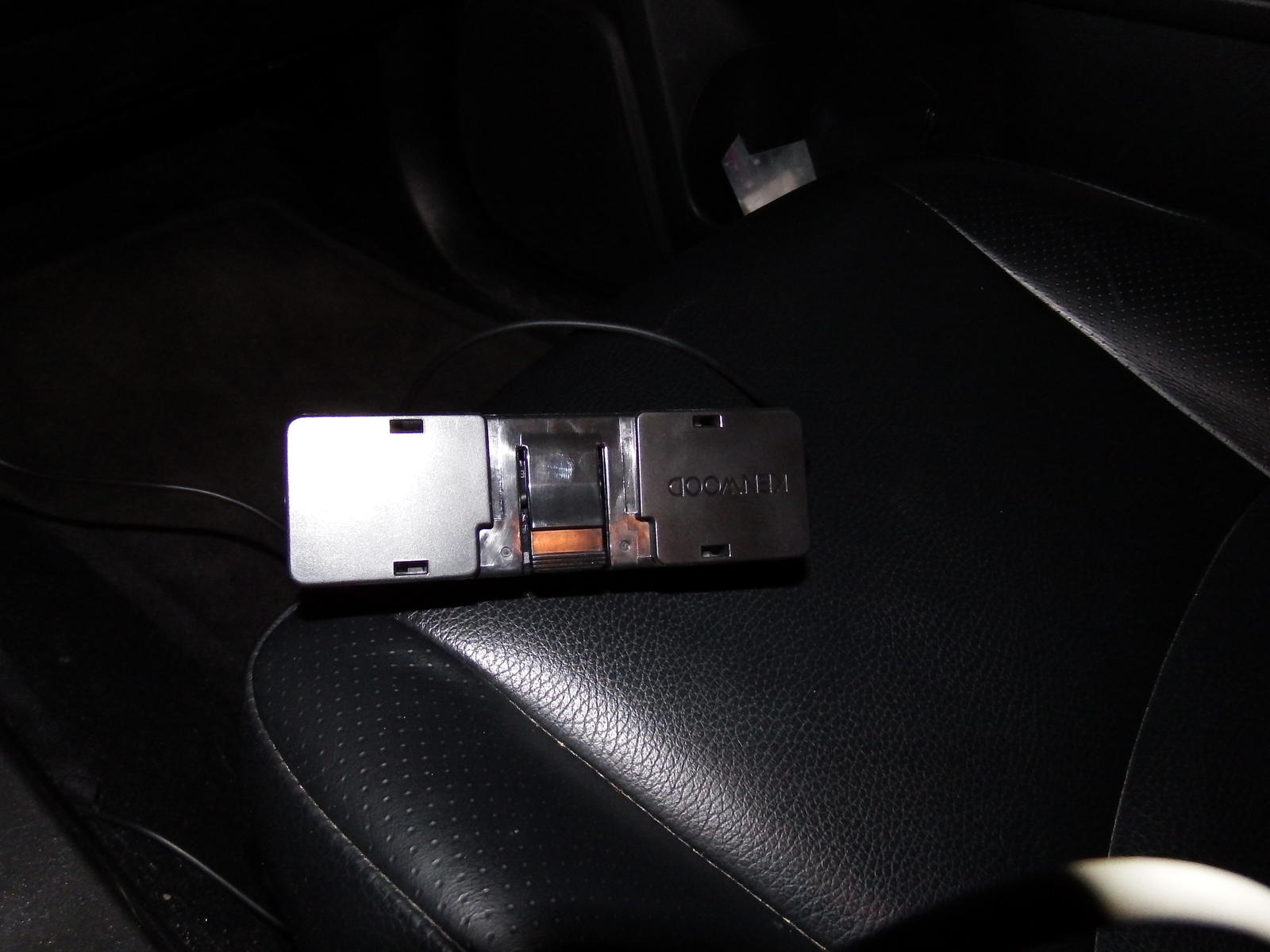

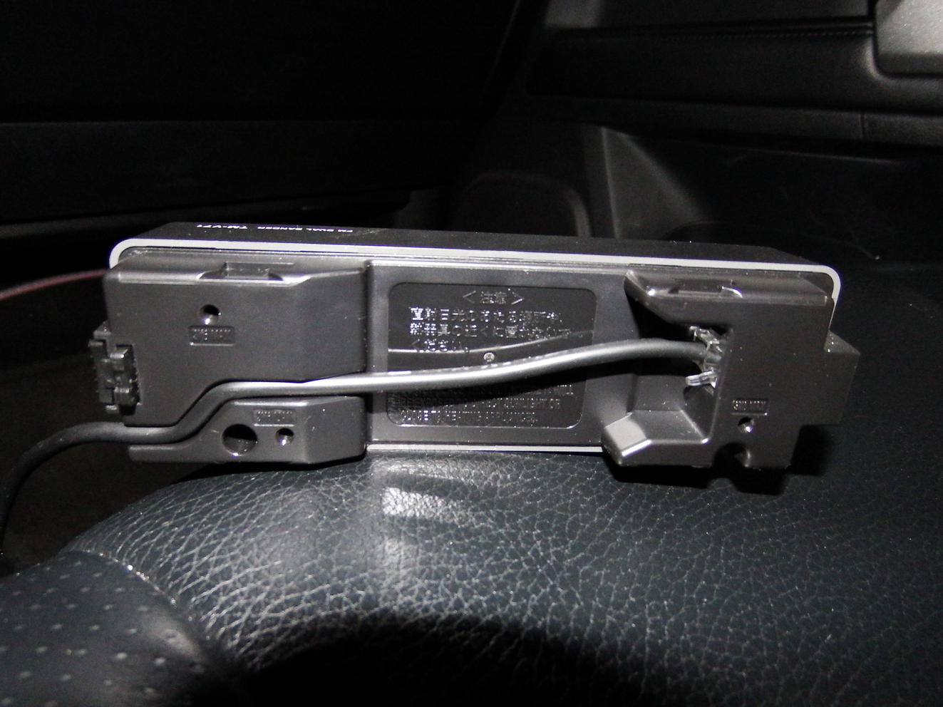

Attached is a shot of the back of the faceplate with the sep kit back removed, and a shot with it attached. The darker portion at the back is the sep kit back.

Attached is pic of the V71 with the sep kit back in place for comparison. It is upside down, because it can be installed both ways if you want the display flipped.
