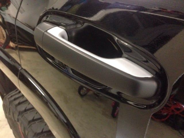

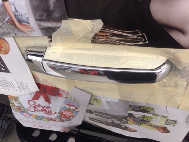

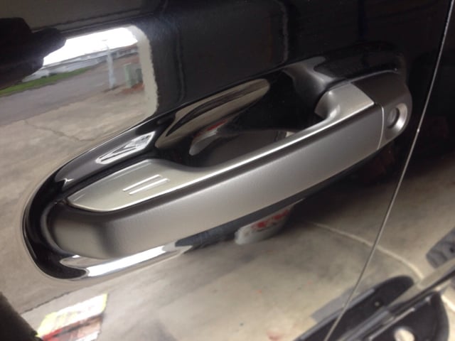

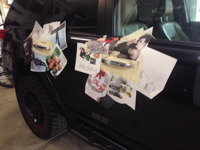

Not sure if I'm the first to rock the two tone handles. But I was afraid of how the sensitivity of the Limited no touch system would be. So I decided to only plastidip the chrome part.
Prep is always key
And the result
Turned out ok. But that's the last of the chrome.
I should really get a job soon.
Plastidip doesn't affect the limited no touch system at all. Also you just needed to cover the outside parts of the full door handle and spray everything. The inside part will come off with a perfect line versus the chrome and vice versa. I know because you will find the plastidip starts to wear as your tugging on it while opening the door over and over again. I have had to spray the driver's side many times and for a few weeks actually peeled parts off to look like your finished product. Feel free to spray and peel.
Looks good...might get back to that look in a few weeks as mine is peeling again.
This is another reason I didn't want to do the silver part. I witnessed another members handles pealing from the backside from opening the door. And it's not that easy to get a good coat of plastidip on the back side of the handle without removing the handles from the doors.
After typing that and proofreading, I'm not sure I want to 'witness another members handle...from the backside'.
I hear you...luckily - it peels right off and makes perfect lines/transitions to what you've done. I will probably end up back where you're at...though all black looks really good.
