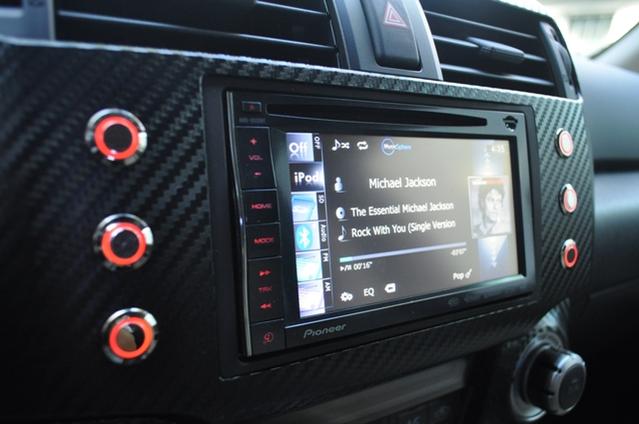

I know there are a lot of questions about the headlights, but that's going to take some time in explanation. So, I'm going to get into the interior stuff and why I chose to do what I did.

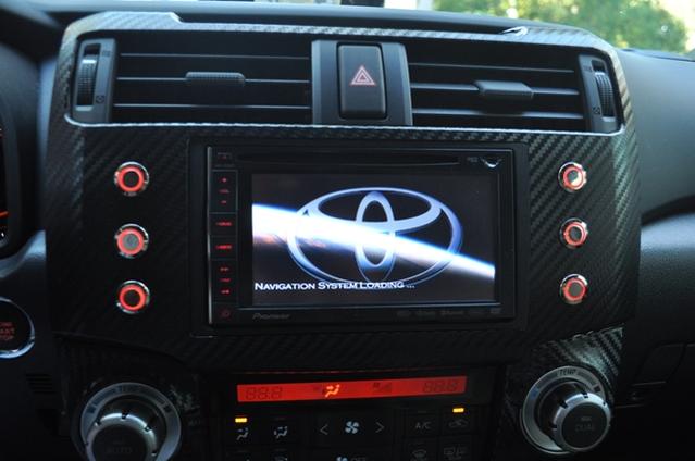

First of all, had to change out the nav system. It wasn't because I didn't like it, well, it was, but I really hated the operating system when it came to ipod use. It flat out sucks. Who wants to scroll through your entire list of music while driving?!
So I chose to use the Pioneer AVIC920BT. Why didn't I just go all out and get the bad mama jama 120? Well, I've got a friend in the biz so he got me the headunit, wiring harness, steering wheel harness, dash kit, etc for $400. Yup! That's why. Anyway, I really didn't like the HUGE GAPING space on either side of the head unit so I added switches. Originally, I had just regular round rockers with a red led (of course, red) and it looked ok. It still looked ginormous so I went with the dinoc vinyl (thanks, to you Harper). Then I found these switches from Oracle that had a great led round push button leds. The four top most switches are regular and the bottom 2 are momentary (hopefully for a train horn, soon).
Duc,
Nice job!
Question: I was told by some folks in the know at a certain company in Virginia that replacing the factory head unit would cause you to lose certain functions.
He said that, even with the kit for using the steering wheel controls, I would still lose the ones that control the phone. He also said that I would need to install new satellite radio and GPS antennae. He finally said I would need to install a new backup camera.
Needless to say, that was a real putoff...:nono:
My question to you is, how did you deal with these issues, assuming you ran into them at all?

Thanks! I'm not sure this certain person in a certain place in Virginia has the knowledge of aftermarket radios. At least not in what has changed recently. I did lose some phone control functions but this was 5 years ago. I would think that newer head units and integration wiring harnesses have gotten better. I am currently using the factory back up camera wired directly to it from the head unit. If you're buying a new head unit specifically for sat radio and or gps, it should come with the necessary antenna or at least have that option from the manufacturer of the head unit.
Best thing to do would be to find a reputable aftermarket stereo shop to address your questions. That means... not Best Buy unless you know the install tech or supervisor personally.
