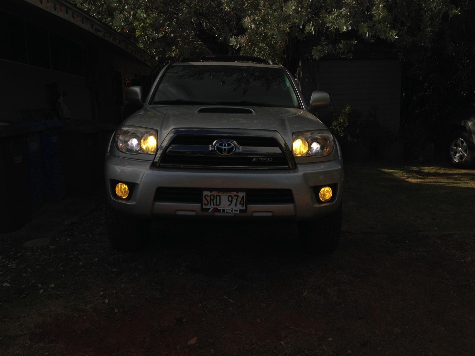

last weekend i did the fog mod and installed nokya 2500k bulbs in my fogs and highs.

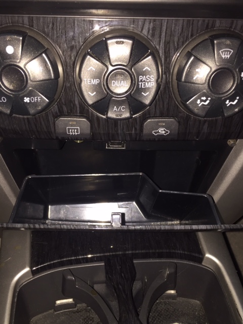

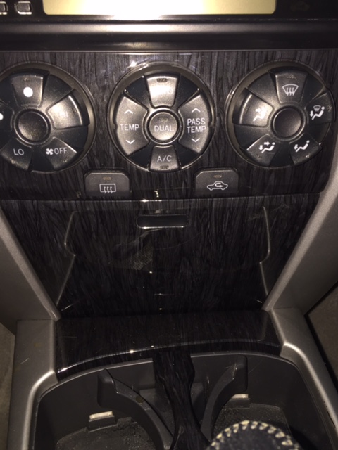

Just put in HVAC and speedometer LEDs from SB and Lighthouse. They look great and the HVAC cluster can easily be done in 10 minutes. Went for all white and red info display, which is more red in person.
How do you remove the console to get leds in there?

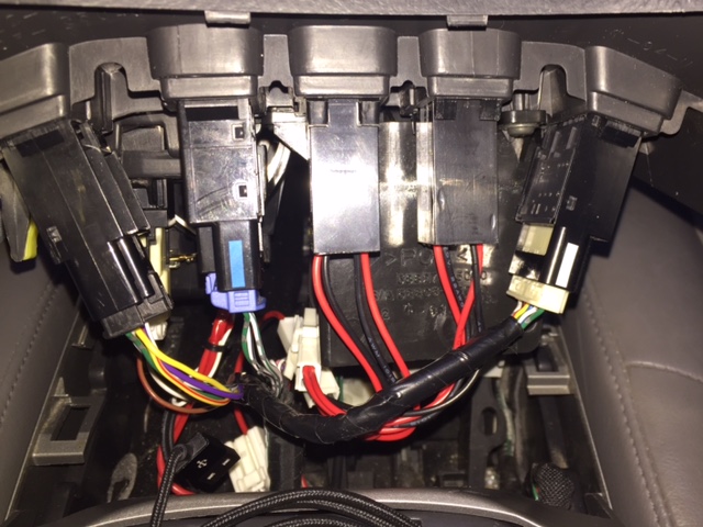

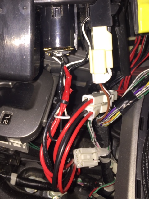

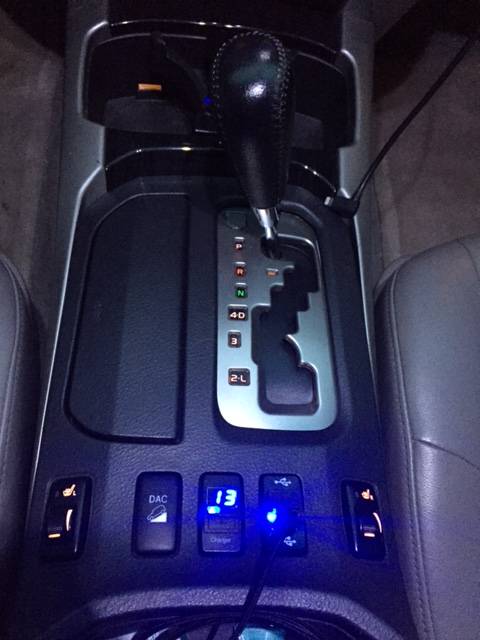

Installed Mictuning USB ports in the center console. About an hours work.
Tapped power from the cigarette lighter (10 Amp) which I never use anyway.
One has the voltmeter which is a nice feature. Each is rated at 2.1 amps so no threat of popping the lighter fuse.
Chose blue as I'll be doing the dash lighting shortly.
Do you have more pics about how to do this? and a product list?
I bought them on Amazon.
Put "Toyota USB" into the search bar and dozens pop up.
Straight forward install. They simply pop into the existing knock outs.
The i just tapped into the cigarette lighters +/- wire and that's it.
Tie the reds together and the blacks together. Then just plug them in.

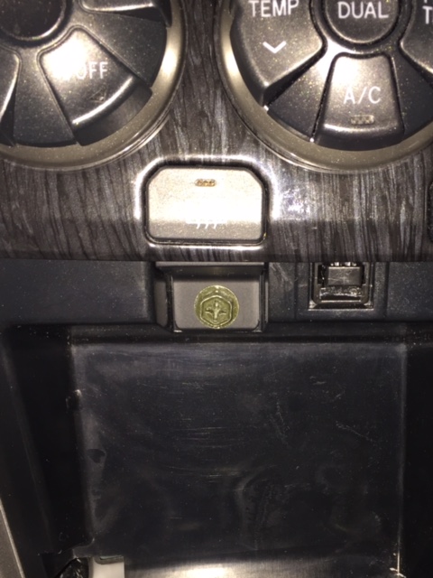

In my '06 Ltd, just below the controls behind the storage bin, one screw holds it in. Remove the screw an then just pull from below. The rest is a snap in thing.

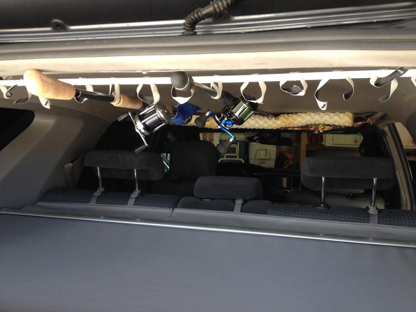

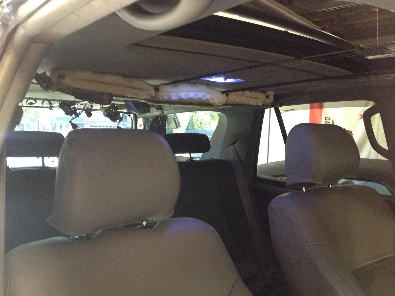

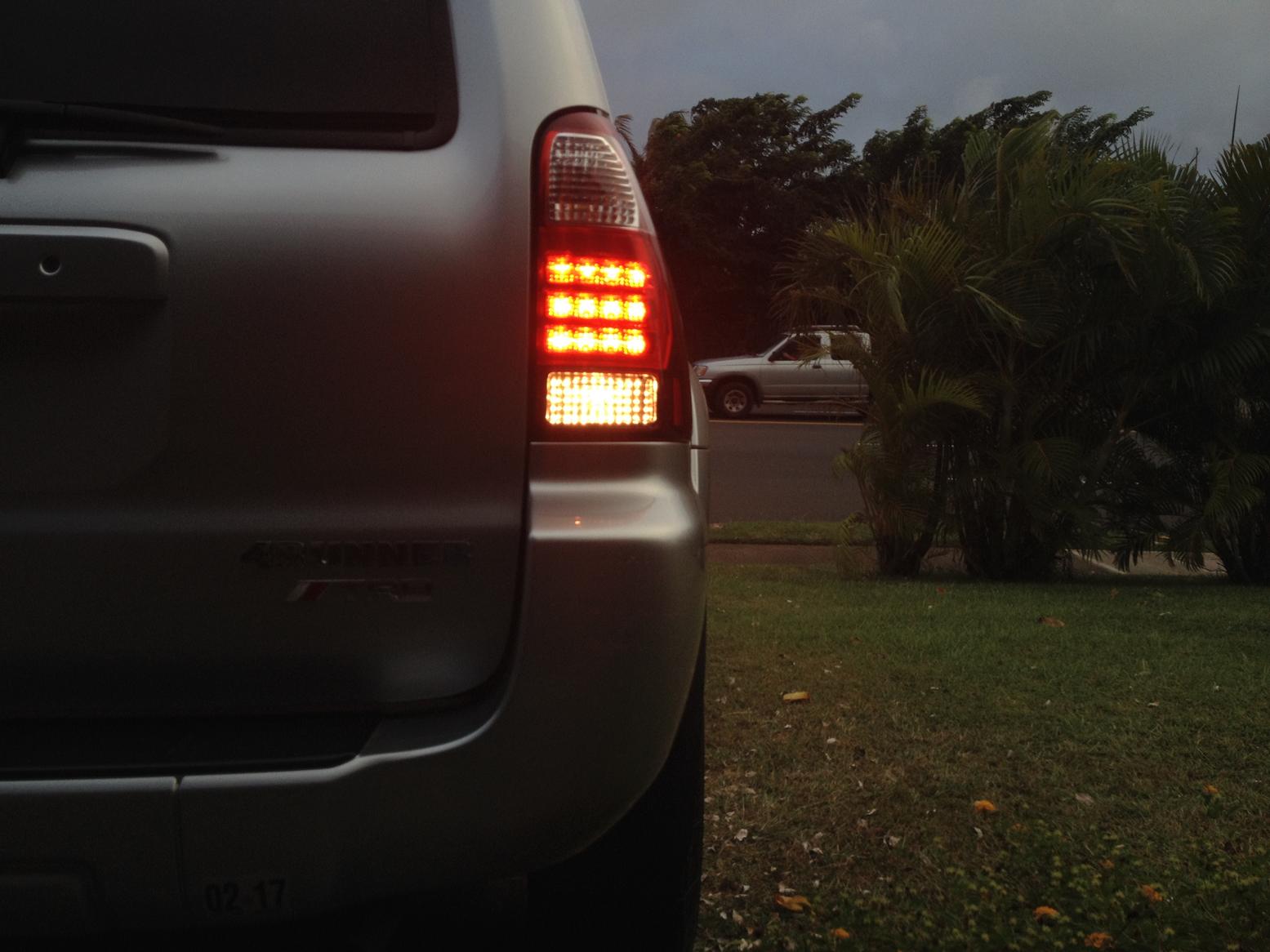

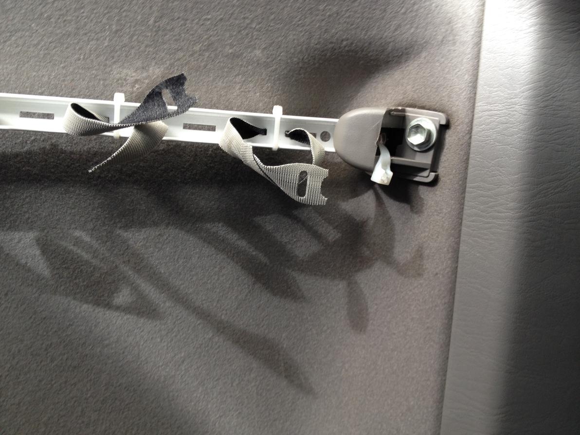

So many great mods in this thread! I have done a HCF delete, Rear led fog swap, DRL rewire, rear nilight led install, wheel spacers, fishing pole rack!
Fishing pole rack
Easy mod for fishing poles! Materials needed- 1 piece 1/2" shelf rack (spans coat holders in cargo area), small zipties (attach shelf rack to rear coatholders), velcro straps (attach rods to shelf rack), 1 ratchet tie-down strap (spans rearseat roof handles), foam or towel to keep rods in place between strap and roof. Will hold up to 8' rods!

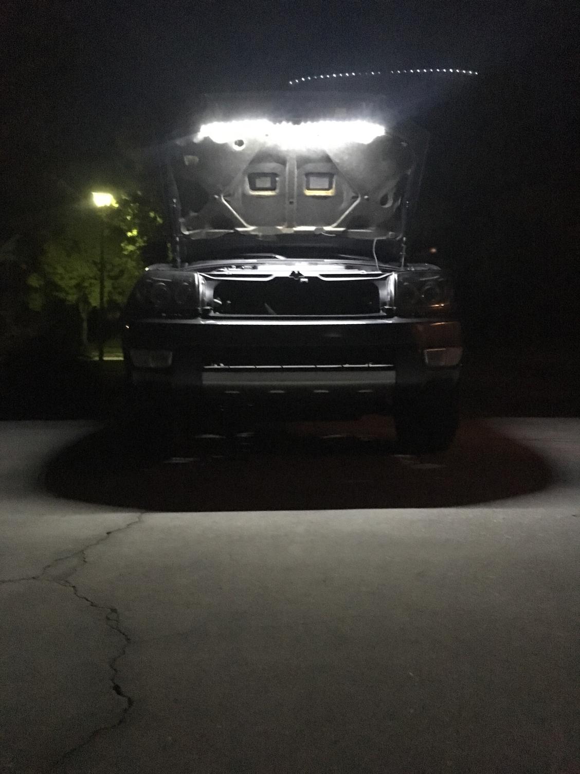

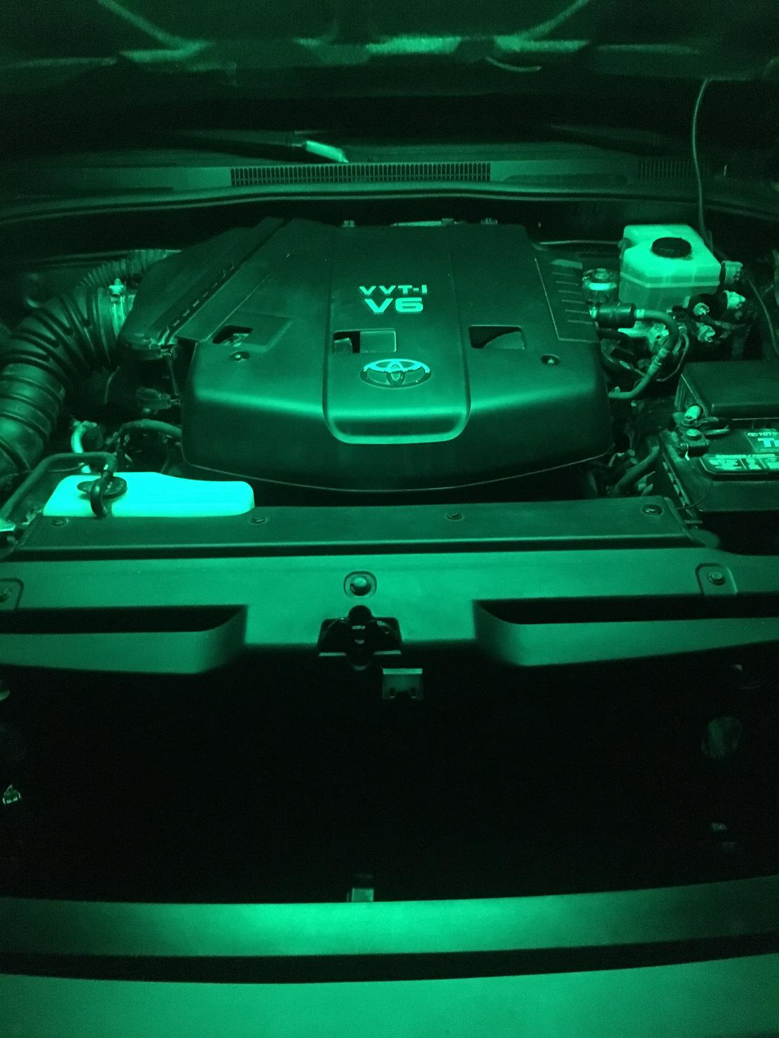

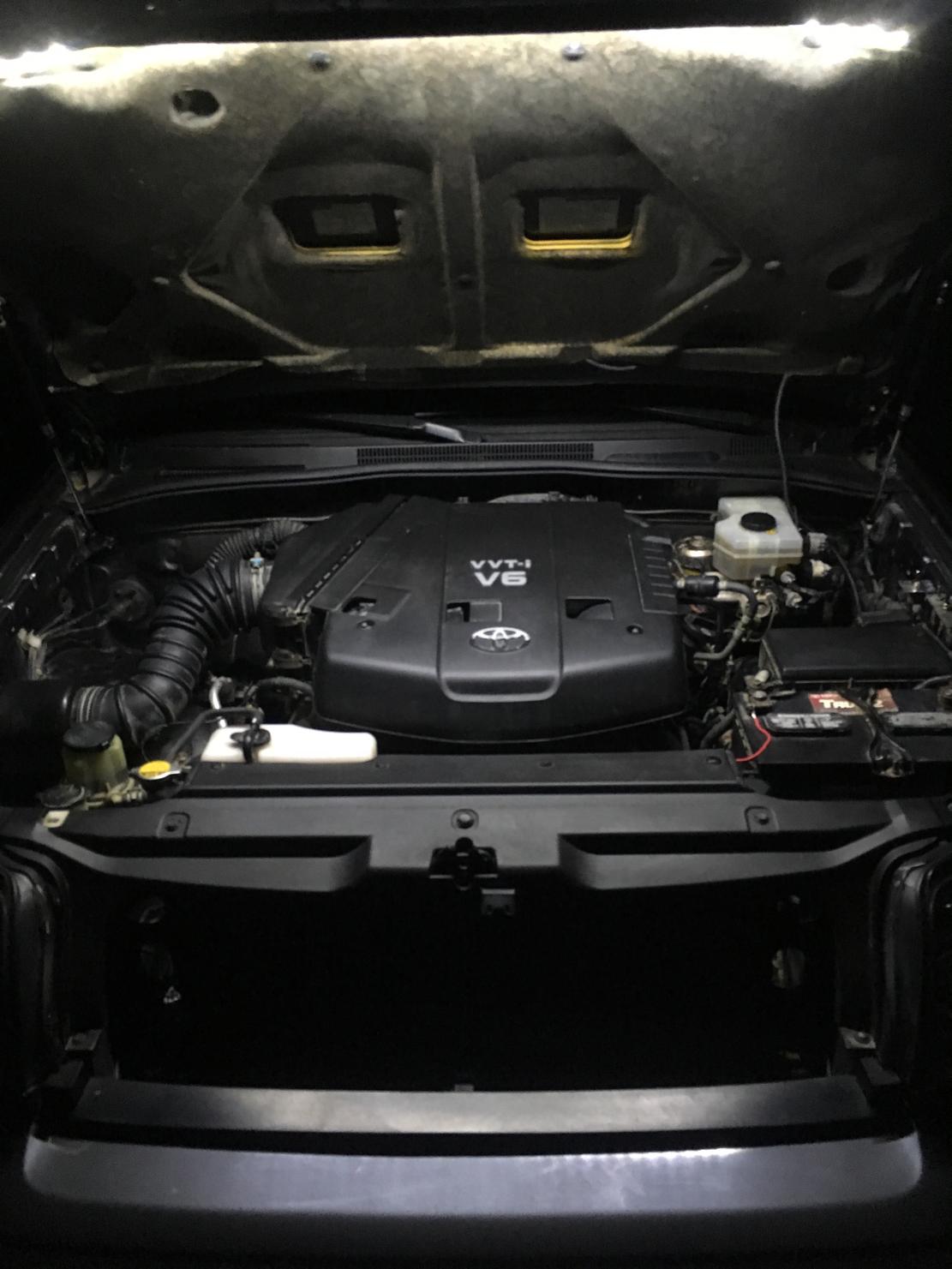

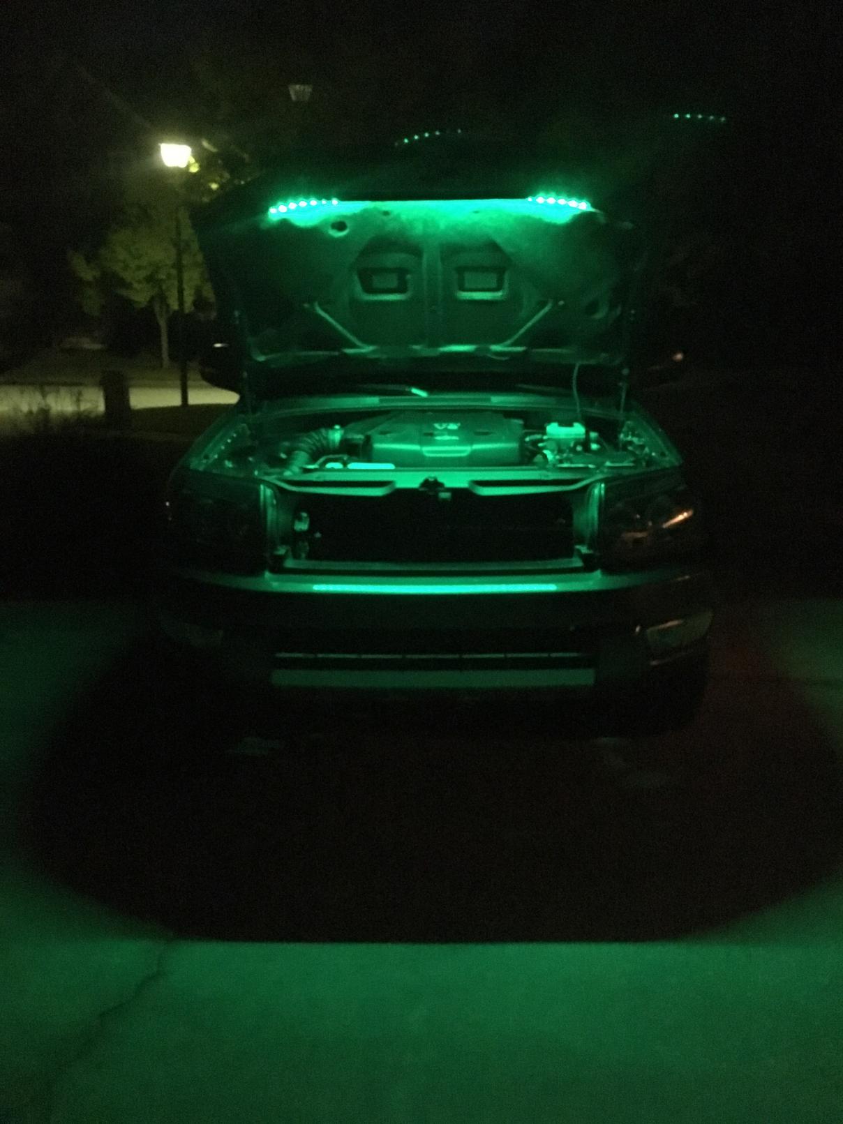

Today I installed my Anti-Dark engine light.

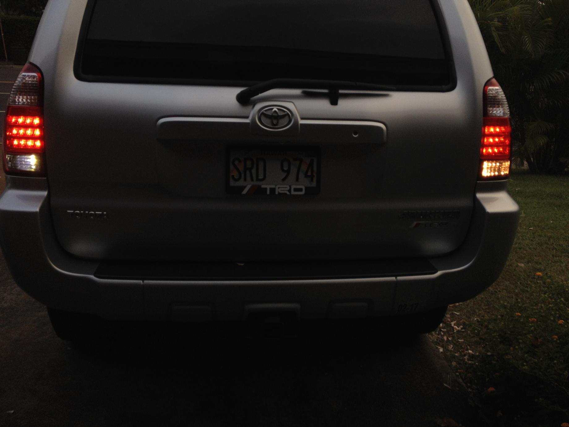

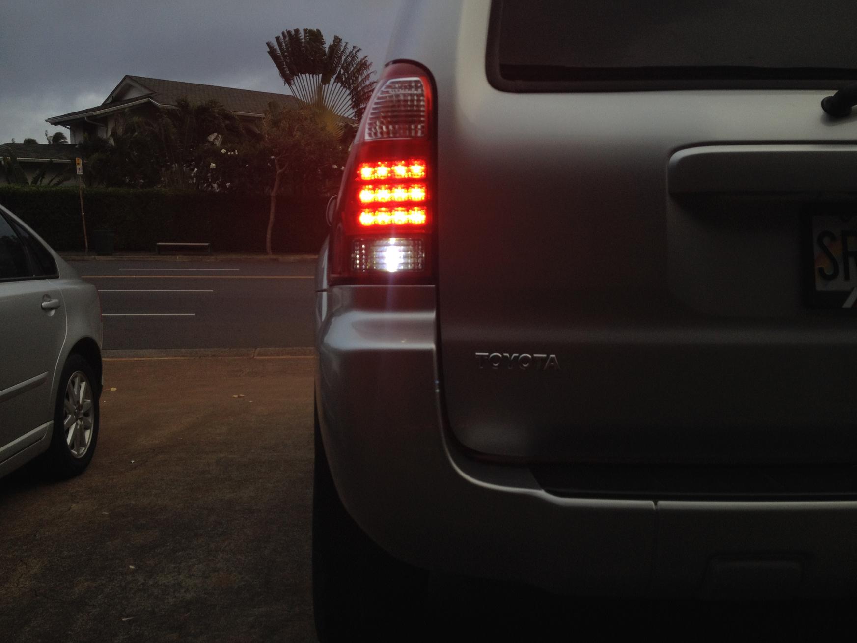

i swapped my stock reverse bulbs today with some Morimoto XB LED Bulbs. The Morimotos only project light outward which i thought would be better because you get more light where you need it, but I'm not too sure. You decide which is better.
