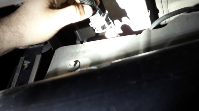

Forgot to update this. I could never find time to mess with this so I ended up going to a shop. They discovered that the main line going from top of tank to canister was disconnected from canister. We apparently did not get it fully reconnected. Well that sucks! Rough pic attached.
Did reconnecting it to the cannister fix the code issues?
