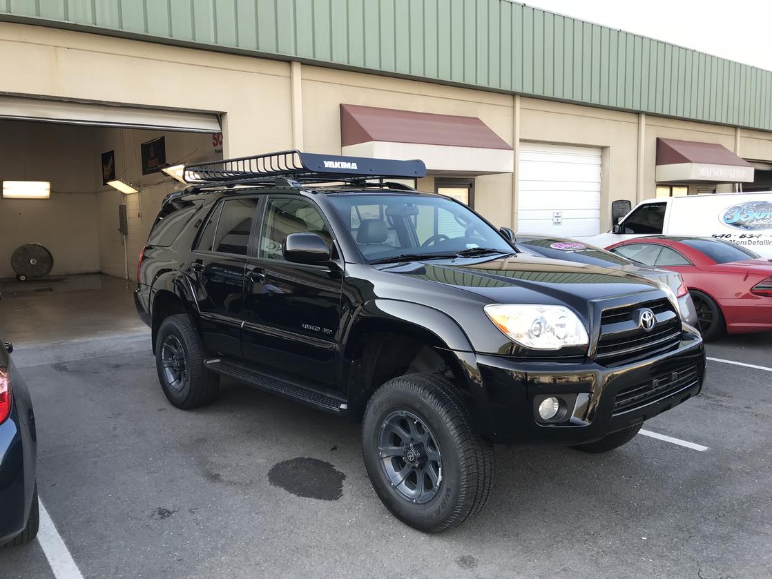

i had my lift done in stages as i was a tester 4th gen for eibach. first they put on all new shocks all around, +0" in the back, leveled in the front (2", i believe). took a bunch of measurements and had me come back a few weeks later after they dialed in the springs. this kit is basically a much nicer copy of 5100s with OME springs.
not the best iphone photos, but here you are.
stock with terrible XREAS:
with RHA shocks, stock shitty springs:
and here's how it sits now with the toytec I MEAN EIBACH springs.
i love it. i have 3" of lift and don't do anything where i'd need more than that. i don't think i'll ever want to drop the cash on kings or icons or anything, i only wish the springs were rated for a bit more because loaded up for a long road trip and it was sagging a little in the back...

Ok - here are some initial pics of the Eibach kit installed. More detail to come.
Net/net: pleased with the stance and ride.
Learnings: need to set the front struts on 2nd-from-bottom height perch to secure a level stance. This only netted me ~2” front/1” rear lift from old 153k mole sagging suspension.
If you set the height on anything higher there is a massive negative rake which looks ridiculous and rides somewhat rough (learned that the hard way)
