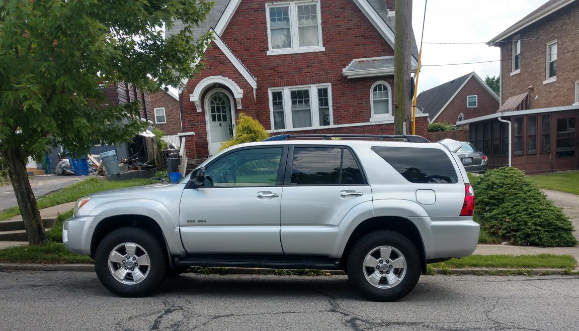

i had my lift done in stages as i was a tester 4th gen for eibach. first they put on all new shocks all around, +0" in the back, leveled in the front (2", i believe). took a bunch of measurements and had me come back a few weeks later after they dialed in the springs. this kit is basically a much nicer copy of 5100s with OME springs.
not the best iphone photos, but here you are.
stock with terrible XREAS:
with RHA shocks, stock shitty springs:
and here's how it sits now with the toytec I MEAN EIBACH springs.
i love it. i have 3" of lift and don't do anything where i'd need more than that. i don't think i'll ever want to drop the cash on kings or icons or anything, i only wish the springs were rated for a bit more because loaded up for a long road trip and it was sagging a little in the back...

Just to confirm, in that last picture you don't have any lift in the rear?
