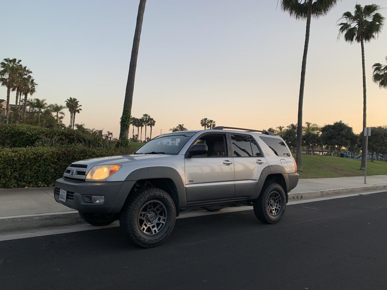

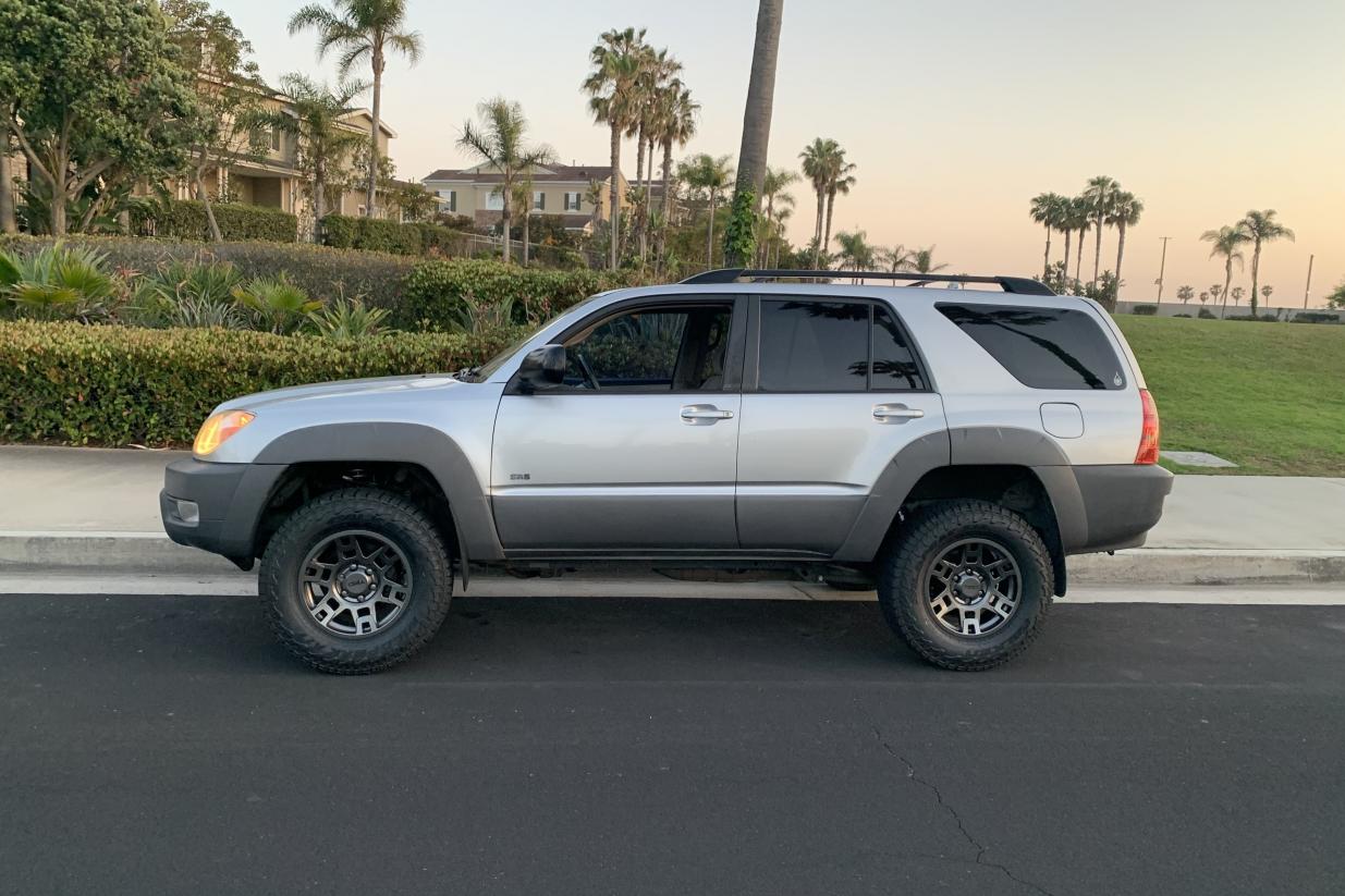

2003 4Runner 2WD V6 w/ Eibach Pro Truck Lift Kit
I just had my Eibach Pro Truck kit installed today. Also installed Old Man Emu UCAs, and found some TRD wheels and brand new Falken tires on Offerup for a decent deal. Love the ride so far. Feels great all around, but this is coming from stock suspension with 248K miles. This 4runner just won't die, so I decided to have some fun with it.

Looks good! I’m with you on the 4runner not dying! I’m wondering if my 2003 will make it to give to my 6 year old in 10 years!
What size tires do you have and what did your center of wheel hub to fender measurements come out to be?

I'm running 265/70/17s. They are plenty big enough for me, and I think they match the lift pretty well. In addition, I really like the ride with this kit. Very good road feel, but responds very well when it gets rough. I think you'll like it!
Measurements below after a few days and a few hundred miles...
Before:
Front - 18-1/2" center of wheel hub to fender
Rear - 20-1/2" center of wheel hub to fender
After:
Front - 21-1/4" center of wheel hub to fender
Rear - 22" center of wheel hub to fender
