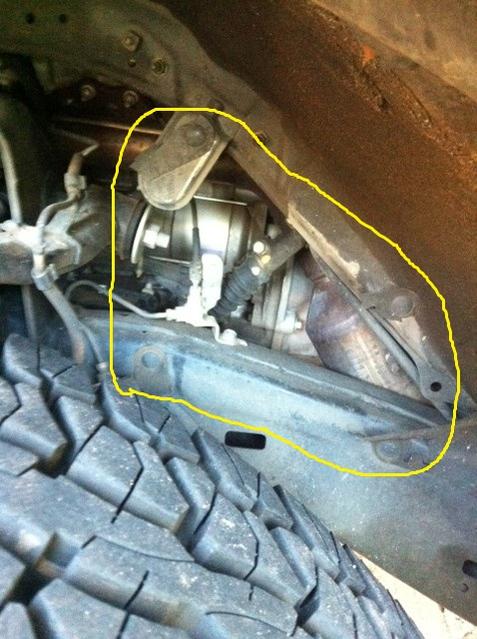

I noticed part of my fender liner disappeared so I found this thread. Thanks for the link! My question is this ... I only need the driver's side shield, so is driver's side left or right? I apologize for the dumb question and I'll make up for it with my boss paint skills below. Thanks!

Left but I actually just got off the phone with toyota looking for the same parts and the two rears are the same part # so either one should work.
