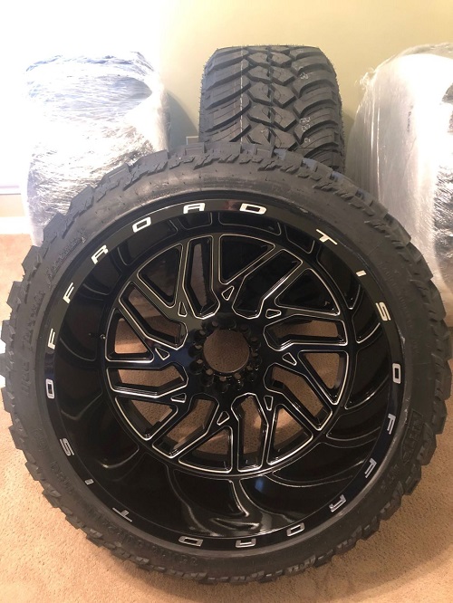

I've actually bought wheels and tires. I got a heck of a deal form RIMZONE. I got a set of TIS 544BMs that are 24x14, Wrapped in the AMP Mud Attack M/Ts that are 35x14.5r24.
My Christmas gift to myself lol.

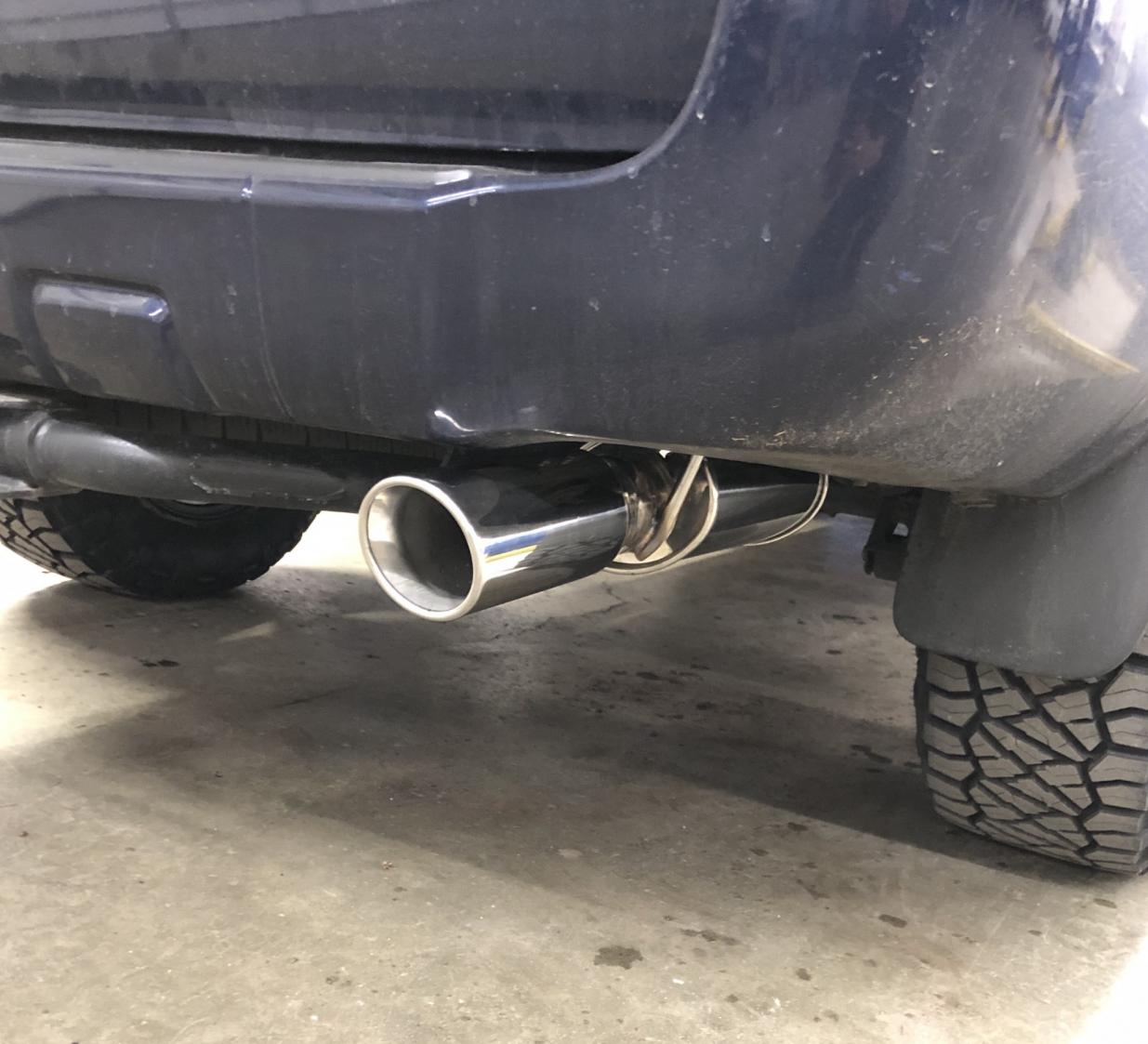

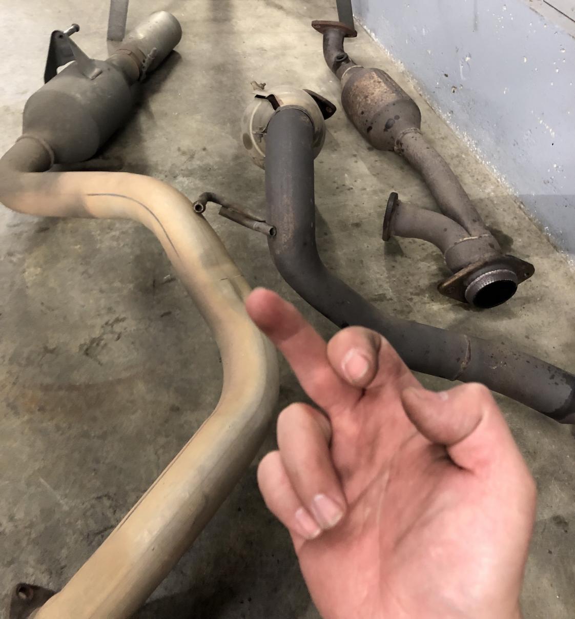

URD MK3 exhaust and stainless Y pipe is on. You can see the way the stock y pipe and the stock over pipe for the rear cross member constrict. Had to cut the bolts on the back muffler. Those were rust welded on...
The truck now sounds like the V8 that it is. Vids to follow.
Nice deep rumble at start up and idle. Docile at highway speed. Screams at WOT.

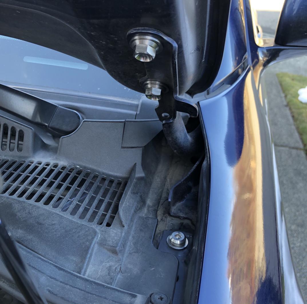

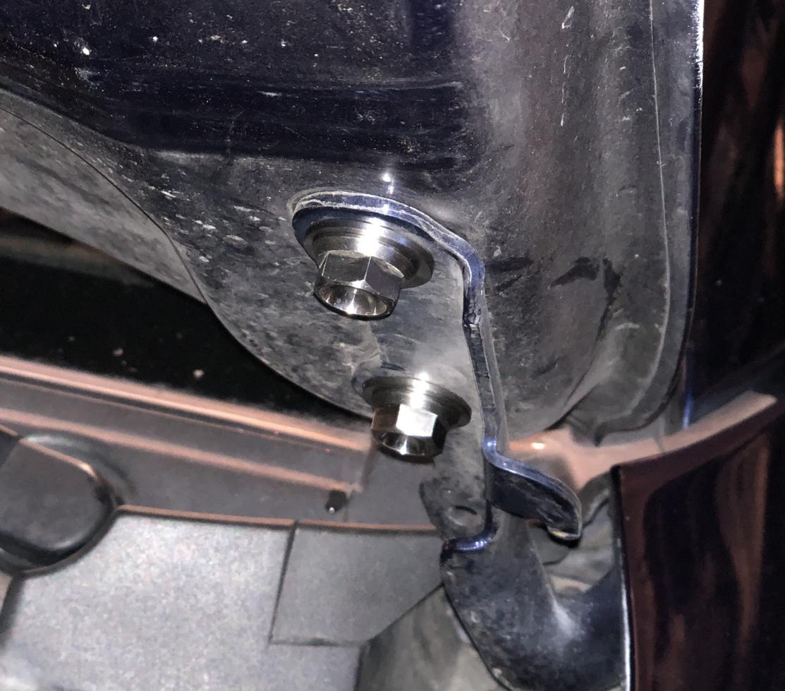

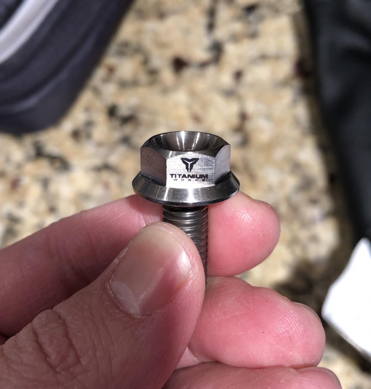

I can’t stand rust... Undercarriage bolts are now all stainless. Engine bay bolts are now all titanium from Titanium works. I got to know the owner Ridhwan and have his fasteners on my GTR. His bolts are machined to perfection.
Check out more of his work on Instagram and Facebook. Tell him Formidable sent you.

By the way, I checked out that IG link for the titanium hardware. Very nice stuff. I’ve always changed my engine bay hardware to stainless on every car project I’ve done. In most cases, I end up polishing them too, unless I’m going for the brushed look. Titanium is probably a bit overkill unless I was building a race car where ever gram of weight mattered, but I can see where some would want it for the aesthetics as well. In the case of my 4Runner, some of the hardware was so corroded that I needed to use those special sockets for stripped bolt heads just to get them out! I didn’t bother polishing the replacement hardware since this isn’t a show type vehicle, but I definitely wanted rust free hardware! I also applied ant-seize to the threads, especially those going into aluminum.
What you’re saying makes perfect sense. The fog bulbs were dirty as hell coming out and the fans may take a beating in that location. I checked them again and they have fans within the angled housing! I just happened upon those bulbs and completely missed the pull down menu. So if you can get a set for cheaper in the original link go for it!
Titanium is definitely overkill for this truck. I got them for the corrosion resistance and aesthetics. The bolts are much nicer and stronger than stainless. Some of the bolts that came out were pretty nasty. Took some steel wool, dust blaster, rustoleum to the threads, and permatex. Smooth as butter going in.

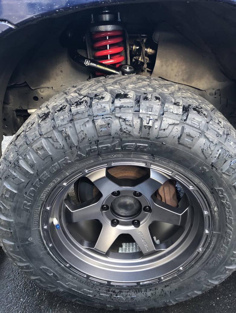

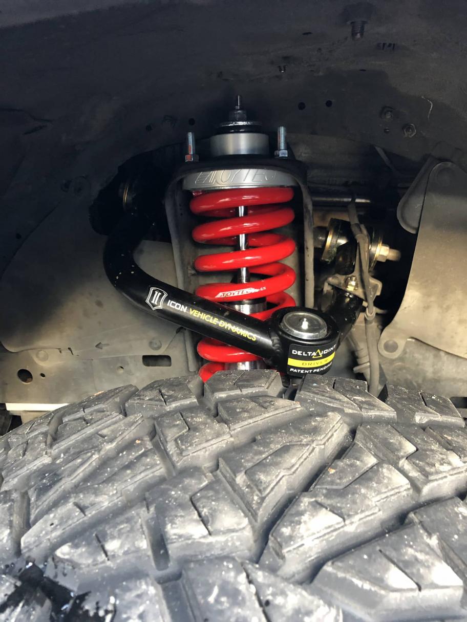

Toytec coilovers and Icon UCAs with delta joints installed.
It’s nice to know they exist for use in applications requiring more strength than stainless bolts anyway. I’m sure these can be polished if desired as well. I generally only use stainless in low stress areas, such as intakes, valve covers, and other stuff like that, but for stuff requiring grade 8 fasteners, I’d guess these would work, but not positive on that. Do you happen to know if they are rated to replace stuff like suspension bolts?
Yes they are extremely strong. Talk to Ridhwan. He has caliper bolt replacements. T1 Race use his bolts on GTR timing covers.

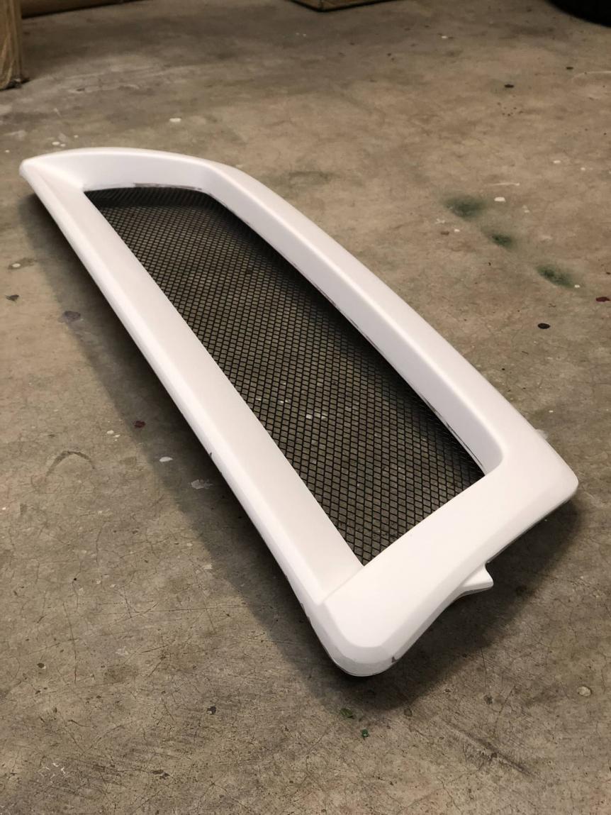

JAOS Aura front grille arrived today. Given that this will probably get rock chipped to hell, I will just rattle can this thing Nautical Blue Metallic with a few coats of clear and call it a day. I did this for my 3rd gen satoshi grille. Worked out great!
