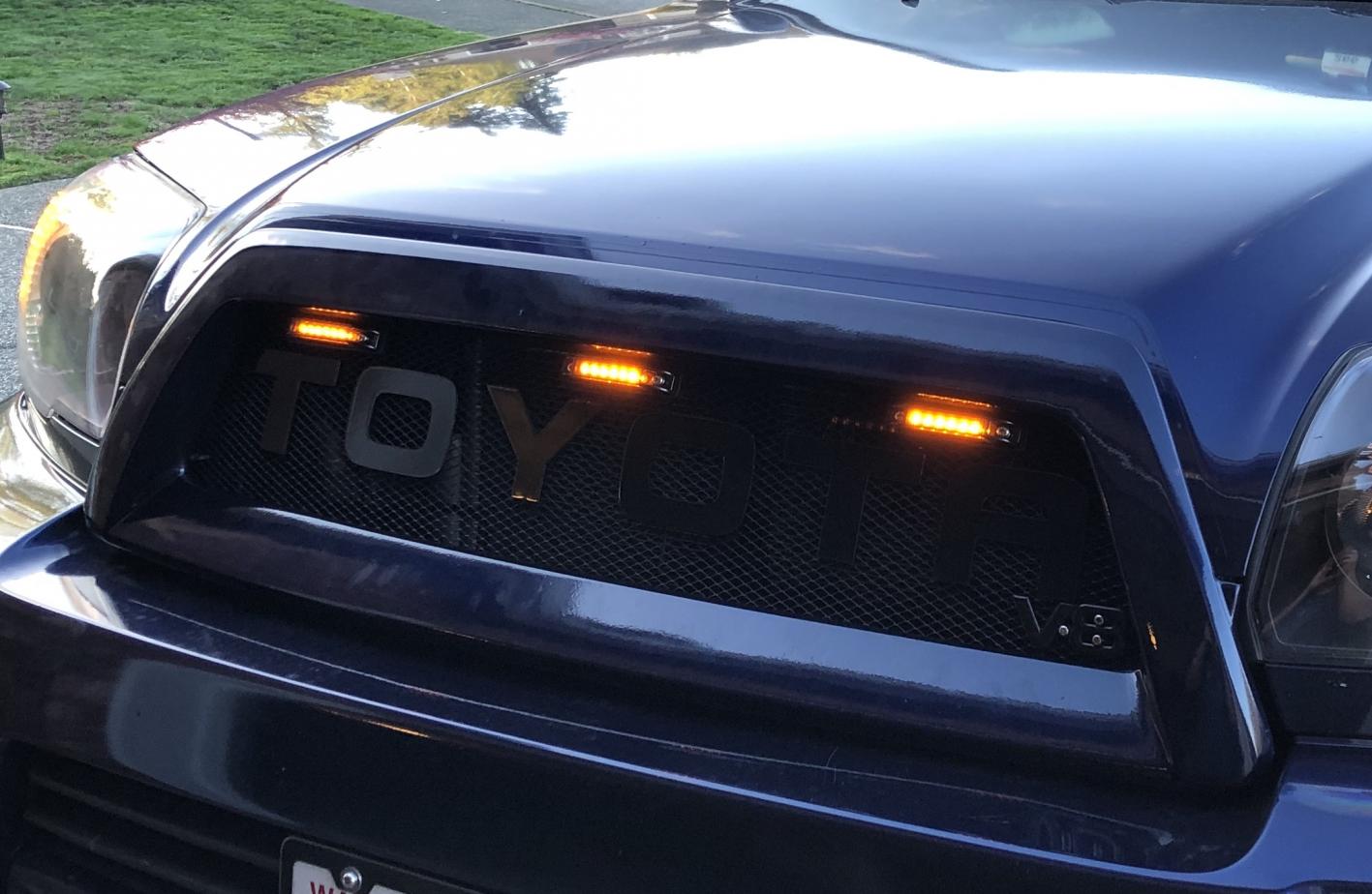

Raptor lights wired up!

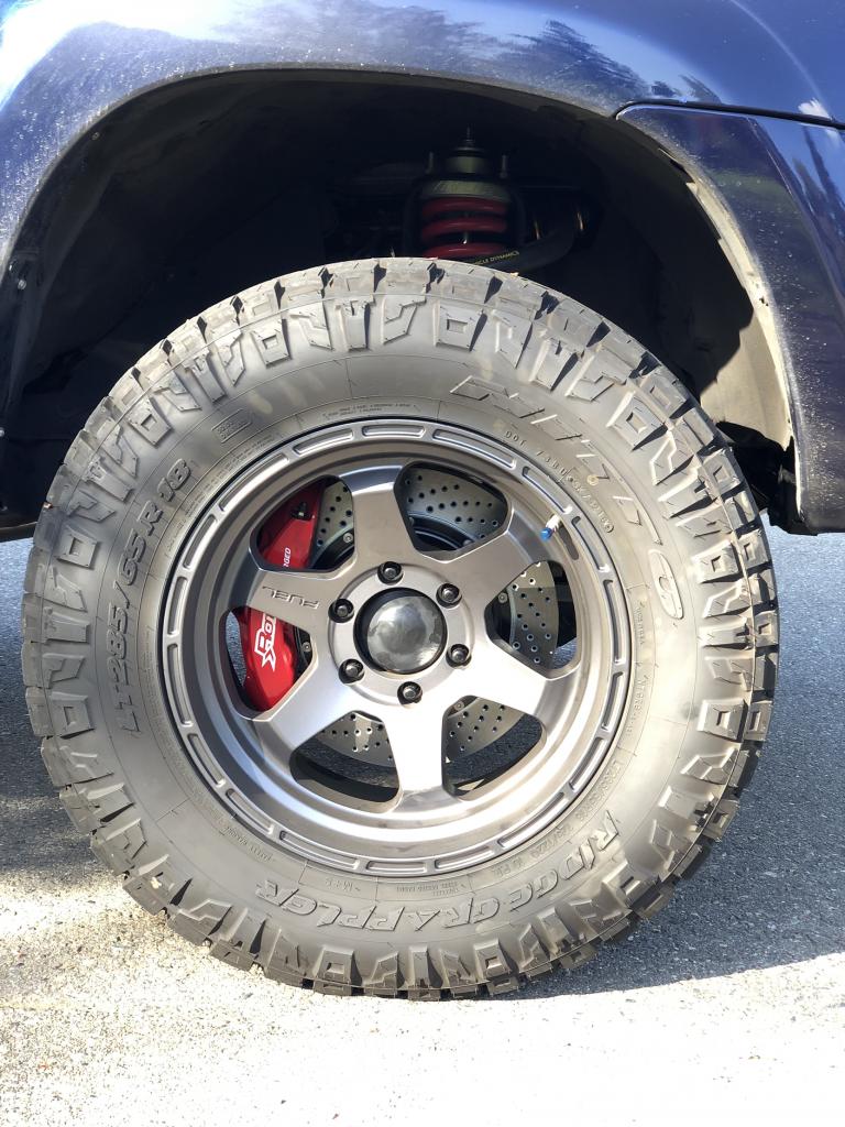

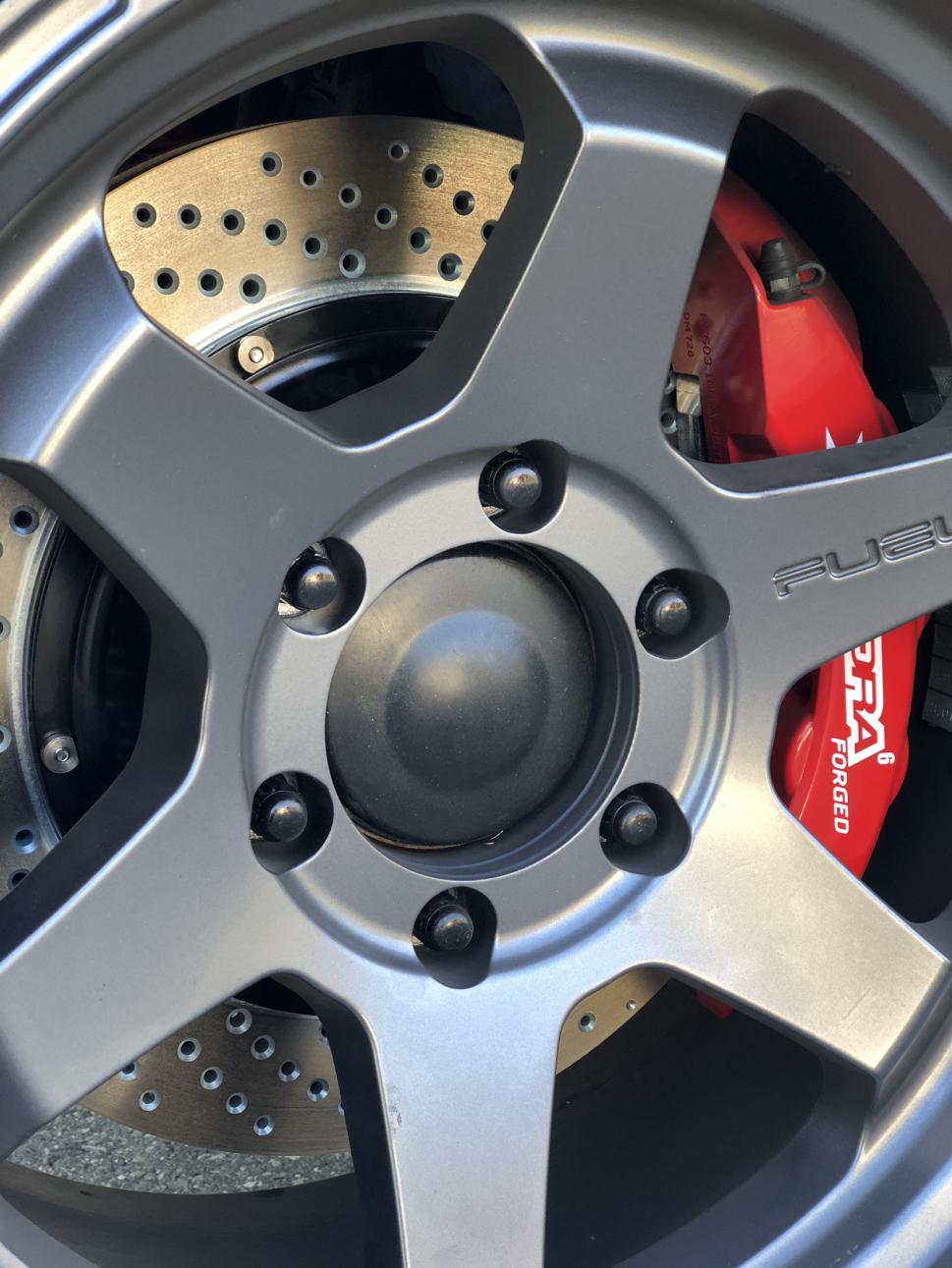

I really dig those wheels and am considering a set for mine - is there a reason you chose 18" over 17"? I'd prefer 17" but worry maybe the lip design or spoke design might be different.
Thanks! I counted the bolts I needed and ordered them through titanium works. No kit is offered presently. I got to know the owner Ridhwan as he made many custom titanium parts for my Nissan GTR. If you back up a bit in this thread I mention how many you will need for the 4.7L.
The wheels are aggressive concave six spoke design similar to TE37’s but with a lip. The matte gunmetal finish is outstanding. You won’t be disappointed. Years ago the limiting factor on the 18”s used to be tire selection. That is no longer the case. The problem I had with 17”s is if you ever want to upgrade your brakes in the future, 17”s will limit your rotor size. I have a set of Rotora 14” front and rear rotors and forged calipers in the mail presently. They only work with 18” wheels.
That's exactly why i love those wheels. I was looking for a deep-dish concave TE37-style wheels. The best I could find had the faux bead-locks which I think are obnoxious as they are overused a lot. Are you running spacers as well? Looks like you are also leaving off the center caps - not a fan?

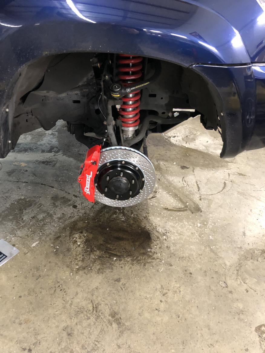

Buh-bye shitty OEM brakes!

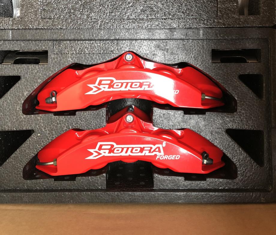

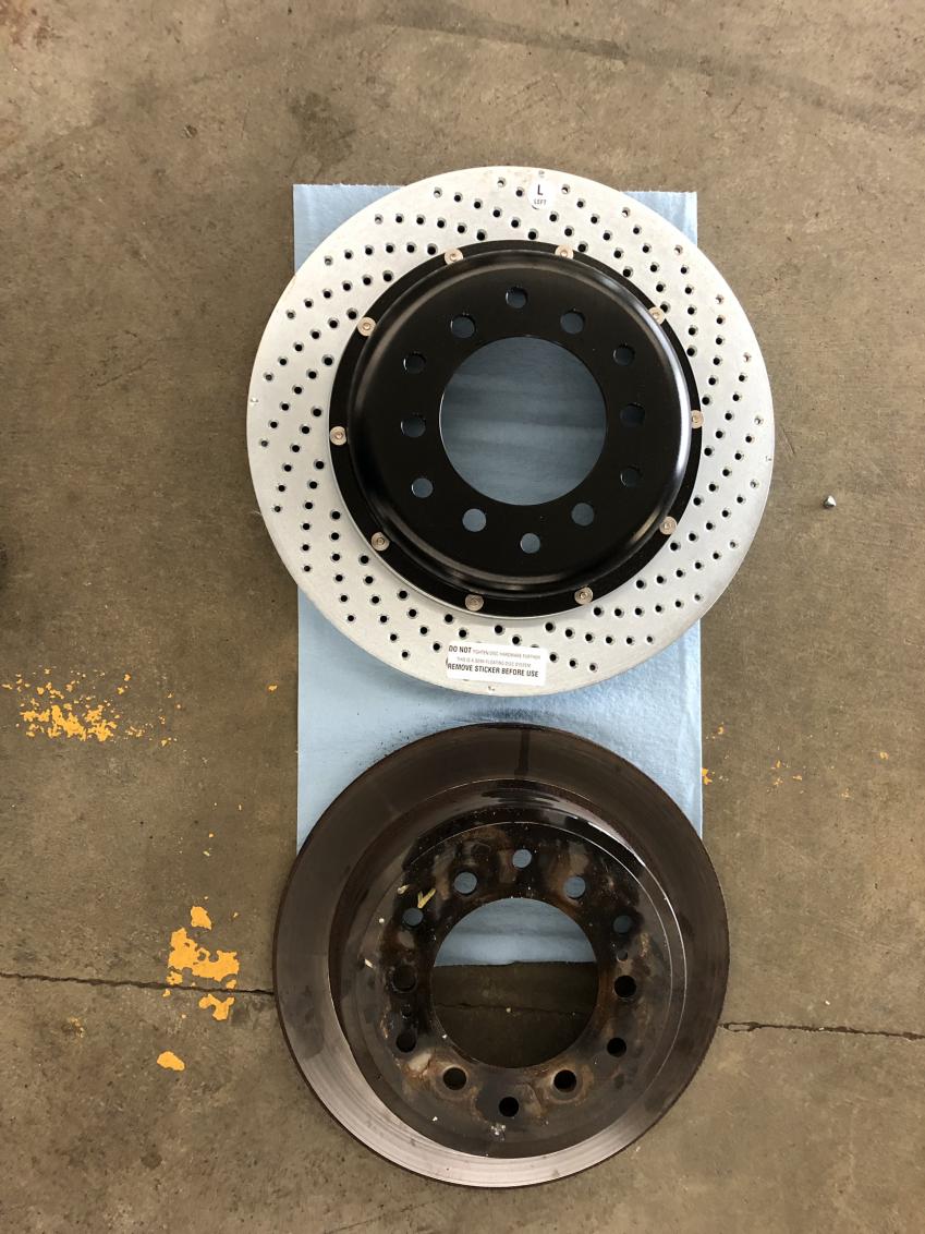

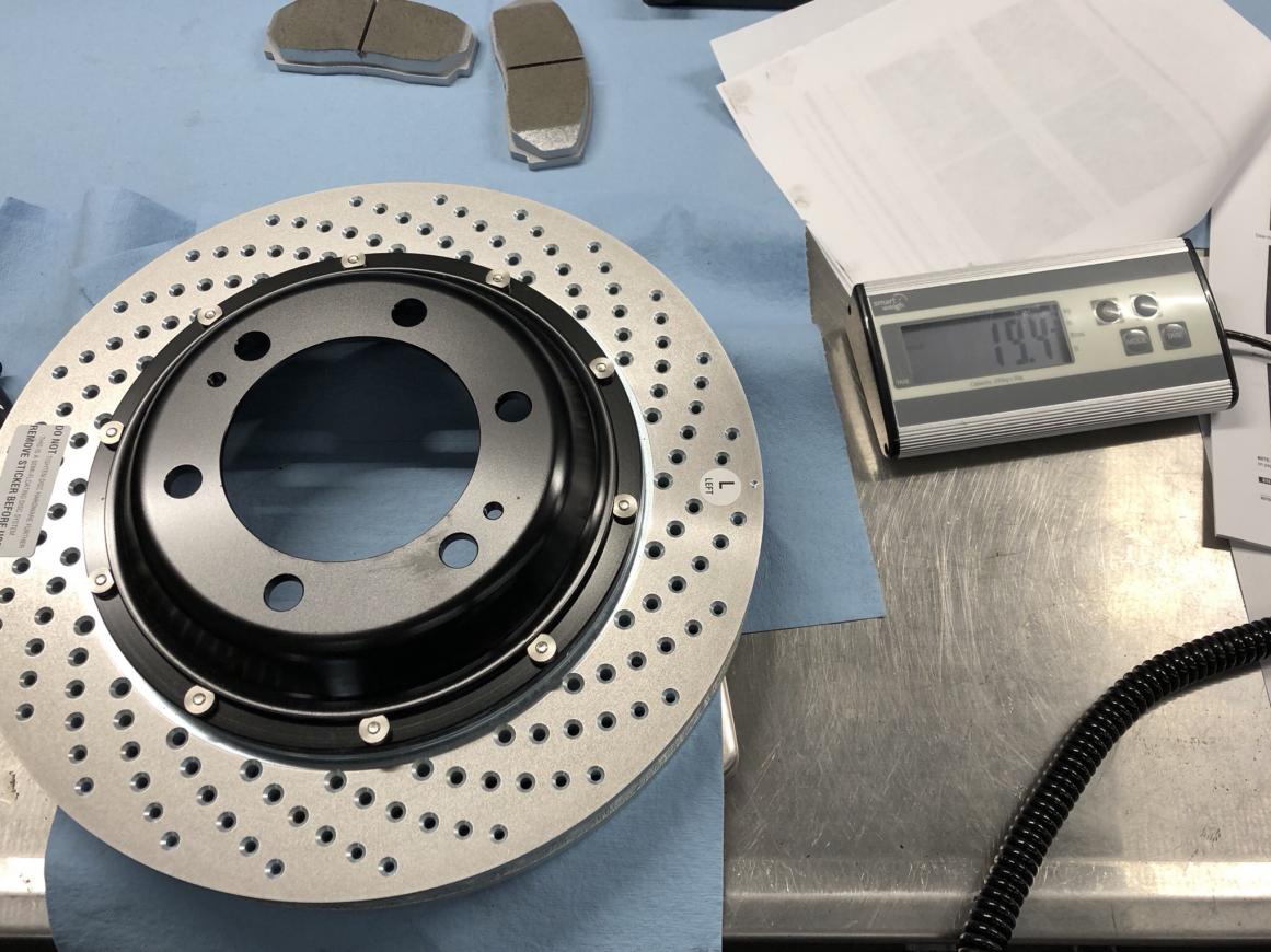

Massive 14” front and 14” rear Rotora two piece rotors with aluminum hats along with Rotora 6 piston front and 4 piston rear forged aluminum calipers installed today...
Review to follow.

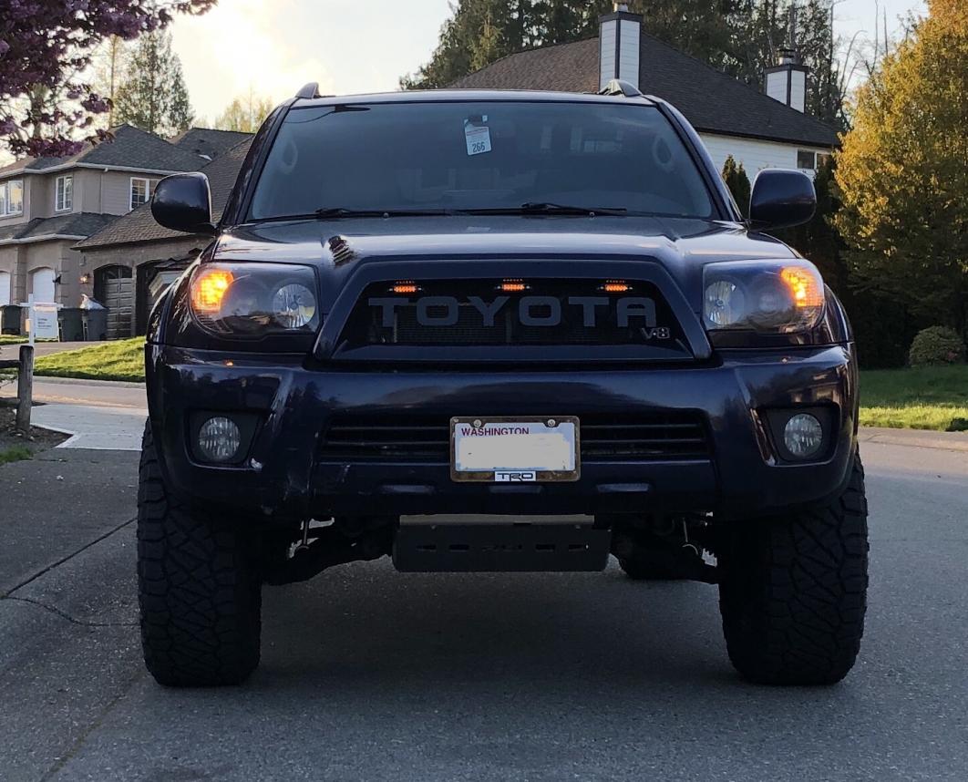

Where and what did you get for the front grill with the Raptor LED's? I am looking for that exact setup.
JAOS Aura front grille purchased through [MENTION=9]Jason B[/MENTION] website. I sanded and rattle canned to color match nautical blue metallic followed by gloss clear.
Burtman Industries
The raptor LED’s are off amazon. Bought three and wired into ignition.
https://www.amazon.com/dp/B00ECTQNNS/ref=cm_sw_r_cp_api_i_fQCZCbRCYQAHP

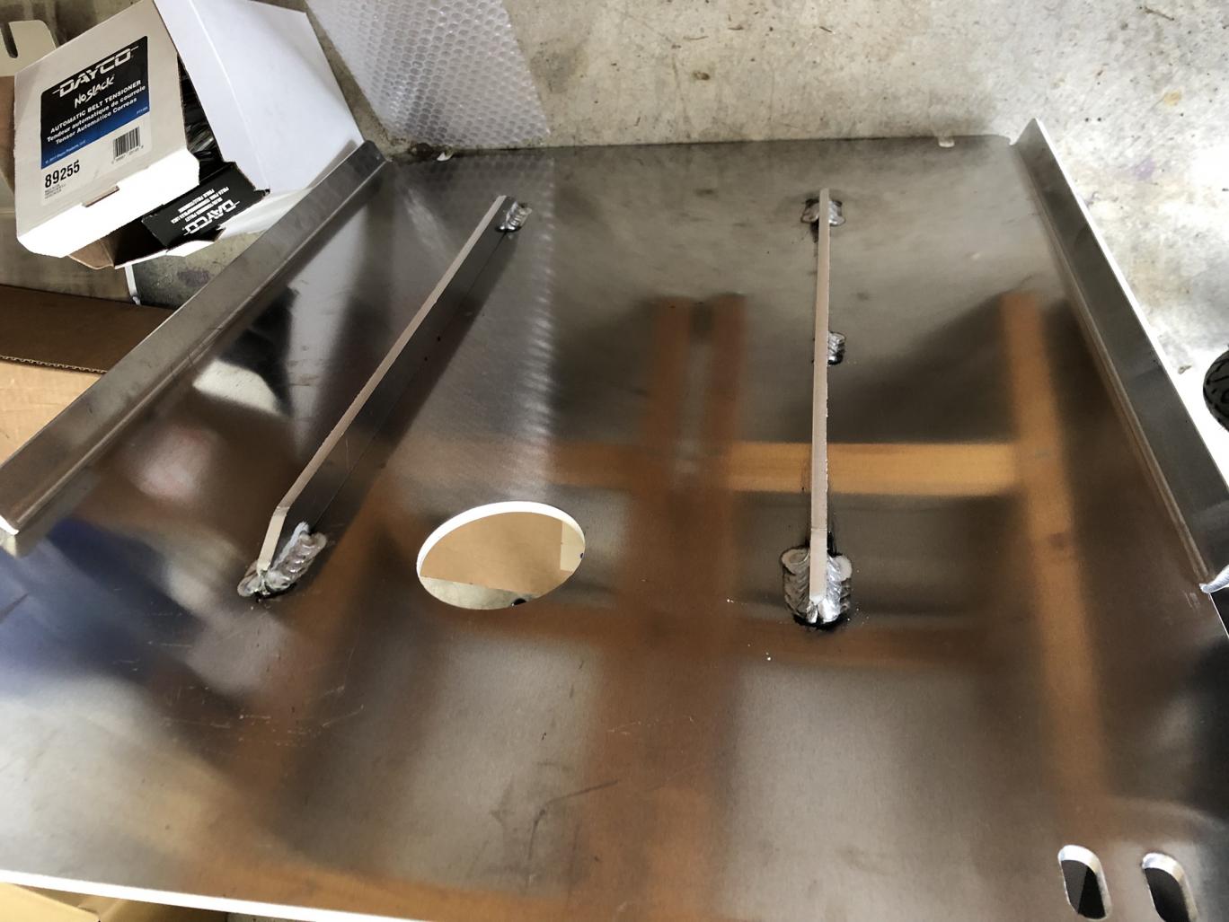

Regarding material... steel will need to be hit with rattle can enamel from time to time. I am fine with that given the frame requires the same. However, these trucks are heavy AF. So the question is how serious are the trails planned? If doing most of the driving on road, occ off-road, it doesn’t make sense to go for steel when aluminum is a lighter alternative and depending on the fabricator, can be very strong. For example, the RCI under belly aluminum skids come reinforced with aluminum beams welded in. These beams hit my URD y pipe so the pipe will need to be cut at some point.
