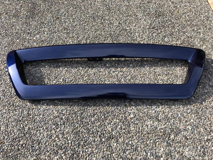

JAOS grille - Rattle can nautical blue metallic with few coats of clear.

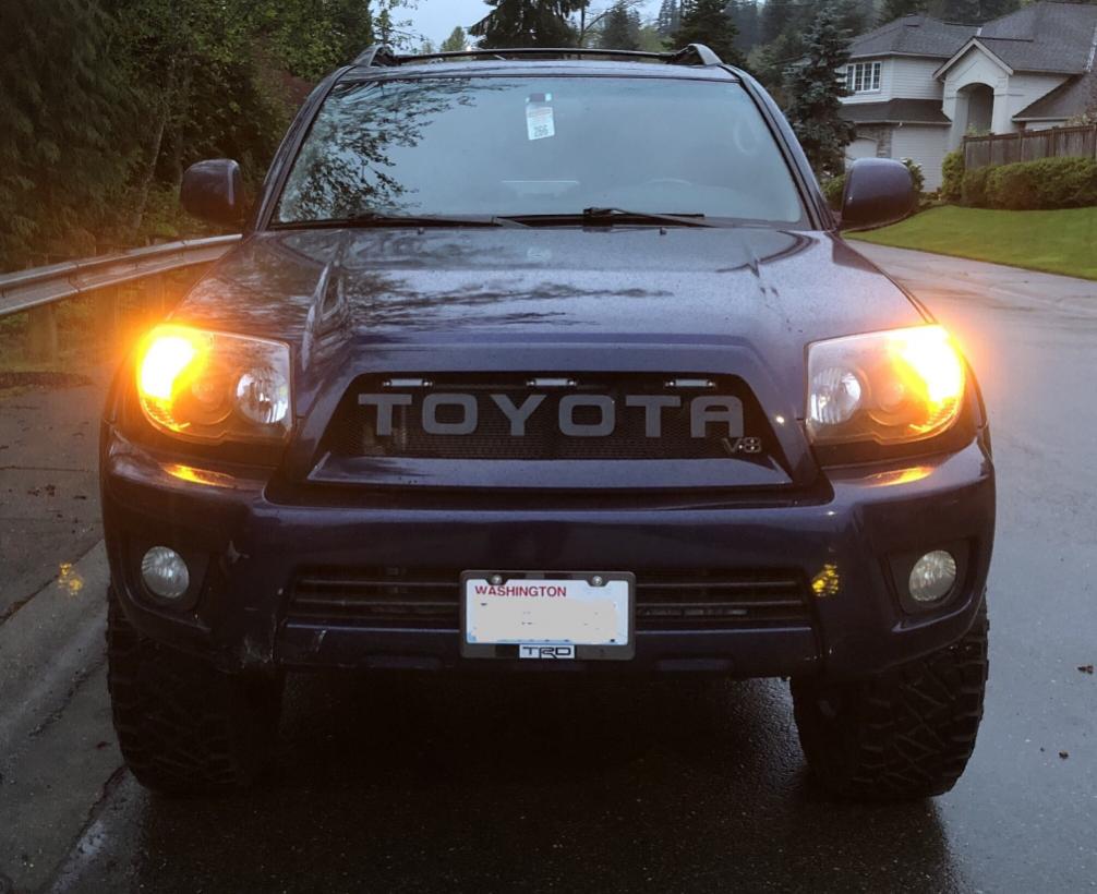

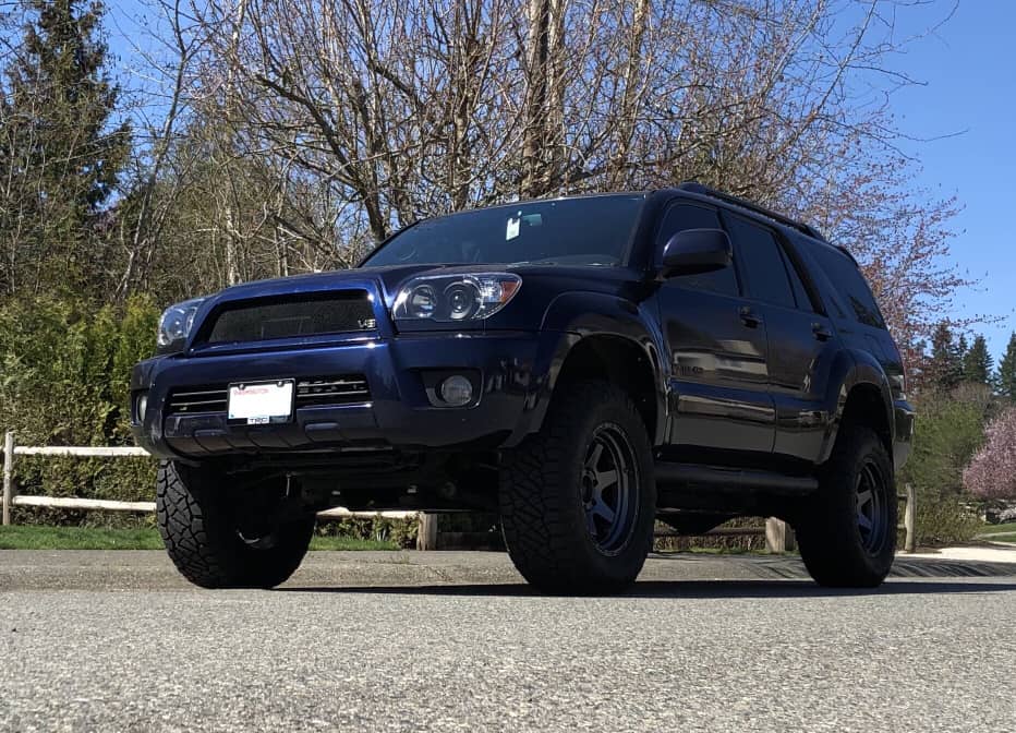

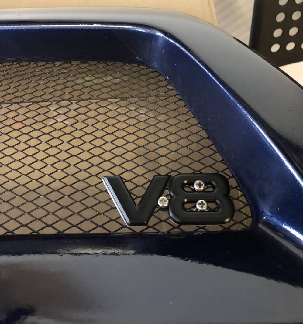

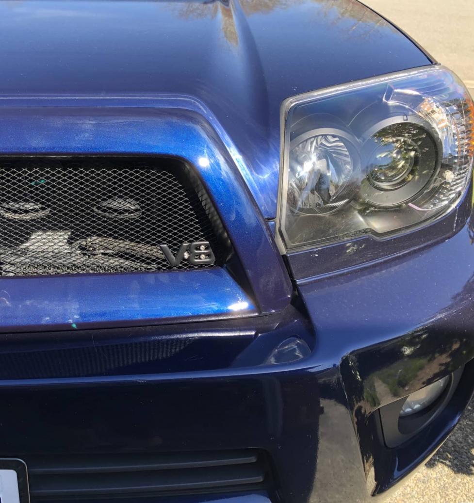

Rattle can nautical blue metallic JAOS grille installed with Toyota V8 blackout emblem. Fitment is perfect as you would expect from a part made in Japan.

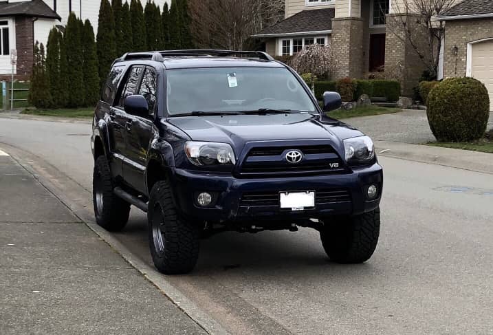

Great looking truck
Really like the color as well as your mods. Was wondering how you like the DT MOTO Blackout headlights?

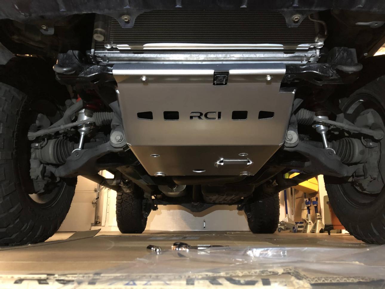

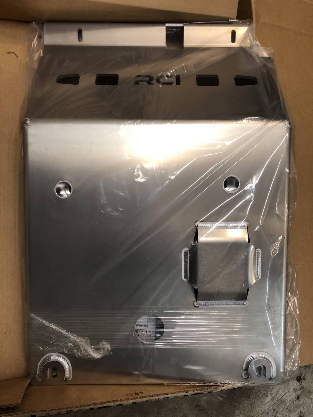

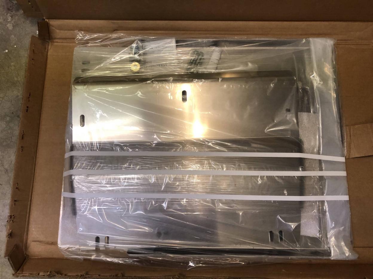

Full RCI aluminum skid plates arrived... workmanship is outstanding. Welds are phenomenal. I have a few broken rusted bolts I need to extract before I install these. Nice weekend project.
I also bought the powder coated aluminum version of the plates. Mine look different though, and I only bought them a couple of months ago during the group buy. I don’t have that welded on “bump out” plate. Is that a special request?
I requested RCI send me skids that work with a diff drop. If it’s not due to that then maybe it is a new design.
That might explain it. Doesn’t seem likely they’d change the design so soon, but you never know. Mine is flat across the bottom, with the exception of welded on bosses to protect the bolt heads from getting sheared off.

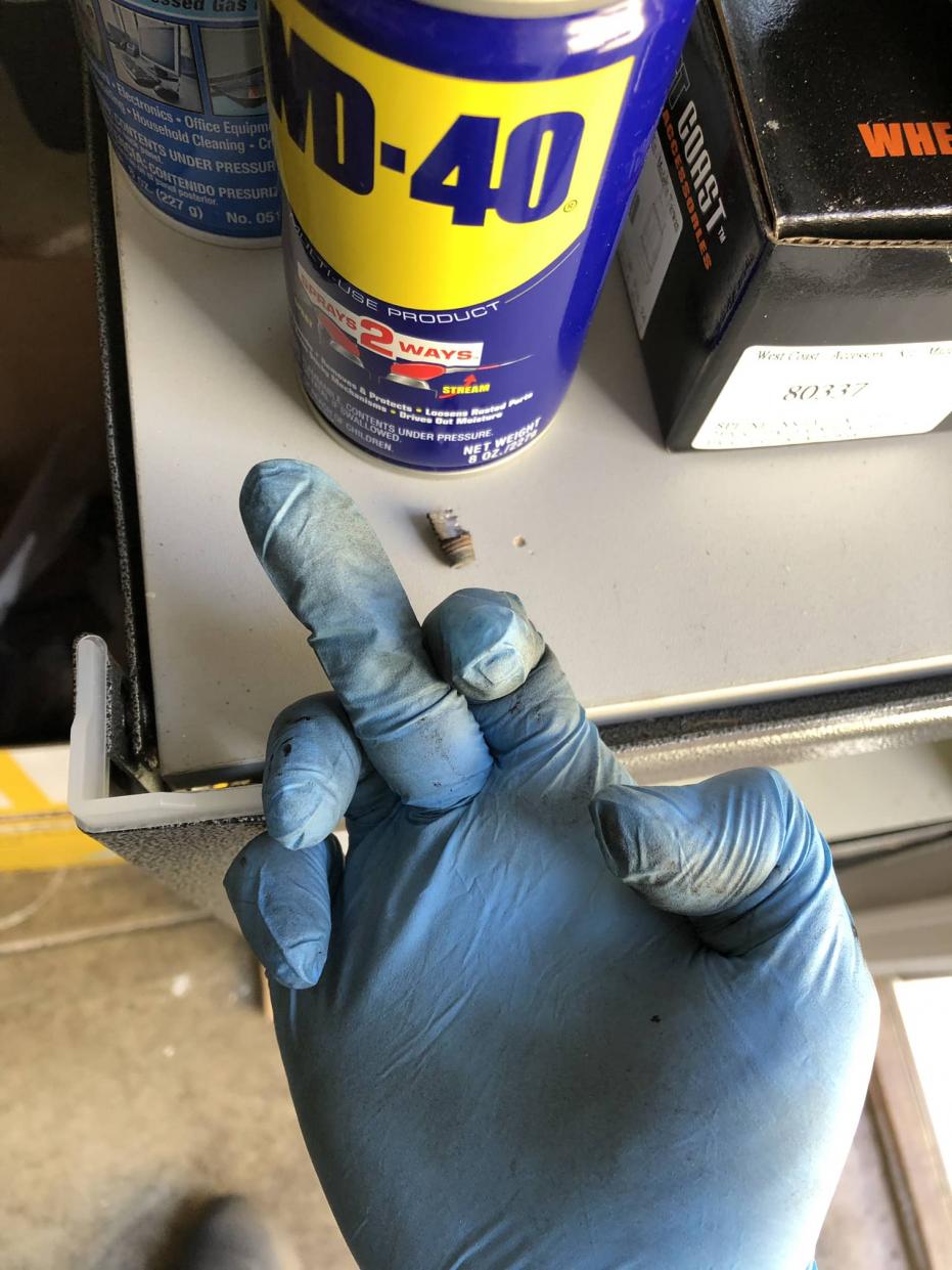

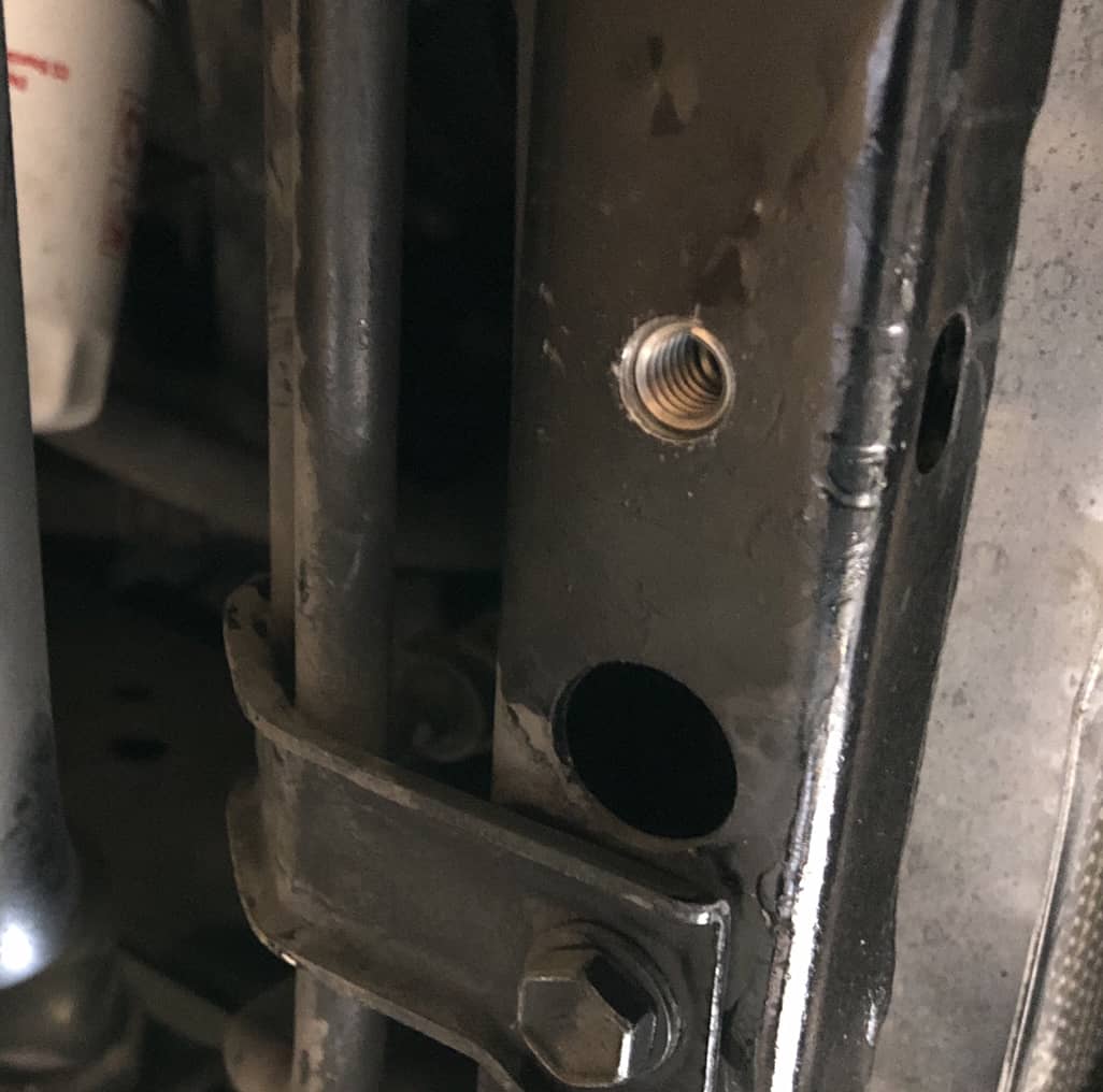

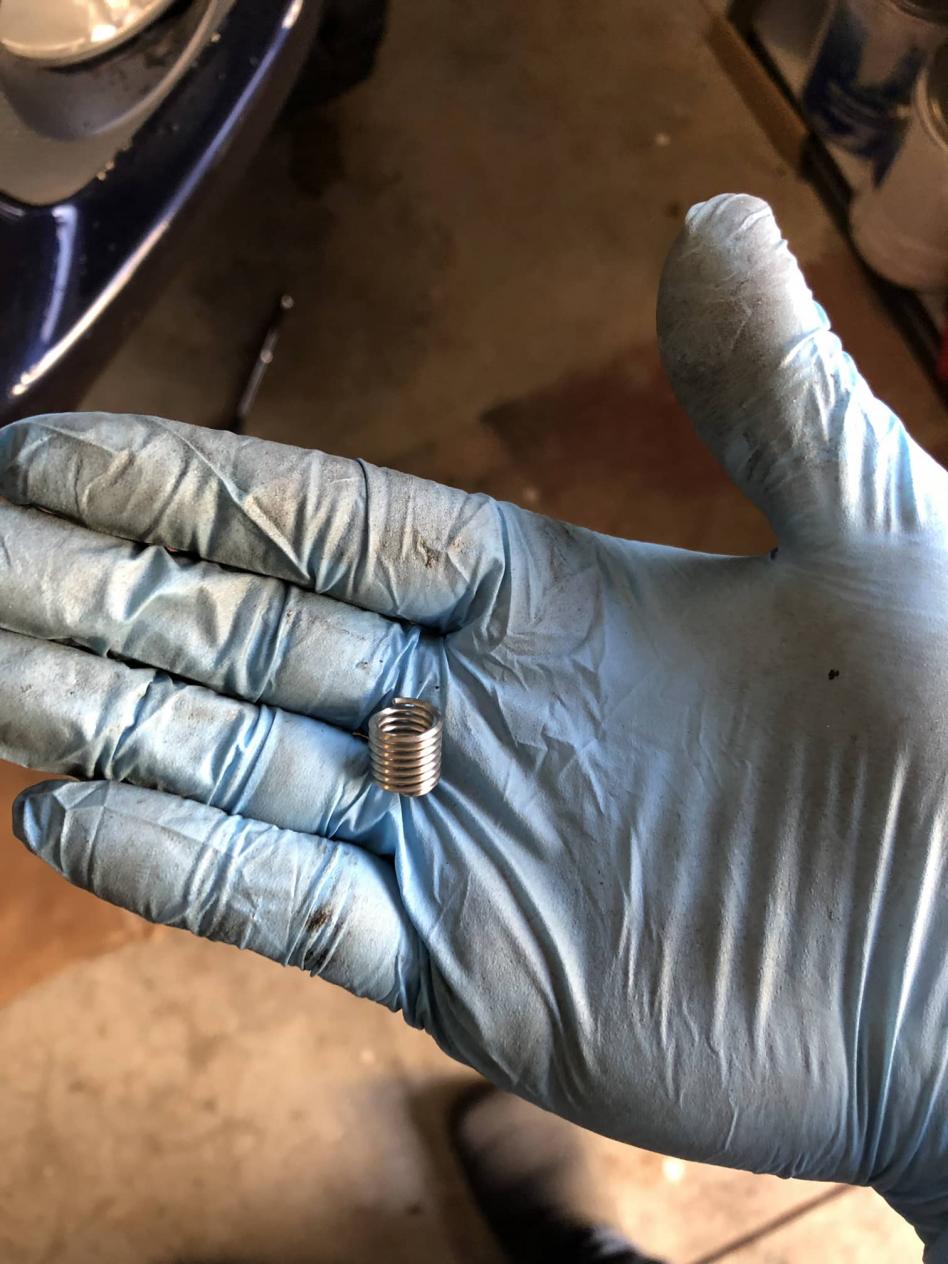

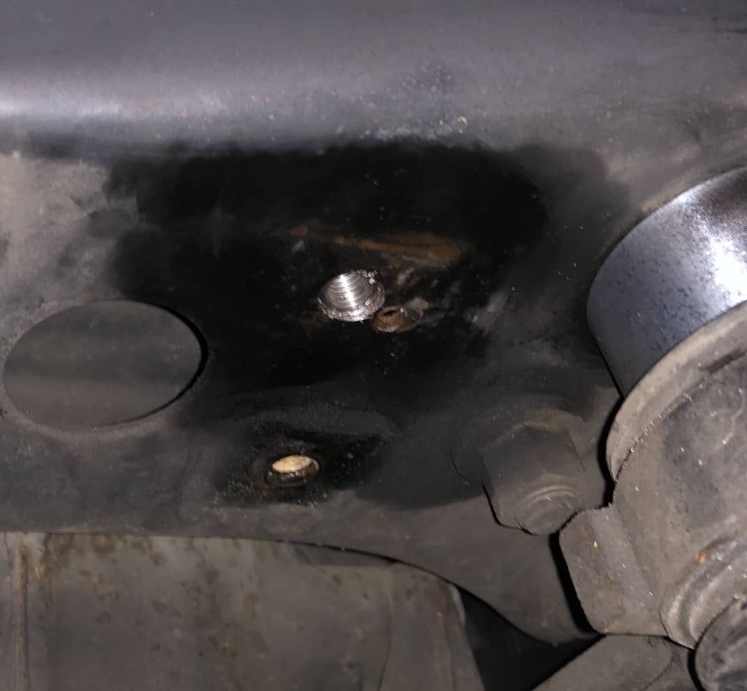

Previous owner broke a few skid plate bolts and stripped threads. My skid plates were held on with two bolts each...

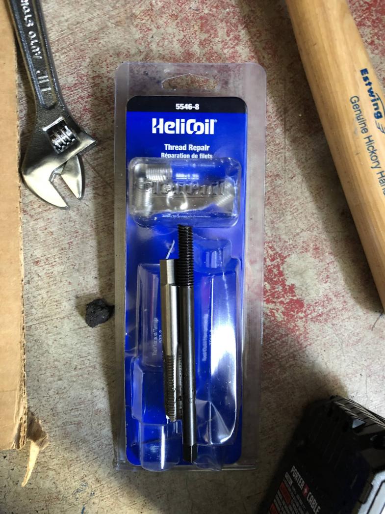

Today I took the drill and m8 helicoil kit to the broken and stripped holes. Pic of one of the broken bolt tips next to the WD40 can and appropriate sentiment below.
The stainless threads are now stronger than stock. Not to mention the bolts go in butter smooth with permatex antiseize applied.

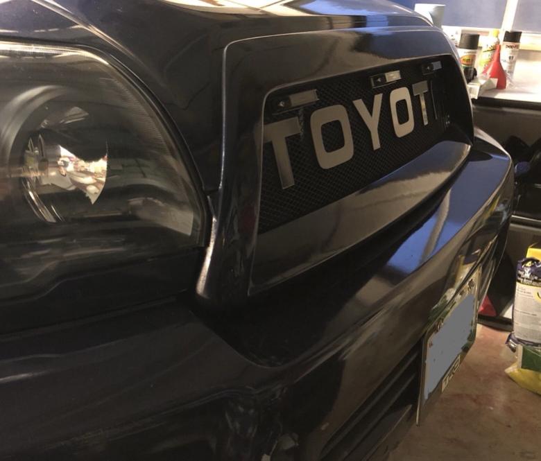

JAOS grille was looking a bit empty. Filled it in with raptor lettering and lights. Lettering is held on with epoxy putty... which is incredible stuff. Also fixed my broken plastic fan shroud using this putty.
Still need to wire up the lights.
