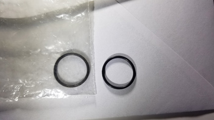

Update: After many miles of searching, Ace Hardware had this metric 20mm OD X 17mm ID X 1.5mm DIA o ring.
O ring on the left, in zip lock is oem. The right side o ring is Ace.
Along the way to Ace, I checked all the parts stores/fastener stores along the route to no avail.
So mines is a goner. I know something should be there to seal out the water and dirt that could makes it's way to the pressed in wheel bearing and contaminate it.
I was thinking of fipg'ing along the flange on the sensor. Or maybe customizing a fiber gasket to fit over the abs flange to seal out the water and dirt?
Only way to get the new o ring is to buy a new oem sensor.
This issue is a minor one, I'm just wondering what the ingenious members on here did when they came across this issue on they're own rig. Thanks

Its the abs sensor (cylindrical shape) that slides into the spindle hub cavity, and secures by a single 10mm hex head bolt. PN# 8954335050.
The o ring is on the sensor itself. :)

I'd suggest going to an o-ring supplier, they shouldn't need much more than rough measurements to get you squared away. Chances are there's a couple in your area, or at least within your state - you just never know they exist until you do business with them
Otherwise you might be going on a wild goose chase for a 10 cent part

This a easy fix Ace is the place it a nothing special O-ring.
Front is smaller dia than rear sensor didn't have one on shelf to measure.
Look for O-ring that fits groove easily but fully on cross section, O-ring should fit inner diameter snug.
With O-ring in place on sensor O-ring should be 1-2mm larger in diameter than body of sensor.
Industry Standard for sizing O-rings.
Make sure you clean sensor hole to bare metal lil grease in hole lil grease on O-ring gtg.
