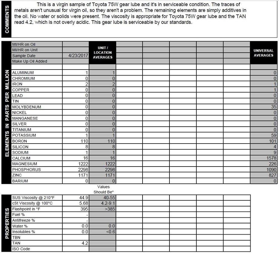

I called a few toyota dealerships service managers. they said they put in the diffs and transfer cases mobil 1 synthetic 75-90wt. now the book says to use toyota 75-85wt on diffs and the tranfer case uses the transfer case oil .. this is the toyota transfer case spec test sheet
notice the high levels of additives used to provide the proper lubrication . I asked it they had this oil in stock they said no had to get a CAN from the distributor warehouse .
Exactly my you should not use 75-90 in the transfer case. Doesn't even come close to meeting the spec of Toyota 75w oil. Dealers are the last place I would look for proper service advice. They generally can't even handle a simple oil change without screwing something up.

Um, have you not see the spec sheets for the additive package in the OEM 75W oil? Find me another oil that meets or exceeds those specs. I'll wait...……...
That's just a VOA, not specs but elemental analysis. Anyway, who cares if the Toyota fluid is "superior". What does "superior" mean in a Transfer Case?
